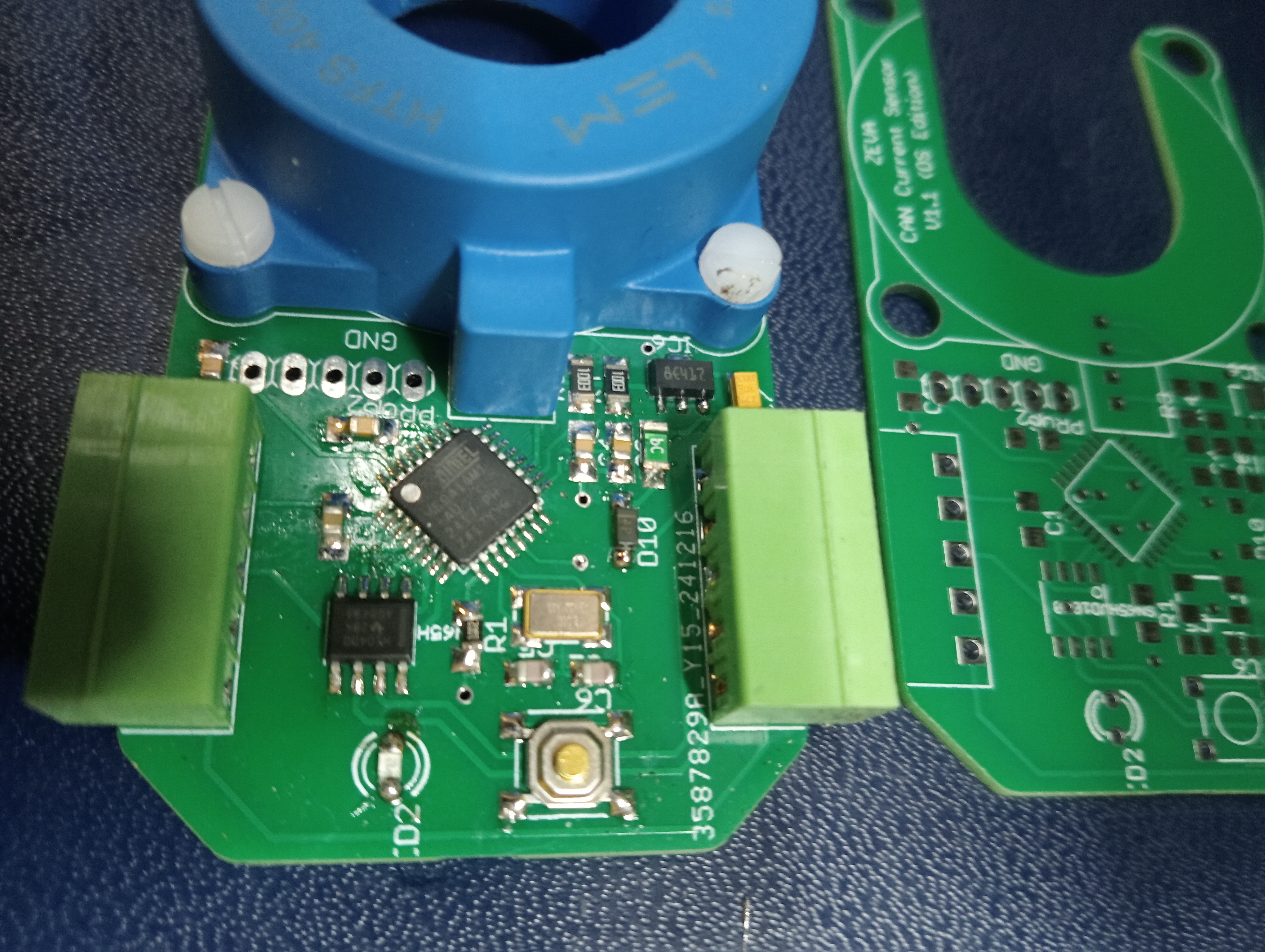

From JLPCB i got ZEVA Current sensor boards I ordered.
I soldered main chip ATMega16M and support components. For sensor i used LEM HTFS400 sensor.
When i got it together i used my AT programmer.
For this i use just a simple AVR USBasp programmer with custom built cable.
https://hobbycomponents.com/usb-interfa ... er-adaptor
Program of choice is avrdude
https://github.com/mariusgreuel/avrdude ... me-ov-file
Because i struggle with using command line i found this GUI interface AVRdudess, it makes my life so much easier
https://blog.zakkemble.net/avrdudess-a-gui-for-avrdude/
Boards must be connected to 12V supply, just because wiring is done that way. If not programmer will not detect the chip.
I connected the board by hand and kept pins pressed together. Then i set the speed of communication to 8bit and tried to autodetect the chip.
I selected my hex file and set the fuses for programming.
When i finished the LED lit up!
As hall sensor has trouble with centering i pressed the button and when LED stopped blinking sensor is centered.
I made 3d printed casing for this sensor so circuit is protected.
Stil have to connect this sensor to CAN lines, but i think it will not be a problem as it is a through connector.
Will report back with some photos...

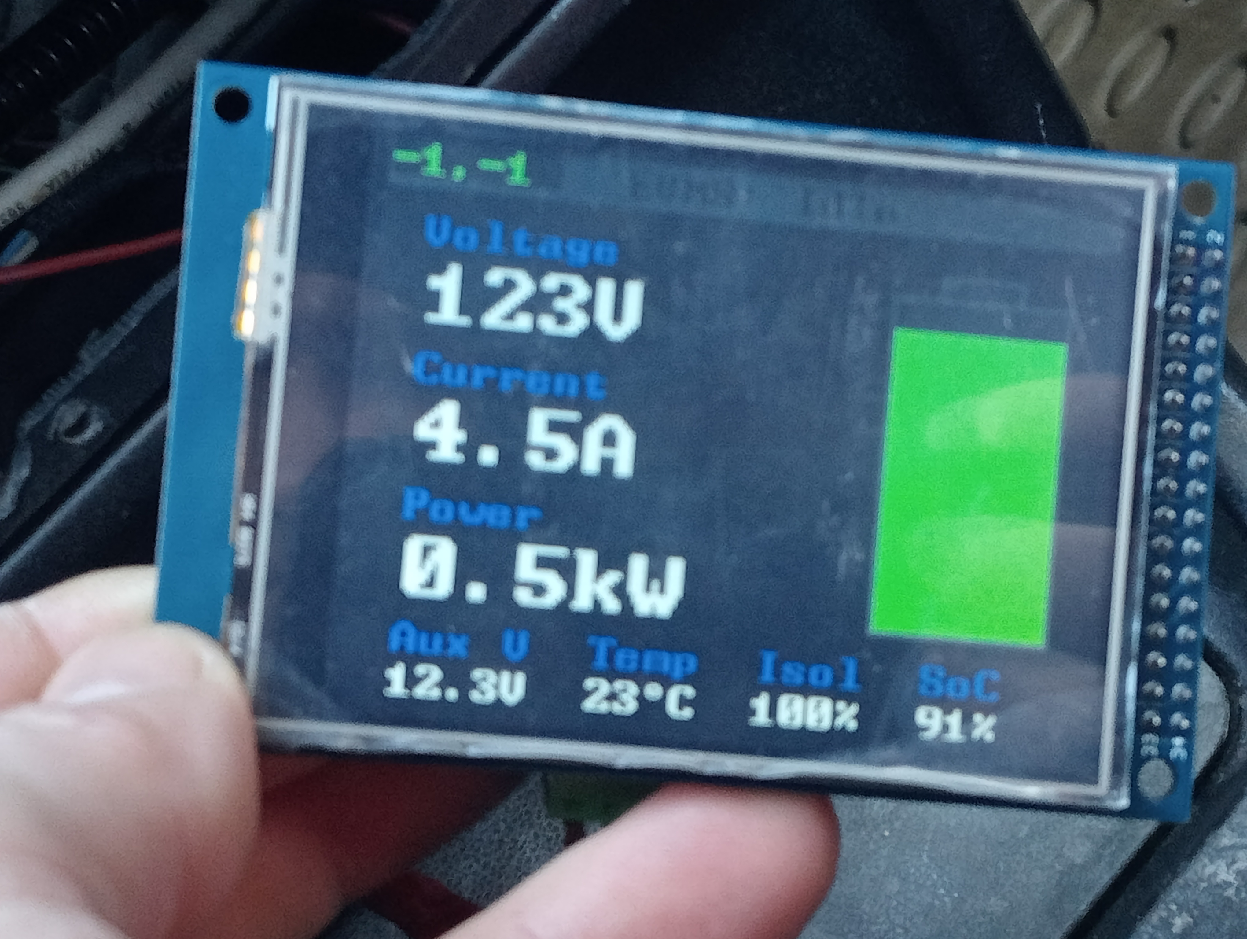

@chentron.... I see another problem....
My 8x 12S modules are communicating and 384V voltage is correctly displayed.
BUT there is an intermadiate voltage of 123V being displayed at about 1s interval. Display alternates between "running" and "idle" state with "idle" being the state when 123V is displayed. How can i make this go away?
I tried to connect HV on the EVMS3 pins and that didnt change anything. I do have only opto circuit connected. Nothing of the 4W resistors or precharge command. I use my own precharge circuit with drive VCU.
Re: ZEVA 24S BMS application
Posted: Sat Mar 22, 2025 6:32 pm
by arber333
This is the vide of me starting the car which provides 12V signal to RUN state.
My battery is 384Vdc 96S
BMS EVMS3 alternates between 123V and 384V and RUN and IDLE state!
Posted: Thu Mar 27, 2025 7:35 am
by arber333
chentron wrote: Sat Mar 22, 2025 2:32 pm running state is when 12v are applied to "key in" in EVMS3. (Just for info: Balancing cells is only done when evms3 is in running state.)
no 12v on "key in" automatically changes to Idle.
Alternating running/idle is strange. Can you inspect this before to revise why 123v are displayed.
Balancing is actually going on with both "Running" and "Charging" modes, its just needs to see high enough cell voltages to start balancing.
I find it quite good and effective process.
But all the time that 123V is interfeering into comms. Sometimes it will stay at 123V for 1s but other times it will flick at 4Hz. Why is this significant? Well CAN communication runs at 4Hz. This means something is probably out of sync...
I dont know from where it originates but i will try to read the code and see if i can change that...

the total voltage shown in the screen is the summatory of all the cells calculated individually.
So, what I would try is to isolate which bms slave is provoking this flicking voltage reading. Mounting each cell block and testing when appear the flicking.
If I had to bet, I would say that it is logical that it fails between cells 30s/31s or 66s/67s.
Once identified the failed one, probably you could find in the electronic a not reliable component or soldering. But You probably know much more than me about this.
going to idle state, is probably that 123v is less than the minimum voltage required in the setup so it can not be in running mode.
Posted: Fri Apr 18, 2025 9:50 pm
by arber333
chentron wrote: Fri Apr 18, 2025 3:53 pm the total voltage shown in the screen is the summatory of all the cells calculated individually.
Hm... so this would mean system is loosing comms in the time it takes to show the next message?
I will try to unplug all modules and test one by one like you said.
However i see the same thing if i only use one 12S module on my workbench. This first led me to belive it is something software related...
