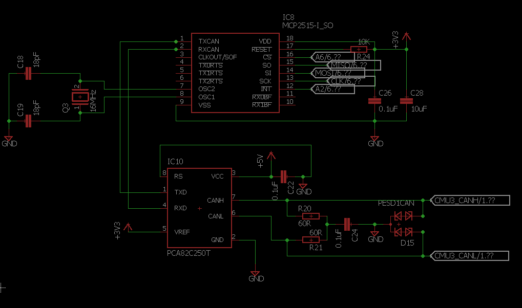

Hi guys,
I'm currently running an Outlander pack for my project, I have CAN communication between my BMS and the 10x CMUs from the Outlander.
I have removed the ANO wiring from the CMU harness as I don't have the Outlander BMS.
I have shortened the CTR (termination resistor) wiring from CMU #7, and spliced it into the CANH/L wiring near to the connector for this CMU.
My BMS communicates through a MCP2515, 16MHz crystal, and a MCP2562 transceiver. My microcontroller is a Teensy 3.2.
My initilisation code is below:

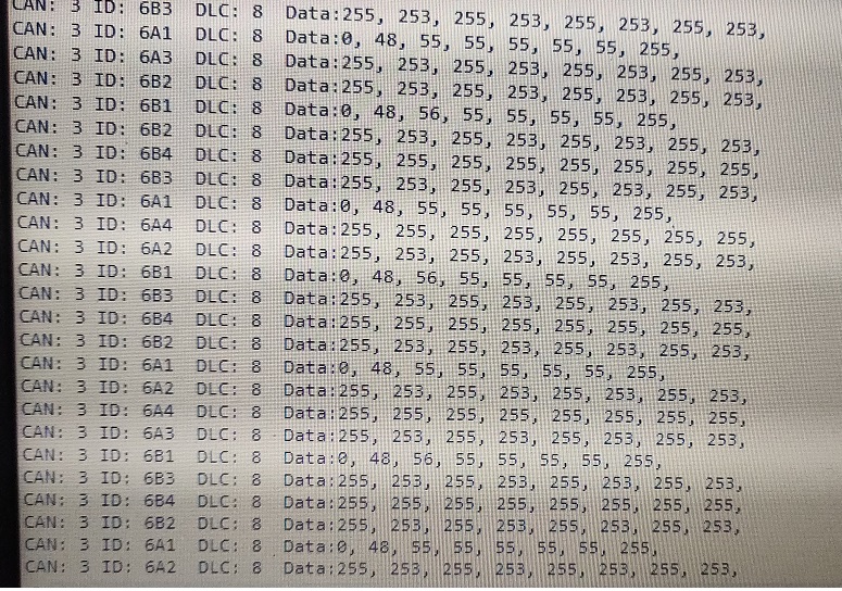

With a single CMU connected, everything works as expected. I can decode the CAN message into mV readings for each cell, and they match my multimeter readings.
However, when connecting a second CMU, the data changes to read "255,253" for each voltage reading. This does not appear to be corruption - the values are consistent. It almost looks like an error state from the CMU.
Does anyone have any suggestions here? Have I messed something up with either the wiring or the code?

The main question should be, you get any new can IDs when you connect the second CMU.
It looks like it due to the xAx and xBx messages.
if you have a known good can decoding tool, always useful to have use that to see what is really on the bus.

Ahh yes, sorry I should have added that in the image there are two CMUs connected. If I disconnect one, then I get "normal" information from the other.
I don't have access to any decoding tools - the nature of these messages does look as though they are coming through as intended. If I connect 10x CMUs, then I seem to get a mixture of "good" and "bad" ones. So I do think there is some sort of conflict there.
Though as far was I was aware, the CMU only receives data on address 0x3C3, I am transmitting all zero on that.

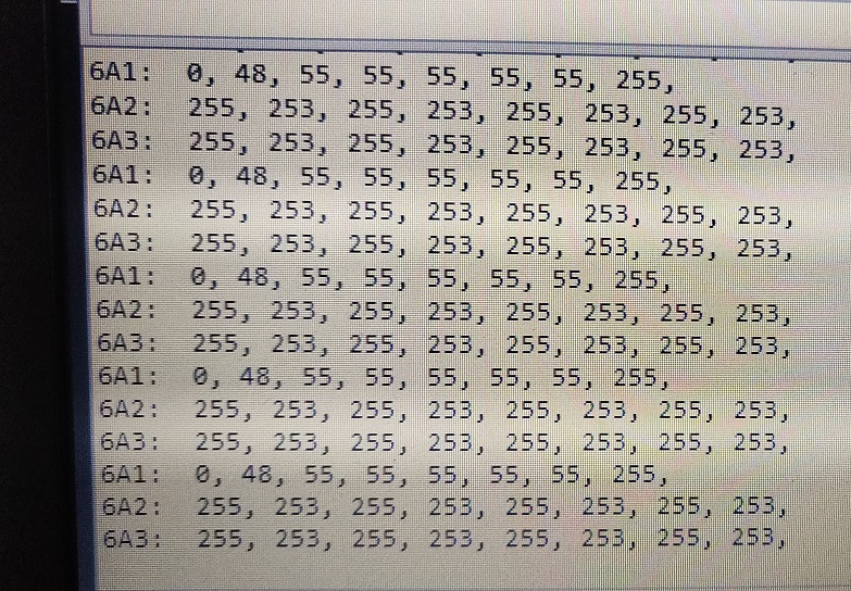

Quick update, I grabbed an arduino with a CAN shield and connected it up. It seems that once a CMU starts sending this "bad" data, it's not possible to get it back to normal. I connected it to a single CMU which was previously giving correct voltage readings, now all I get is the 255,253 repeated over and over.
So, it looks like something I've done has bricked a number of CMUs. Which is odd because, shortly before connecting them all up, I tested them all one-by-one to get the CAN ID from them, and all of them worked fine.

I've tried 3 setups now: My circuit from the schematic posted earlier, the setup in the photo, and a Raspberry Pi with Wireshark. All give the same readings.
This screenshot is from a happy and unhappy CMU:
And this one is from a few moments later, after connecting a resistor across the terminals of the unhappy CMU's pack:
As before, when removing the resistor, the pack remains happy for a few seconds, then goes back to sending the data as in the first screenshot.
