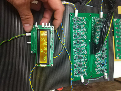

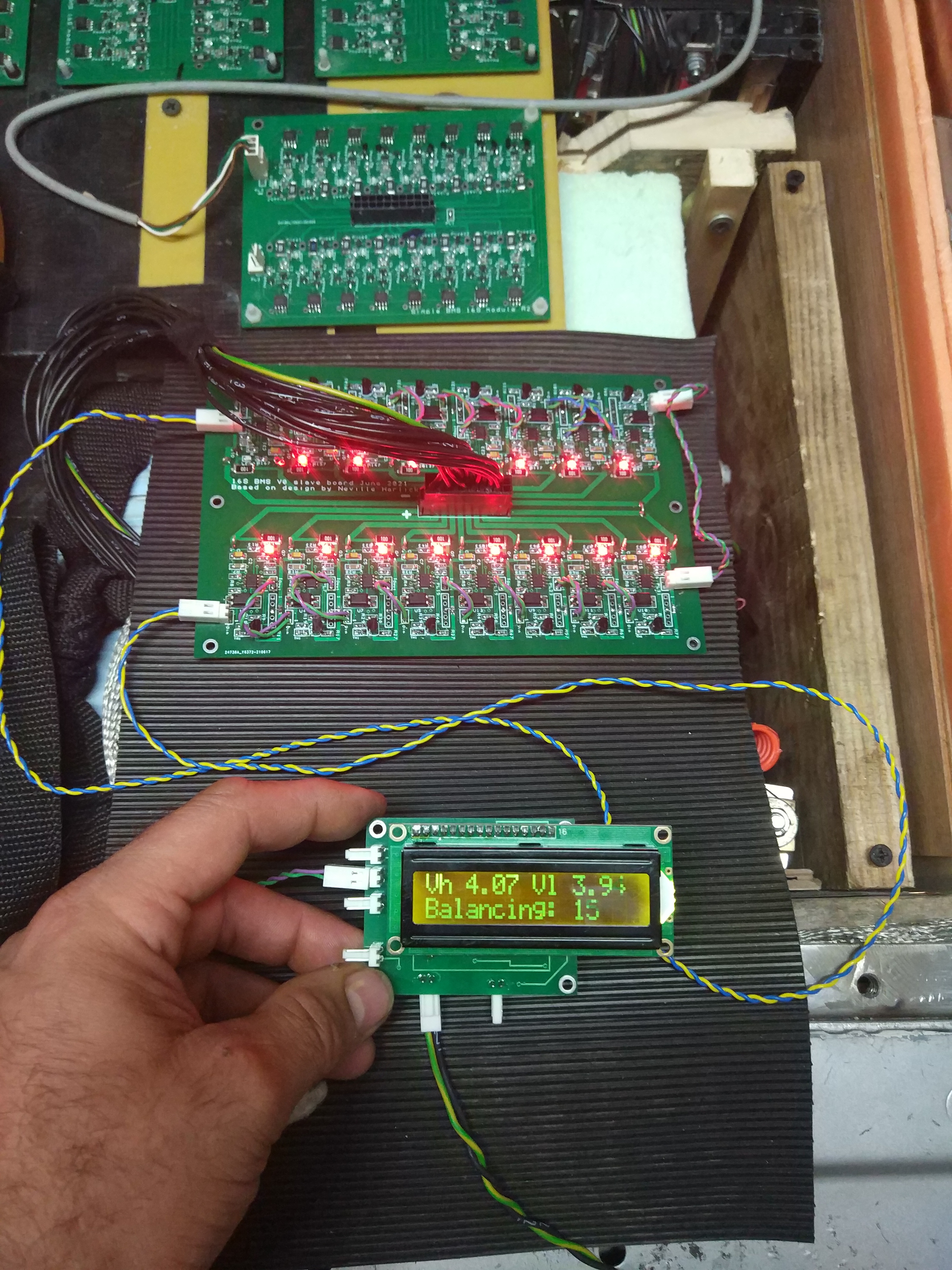

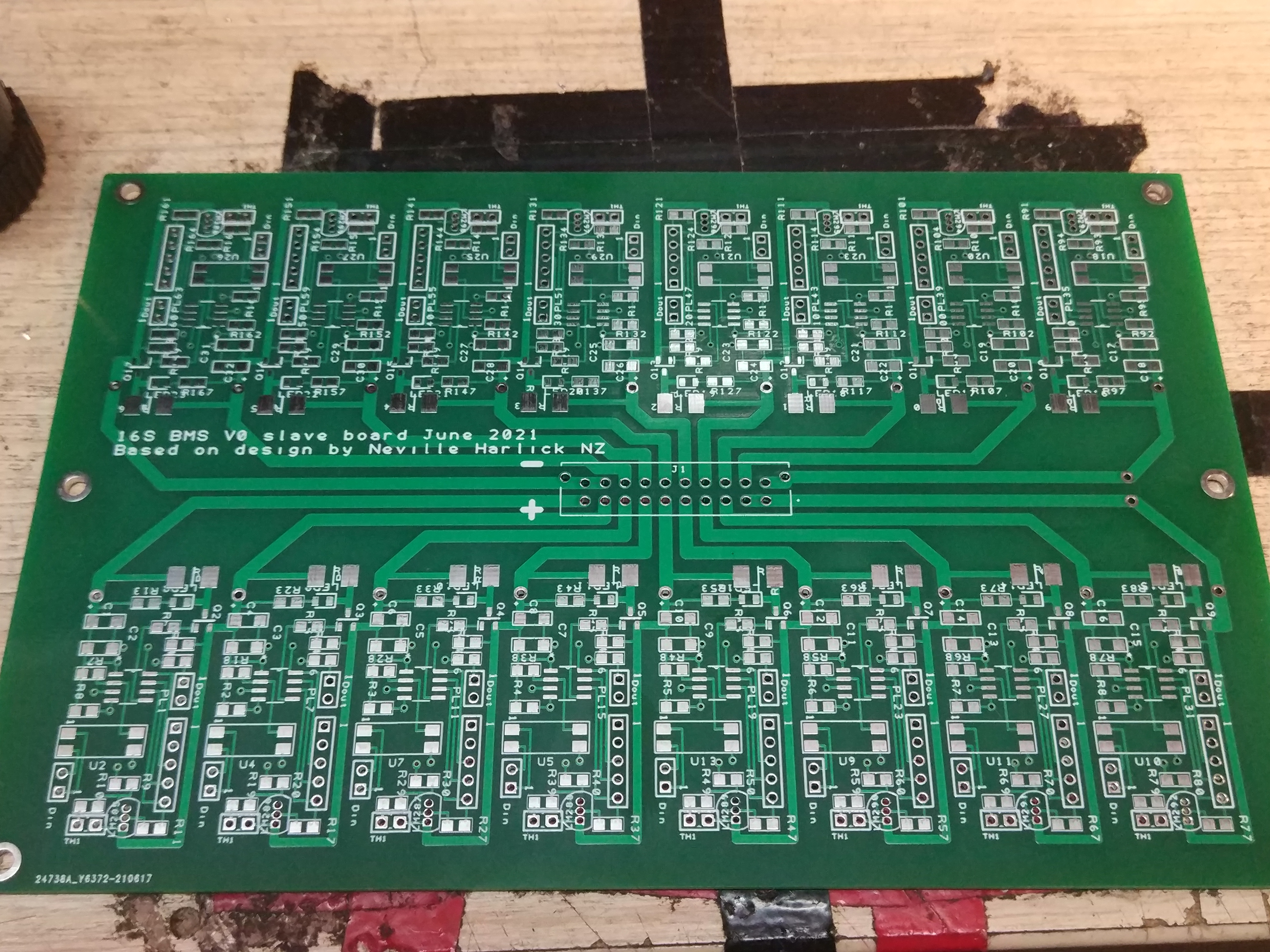

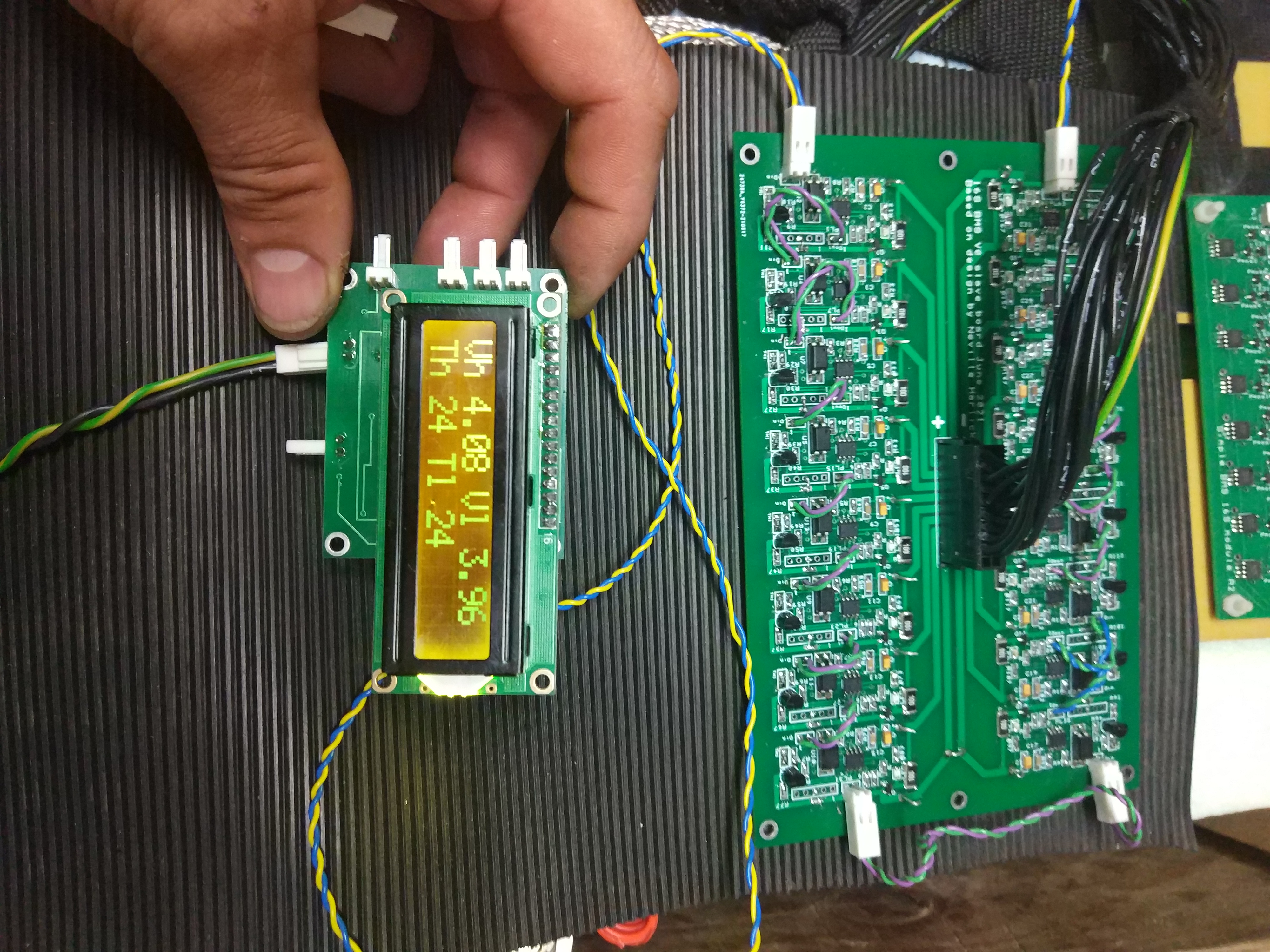

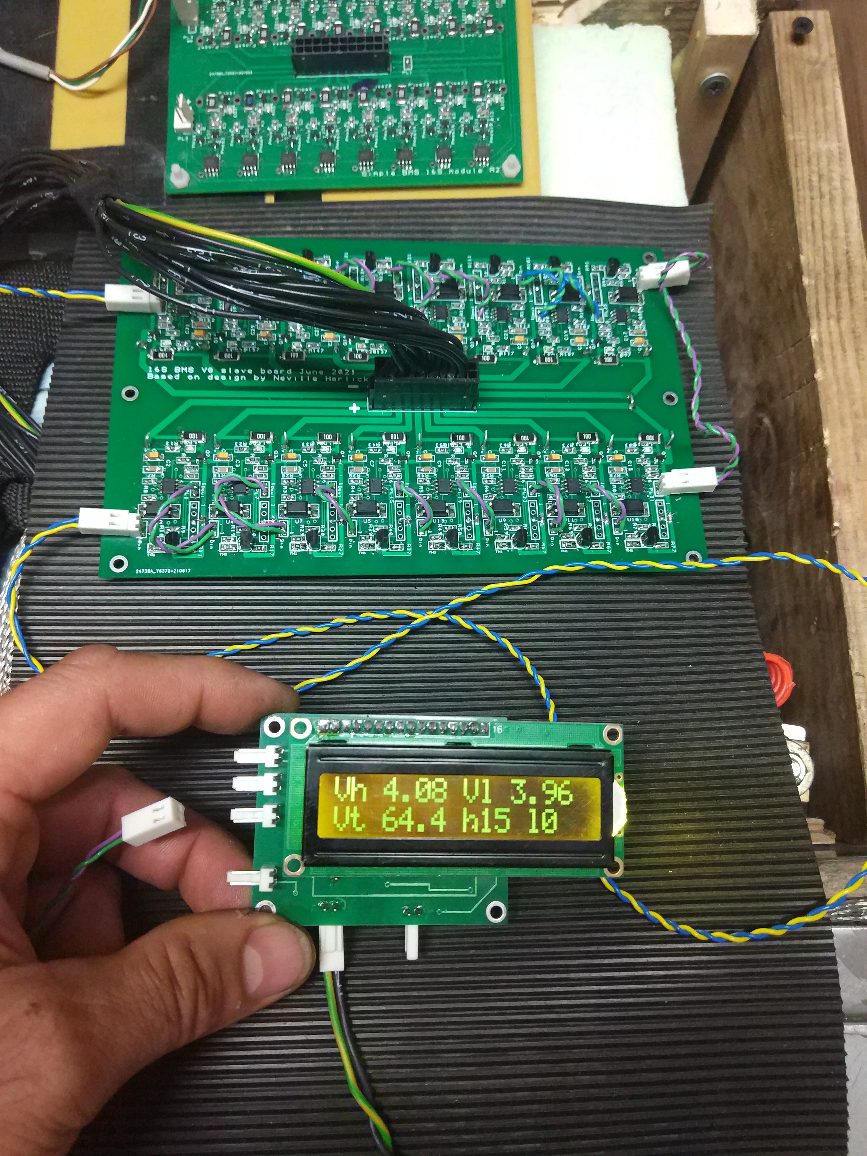

I decided i need to have some form of control over my Jaguar cell voltages. So i went to dust off my old BMS plans.
Since it is daisy chain i will need one Pic12F chip and LM285 reference for each cell. But in return i will get good voltage reporting and temperature reports as well. I went on and made a design for 16S board. Since i have 96S i will need 6 of them.
They will be connected to each other with twisted pair for noise suppression and each pair will end in master board.
Now master board will be something for me to play with. My intention is to make a new master using a Pic18F chip with CAN bus module. This way it will be able to send telegram to charger and cell voltage reports to CAN LCD display i intend to have in my car in the future.
After i finished one board i tried each module individually and only when i was sure they work i connected twisted pairs. When wires are joined Pic12F programming is inhibited. Then i connected complete board to my cell block. I use Molex Minifit connectors.
