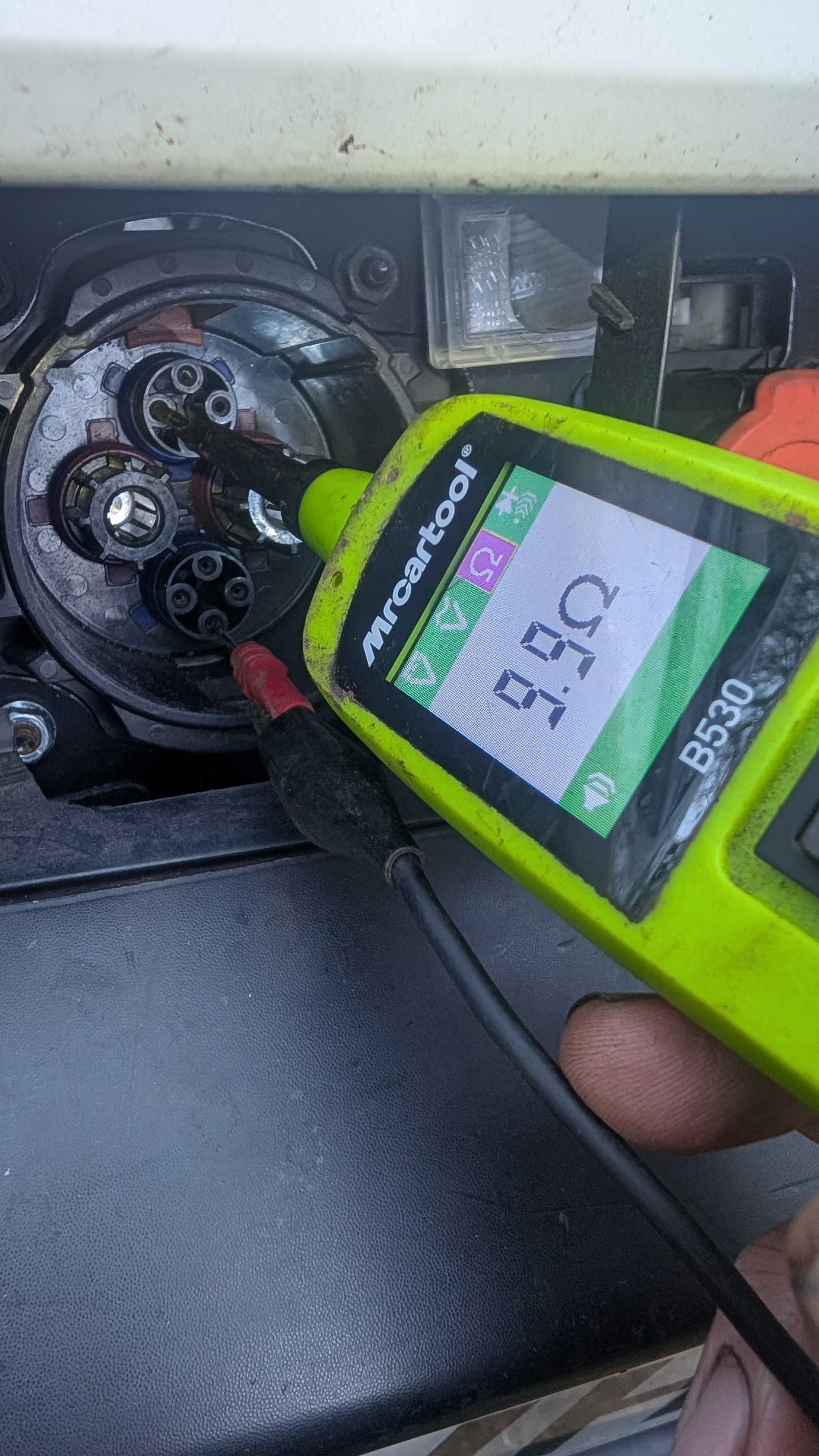

Re: Chademo with Leaf PDM on Zombi VCU
Can you measure the Proximity to ground resistance of the two plugs used to produce this please.

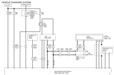

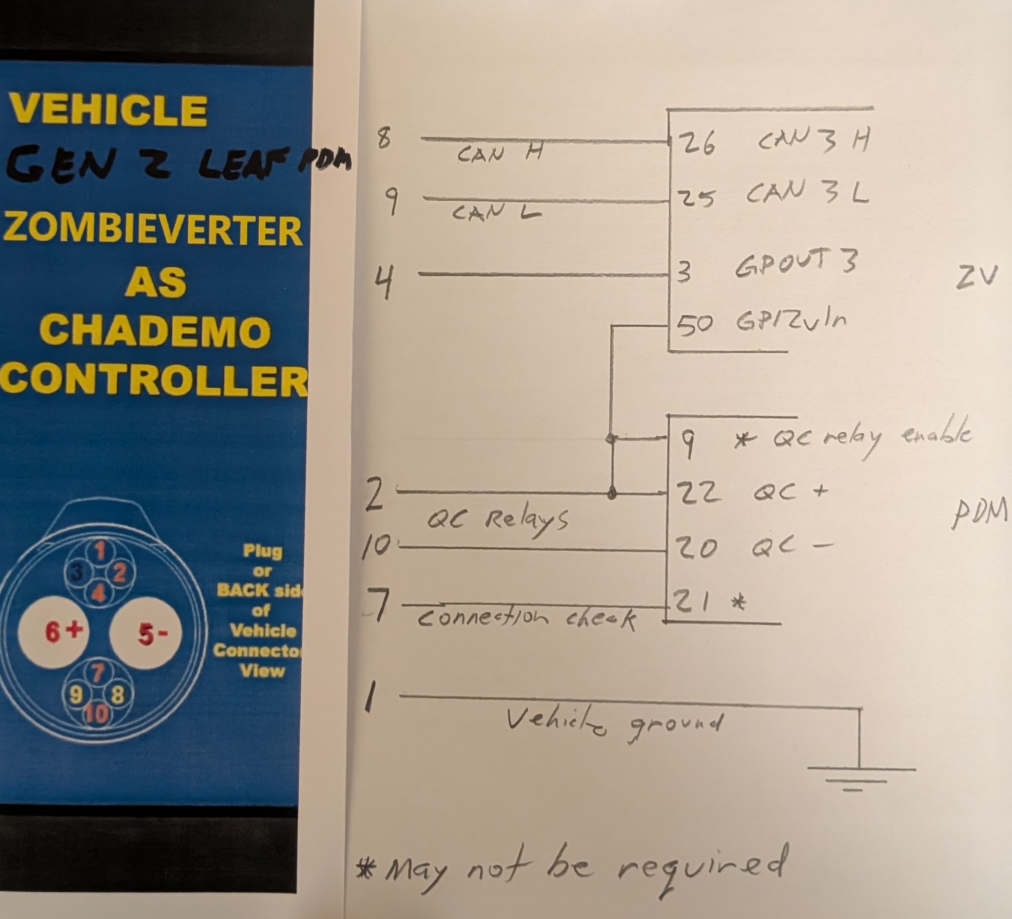

I know this is an old thread but the topic is relevant to my situation. I'm trying to get Chademo working on my van. I'm using a full Leaf stack from a 30kWh AZE0. The wiring is shown below.
When I try and DCFC the station shows vehicle detected, communication established but fails on the final safety checks. My van goes into charging mode when I power pin 2 and earth pin 10 on the Chademo plug as well as when connecting to the charging station.
I'm not sure about some of my wiring, specifically Pin 2 Chademo -> pin 20 PDM?. Maybe it should be going to pin 22 PDM?
Also pin 7 Chademo currently isn't connected, but the diagram shows it connected to a 12v pullup resistor.
Should I connect it?
What value resistor should I use?
Should the 12v be constant or from the enable relay?
Once I get this working I'll add the info to the wiki.
I looked again at how the Leaf PDM is wired to the Chademo socket and changed around PDM pins 20-22 as per this diagram.
Sadly still no charge. I suspect the quick charge contactors aren't closing. Can someone confirm this is how it should be wired and what is required to close the QC contactors in the PDM?

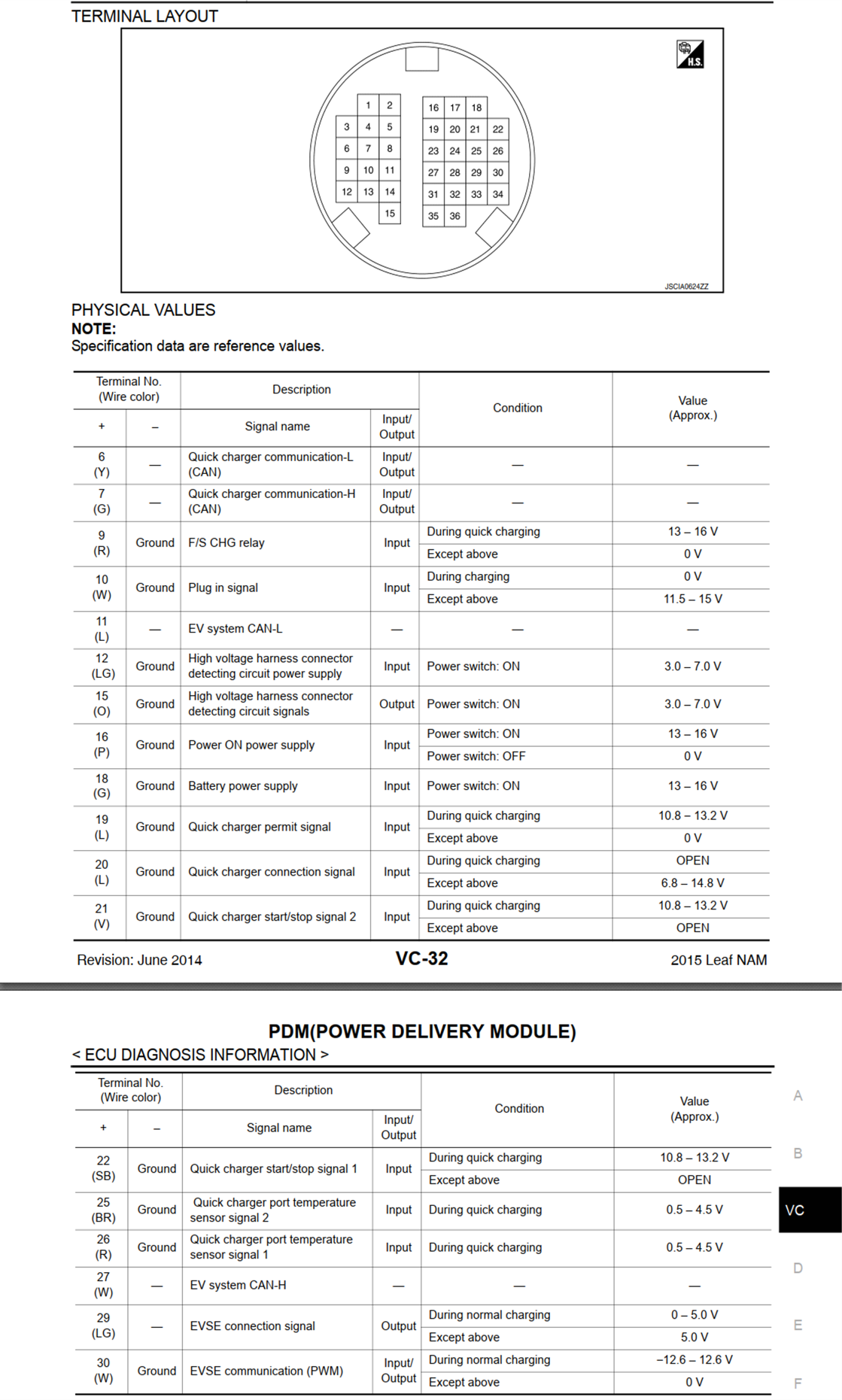

I confirmed today that the quick charge contactors are not closing when I power pin 2 with 12 volts and earth pin 10.
What is required to close the contactors in the PDM? I suppose I could brute force it by wiring directly to the contactors but I'd rather not.

I'm actually starting to look at getting chademo working on my 2017 Leaf stack, so interested to hear if you find a working solution.GregFordyce wrote: ↑Mon Apr 27, 2026 10:41 am I confirmed today that the quick charge contactors are not closing when I power pin 2 with 12 volts and earth pin 10.
- Bratitude
- Posts: 1156
- Location: Canada
- Has thanked: 246 times
- Been thanked: 469 times
What year pdm?
If you can’t tiger the dcfc contactors externally then you’ll need to hardwire them unfortunately

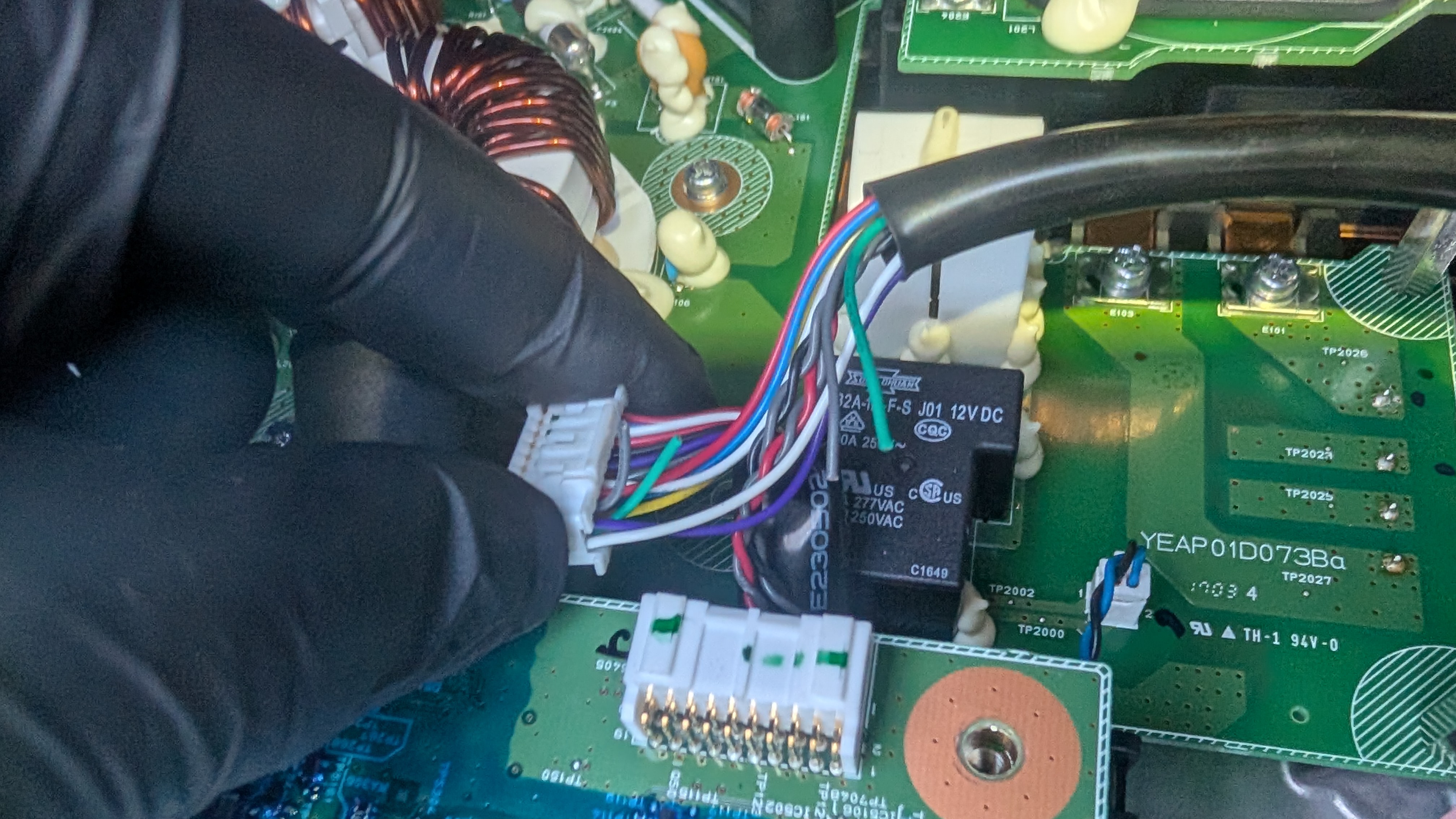

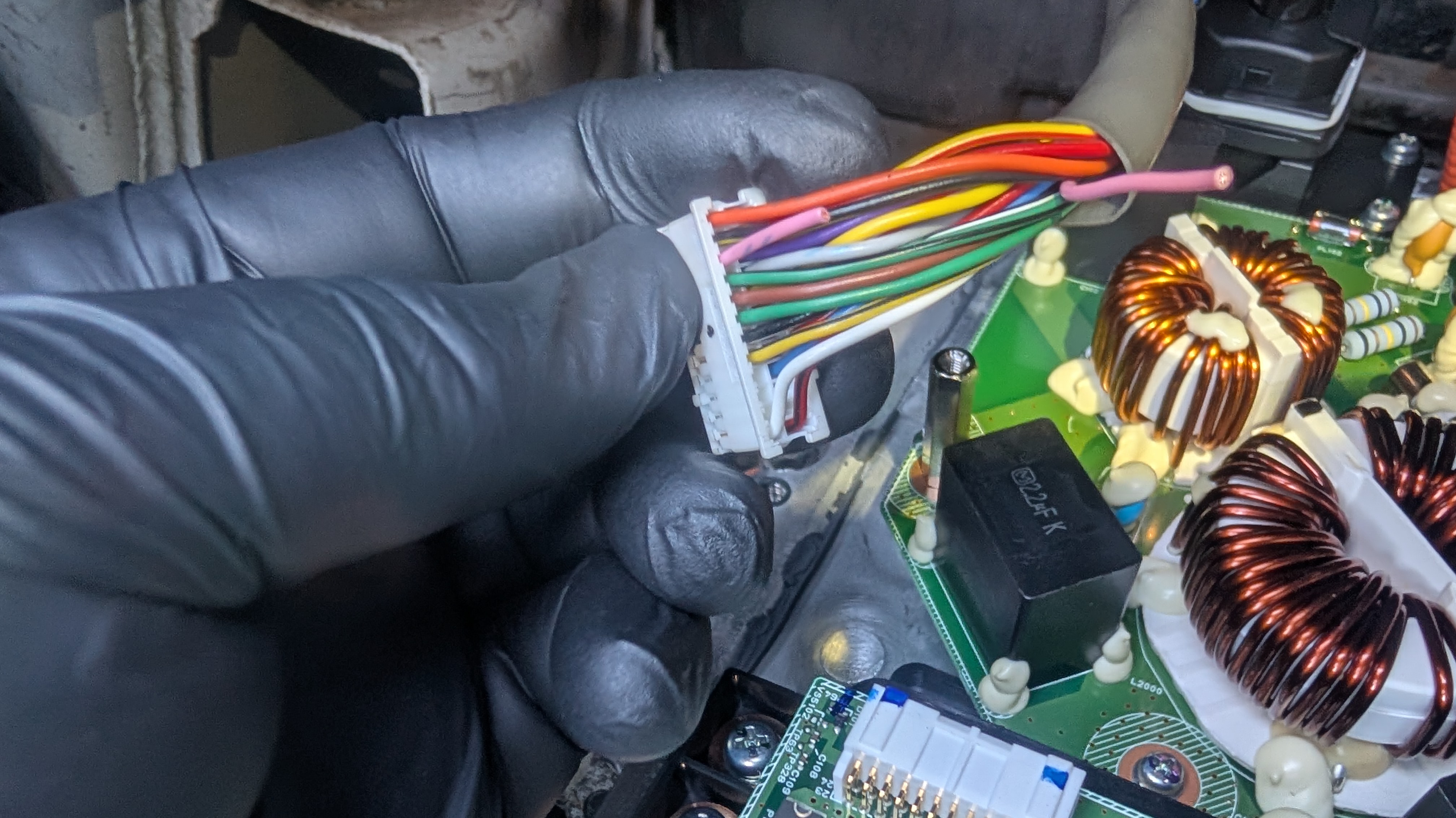

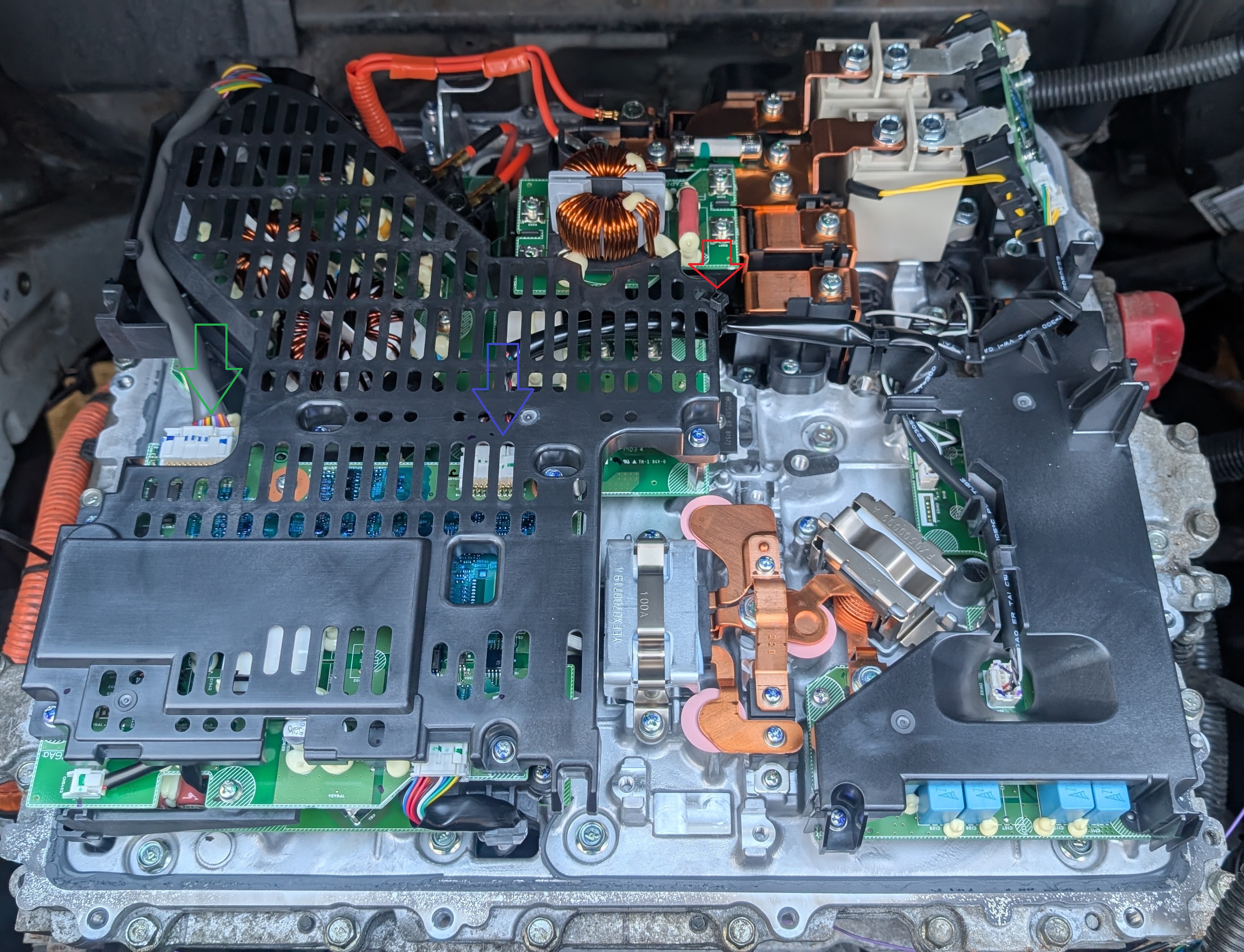

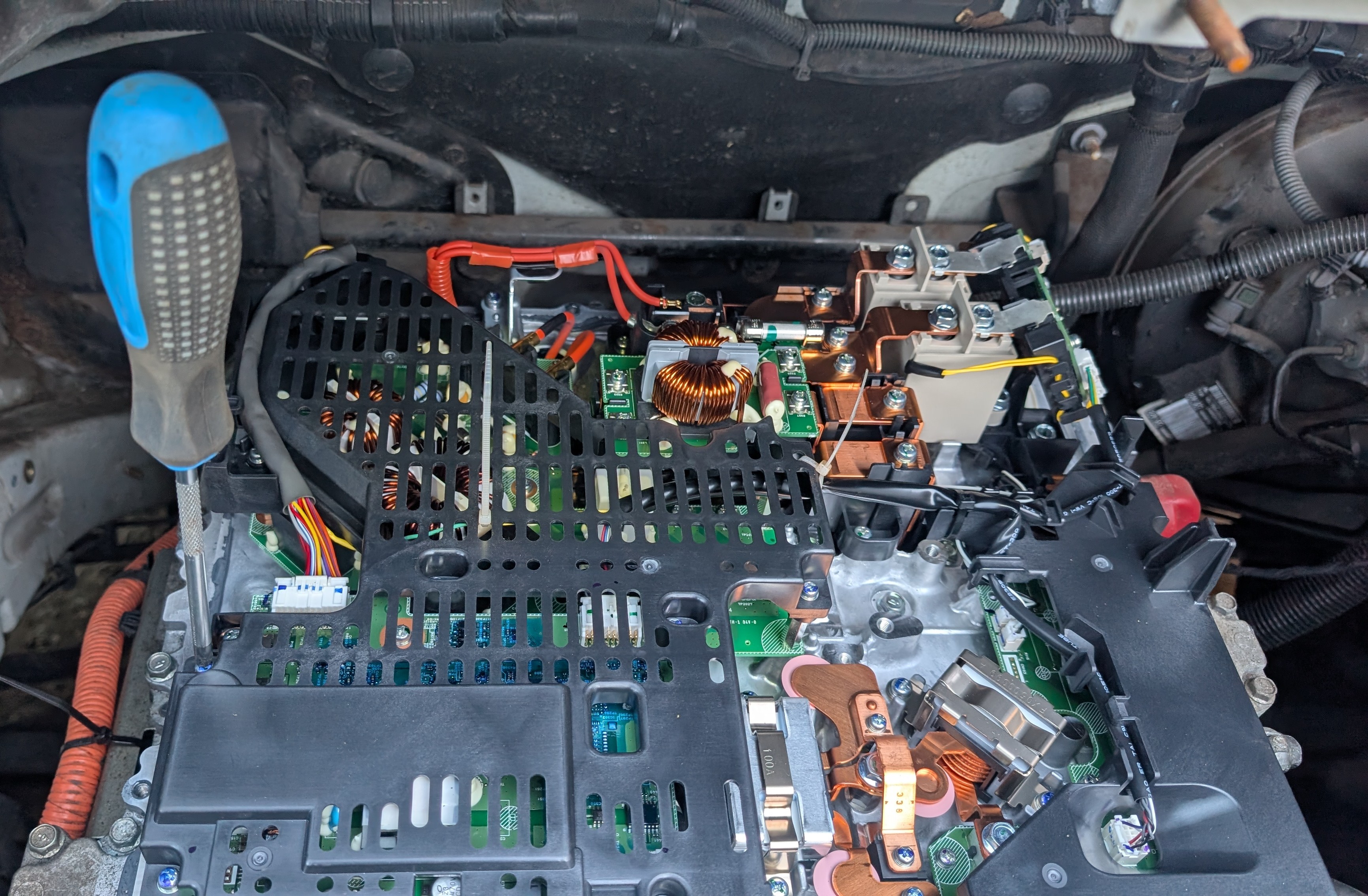

My van has a 2017 AZE0 from a 30kWh Leaf and the pictures below are from a 2015 24kWh.
I've come to that conclusion as well. So in preparation I lifted the lid on my spare AZE0 leaf stack so I could get to the PCB on the QC/dcfc contactors. I've done a partial schematic of the pcb.If you can’t tiger the dcfc contactors externally then you’ll need to hardwire them unfortunately
- CN701 pin 1 -> CN711 pin 2
- CN701 pin 2 -> CN712 pin 2
- CN701 pin 3 -> pins 1 on both CN711 & CN712
Below is a front and rear picture of the pcb.
So a gen2 pdm I guess?
That board is the contractor economizer board so definitely don’t bypass it! Looks like you got it though
CHAdeMO is definitely a bit finicky with zombie, im having some issues with HVactive not being enabled. So more to follow suit
- GregFordyce
- Posts: 49
- Joined: Sun May 23, 2021 5:58 pm
- Location: Scottish Borders
- Has thanked: 43 times
- Been thanked: 29 times
Yes, gen2.
This is not an economizer board, the connections on pins 1-3 of CN701 pass straight through the board, it's simply acting as a junction block for the QC contactors, but you are right, it doesn't need bypassing. The rest of the circuitry on the board is an isolated signal back to the PDM, on pins 4-6, to indicate the contactors are closed and probably also to check for a welded contactor condition.That board is the contractor economizer board so definitely don’t bypass it! Looks like you got it though

Since you have the PDM hat open, would you check whether the pins 1-3 of CN701 are directly connected to PDM pins 21 & 22?GregFordyce wrote: ↑Wed Apr 29, 2026 7:56 am Yes, gen2.
Or if not, how they are connected?
And what energizing PDM pin 9 actually does?

Success, Chademo is working on my Gen 2 Leaf stack!
Now for how we got there.
https://www.youtube.com/shorts/2yLIPDVTzH8
First step, follow Damien's video https://www.youtube.com/watch?v=zuPvgzQt6XQ and wire up your Chademo port as shown below. Next the cover is removed. Follow all safety procedures as you will be working next to 400 volt exposed conductors. Disconnect all batteries and remove any service plugs. With the cover removed check for continuity between Chademo pin 2 and pin 3 of CN701 (you will also have continuity to pins 1 and 2 through the contactor coils). Once this is confirmed okay, cut the cable tie (red arrow), remove the plastic cover and disconnect the 2 connectors (blue and green arrows). Check for continuity on the pink wire, pin 6, to Chademo pin 10. If okay cut wire as shown. The black/yellow wire, pin 4, goes to Chademo pin 2. The plastic sleeving around the wire harness can be pushed back if it's to close to the connector. Check for continuity from pins 1 and 2 of CN701 to pins 3 and 4. If okay, cut as shown. Join these 2 wires together and connect to the pink wire leaving a bit of slack so it can fit under the plastic cover. Reconnect both connectors and check resistance between Chademo pins 2 and 10. Expect to see around 10 to 12 ohms. Next test the contactors close with 12v applied. (video below) NOTE, vehicle 12v and traction pack are NOT connected for this test!
https://www.youtube.com/shorts/EU6L3haZdI8 Refit the plastic cover, the screw with the screwdriver sticking out of is longer than all the rest. I also fitted 2 white cable ties as shown.
I'll add this to the wiki in a week or so after any comments/suggestions.
Happy Chademoing!
Greg.
PDM pin 9 seems to go to the lower section of the PDM. I'm not sure what it does but I have connected it as shown above.And what energizing PDM pin 9 actually does?
Happy Chademoing!
Greg.
