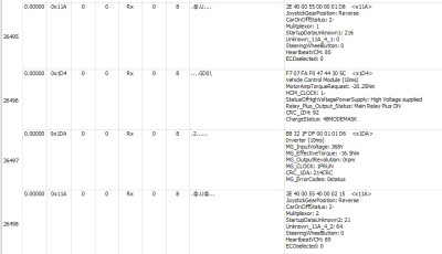

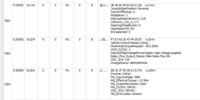

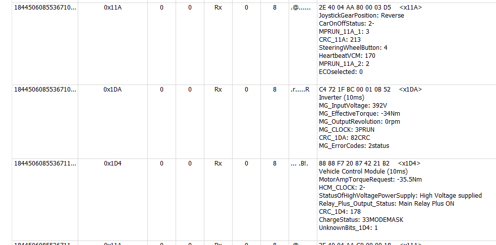

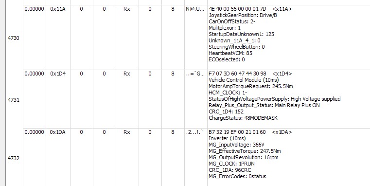

Finally had time to test this out again as I have witnessed this happening on multiple Zombie fw versions. I think it was 2.05 that I first tested, but didn't look deeper into this then.
My setup is a 2017 Leaf full stack and LBC. Leaf accelerator pedal.

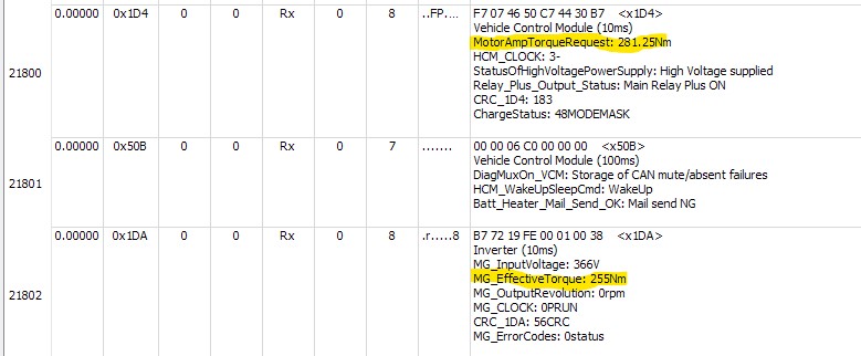

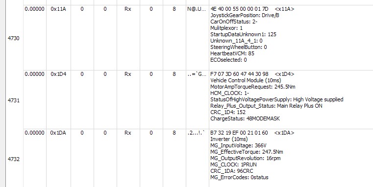

Forward direction this really wants to move, and I can press against the brake pedal to verify that motor effective torque is ~260Nm reported by inverter.
Things don't work like that when drive direction is reverse. Torque request but the effective torque is max. -17Nm --> this is no good...
I don't have a manual gearbox, so I can't overcome this issue just by selecting reverse from manual box :D
Looking at the CAN trace, the JoysticGearPosition in 0x11A doesn't change regardless of drive direction selection. Got me wondering, could this be the root cause. Probably another safety layer by Nissan, that the inverter won't go full negative torque when drive direction selected forward.
Attached params and CAN trace.
Tested on latest released and also built todays situation of what is the most current in Damien's GitHub. The trace is done with this version I compiled.
But note, that this doesn't change the behavior of the inverter.

Posts: 2962
Has thanked: 328 times
Been thanked: 847 times
Re: Leaf full stack not reversing properly
You ever had a version where it worked better?
Will have to dig into this when i get the chance to review some Leaf CAN logs. Yes the leaf does indeed have the reverse signal, can review how to add it in properly into the CAN control in Zombie.
The Leaf is indeed firmware limited in reverse.
It would be good to know if others have the same, or ever had it working well in reverse.

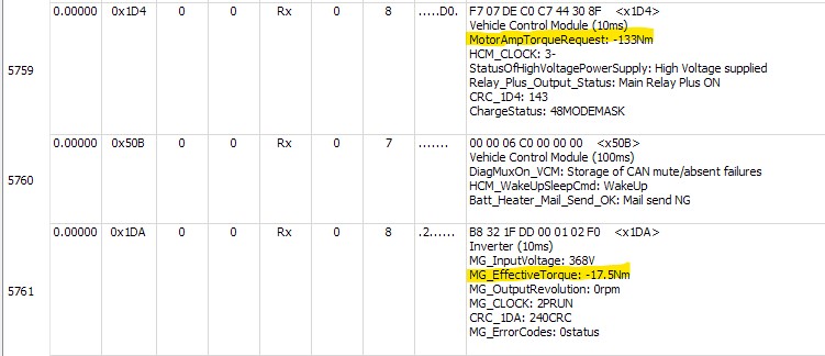

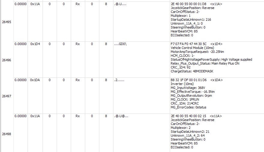

Can you test with applying less torque request in reverse. To see if it goes above the -17.5Nm?
For example we can see a -35Nm request form a leaf 60kWh log.
J0hannes
Posts: 158
Has thanked: 21 times
Been thanked: 182 times
Post by J0hannes »
Here's one frame with -20.25Nm torque req and MG eff torque does not go above -17.5Nm
Posts: 2962
J0hannes wrote: Tue Mar 04, 2025 5:19 pm Here's one frame with -20.25Nm torque req and MG eff torque does not go above -17.5Nm
Please provide a log of this, I need data to review.

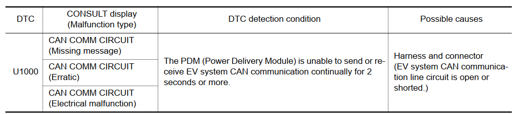

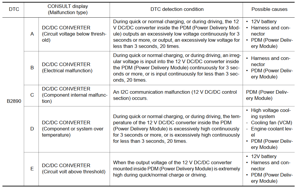

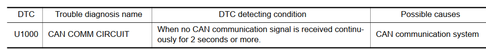

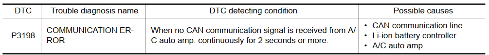

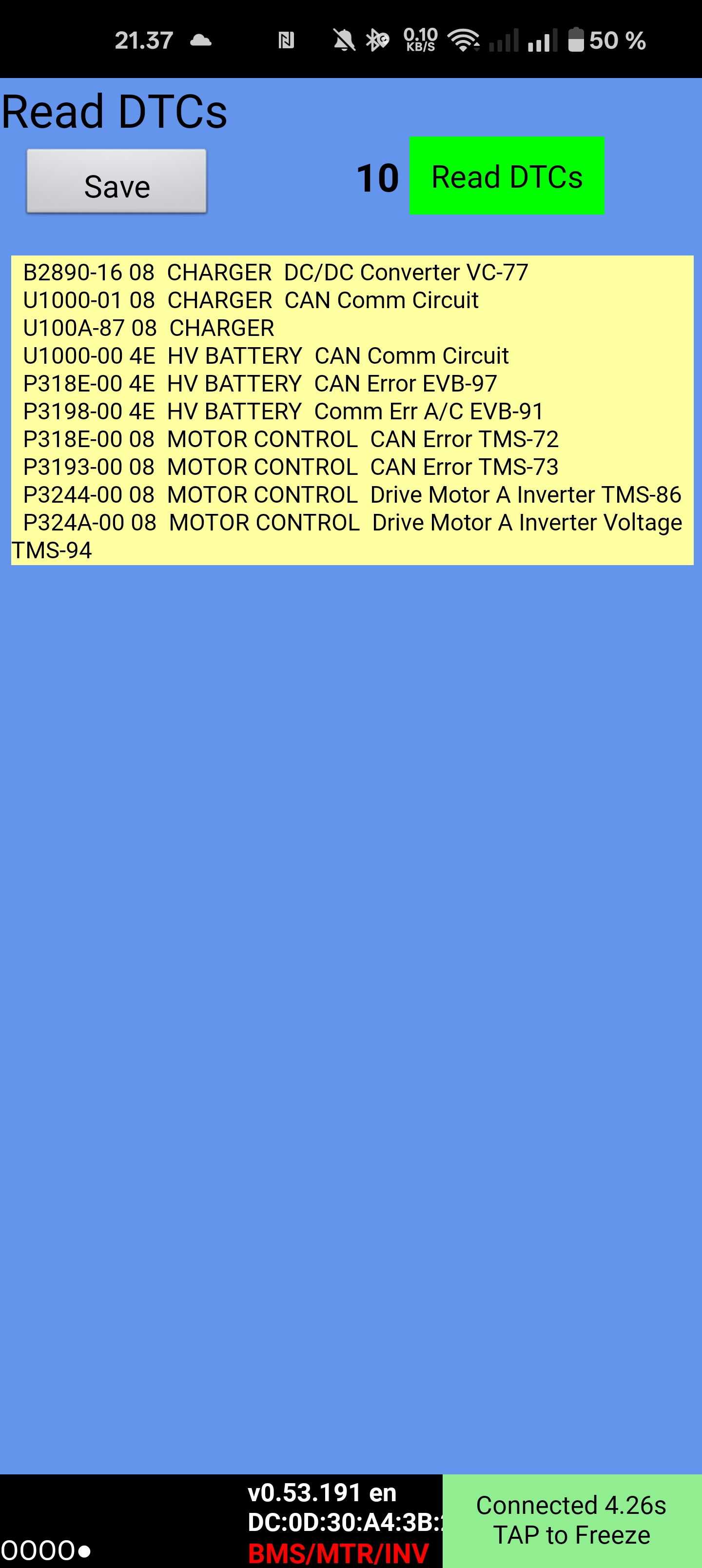

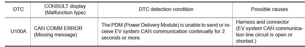

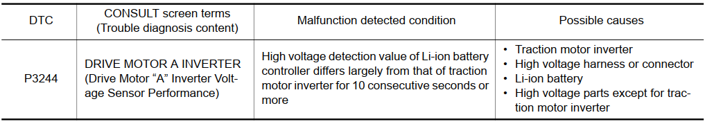

These are active DTCs that Leafspy reads.
Haven't checked all of these, but some are CRC errors
Posts: 2962
J0hannes wrote: Tue Mar 04, 2025 6:02 pm Here you are, I meant to attach this already in my prevvious post
Your logs are not savvy CAN compatible so I cannot read them to analyse.
J0hannes wrote: Tue Mar 04, 2025 7:41 pm
Interesting, could you please provide details on each?

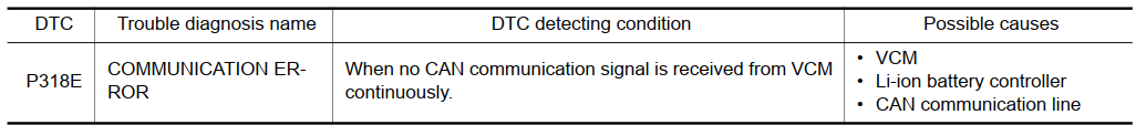

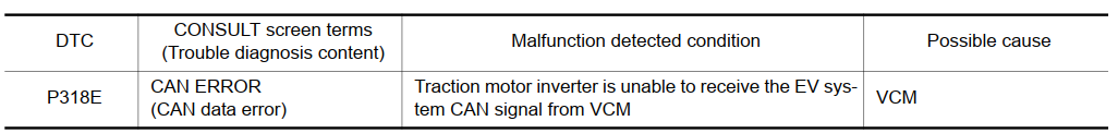

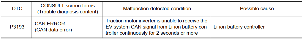

Marat
Posts: 29
Joined: Wed Nov 16, 2022 6:24 pm
Been thanked: 12 times
Post by Marat »
P318E CAN ERROR
(CAN data error)
Traction motor inverter is unable to receive the EV system
CAN signal from VCM
P3193 CAN ERROR
(CAN data error)
EV system CAN signal from Li-ion battery controller
continuously for 2 seconds or more
P3244
DRIVE MOTOR A INVERTER
(Drive Motor “A” Inverter Voltage
Sensor Performance)
High voltage detection value of Li-ion battery
controller differs largely from that of traction
motor inverter for 10 consecutive seconds or
more

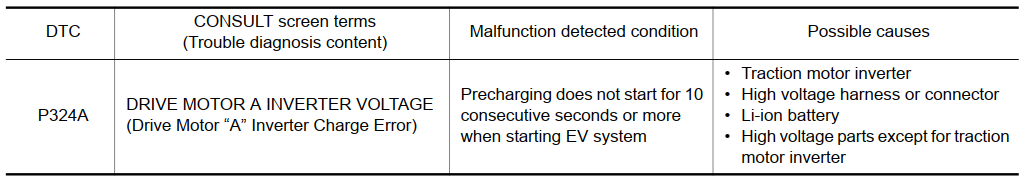

P324A DRIVE MOTOR A INVERTER VOLTAGE
(Drive Motor “A” Inverter Charge Error)
Precharging does not start for 10
consecutive seconds or more
when starting EV system
The errors may be old and need to be cleared and recalculated.

Post by J0hannes »
PDM
PDM
PDM
Battery
Battery
Battery
Inverter
Inverter
Inverter
Inverter
I didn't clear these yet, so can't say if they are all relevant

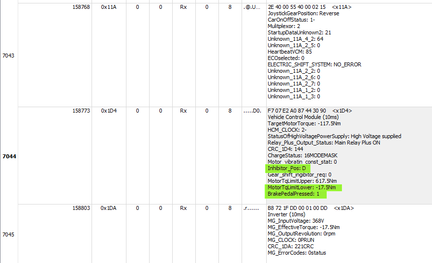

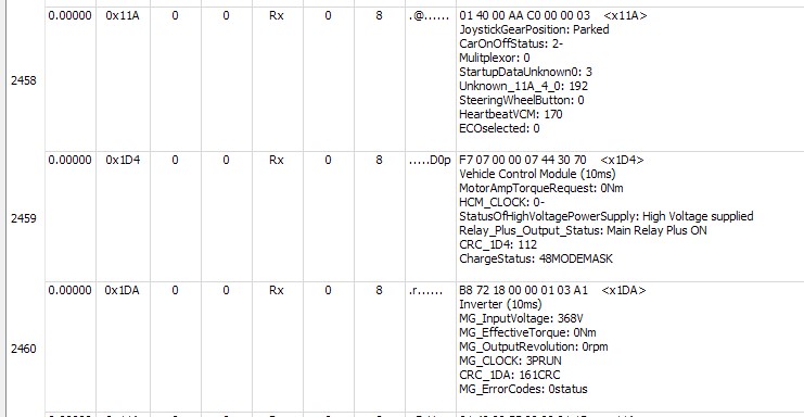

1D4 message error found -->Leaf full stack not reversing properly
Post by J0hannes »

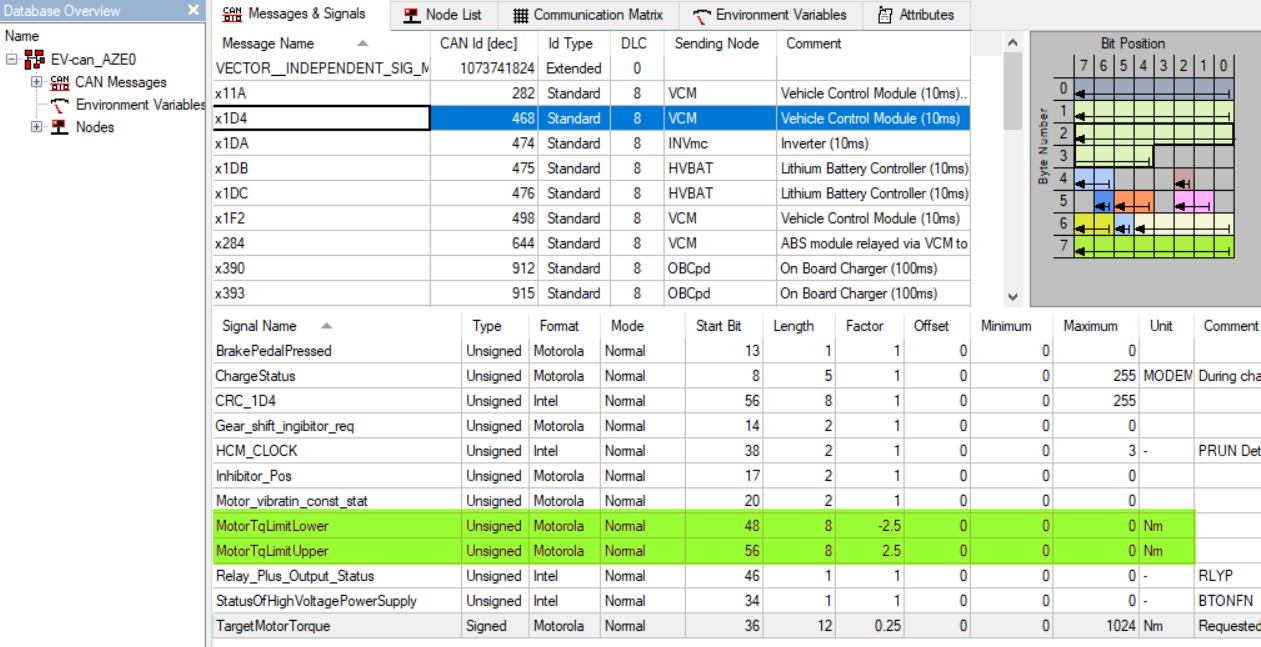

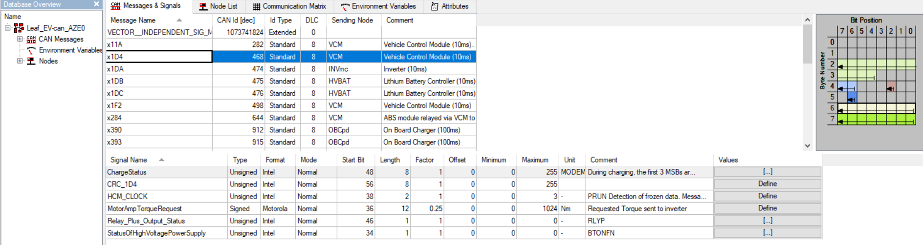

Well, I think I found out, why the inverter gives only -17.5Nm out...
Because Zombieverter tells the inverter to give only that :D
What I did was update my DBC from Dala's Github, my previous one was from over a year ago. New signals here :geek: No wonder finding out the issue felt difficult and now the problem is clear as the sky on a freezing day :D
Also, I guess the Inhibitor pos and brake pedal pressed statuses would be a good idea to change so they follow actual brake pedal and drive direction selected states
I think with this 1D4 getting fixed, Leaf reversing will work like it should :)
Posts: 2962
Okay thanks for finding this, I will also get new dbcs :) mine are old too.
I will update this post once I have update the code on github.
//EDIT///
Okay so made both limits the same lets see what that does. Make sure not to break anything.
https://github.com/damienmaguire/Stm32- ... 6c70b2aa69
Possibly this will also allow us to run the motor in reverse, but not sure just yet.
!!! CHECK your params after this update, as we are removing a request limit. This means if the VCU asks for -600Nm in reverse it the inverter might comply.
Check:
1.Regen settings
2.Ramp settings
3.Reverse throttle limits
4.Check brake settings
