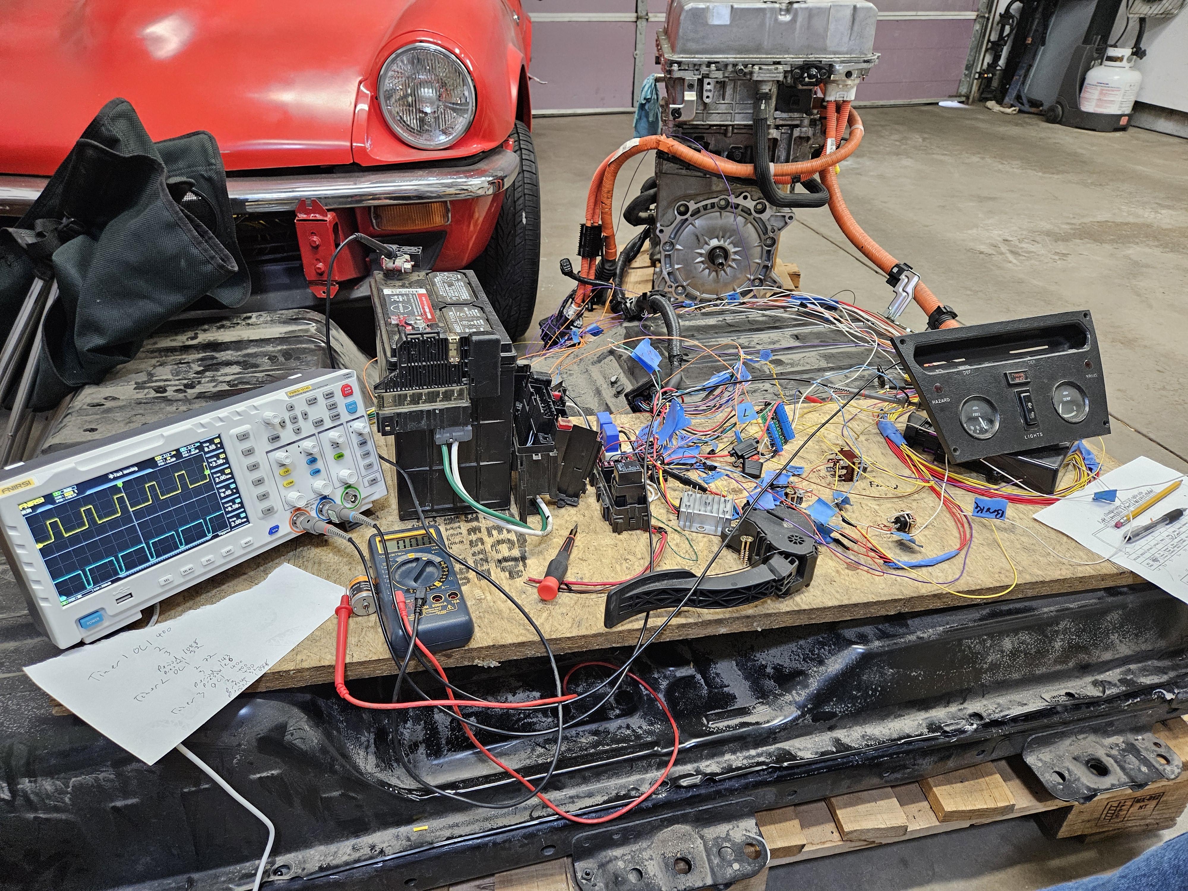

Hello
I have been looking at how to I get the SOC out of the Zombieverter. I would like to have it drive my old fuel gauge. The gauge goes from 0-10 V.
My plan was to use a PWM to drive this but I don't see that as an option.
Have other people tried different solutions?

alucas wrote: Mon Mar 03, 2025 1:13 am but I don't see that as an option.
I have added this in the testing branch of the Zombie on github. We are waiting for testing before releasing an update.
https://github.com/damienmaguire/Stm32-vcu/issues/154

I got this working for both a SOC and temp gauge. Note I used a motor driver with a optoisolator. I also have a voltage regulator that runs at 10V. I tested on a leaf setup that is not yet in the car.
The frequency of modulation seemed high for my use so I modified the code to be able to adjust timer3 prescale and frequency via the web interface. I can share that change if anyone wants it.

alucas wrote: Sat Mar 22, 2025 4:53 pm code to be able to adjust timer3 prescale and frequency via the web interface.
Might be good to look at adding that option. Only thing that would need to be coded in is to keep this from being allowed when the Control Pilot or GS450h pump is used on a pwm output.
