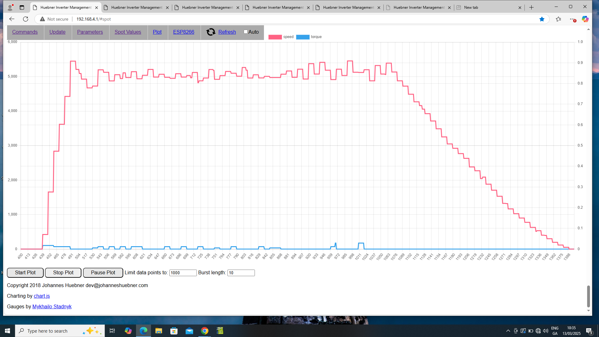

Re: Unlocking the power/torque of Prius gen 3 drive train?
Set revlim to 8000...see log
set revlim to 10000...see log
- Posts: 2293
- Location: Bristol
- Has thanked: 199 times
- Been thanked: 524 times
So this is not the limit right now. Best get this into a vehicle with a welded PSD and then start tweaking things.

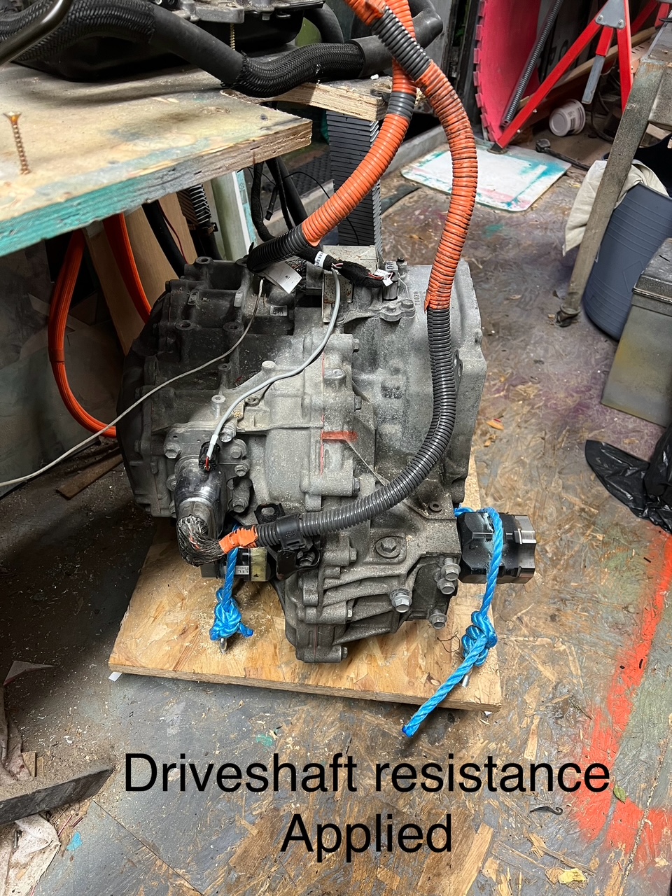

- Joined: Wed Apr 10, 2024 6:50 pm
- Has thanked: 260 times
- Been thanked: 19 times
Oil in and MG1 running on revlim5000 no unusual noises.
Runs forward and reverse with output shaft matching.

Thanks Tom, anything else I can try in the interim?
I have a crude resistance rope setup on each drive hub that I could use to increase the load.
Any point in trying MG1 & MG2 together for a spin?

- Posts: 2293
- Location: Bristol
No the limit Greg's rabit hit was 20kW, this is not something to simply absorb in a "DIY" setup.

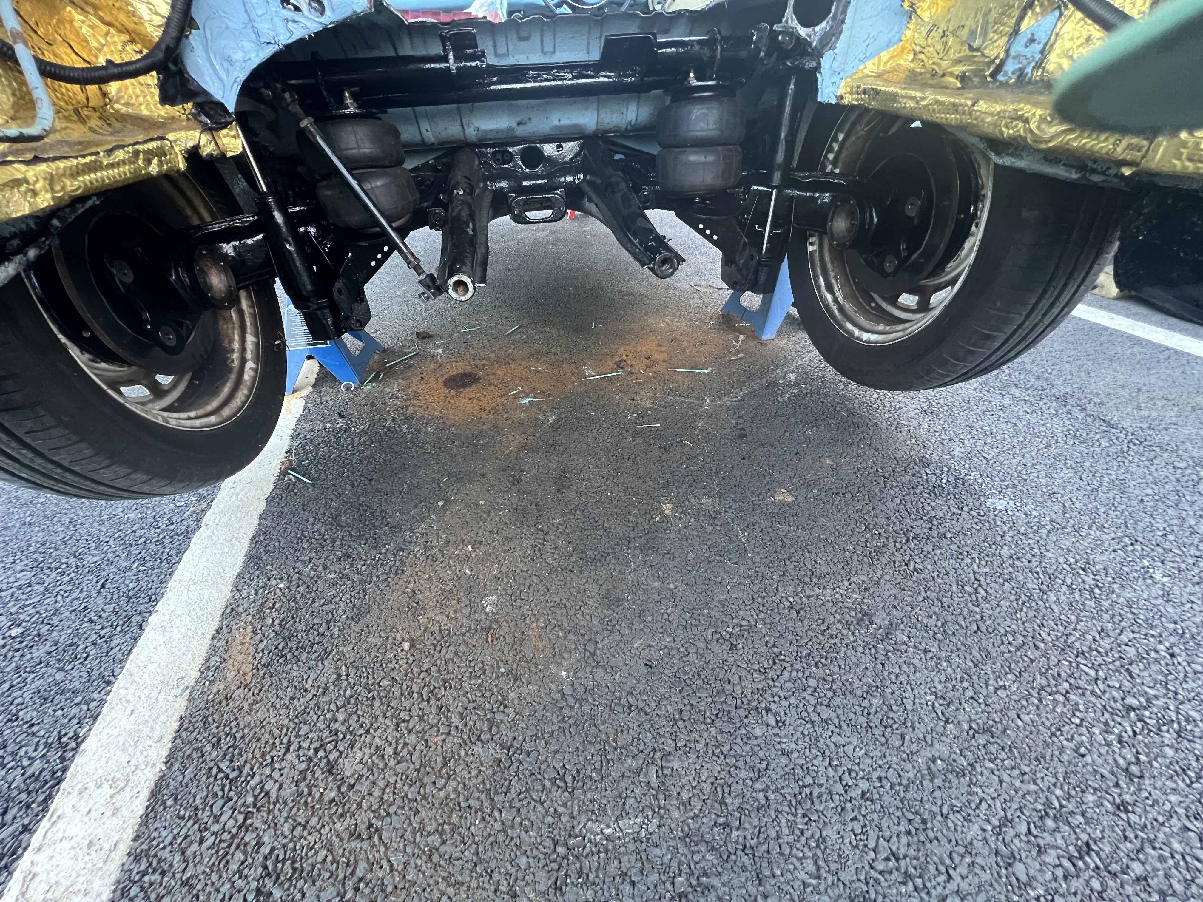

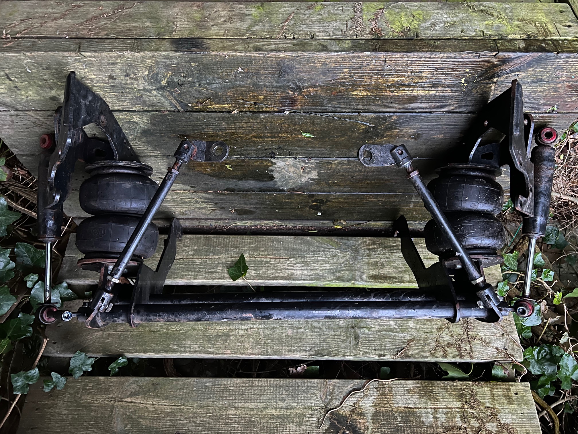

- Posts: 41
New Independent rear suspension and air bags are in
Engine mounts fitted to drive train
Drive shafts measured and sent off to the machine shop
Planning locations
