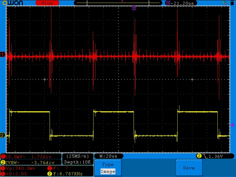

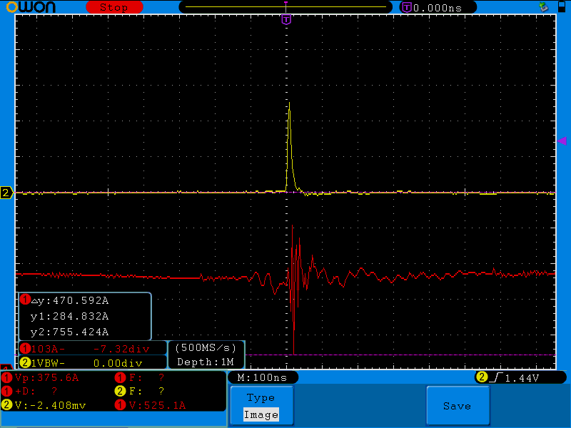

So took the inverter apart. Luckily I did not need to drain the cooling system.
There seems to be quite a lot of switch ringing on the current waveform. 150mV equates to 45A
measurement setup
measurement setup
Red: current sensor signal Yellow: is ch3 PWM (for timing)
Overview
Overview
zoomed in
zoomed in
after voltage divider
Have tried adding a capacitor before the voltage divider/input filter (as on the first picture). That didn't do much.
Thinking about adding a chip bead ferrite inline. Need to find one with that works on the 26MHz most are 100MHz or higher
Don't think that I can do something about the origin of the noise.

Before that i got the chip bead ferrite installed on the inverter board. Went for the MMZ1608S202ATD25 from TDK.
After some initial testing it looked to good to be true so I soldered a small wire across the bead, So I can measure in one setup, without and with the bead ferrite active. By simple cutting the wire.
So it suppressed the noise a lot. So I was hopeful that this solved the issue but sadly it did not. Still happy I "fixed" this.

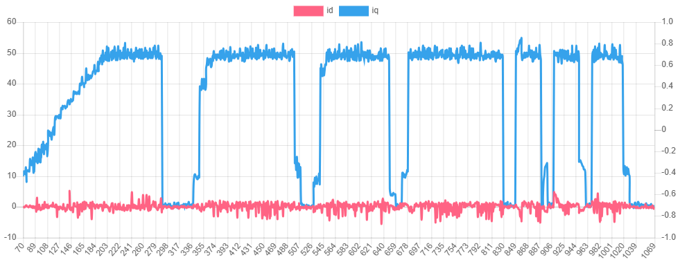

Did some testing in the garage because the weather is not compatible with driving with the hood up and a scope in there.
Set the throtcur to 0.5 and the I can go full throttle and slowly accelerate and then break before smashing in to the work bench.
So throtcur at 0.5 at 100% throttle 50A produces 107 peak to peak(probably, the current clamp is a cheap one. Hantek CC-650)
After looking at this I remembered that I have the MTPA parameters set so this may change things.
Took a plot on the web interface.
So at 50A throttle Iq is 50A and there is some Id current resulting in the 107Ap/p on the scope.
To answer my own question:
manny wrote: Tue Apr 15, 2025 8:51 am Is this peak or RMS?
~Peak, but with some Id current. peak = sqrt(Iq²+Id²)
This all seems fine. Hopefully the weather will cooperate this weekend to do some testing on the driveway and get a scope shot when the overcurrent occurs. To see if there is something strange going on or if it's just noise/trigger happy overcurrent comparator.
