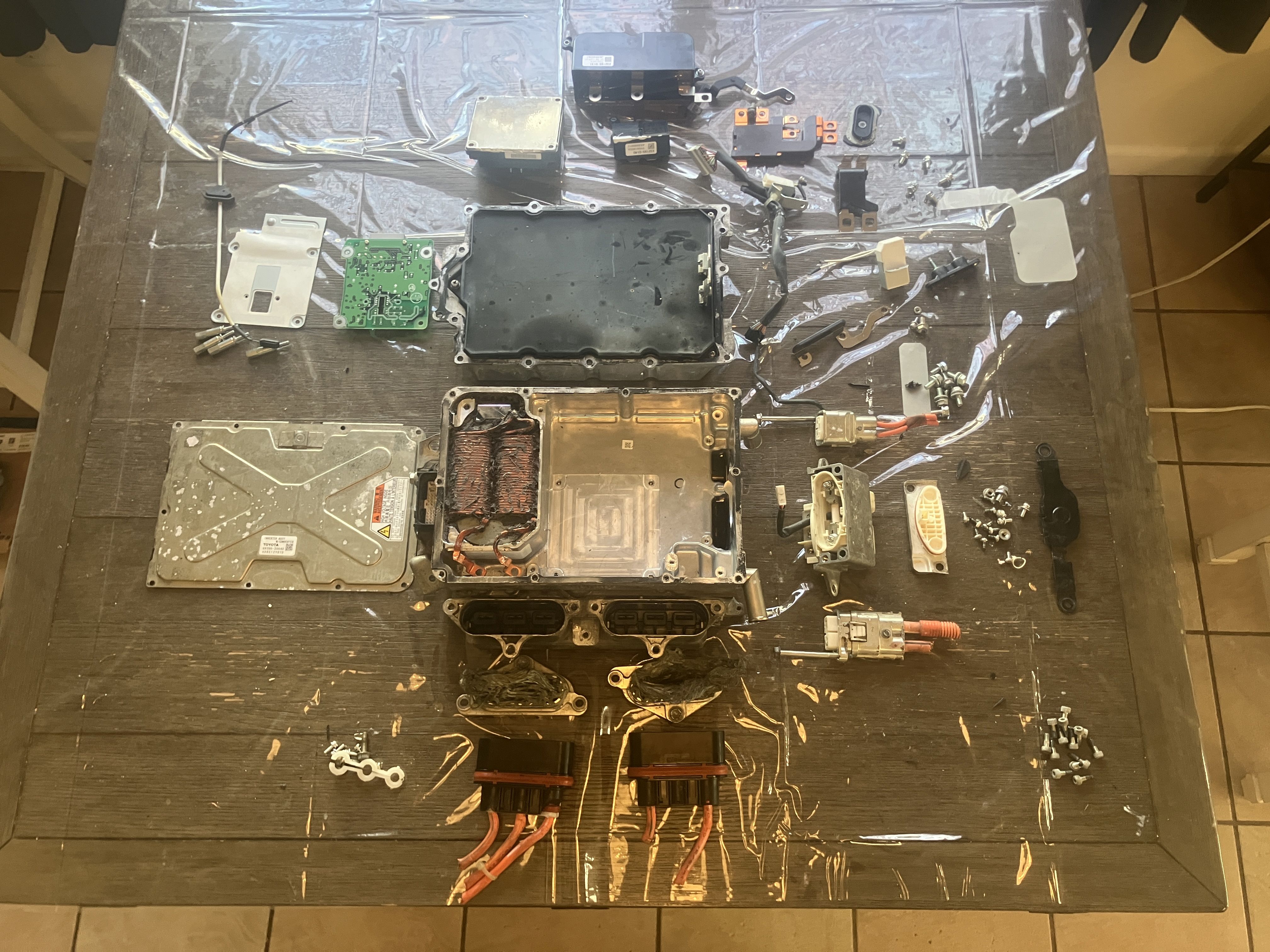

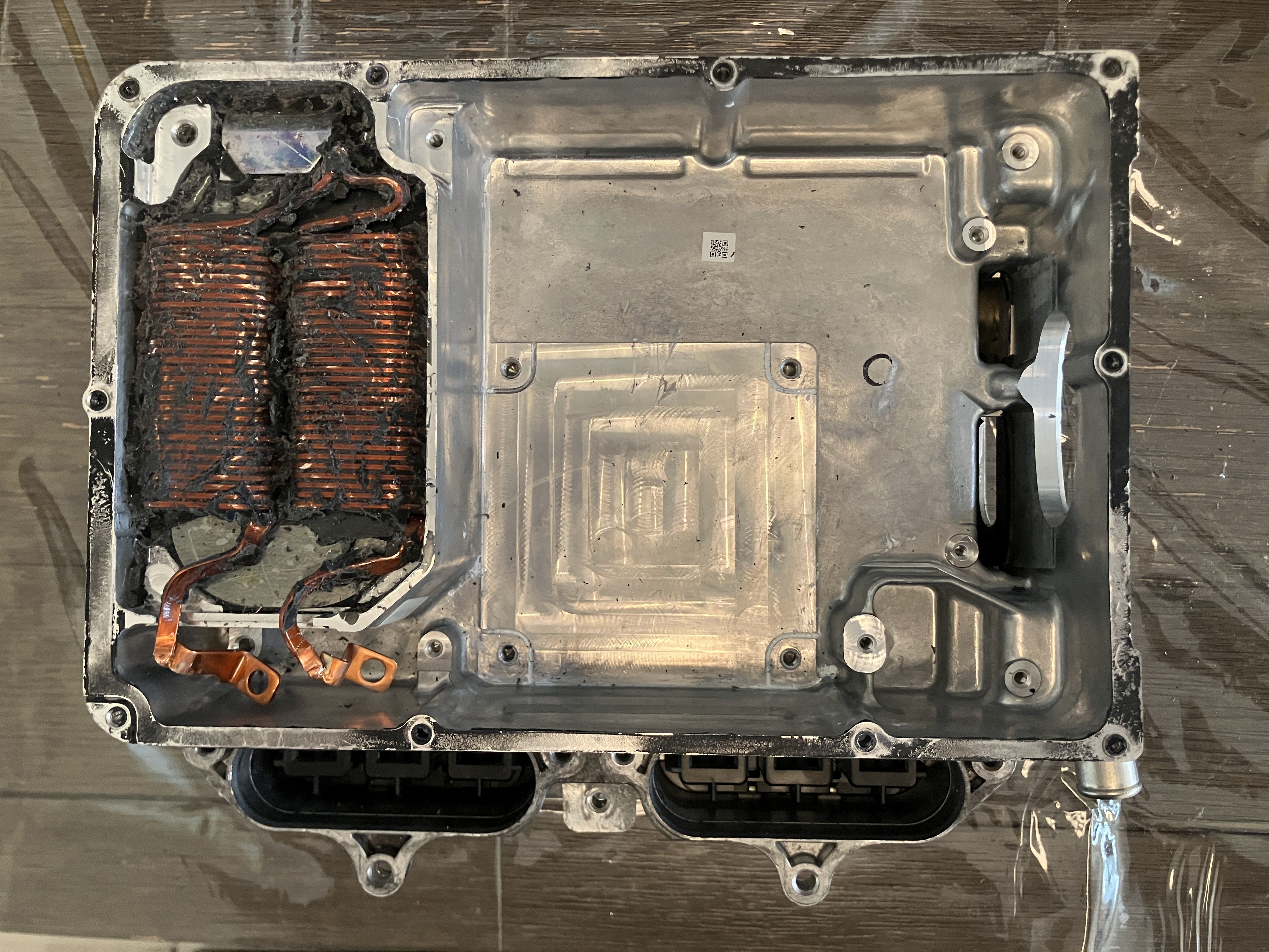

Lexus GS450h Inverter DC DC Converter Delete
hope some of you find this useful, I did not want to burry it in my truck build thread or any of the deep inverter support threads
please post your ideas of what you would use this empty cavity for

Re: Lexus GS450h Inverter DC DC Converter Delete
i do not recommend gutting the dc-dc as you loose an important spot value invudc aka inverter voltage reading
I have a question arising from this teardown:
As we're putting the battery connection directly into the inverter on the terminals behind the plastic cover, doesn't the existence of those thin busbars mean that the battery voltage is also applied to the DC-DC?
I thought, applying battery voltage there would blow the unit. Are we deleting the busbars or leaving them in?
Ok. Just rewatched Damien's connection video again (must be 4 times now but it's like a good movie; you notice things you didn't get from the last watch every time).nino500 wrote: ↑Fri Apr 24, 2026 4:39 pm I have a question arising from this teardown:
Thanks.
I see now that the busbars remain in place and they're not a direct parallel connection to the boost converter input.
