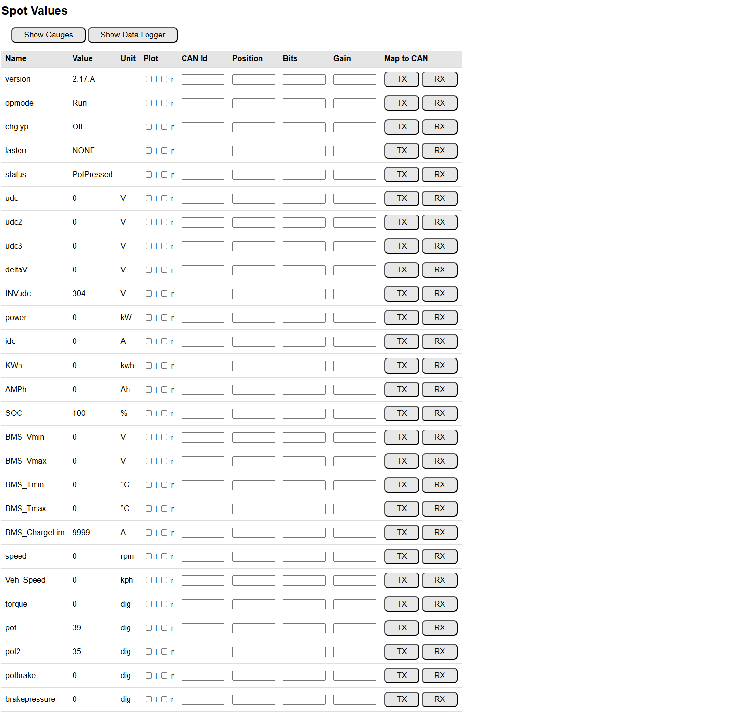

Re: Leaf First Spin Parameter Help
Here's the params file, and 2 can logs, plus an image of some spot values.
For inverter selection, I have Leaf gen 1. From what I've read I know the zombie works with other leaf gens, and I just assumed this was the correct setting. Is that right?
Thanks for taking a look!

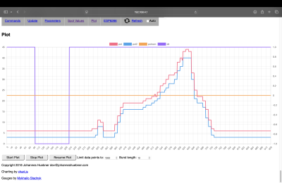

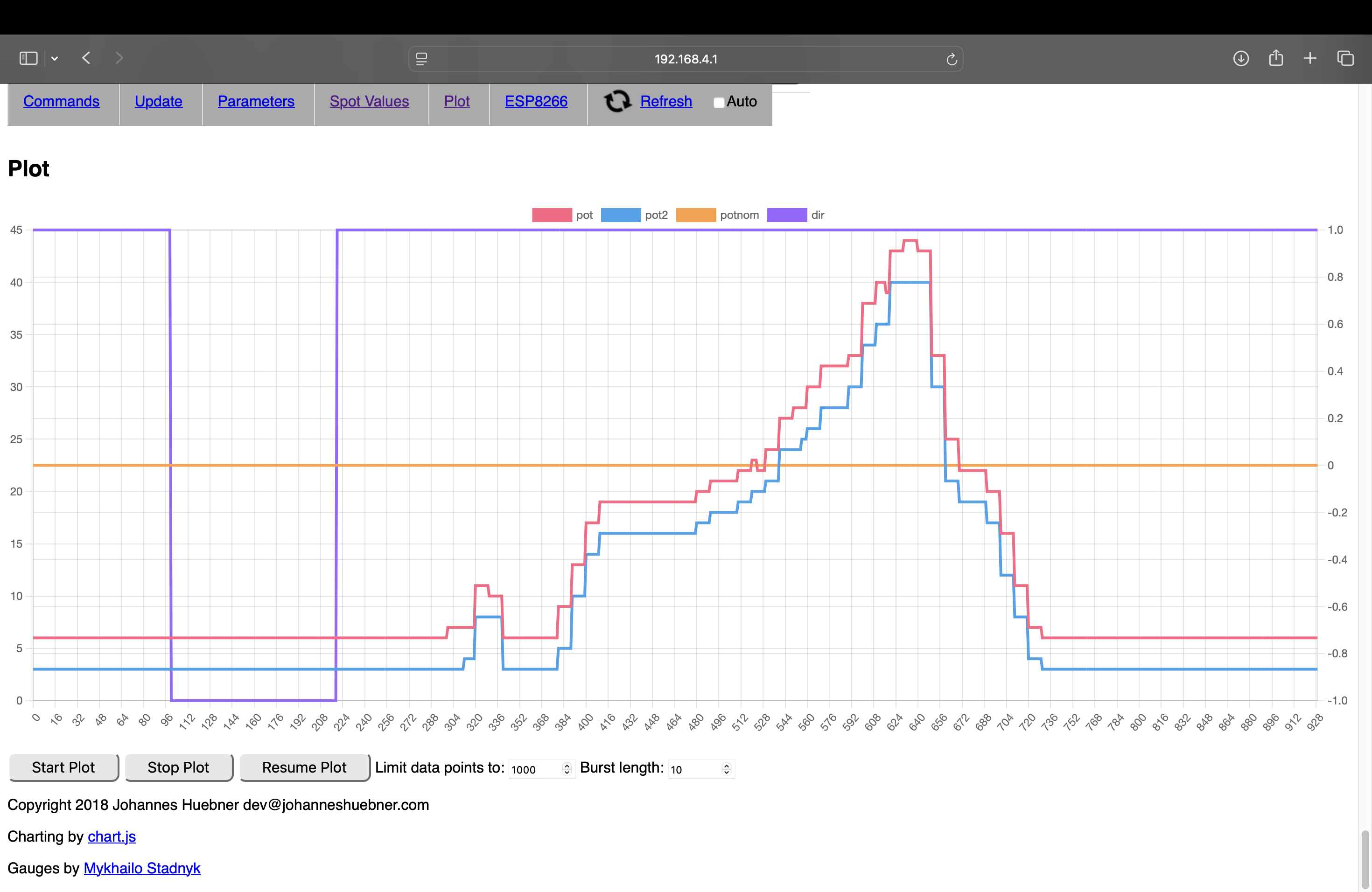

plot.
L- pot 1
R- potnom and dir
start plot
select dir to forward
increase throttle
Screenshot and share please.
L- pot 1
R- potnom and dir
start plot
increase throttle

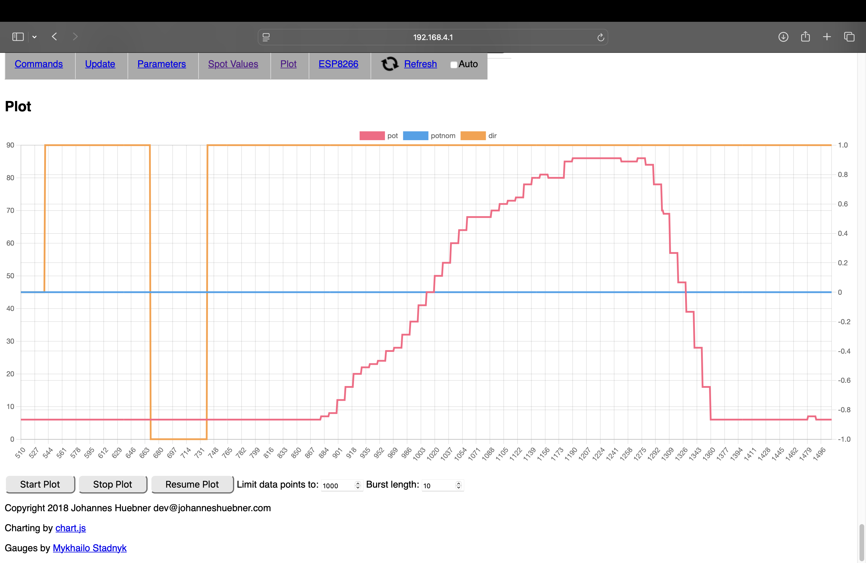

Here's the files. Interestingly the potnom didn't move. I don't know enough to know why it didn't move with the pot values. I'm assuming potnom means pot nominal... the value to use if both the pots pass redundancy checks? IDK. I'm going to go look it up.
Calibrate your throttle first then come back.
You are getting very very low changes in throttle compared to your declared range.
OK, I found the problem this morning. I used parts I had around to build my little control box, and turns out the pot was logarithmic, from an old audio project. So, max it was 3100, but turned half way was still only about 50. So, it was in the thotdead (potnom < %10) zone for most of the pot range.
I calibrated the pot settings to only use the first half of the pot range, and got the motor to spin as expected. So, proof of concept done. Now we're on to cleanup the test setup and think about the real configuration.
