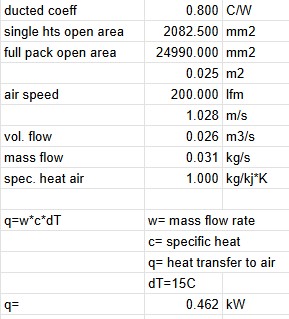

Might ditch liquid cooling! I've always thought air cooling would be better for most EV conversions, and after realizing the cost and complexity of custom liquid cooling I started thinking about switching to air again. Another thread had some very useful data to show thermal behavior of batteries during driving and charging, which increased my confidence too. I pulled a couple muscles in my brain trying to do math, but it seems air cooling will be "good enough" for my project. If anyone wants to check my numbers or see how i did it i'll attempt to write it up below.
i started with the heat generated in the battery pack based on cell resistance as described in another thread on here, and copied their values for resistance since i don't know mine yet.
on a 100deg day you can't really cool the pack below it's max temp so you just have to keep the charge rate below 20kW. on an 80F/27C day it looks like a little bit of cooling will allow me to charge at 50kW. That feels like a reasonable set up for me.
next: find a heatsink that fits my pack and see if it can take out 129W from the pack on an 80F day.
heatsink: https://www.digikey.com/en/products/det ... R0/5848416
3 of these will fit well under a 4-pack of my hyundai modules. i'm trying to keep 4 packs because they fit well under my car and i'll be able to reuse all the BMS slave wiring if i do.
datasheet claims R=.8C/W when ducted at 200LFM so i'm going to see how much heat is transferred to the air at that flowrate on a hot summer day doing 50kW charging.
The equation Q=w*c*dT where Q us heat transfer, w is mass flow rate, and c is specific heat of air is used.
- mass flow rate is found from 200LFM and the open cross sectional area of the heatsink.
- dT is 42C (max battery temp from the other thread) - 27C (hot summer day) = 15C
- gives 450W of heat transfer out of the whole pack. This is not a conservative estimate and I plan to adjust the variables as i find better info for them, but 500W compared to the 129W targeted tells me there is margin for this type of forced air cooling directly on the packs!

cajamatt wrote: Fri May 30, 2025 2:00 am Might ditch liquid cooling! I've always thought air cooling would be better for most EV conversions, and after realizing the cost and complexity of custom liquid cooling I started thinking about switching to air again.
Far away from it but I have this idea of internal air cooling in my mind for a battery box in the engine bay. Find a space for a radiator and internal fan(s) and have gaps around the modules so the air reaches them from all sides. The rad's connectors can go outside the wall so very little risk of water ingress and cooled nicely by the "big" radiator in front. Might even reverse air flow during charging to blow heat out front to have the pack's wall cooled by ambient air as well.
