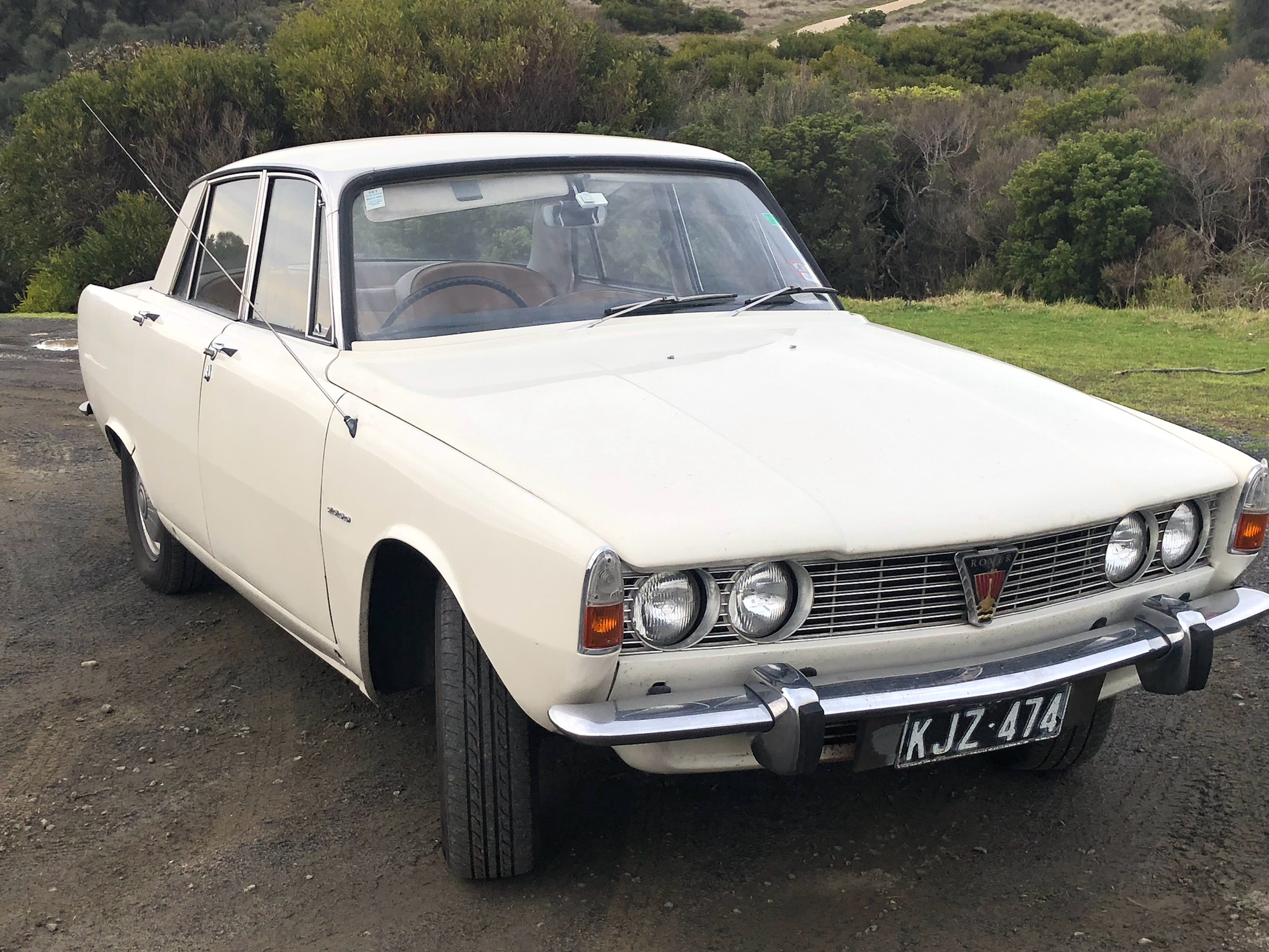

Picture of car attached. I typed the diff ratio incorrectly. It is 1:3.54. I want to get at least 150 km on it. Batteries will be 16 CALB Modules for a total of 35kWh. Sounds like power wont be an issue but I havent seen any posts about top speed with the GS300. I’m aiming for highway driving at 100kmh. Occasional 110-120kmh would be nice.

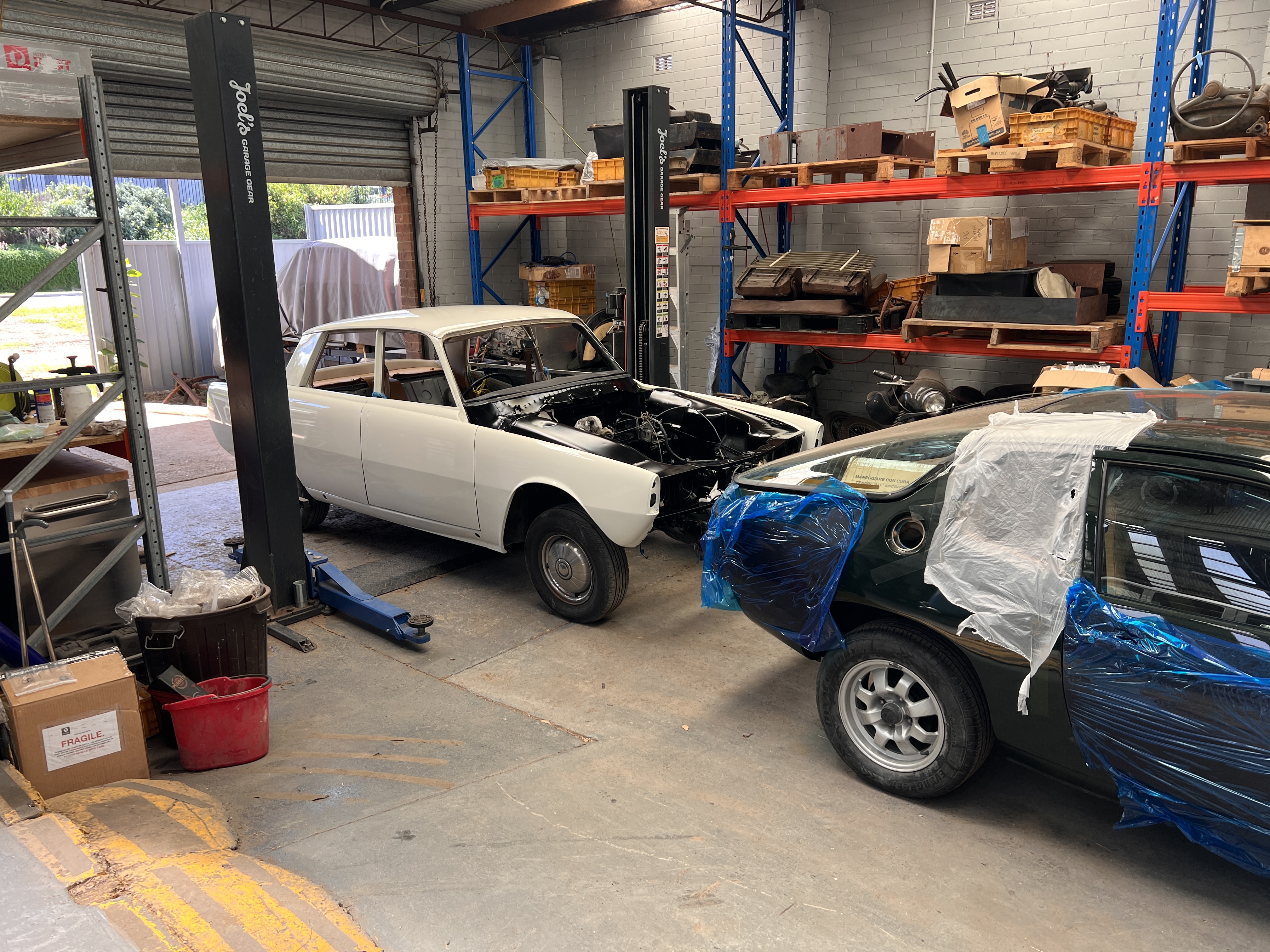

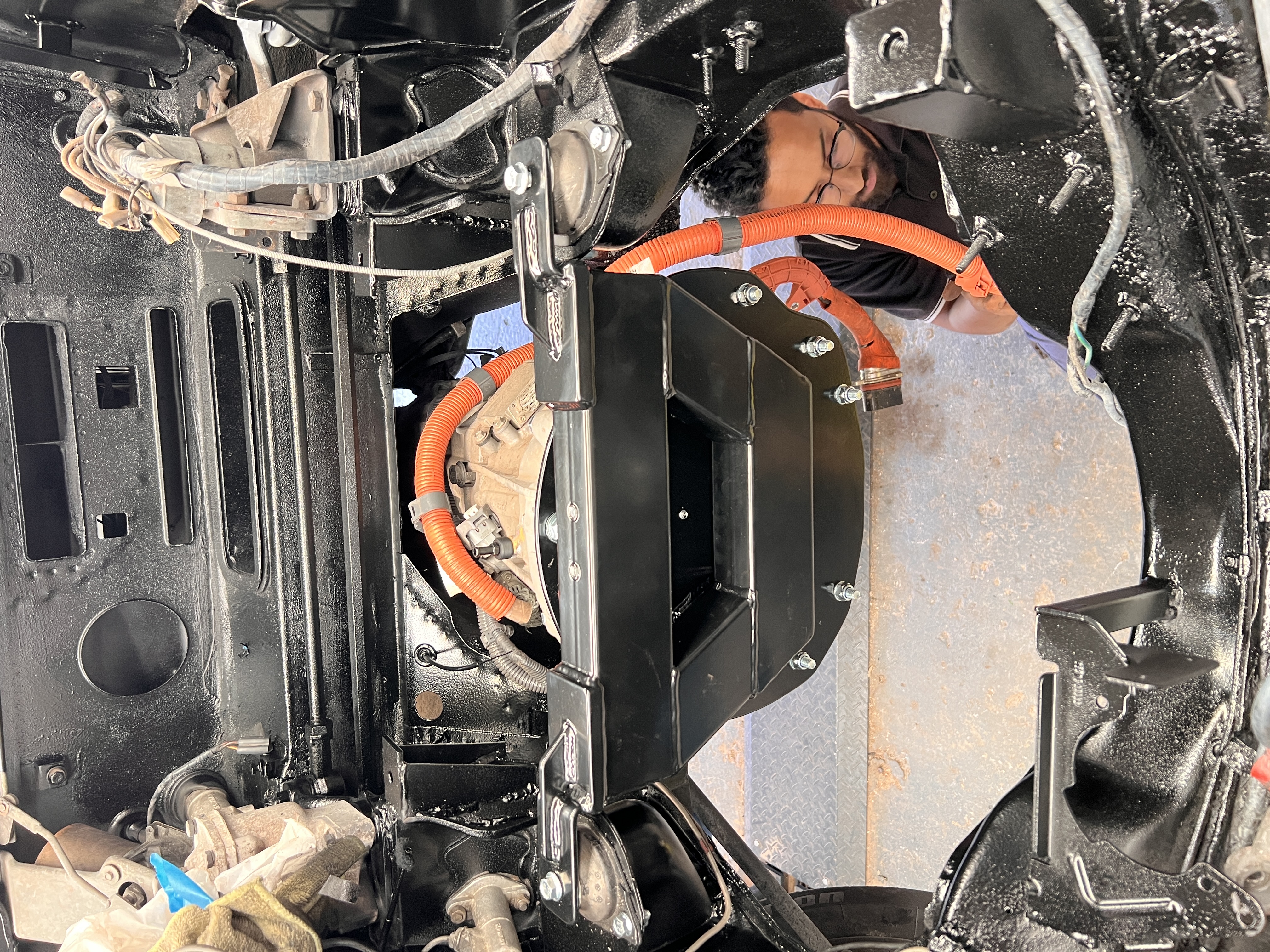

Progress report:
Back from the painter last week. GS450h installed along with modified drive shaft.
