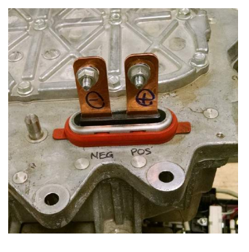

You can always use multimeter diode check.
One polarity will show a diode forward voltage of 0.3 to 1.2V depending on the inverter. This is the reverse polarity and will be a short circuit if you connect the battery this way.
The other polarity will show open circuit after a second of charging the capacitor first. This is the correct polarity for connecting the inverter to a battery.
Measure both ways, make sure you can see both cases and mark accordingly.

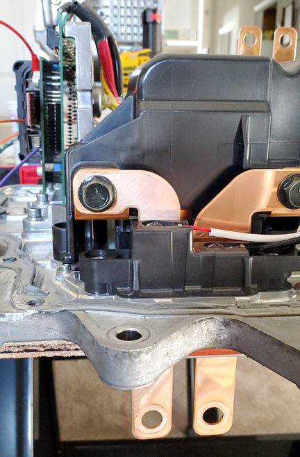

That having been said, on the leaf gen2 inverter positive is the one closer to the side, farther from the cooling port. But you don't need to ask.

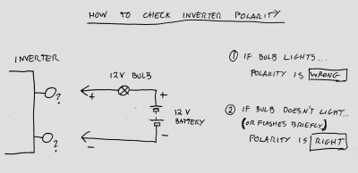

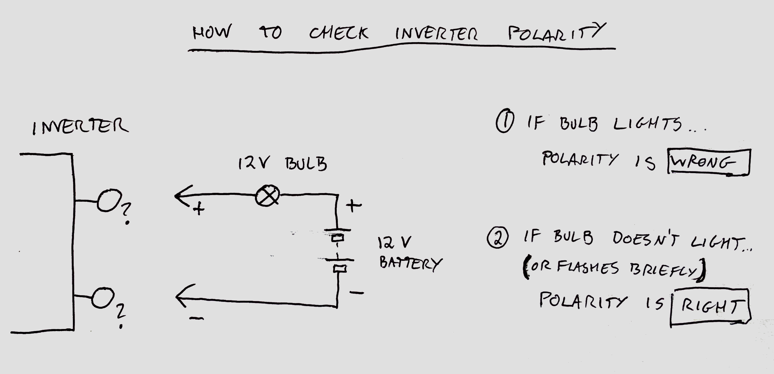

On the course, Damien taught us how to check with a bulb & battery.
A picture might help - hopefully I've got this right!

Image taken from different site
- leaf polarity 1.png (188.03 KiB) Viewed 9781 times
doobedoobedo
- Posts: 264
- Location: UK
Re: Leaf Invertor DC connections
I can vouch for this being correct. I put similar markings on mine.

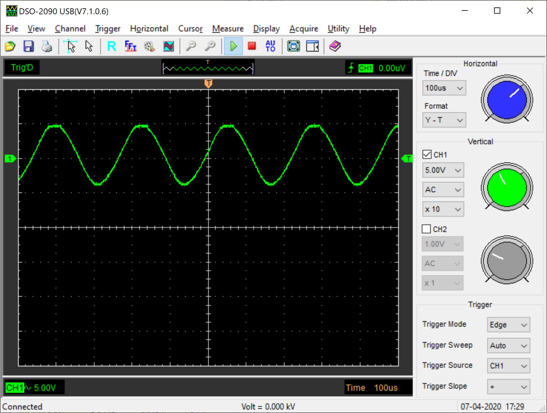

!EX = GND so yet can scope EX to ground. You should see a 4.4kHz sine with 9V peak-peak amplitude.

I think it's my resolver wiring.
EX Signal looks good.

Yes looks fine to me. What do you get on the sin/cos return lines? Be aware amplitude will change here as you turn the shaft.
