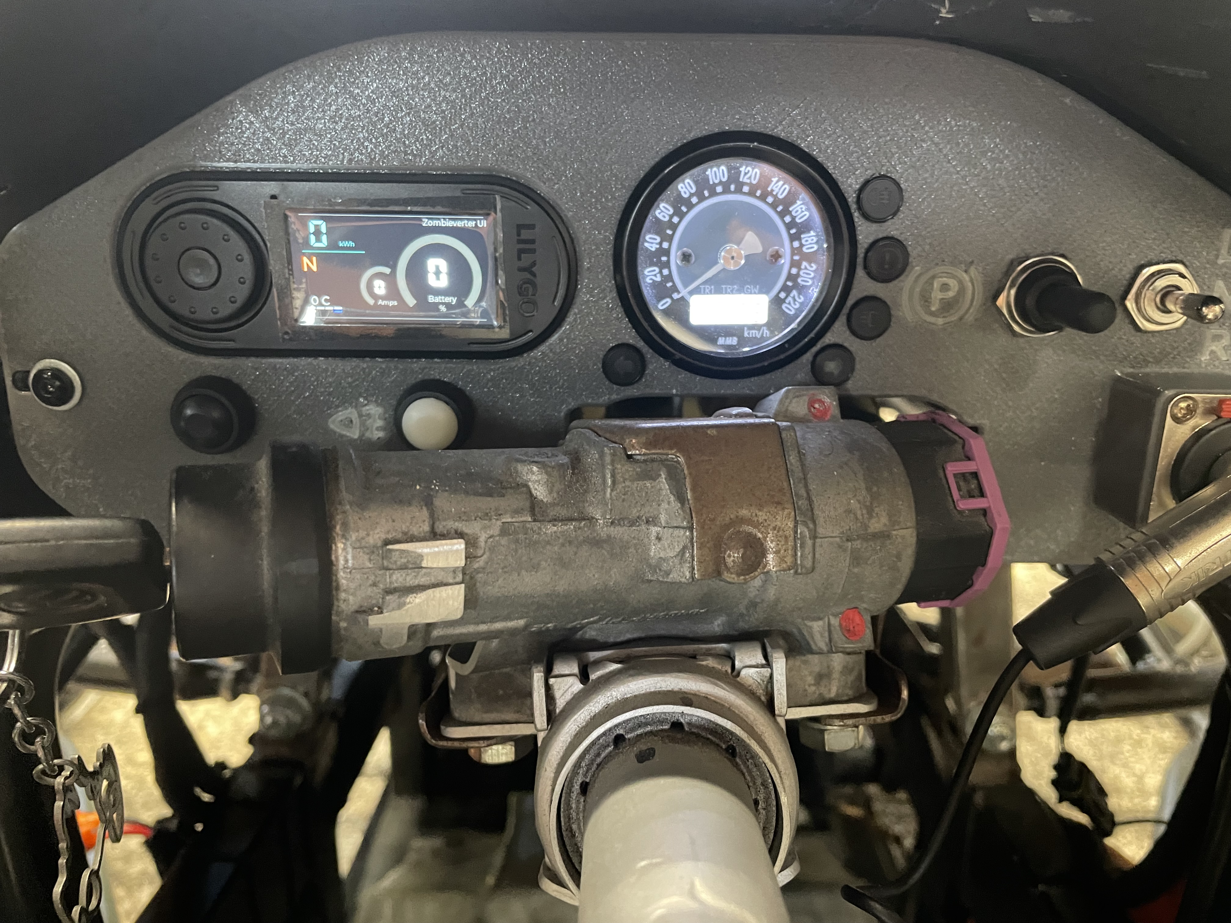

I've been working on a cut down interface for ZombieVerter that runs on a Lilygo T-Embed device. It also allows for setting of some parameters. More will be added.
This uses Can SDO to send and request values from ZombieVerter. To Edit a value, click the central button once, rotate the rotary clicker and double click once on the desired new value.
https://github.com/jamiejones85/ZombieVerterDisplay

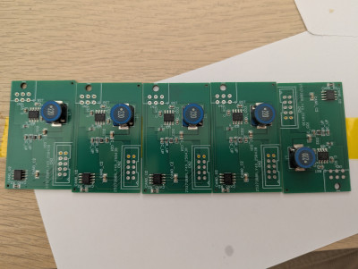

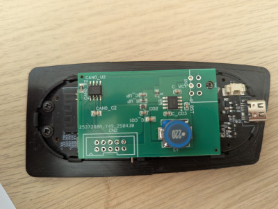

You will need to add a can bus transceiver, I've designed a backpack board that will give the can bus and 12V input, I will update with the design files once tested.

The can bus and power supply boards arrived and working. I can order another batch of there's any interest

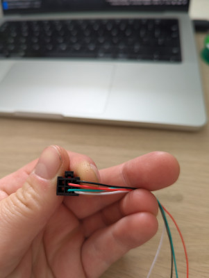

The TFT_eSPI library is a pain unfortunately. I've attached my lv_conf.h
Red is 12v, black is ground. Green is Can L and While Can H.
I don't have any more boards left from the first run, but if there's interest I can get some more made up.

Got 5 of the boards available now if anyone wants one, PM me to sort out. Asking £20 for them
