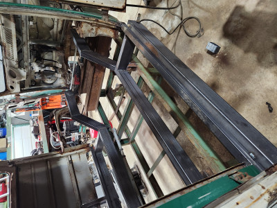

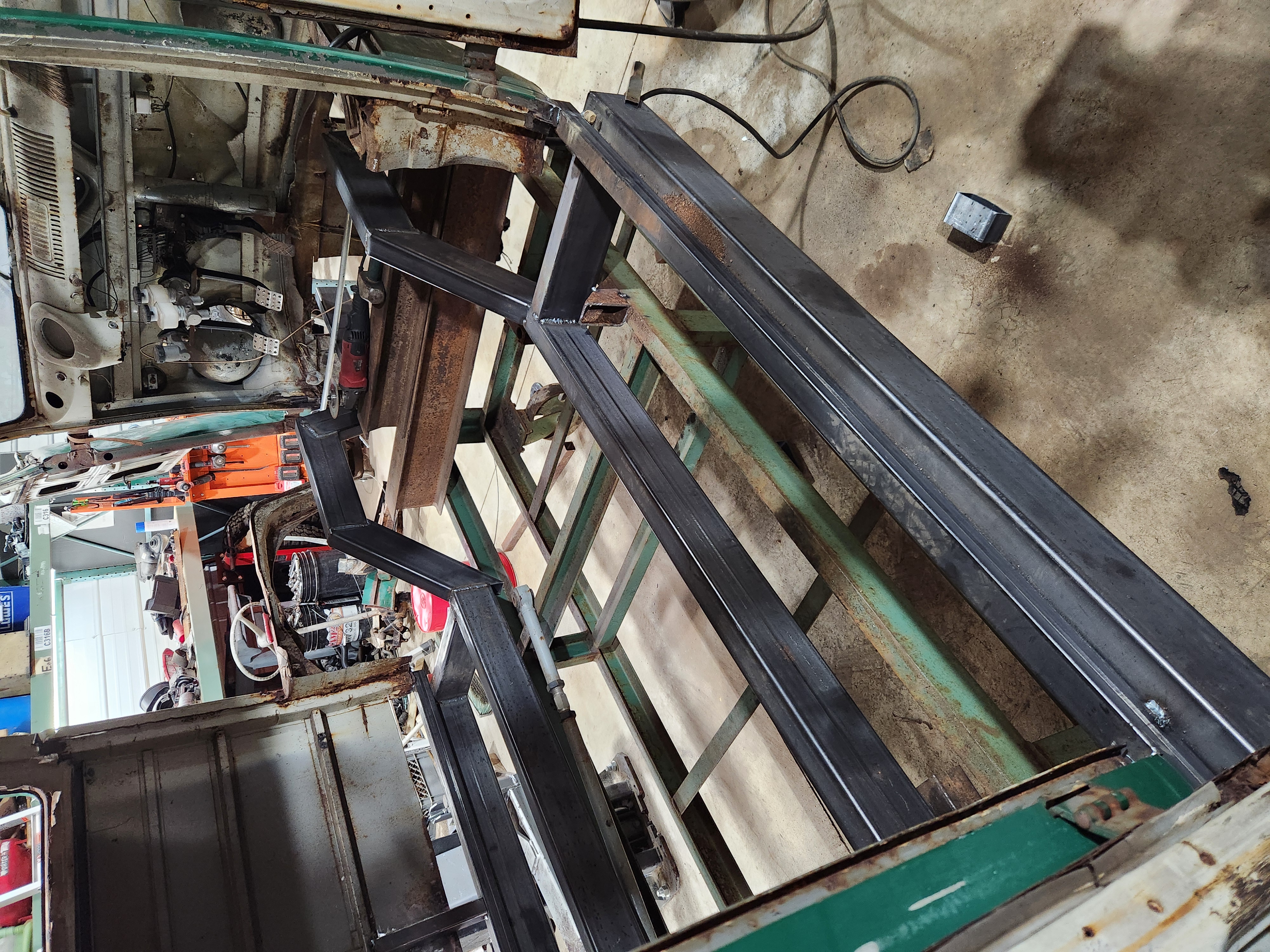

Hello all. I had this in getting started, but didn't get much traction, and some actual work is beginning to take place, so I guess I may as well start this
I am deep in the research phase of a pretty ambitious build. As a background, I have a background in ME, and understand the safety precautions, I have worked on 480v 3 phase equipment and retrofitted my fadal cnc mill with linux. So I'm not a rookie, but also can recognize dunning kruger and know I know nothing on this subject. I am fairly skilled with metal fabrication as well as experienced in suspension design, etc from the 4x4 world.
The vehicle is a derelict 1964 Vw bus that was abandoned in the woods of Minnesota and rescued by me in 2015. It was pretty toast to be a restoration candidate, so my original plan was to put a modern engine in it with a 4x4 drivetrain using a combination of jeep, toyota and jetta parts. So, I fabricated a full rectangular tube chassis and it became apparent that packaging was going to be an issue for my goal of actually using this as a camper. In the midst of this, I came to own a ford F150 hybrid for a while and fell in love with the off grid capabilities of the hybrid, especially when we were boondock camping.
I ran across https://forum.ih8mud.com/threads/1996-l ... t.1268985/, and decided that leaf power was maybe the way to go, so I've spent the last 3 months taking notes, reading, and in general realizing I know nothing.
As of now I plan to mate a leaf motor to a transfer case doubler made from a complete toyota case and a planetary from a jeep 241 case for gear reduction. Combined with 4.10 gear ratio axles and my planned tire size, it should put me at around 6200rpm at cruising speed, which seems ideal for a leaf. I originally wanted to build a pack using LFP batts from Battery hookup, but now the idea to buy a complete salvage 2018 Leaf ( I have a dealer license and buy a lot of cars from auction ) to get the gen2 110kw motor and 40kwh pack.
Additionally, I want to build a range extender on a trailer, using a VW tdi engine converted to mechanical pump, driving a second 80kw leaf motor with a 2:1 overdrive. I'm hoping to get 400 miles of range out of this setup, but calculating miles per kw is tough as is knowing exactly how much energy the leaf genset will make. I'm optimistic that the bus will consume .5kwh/mile.
Summary
  • 4x4 Vw bus with fully fabbed frame and toyota axles
  • gen2 em57 leaf motor mated to doubled gear reduction transfer case
  • 40kwh leaf pack, leaf bms, openinverter controls
  • trailer mounted tdi range extender with second em57
  • many hours of wiring and coding controllers
That's my idea thus far. A photo to whet the appetite...
