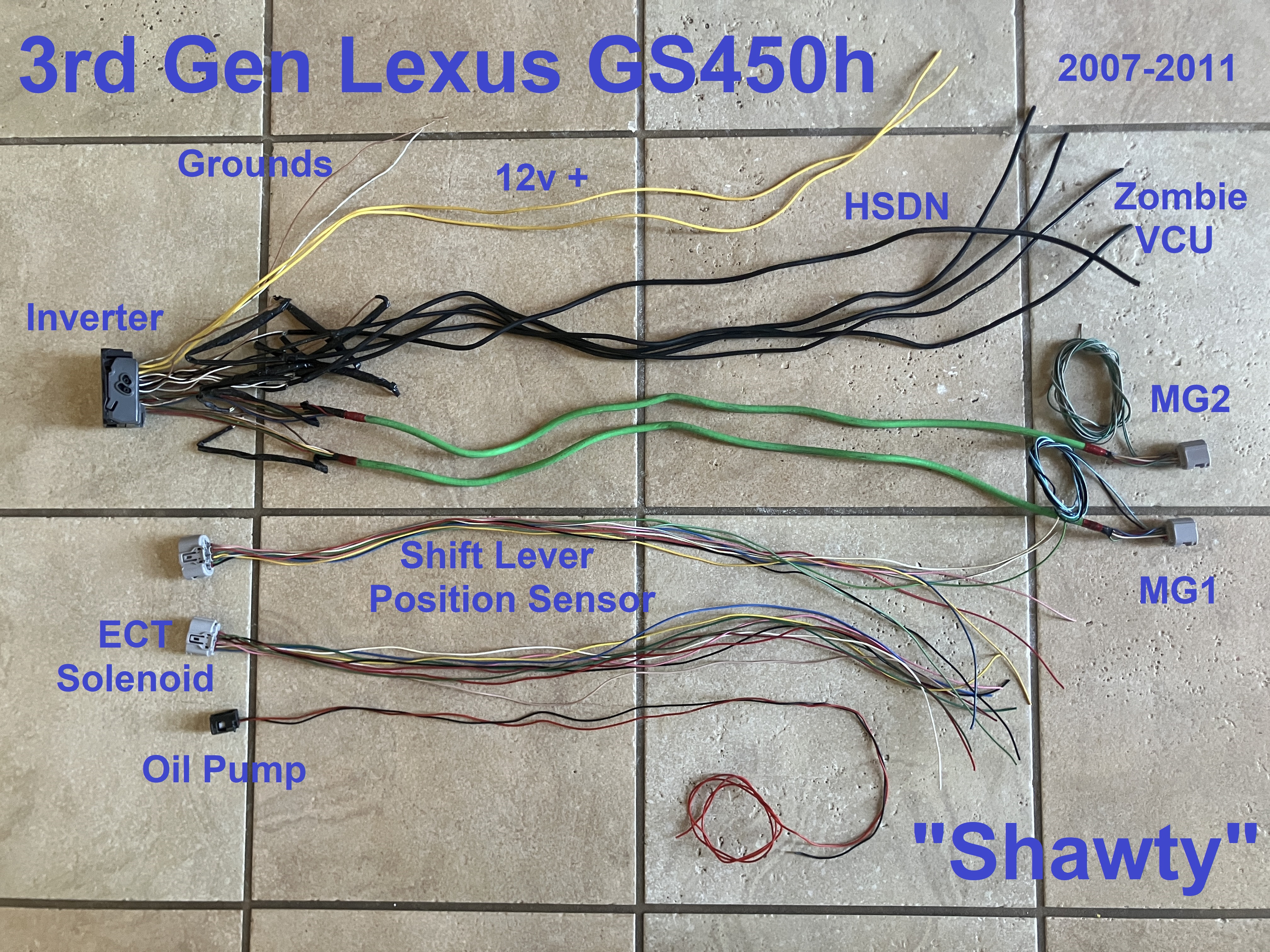

$150 - "Shawty" Lexus GS450h/LS600h Wire Harness (it's one or the other, as they are pinned differently)
Caution: this harness is short, may serve well as a test bench harness, or feel free to extend the wires yourself, or hewk maybe it will reach just fine depending on your component placement, please be aware the three foot long resolver cables (green ones in the pic) are the limiting factor and dictate the distance between the inverter and the transmission

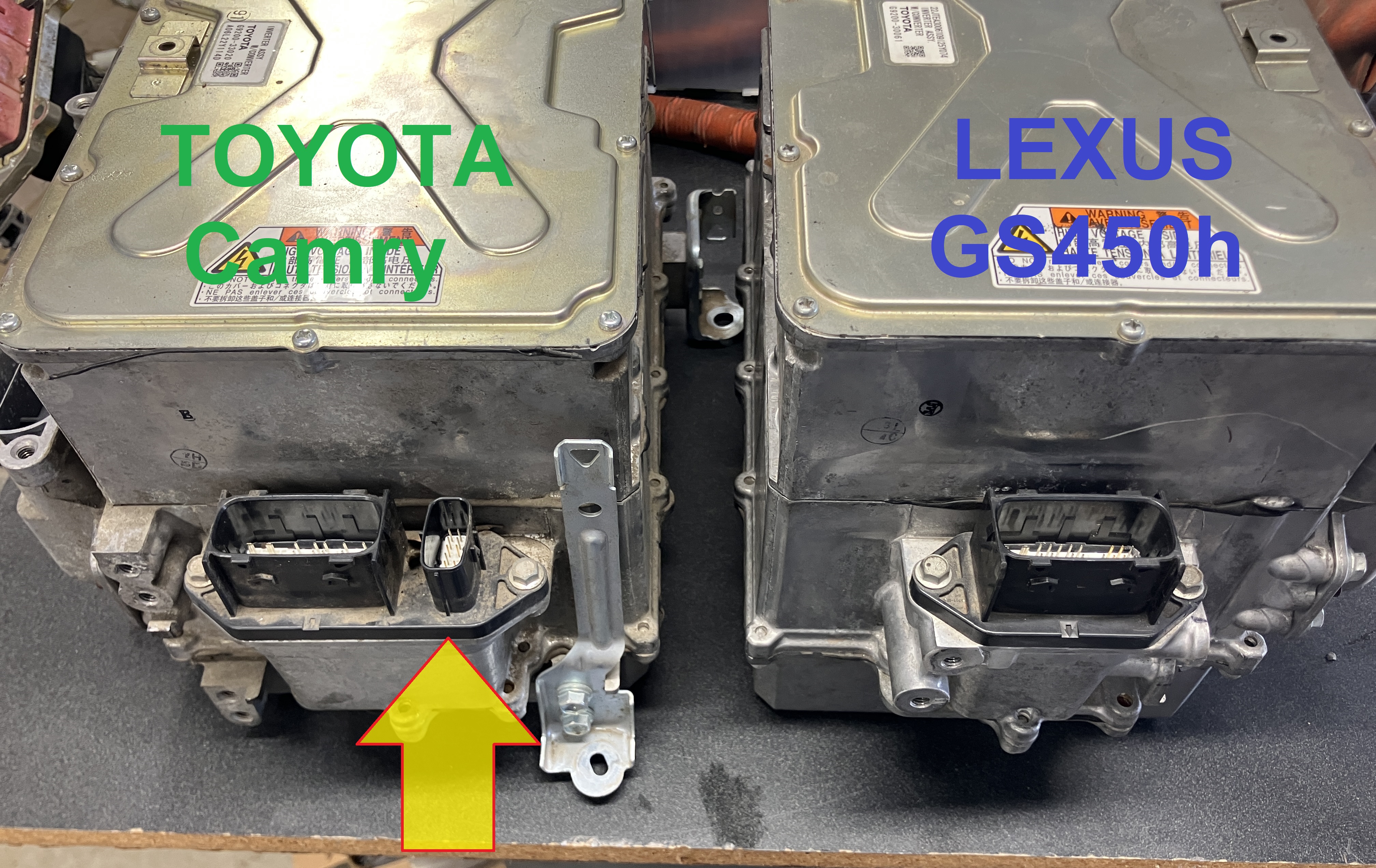

this one is primarily sourced from the 6th Gen (2007-2011) TOYOTA Camry Hybrid (though I end up pulling from at least two vehicles because one of the already short resolver cables is shorter than the other, so I only only keep the longer ones of the two) sourcing the resolver cables is difficult, sourcing the inverter full length harness is literally hell on wheels, here's a fun video of The Greg in the field:
How do I add value? well aside from getting my hands cut and sliced whilst pulling this junk for you in the snow and rain, I also end up repining the plugs for you as the Camry inverter connector splits the resolvers into their own section in a separate plug and the Lexus combines the two like so.
The transmission side MG1 and MG2 plugs are also different and therefor incompatible so I once again install the proper ones for you.

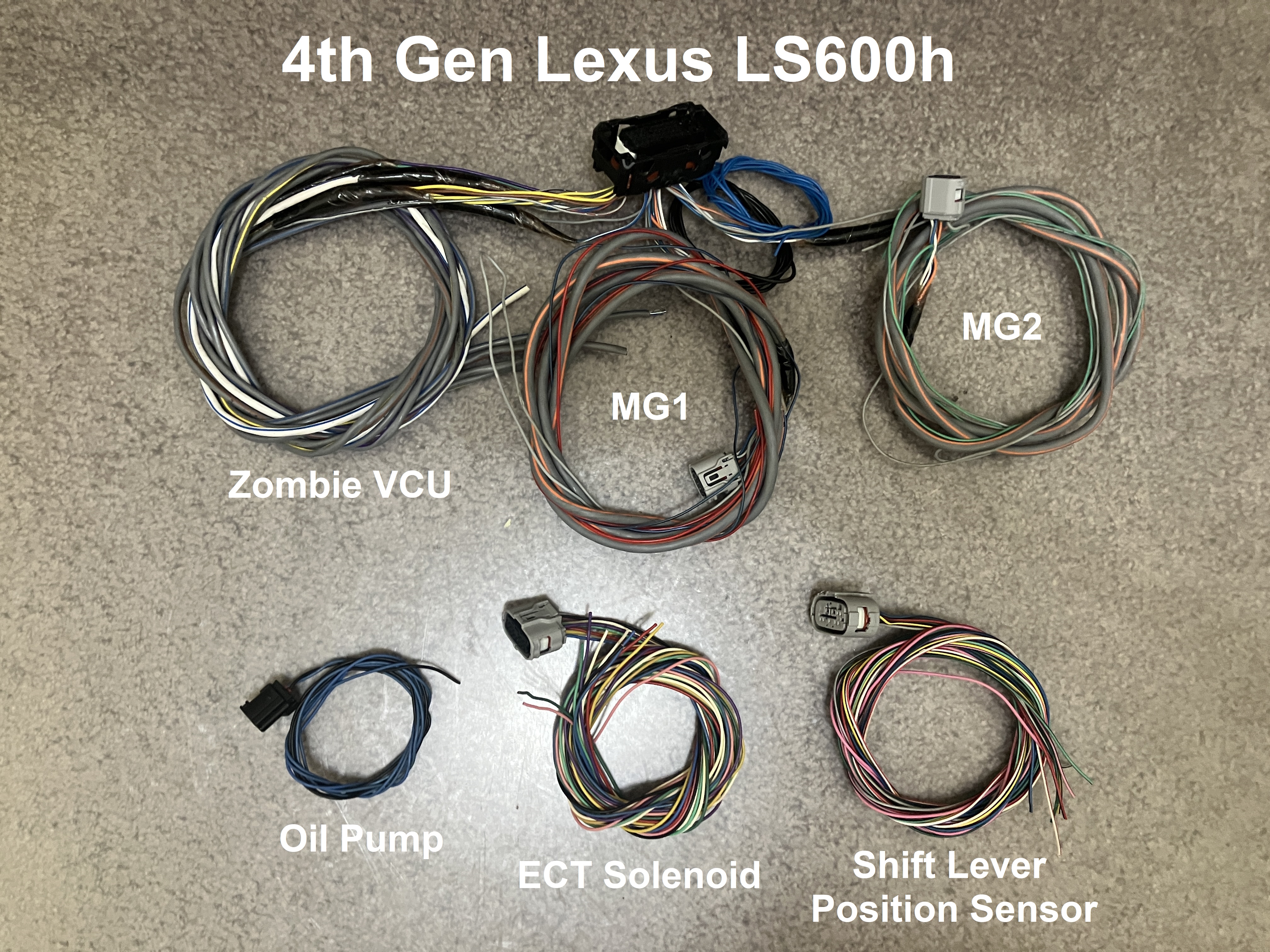

$250 - Lexus GS450h/LS600h Wire Harness (it's one or the other, as they are pinned differently)
the individual wires in the one pictured below have yet to be labeled

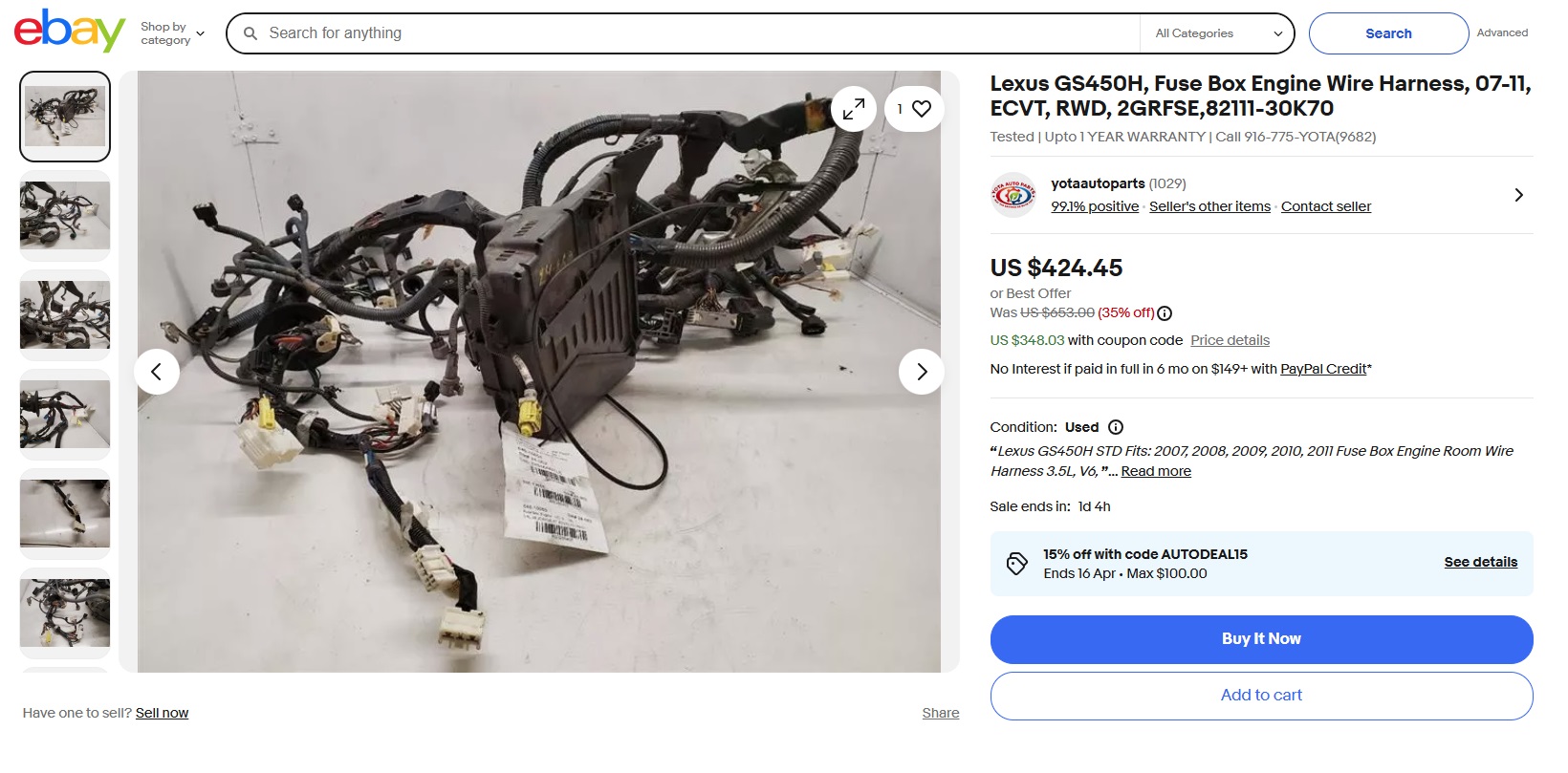

$350 - OEM Lexus GS450h Wire Harness
this one is comprised from two different thinned out Lexus OEM harnesses the super hard to find Engine harness ($450 on eBay plus $35 for shipping) and the Transmission harness ($250 on eBay plus $35 for shipping) to make one EV harness. You are unlikely to find the Engine harness for sale as it is the main huge wire harness that passes through the firewall and the entire car must be stripped out to get it out, hence the high price tag.
This is not my listing, I am just showing you what just the Engine harness goes for on eBay.

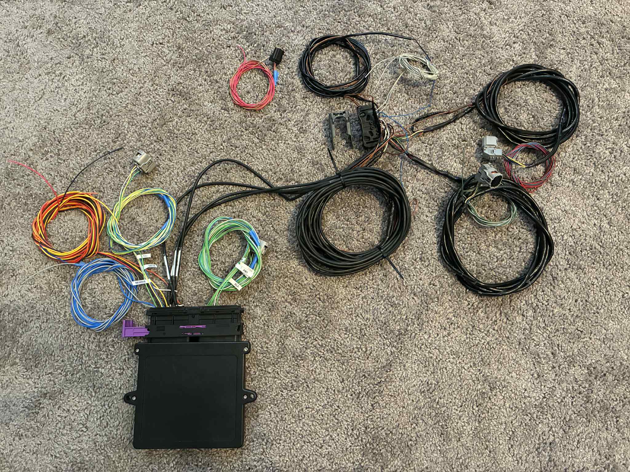

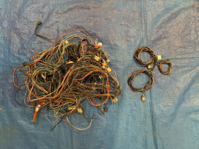

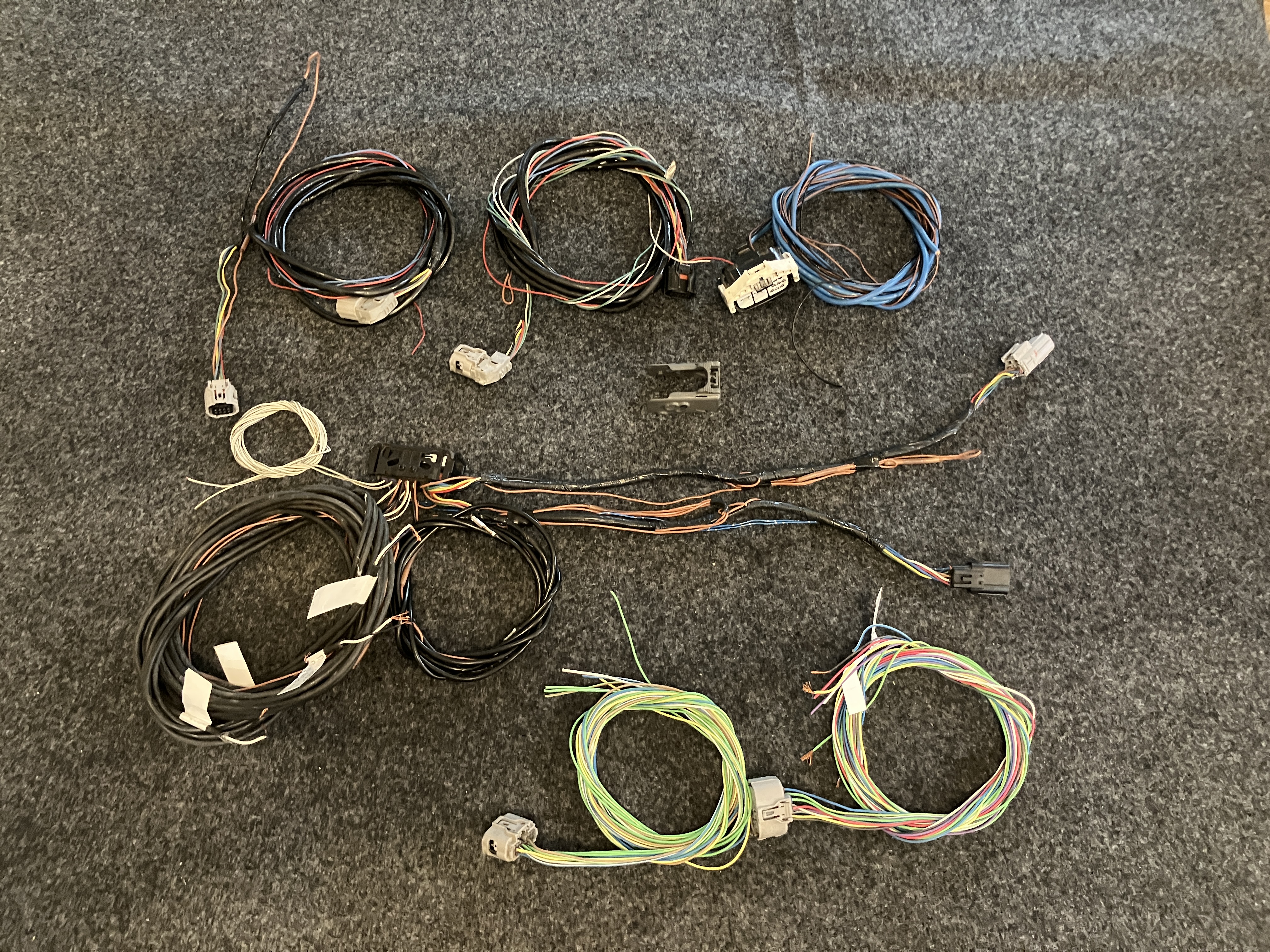

here I am thinning out a Lexus GS450h wire harness a customer sent me, this will eventually turn into a Kit for the Zombie VCU
slowly it's getting there, the vision is that you will receive everything except for the ZombieVerter VCU circuit board which you can obtain from EVBMW.com
this will be nicely loomed eventually
some time later.jpg (9.72 KiB) Viewed 4591 times

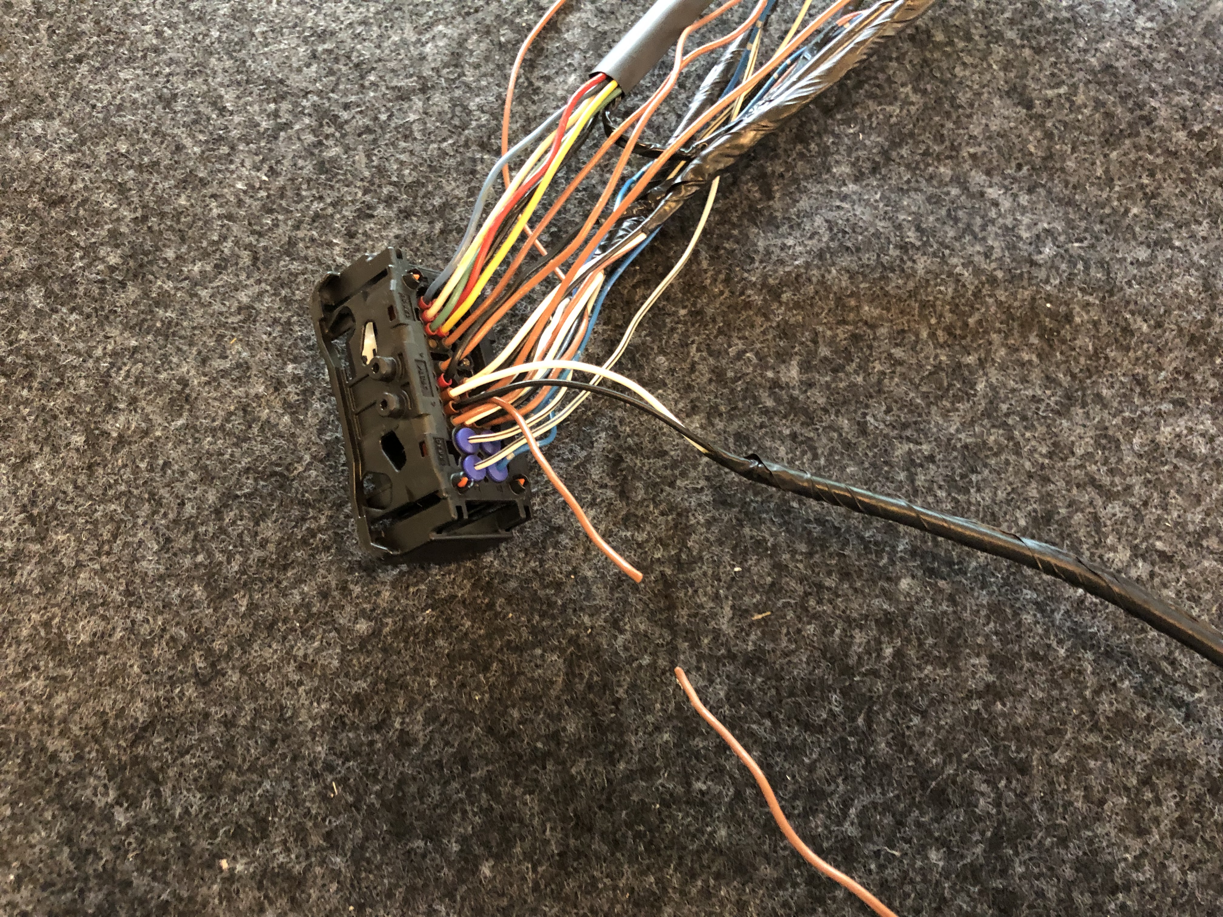

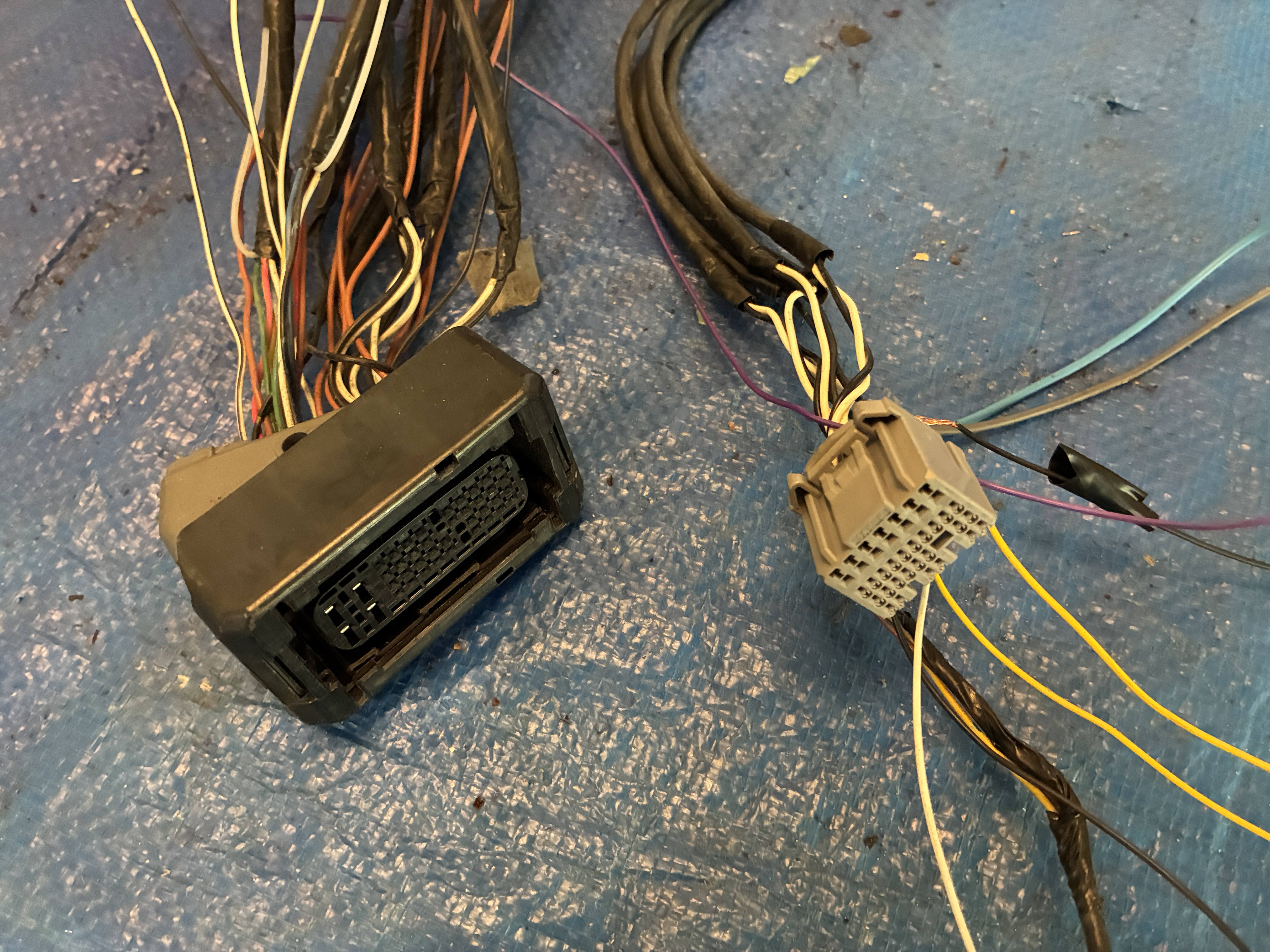

Good Enuff Quality Control - GEQC

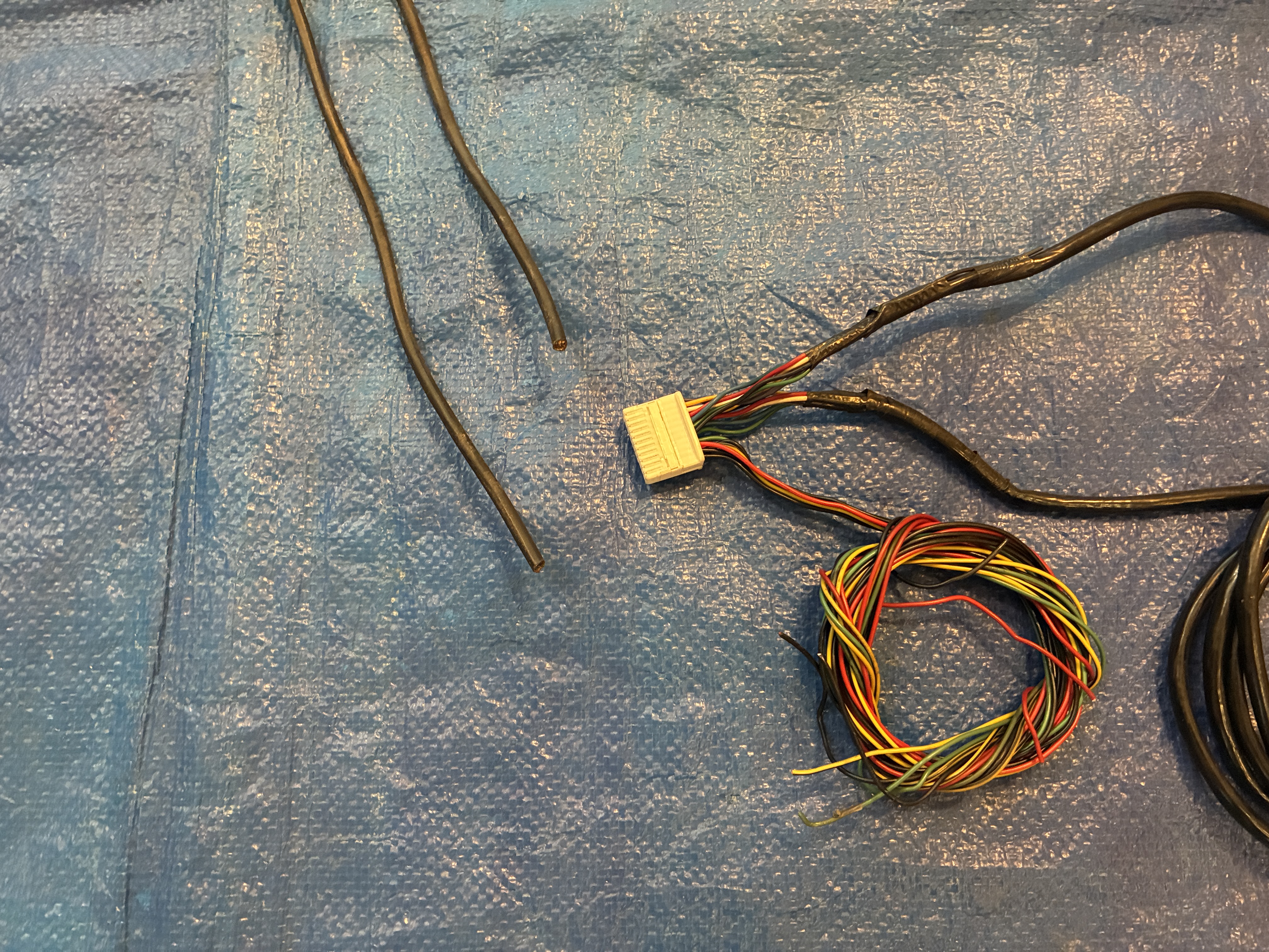

here's the types of things we catch as we use our eyes and hands to see things, can you imagine attempting the world speed record with a damaged ECT Solenoid (E83) wire
and here I caught a severed MTH sync serial shielding ground wire

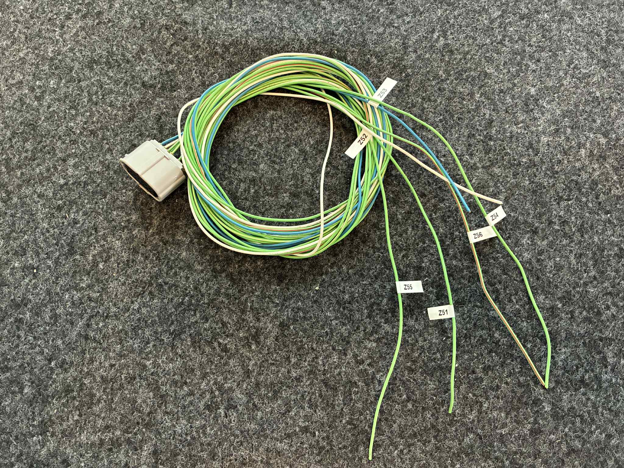

and here I am labalizing the sync serial cables
and the Motor Generator plugulators
for the wire harnesses that you will pin yourself I labelize each wire with the corresponding Zombie pin number, labeled ECT Solenoid harness shown below

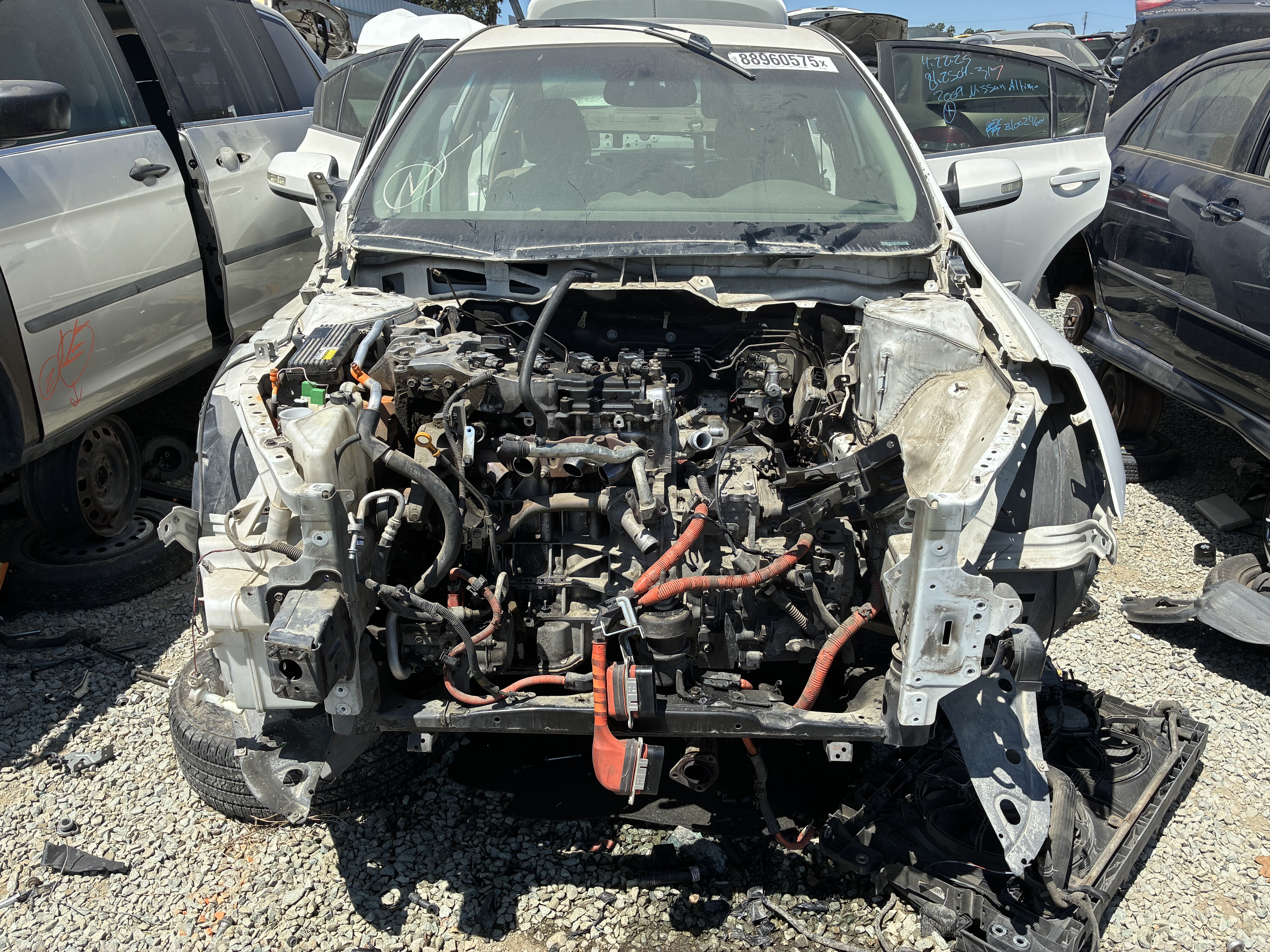

On this episode of How To Put Yourself Out of Business, I give away all my secrets on how I harvest all them parts for you
the 4th Generation Nissan Altima 2007-2012 has the same inverter plug as our beloved 3rd gen Lexus 2007-2011 (it is pinned differently but the plastic part be the same, if you follow, the resolvers also live on a separate connector but we'll get to that)
so my day begins at 0800 when Pick N Pull Opens and before I proceed to show you what the vehicle looks like when I find it as opposed to what it looks like 4 hours later when I leave it, let's level set.
Here are the things to keep in mind as you consider pulling these parts yourself, and I have gone through this myself so I am not trying to talk you out of it I just speak from experience.
1. Do you have a junkyard in your area that allows YOU to pull your own parts? Yes or No
2. Do they have the car you need? Yes or No
3. More importantly is the part you need still there, or did someone already pull it, or is it broken? Some yards have an online inventory system but it only shows you when the car arrived and not what's been already sold, this is quite annoying, see my I drove 3 hours for a Lexus inverter, only to find it was no longer there video:

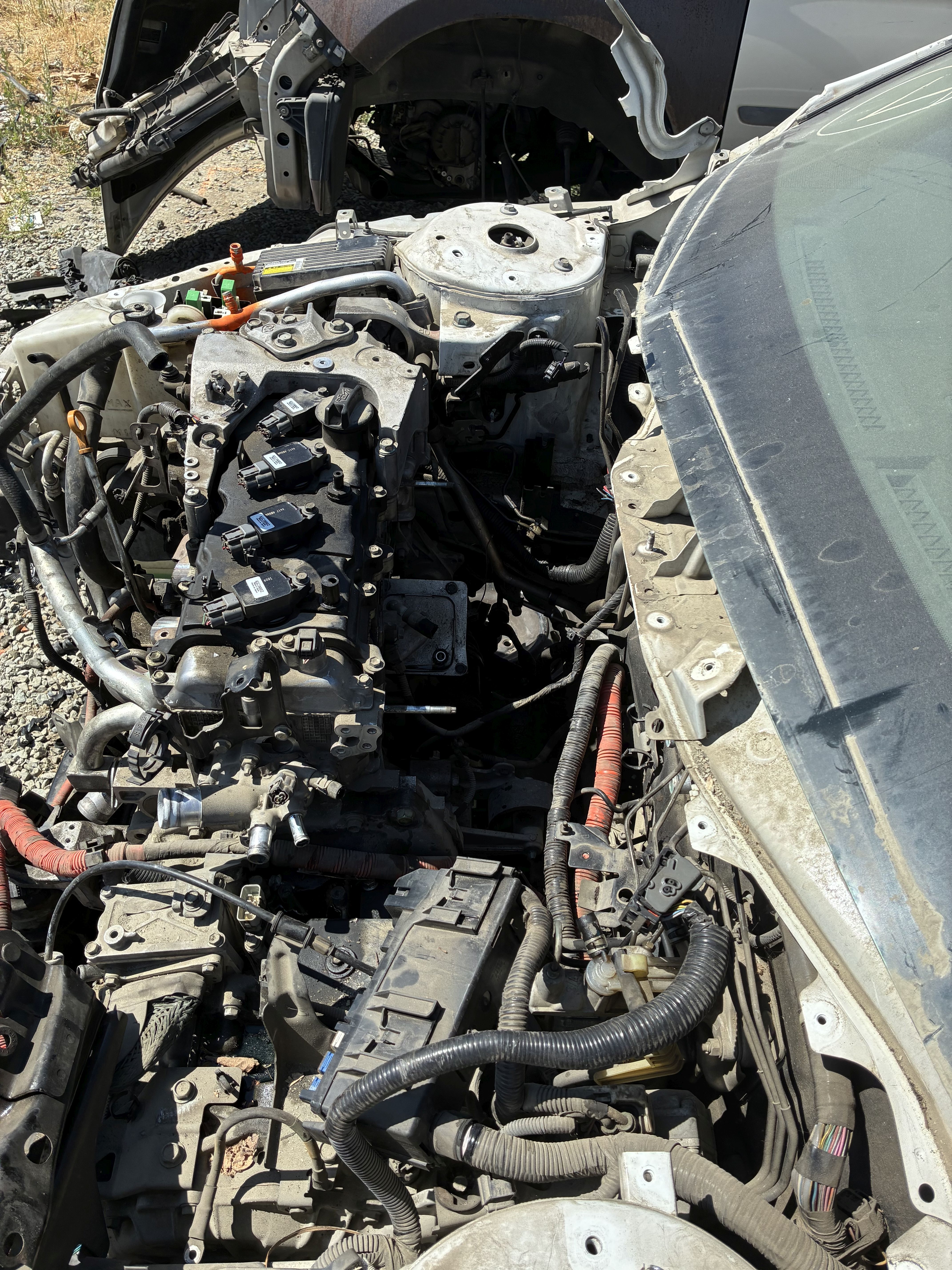

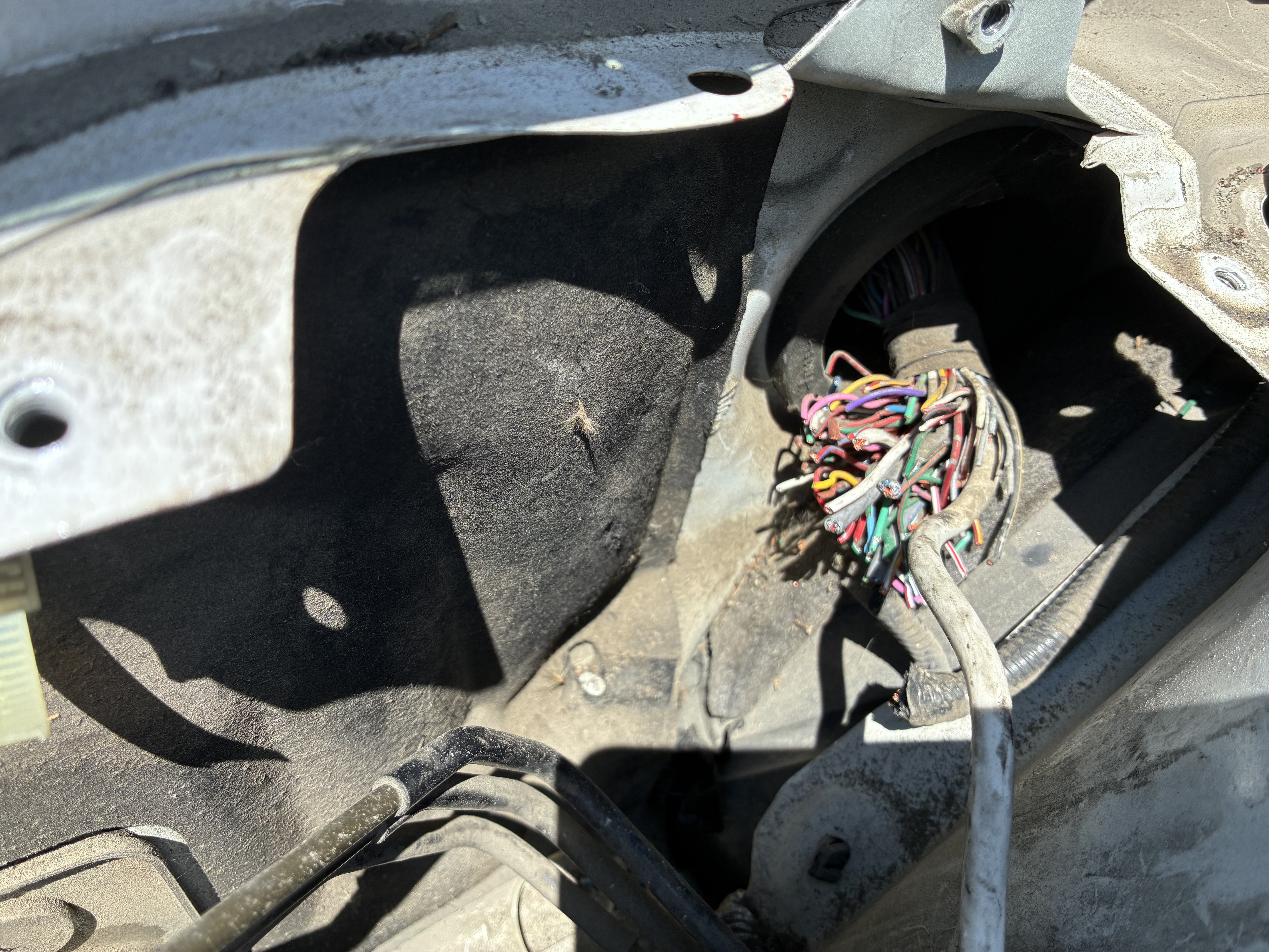

ok on with it, this is what this sexy 2009 Nissan Altima looked like when I found her in the wild, she was 97.2% in tact
one of the first things I like to do is check to see if it has an inverter, and if so if it is a part number that I don't have already, Artur K of the Jaguar XJR EV fame and I are hoping to do some testing of running the much cheaper Altima inverters against the Lexus GS450h gearboxes and dyno test them to see if there is any pony loss or if we can live with it

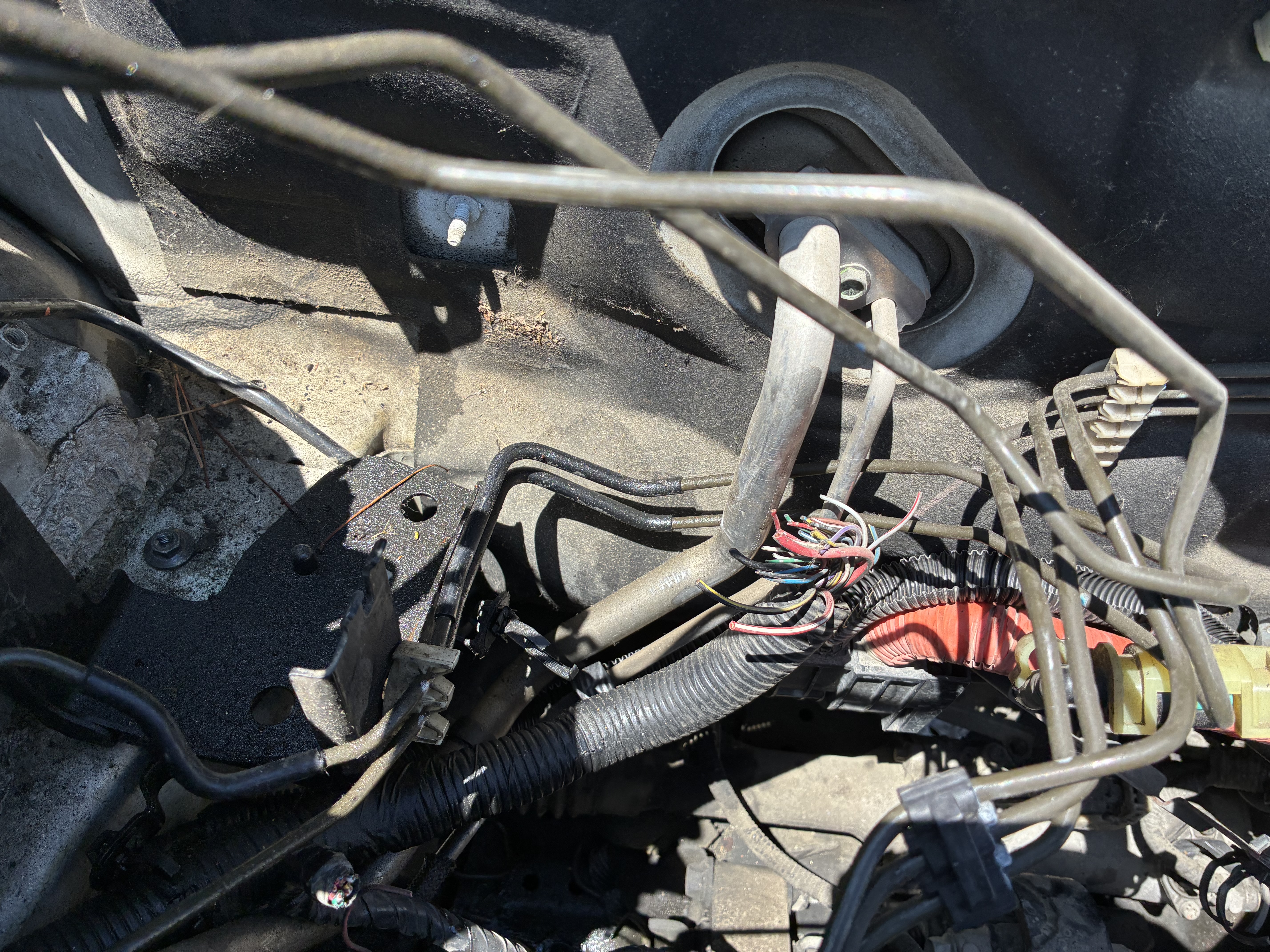

OK, so you saw what the car looked like when I found it, trust me the engine bay was all stock, and here it is 4 hours later, yes we get to remove the hood, among a million other components that are in the way
yes I had to remove that silly ram horn wrap around plastic intake manifold to get to the main wire harness that runs across the entire firewall (yes to unbolt 4 of the 6 intake manifold bolts blind by feel, Fun Leve: -2)
I call this Civilized Carnage

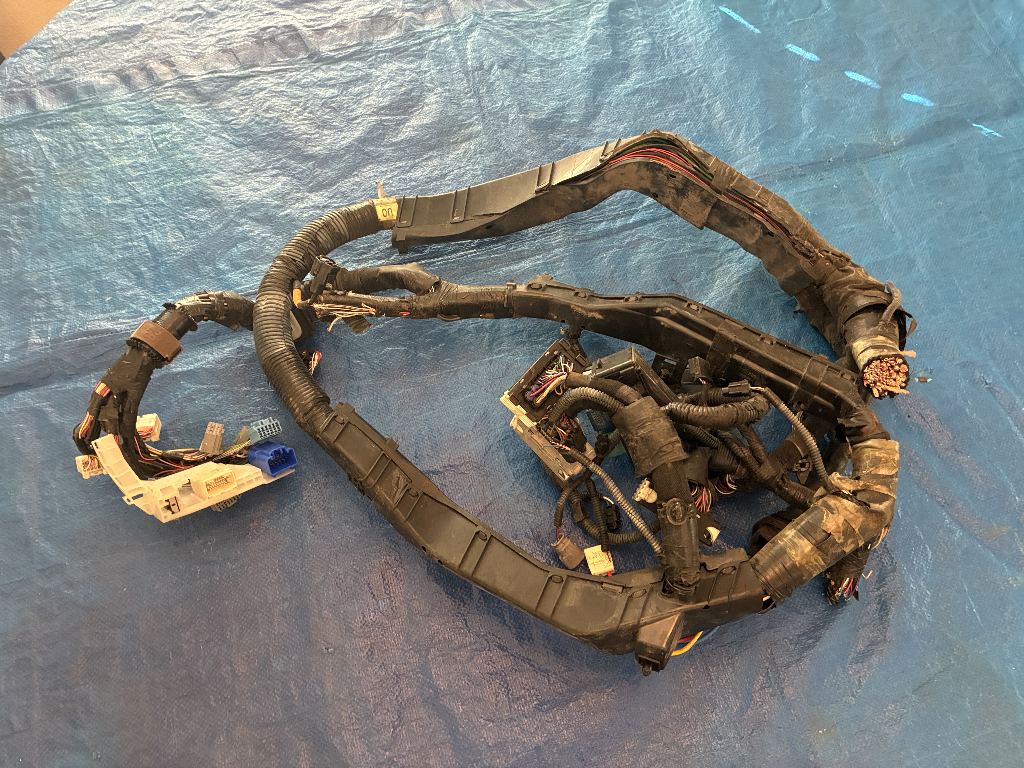

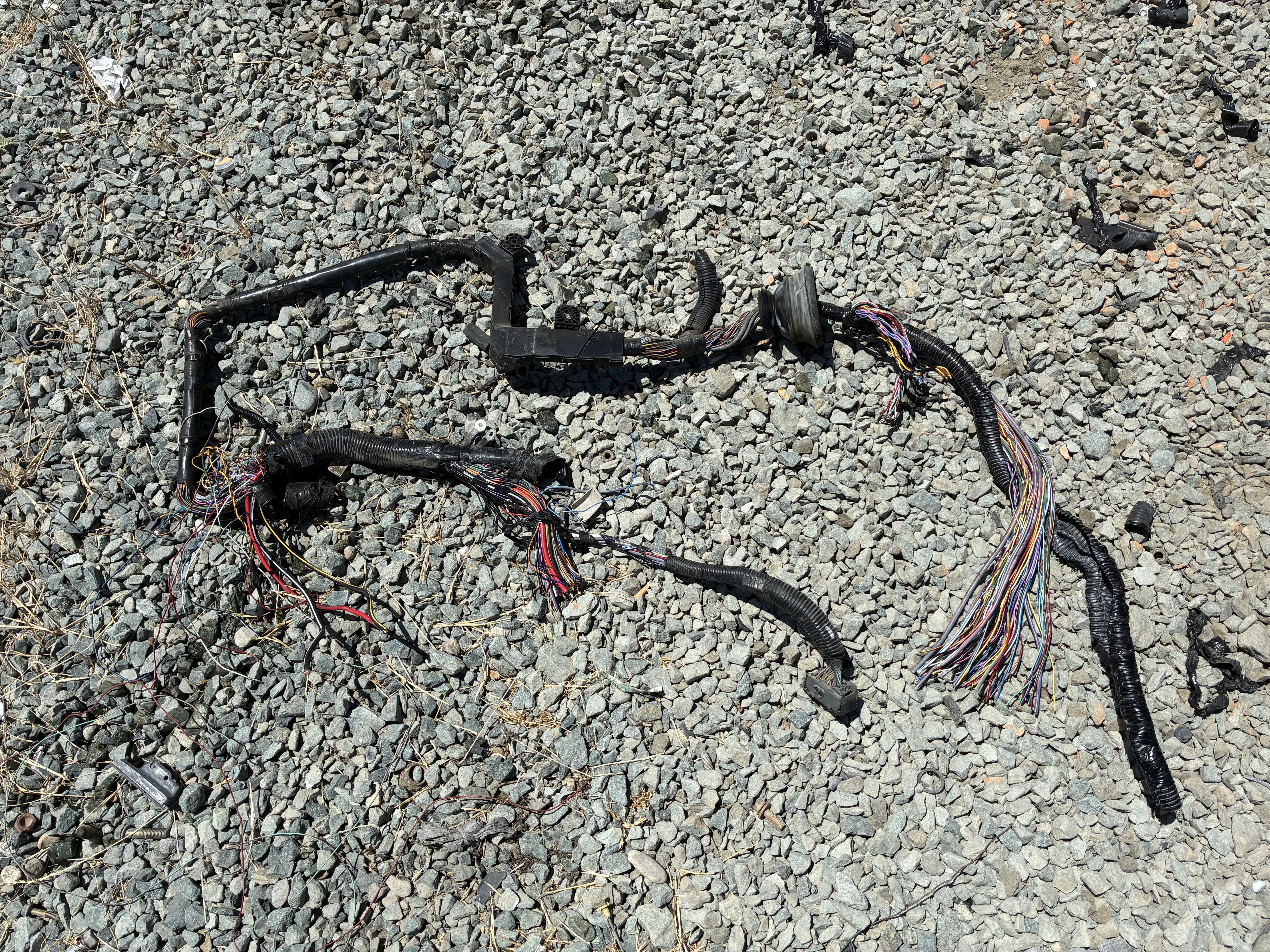

so if it all goes well we get to yank part of the main wire harness that looks like this, and I say part of it because the way it is routed is completely insane, the inverter lives behind the headlight on the driver side, well this stupid harness runs from the inverter to the firewall than across all the way to the passenger side, yes in front of the firewall in the engine bay, then it goes through the firewall, into the cockpit where it runs back over to the driver side and into some black box module thingie I'm sure, Why? why not just run it from the inverter into the cockpit on the drive side an be done with it?
so all that work for pretty much this, which then has to be cleaned and washed and de pinned and repined, etc.

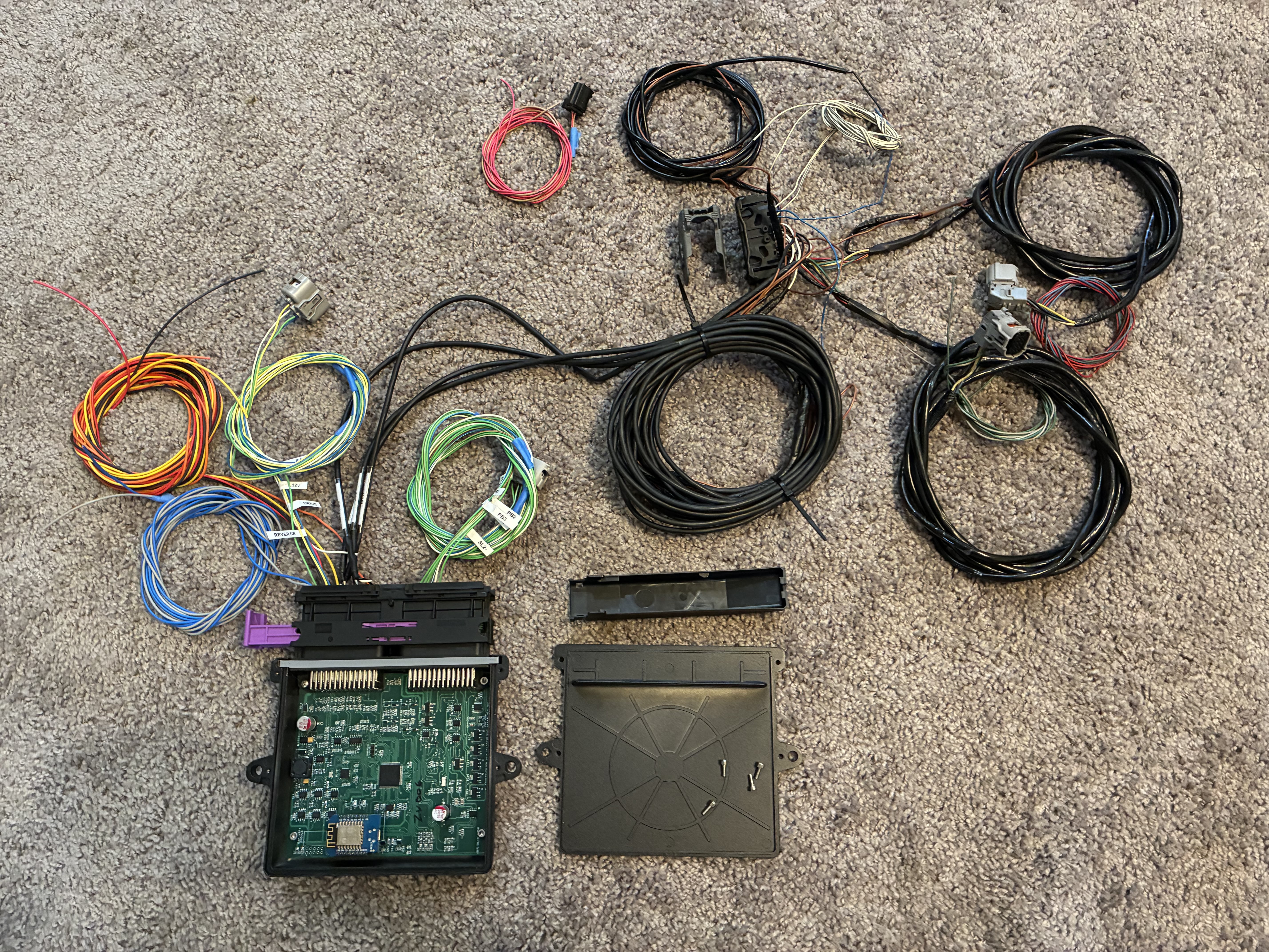

having sold a number of wire harnesses now, I figured might as well finally build myself a prototype, and test one out 😉

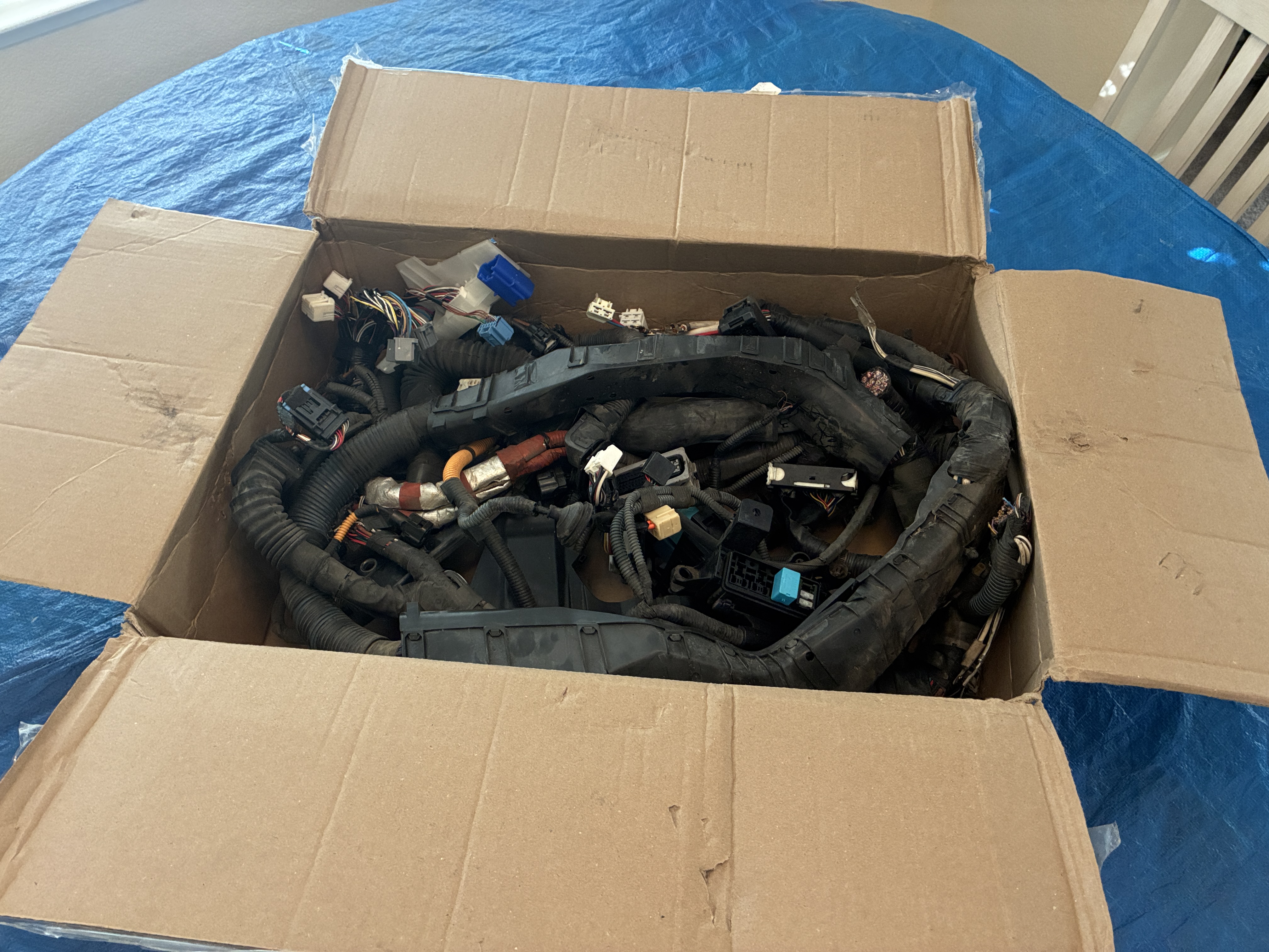

another option is to yank your own harness(es) and ship them over to The Greg to thin out
here I am about to thin out my very first Lexus LS600h all wheel drive Engine Harness and Transmission Harness that a customer has sent in to Good Enuff Wire Harness Worx
I want to share this process and offer up some tips
Very impressed how he managed to get both harnesses in to this box!
Fun Fact: Wire Harnesses are heavy !!!

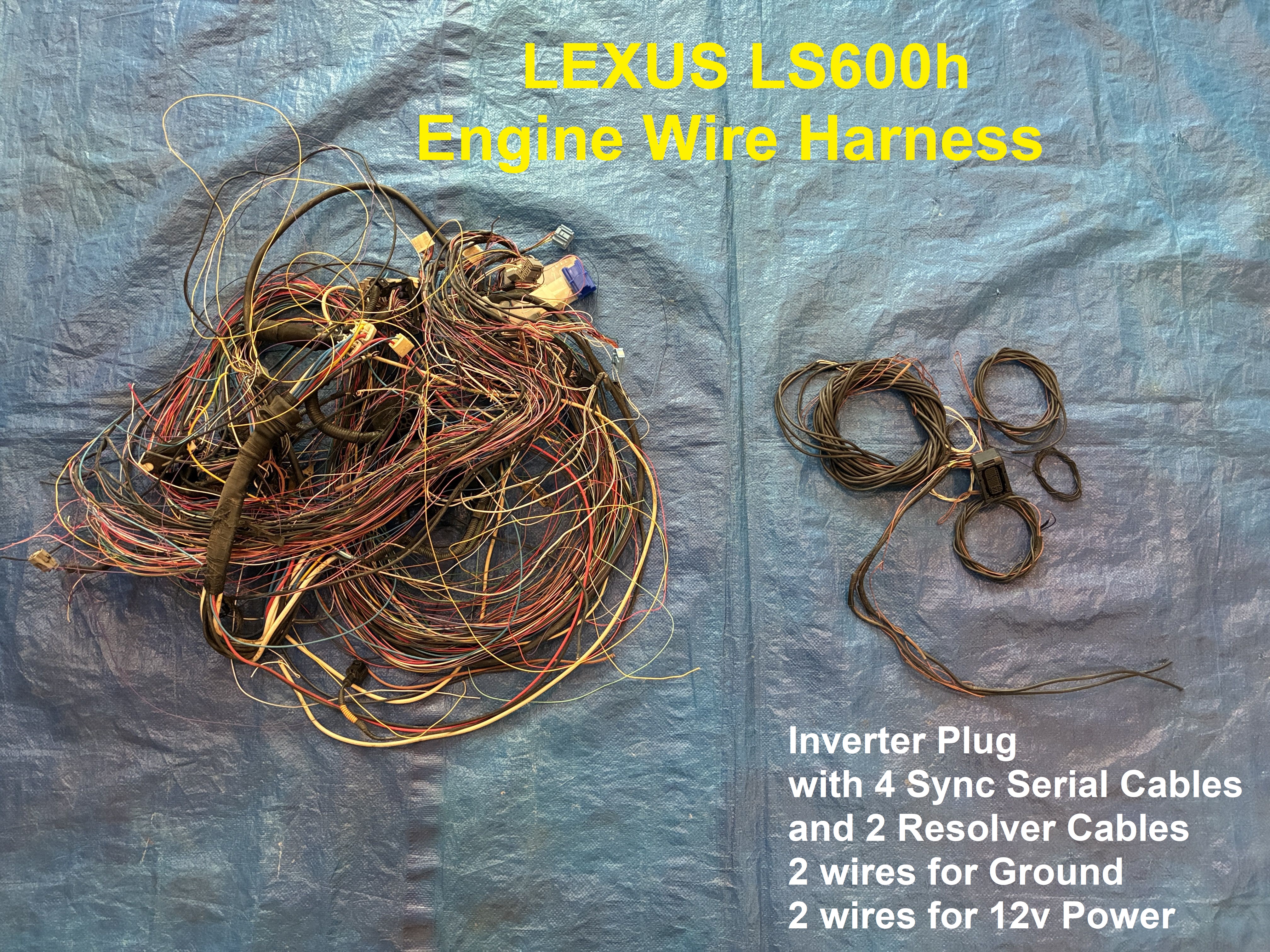

So what exactly do we need out of this so called Engine Harness?
Well, this! The Inverter plug and the tail that comes out of it.
We don't need this white plug below, I just pulled it as a home run for completeness to show where the other ends of the sync serial cables from the inverter plug terminate
so this is what we need, note the two Resolver Cables have been cut prematurely, both of them should run to a single white plug which then accepts the resolver cables from the gearbox
and here's a fun little Stare 'n' Compare of what we need and what's left over

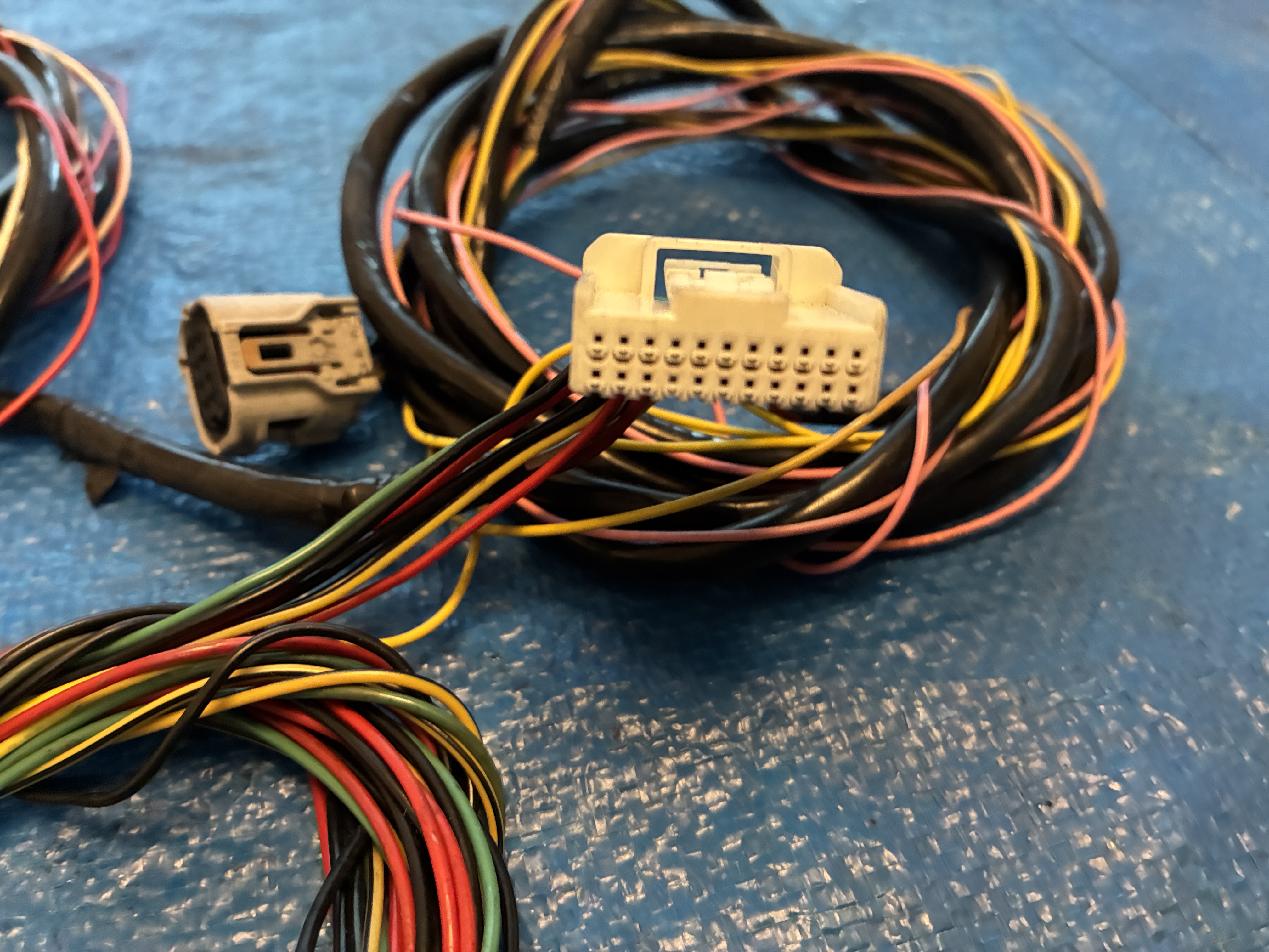

and these are the resolver cables extracted from the Transmission harness
and here's that white connector that runs to the matching white connected on the Inverter harness (that our inadvertently customer lopped off above)
