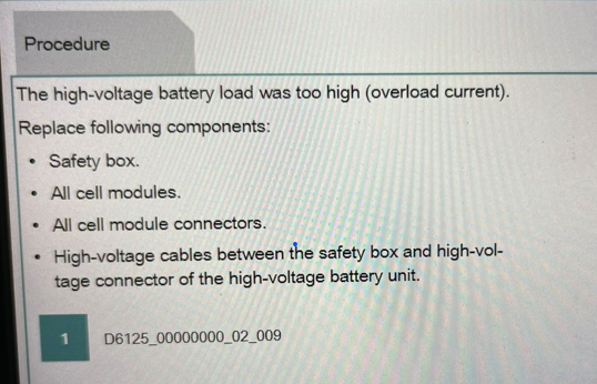

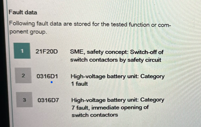

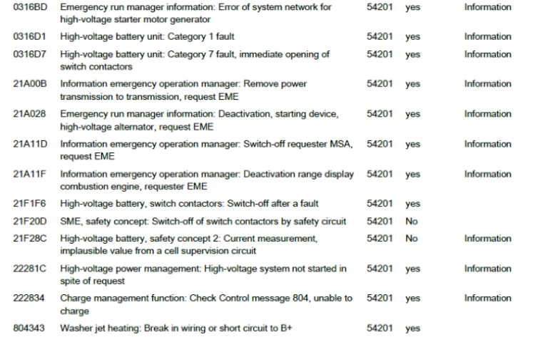

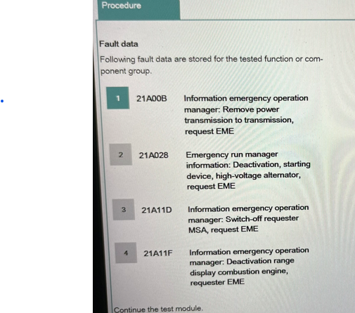

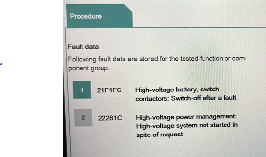

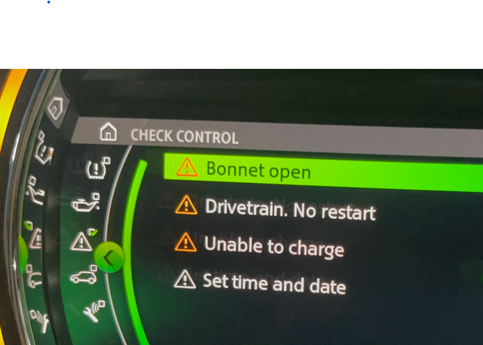

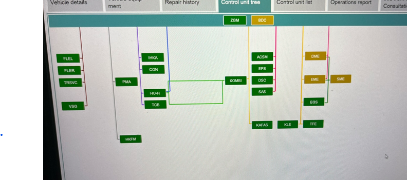

Dear members,
I have a mini cooper 2018, i left car for 3 weeks and when am back it wont start. the 12v battery was dead so i put new one 60 ah AGM and now i have ignition but car will not start and won't move neither in petrol or electric. i got some erros on radio screen (see attached) and also i performed a diagnostic with ISTA (see attached). It will not take charge at wall outlet. Can you point me to a direction please.
