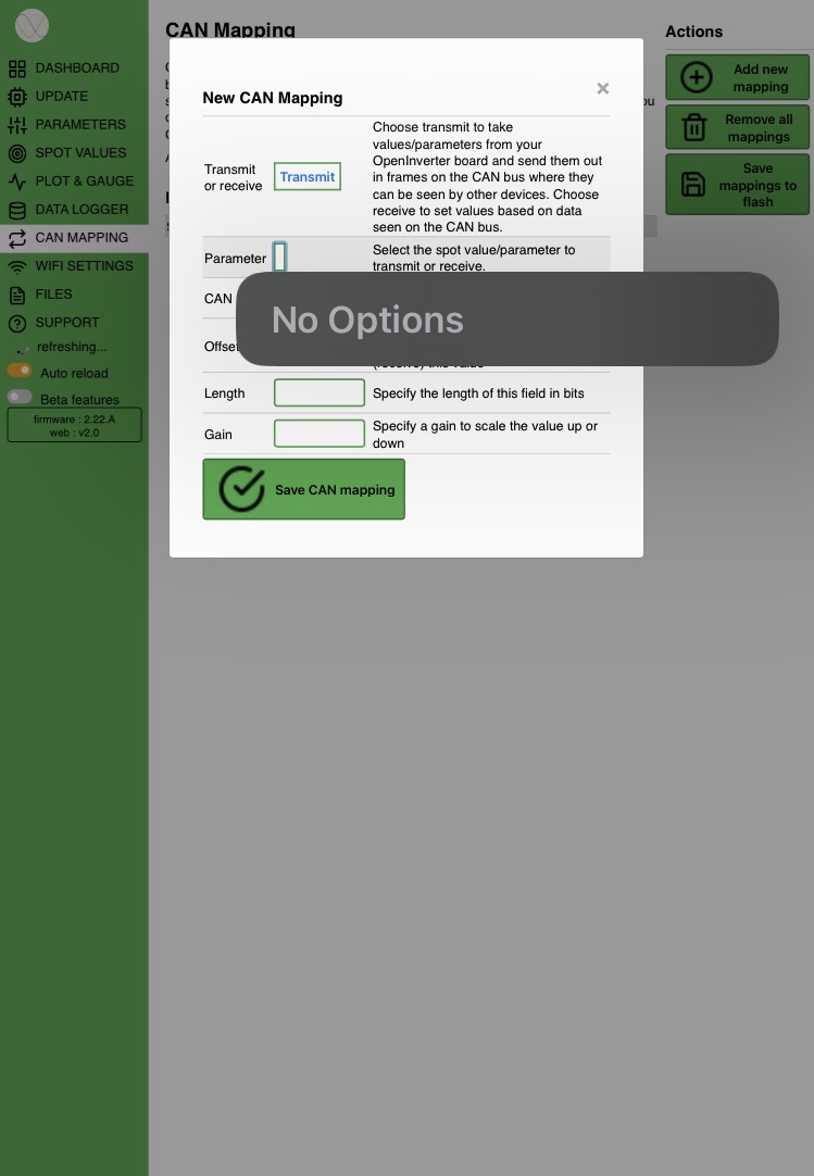

Hello,
I am sure I'm missing something here but when opening a "New CAN Mapping" window the parameter list shows only "No Options".
Please Help.
I tried with Safari and Firefox.
I am using a ZombieVerter VCU V1a Firmware v2.22A; Web Interface : v2.0; Wi-Fi ESP8266

Odd. Are the parameters/spot values showing?

Yes, they are all here.

The list disappear when the FlyingADC BMS (on CAN2, IVT Shunt on CAN1) is powered and enabled at the same time as the ZombieVerter is powered.
The list and saved CAN mappings reappear after one or two webpage refresh.
