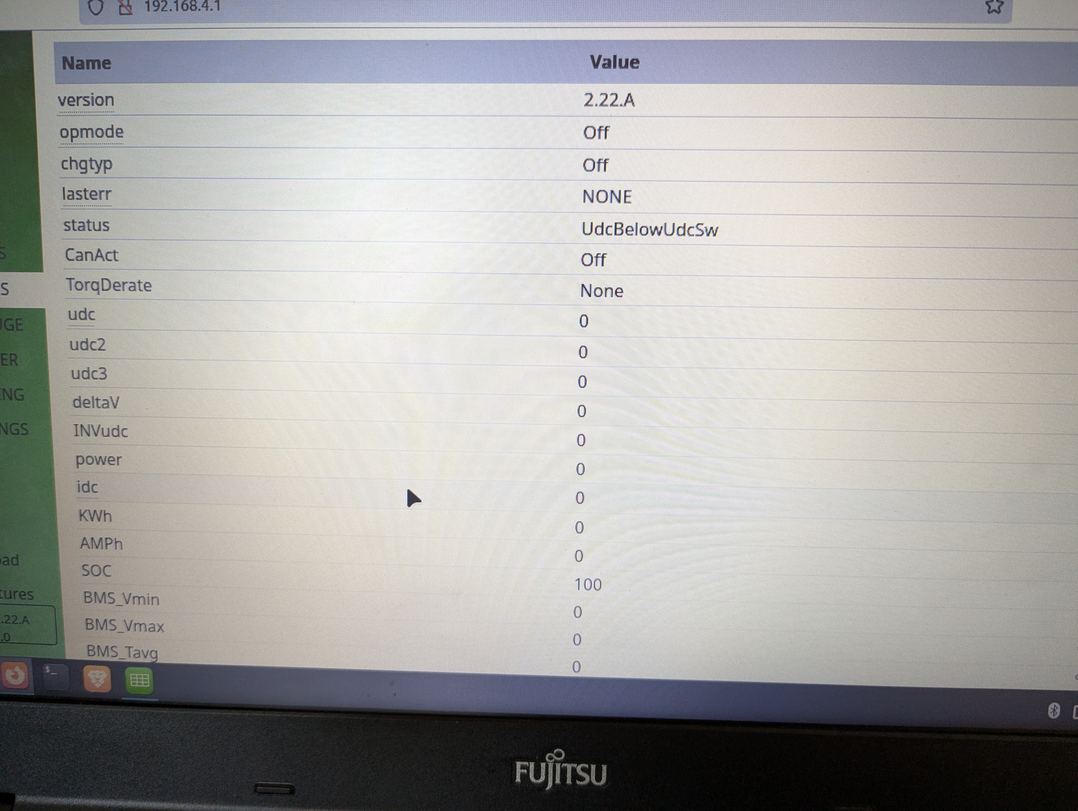

Hi guys, stupid question time and hopefully something silly I'm doing.
I'm testing my newly received Zombieverter by replacing the Leaf VCU in the car.
I think I have the parameters similar to Damiens from the Grey Goose but I'm not seeing any LS ouputs from any of the Pins 31 to 34 so no precharge, Inverter or negative contactor.
I've been able to calibrate the throttle without issues so am able to communicate with the VCU.
I don't have the HV connected as I wanted to see the outputs working correctly before connecting HV.
Is this possible?
I could do this with the Leaf VCU as it immediately sent the precharge output when T15 was turned on.
I have 12V on T15 through a switch and Start through another momentary switch.
Any suggestions?

Firmware is 2.22a web 2.0, Damien only shipped it a couple of weeks ago.
There are no errors but also no voltage showing on UDC even though I had a 20V battery connected to the ISA which was working fine with the Leaf VCU.
This screenshot was taken while the VCU was powered off but I don't think it has changed.
params.json
(2.14 KiB) Downloaded 100 times
I put a meter on the outputs but didn't get a GND on any of them.

Go through your params.
https://openinverter.org/wiki/Zombiever ... pot_Values
"udcmin": 450 - this wont do
Also verify all input are working as they should. Specially if you say you are applying UDC but the ISA shunt is not being read by the zombie as it should.
edit: also use the spotvalue tab not that dashboard one. Also have a look at how to use the plot feature as this is helpful for looking at signals over time.

I've been playing with the Zombie on the bench and can confirm I'm getting low side outputs as soon as I apply 12V to T15.
The Neg contactor pin goes low and stays low. The Precharge pin goes low but only for a second or two.
At this point I've nothing else connected but at least I can confirm I'm getting outputs.
Hopefully over the weekend I'll get time to install it in the car and learn a bit more.

So I thought I had figured this out but now I'm back to getting no LS output on the Negative contactor pin 31
On Thursday while bench testing I connected permanent 12V and GND then T15 to +12V through a switch. When I flicked the switch I saw constant GND on Neg Contactor (pin 31) and 1 or 2 secs on Precharge (Pin 34) so I thought all was well.
I tried in the car again today and it was back to not working car so I disconnected everything except 12V, GND and T15 through a switch and tried again but it still didn't work.
Now I'm back on the bench with the same setup as before seeing the same issue so I've really only seen this working once.
I only have 12V permanent on pin 56, Gnd on pin 55 and am switching 12V +ve to T15 pin 15.
I've triple checked I'm getting voltage at T15 so am at a loss as to what I've done.
Have I made a stupid change to the parameters? Is there anything else required to see the neg contactor get a GND?

Any errors in the spot values?
Please post all your spot values.
You double check all your inputs are showing up as they should?
Re: New Zombie user not getting LS outputs.
Posted: Sat Jun 07, 2025 3:33 pm
by Alibro
No errors but I see T15 status changing as I flick the switch on and off
Posted: Sat Jun 07, 2025 4:09 pm
by tom91
And you giving it a start 12V signal?
You can use the print function to save as pdf, or atleast you can for windows, easier to save.
Posted: Sat Jun 07, 2025 4:14 pm
by Alibro
No nothing except T15 status
Posted: Sat Jun 07, 2025 5:32 pm
by tom91
You need a start signal to go into precharge.
Posted: Sat Jun 07, 2025 8:22 pm
by Alibro
Thanks Tom
I had the start connected at some stage but must have had other settings wrong at the time.
With a bit of help from Kev39 I got them sorted and now the neg contactor pin goes low as expected when the start is pushed.

Posted: Thu Jun 12, 2025 8:36 pm
by Alibro
I know this has been mentioned else where but just in case others are going along the same path as me I'm mentioning it here.
I was struggling to get UDC voltage from the ISA shunt. I was only seeing 0V even though I confirmed I had CAN from the Shunt and VCU.
Turns out the Parameters are a bit confused and if the ISA shunt is connected to CAN1 pins you need to select CAN2 for the shunt in the Parameters page.
I did this and instantly saw voltage as expected.
