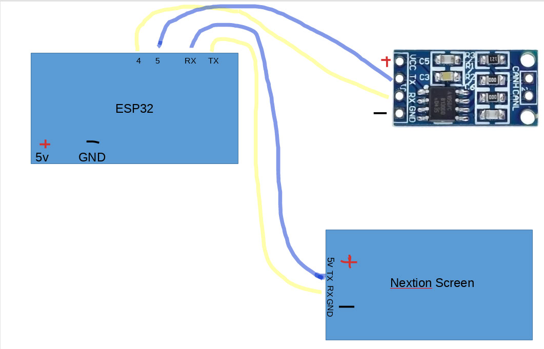

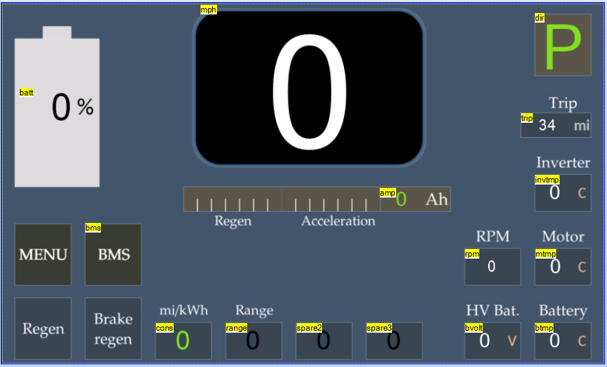

This is the Display I am working on and I posted in my thread. if anybody has questions please let me know.
EVScreen1.ino
(9.88 KiB) Downloaded 70 times
esp32_can-master.zip
(49.83 KiB) Downloaded 51 times
==> needs to be uploaded to the Arduino IDE Library
From the 2 zipped files EV Display.tft if the file that goes on the screen and the EVDisplay.HMI is the file that can be modified with the Nextion software.
EV Display.zip
(846.12 KiB) Downloaded 70 times
Nextion 7.0″ HMI Display Intelligent Series NX8048P070-011C
https://www.amazon.com/dp/B0B95VPVS9?re ... title_0_0
Can Controller
https://www.amazon.com/dp/B093WYRPL1?re ... asin_title
ESP32
https://www.aliexpress.us/item/32568066 ... pt=glo2usa

If anybody has an idea of what else should be on the main screen please let me know. There is still some space.
Would be nice is a real programmer would work on this.

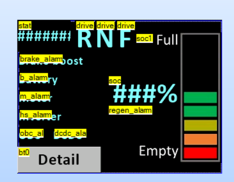

Re: DIsplay for EV conversion
Post by alexbeatle »
Proton wrote: Thu Jun 12, 2025 12:24 am If anybody has an idea of what else should be on the main screen please let me know. There is still some space.

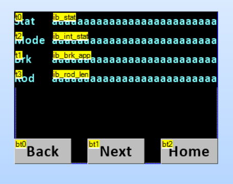

Looks awesome! I use nexion display too - but a small one.
To keep it clean, for the main screen I just display the motor direction, speed and vehicle state - (drive, charge, error) and error pop-ups. Ex. motor temp H (warm)/yellow, HH (hot)/red. Then I have separate details screen for all my hardwares - motor details, battery details, ibooster details, charger details, etc.
Just an idea.

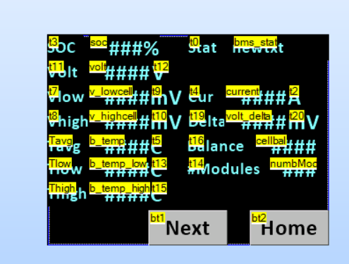

alexbeatle wrote: Thu Jun 12, 2025 3:55 pm Looks awesome! I use nexion display too - but a small one.
Just an idea.
put a screenshot with yours. the more ideas the better. I am going to implement the error popup on mine too. good idea.
I also want to add on the 2nd BMS, charging details. I will have to purchase the CCS board for that.

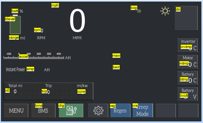

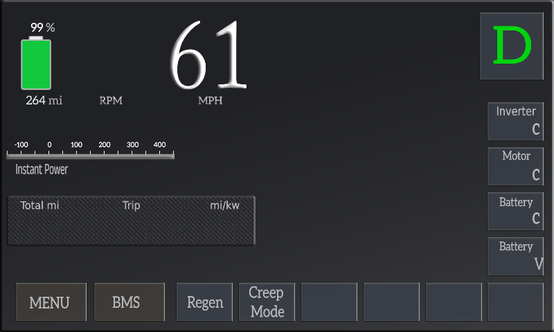

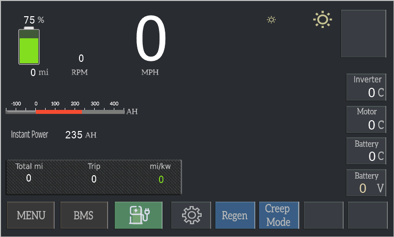

This is the new version and probably final for a while.
There is an invisible slider on the top Right for screen light.
The red line for instant power shows Amps used. I do not think the Regen bar on the left can be made possible in Nextion
Battery green fill goes up and down depending on the charge.
Battery percentage number turns to red under 20%.
Inverter temperature turns to red over 75C(is this threshold right?)
Motor temperature turns to red over 85C (is this threshold right?)
Charge, Regen and creep mode can be pushed on and off but there is no code behind them. Need to figure that out in the future.

PetersonOctavius
Posts: 151
Location: Willemstad, Curaçao
Has thanked: 98 times
Been thanked: 38 times
Post by PetersonOctavius »
Inverter temp max (default derate) is 85C
i think the motor temp (tmpm) is allowed to go quite high.
you ll have to monitor the temps during your first runs

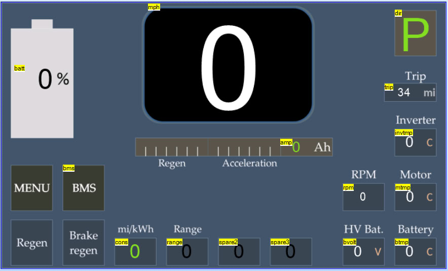

I took the screen protector and the screen looks a little washed out. Probably need to start looking at Dwin screen.
But the software is different.
Proton
Posts: 366
Location: Georgia/US
Has thanked: 227 times
Been thanked: 57 times
Post by Proton »
Updated the background to black to get more contrast. On the screen looks dark gray.
EV Screen.zip
(852.16 KiB) Downloaded 57 times
I updated the files. By mistake yesterday I exported the pictures from Photoshop at 70% instead of 100%

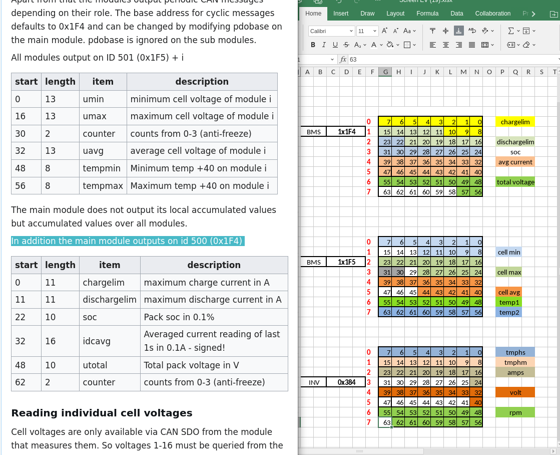

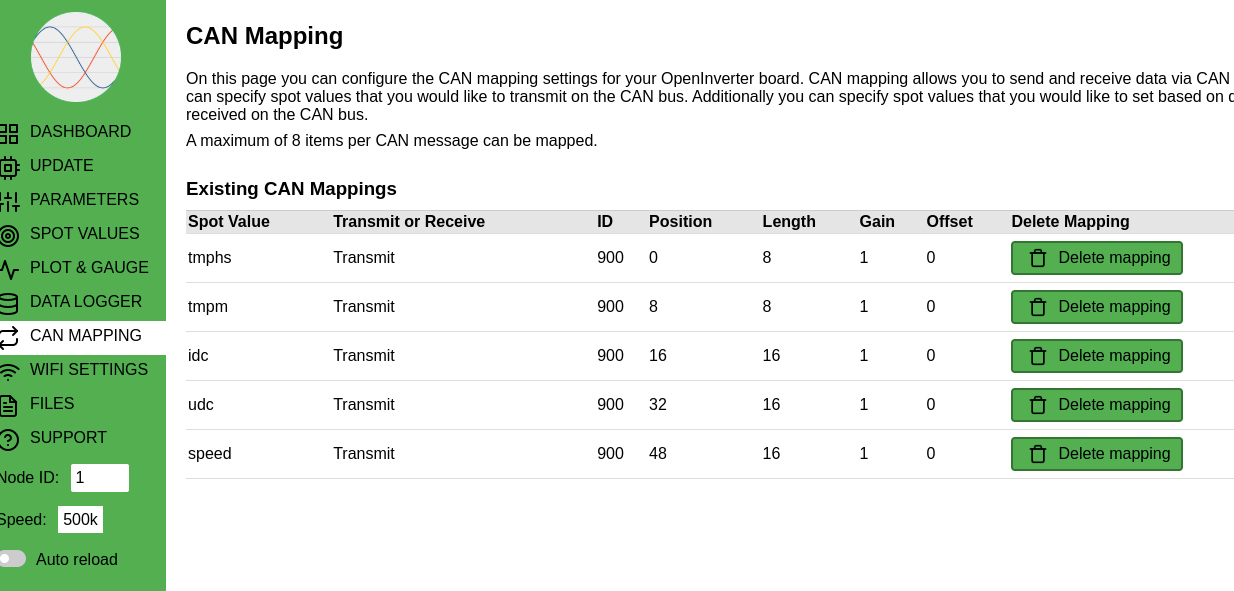

CAN messages for different cars.
DBC_Files.zip
(548.37 KiB) Downloaded 81 times

Proton wrote: Thu Jun 12, 2025 4:12 pm put a screenshot with yours. the more ideas the better. I am going to implement the error popup on mine too. good idea.
It started from the SimpBMS display and became the overall vehicle display, hence the resemblance.
When all is good "..._alarm" are hidden. Else different thresholds alter the text colour - blue/cold, yellow/warm, red/hot

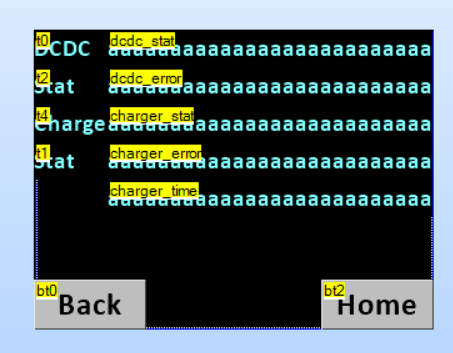

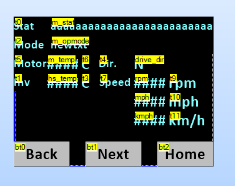

Main
BMS/battery
Drive
Ibooster
Dcdc/charger

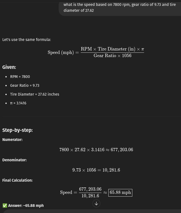

To calculate Speed MPH from motor RPM and Wheel Diameter.
speed = (rpm * 27.62 * 3.1416) / (9.73 * 1056); // tesla gear ratio = 9.73, Tire diameter = 27.62.
For KM/h the formula would be different.
I used Chat GPT to get the formula. Still need to test it.

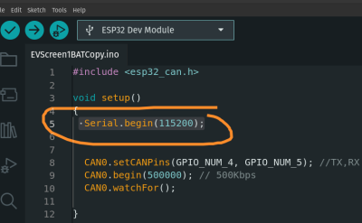

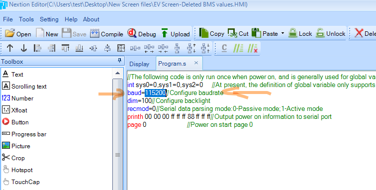

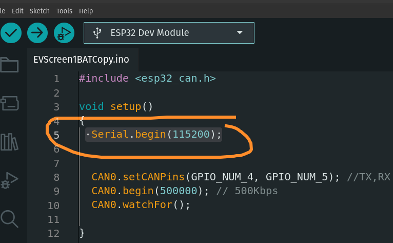

Updated screen files. baud rate changed to 115200 to update values on the screen instantly.
EVScreen1-115.ino
(5.17 KiB) Downloaded 67 times
EV Screen-115.zip
(851.38 KiB) Downloaded 57 times
