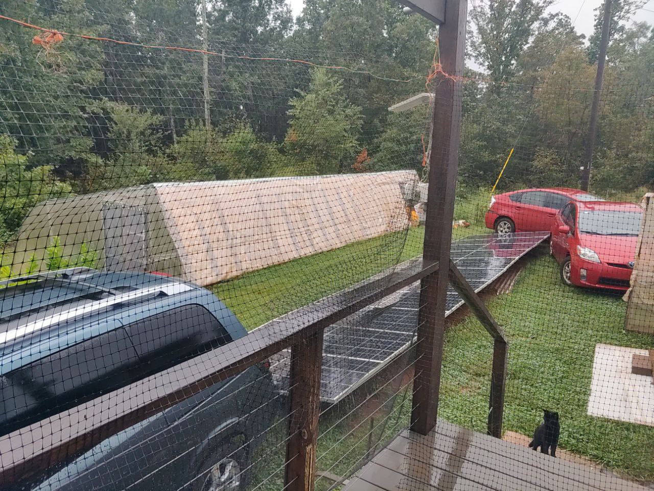

I built this solar carport for $1080 and was a lot of work. The metal poles are 4ft in the ground in concrete.
In the spring I was able to produce 50kw /Day. But that was only after few cloudy days when the battery went down to 50%.
Right now I can produce more but I do not know exactly how much because my batteries are full by noon and the inverter stops producing power. I need to have the battery down to maybe 60% and then I need a full sunny day to see how much I can produce in the summer.

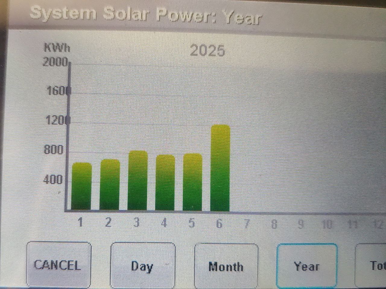

This image show the how much my house used this year. Not what the system can produce, because I can produce a lot more.
July is the hottest Month and will probably know if my panels produce enough power.
When I will start charging the battery for the car I will know exactly how much I can produce.
Here I was guarding my solat panel on the ground. we had high winds that were picking up the solar panels and I had to move the cars around.
Here is the new solar carport.

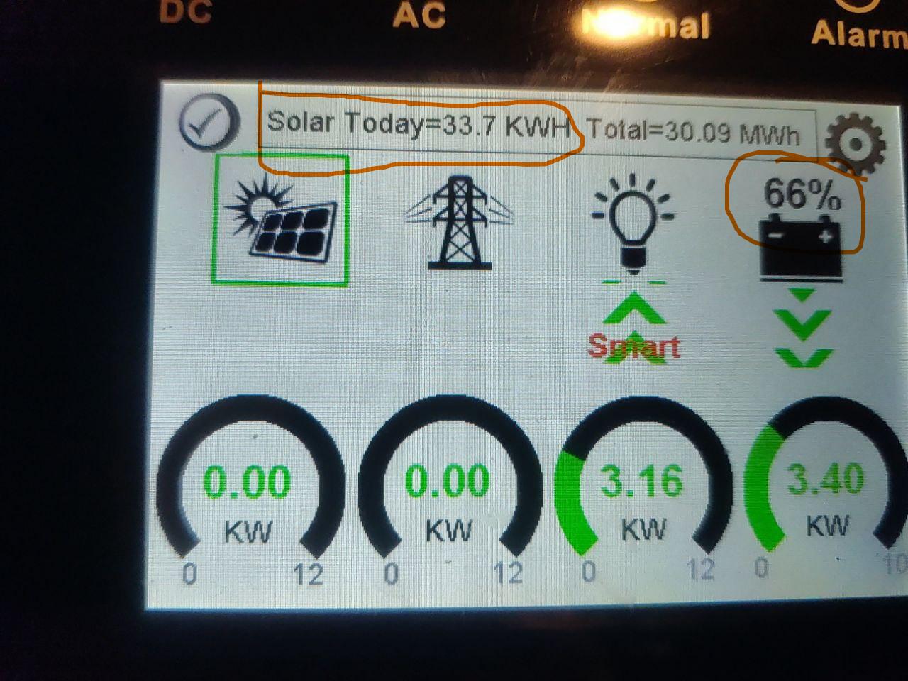

after I tested the Solar production in march and I got 50Kw, and because today is the longest day of the year I wanted to test again the solar production.
TO drain the battery for today yesterday afternoon I turned of the switch from the solar panels to help discharge the battery and last night I did 5 loads of washing and drying and managed to drain the battery to about 68%.
surprise is that the production was only 54.8kW, only 4.8kw more compared to the spring test. I was expecting over 60kW. I guess that heat indeed has a big effect on the solar panels. today we had 34C and indeed was very hot. AC ran nonstop from 11 AM to 7-8 PM
I forgot to check if the 10 panels on the roof of the house are clean, but I can check that tomorrow.
Also the battery showed 100% around 4 PM but according to the production curve I do not think I lost any production.

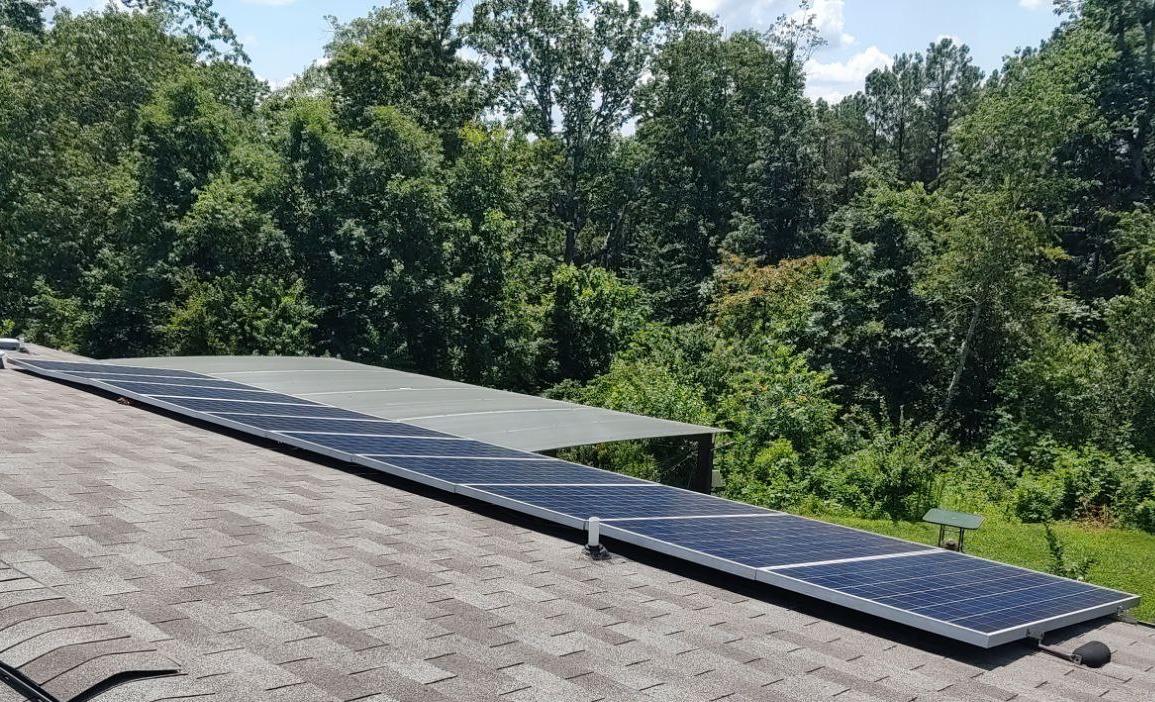

So, it looks like the solar panels on the roof are less efficient that the solar panels on the Carport which have a lot more airflow.
M1 Roof are 79% efficient, probably because of the hot roof.
M2 Carport are 84% efficient probably because there is more air flow underneath.
But both lose efficiency in this heat.
Probably next for the sake of science I will disconnect the solar panels on the roof too see if the carport is enough to keep the batteries full in this east coast weather where you have to run the AC 24/7 in the summer.
For a well insulated house like a passive house the 3.1kW panel on the roof should be enough even in the summer.

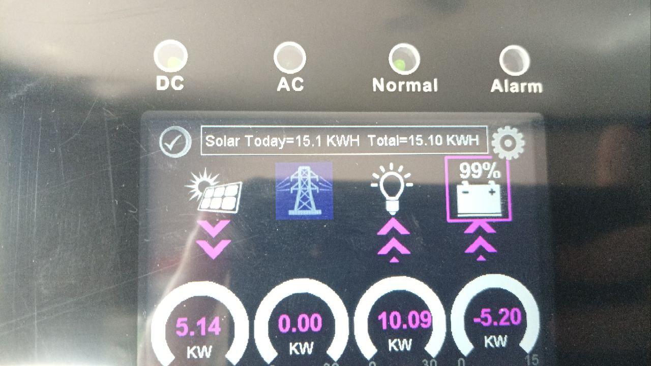

I finally had time to install the 15K. Did not connect the Grid back; just the batteries and the solar.
Using 10k right now. Dryer 6 kWh, stove 2.4 kWh, water heater 1.5 kWh, and the rest are small loads.
