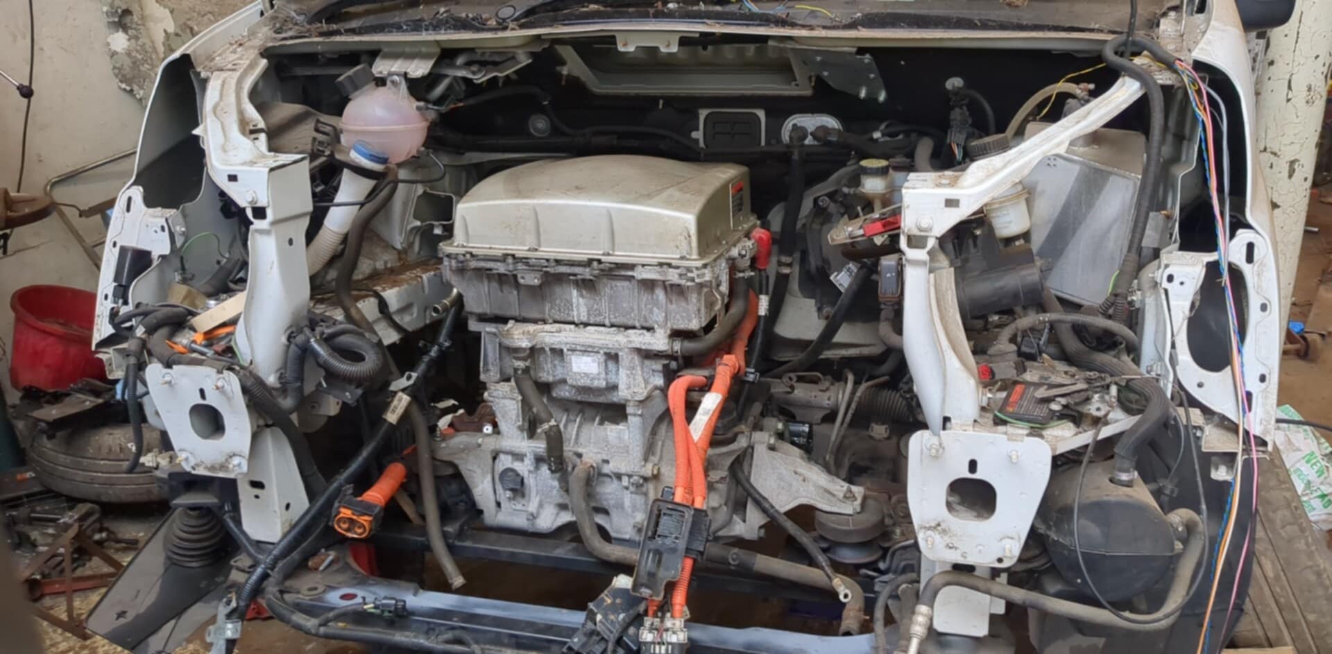

Progress so far. Leaf stack fitted to van. The driveshafts are with a local engineering company, they have a plan but won't give me a guarantee! :shock: The next step is radiator and shove a Leaf battery underneath on the floor, wire up the Zombieverter and try and get a motor spin.
Leaf stack fitted.
Leaf stack fitted.

Project update. I've fitted a radiator from a 2008 Peugeot 207 1.4D. The Expert radiator was blocking the charge ports. The new radiator has been moved left to fit the charge ports in. System filled with anti-freeze and bled. I'm using the Allied water pump and a combination of Allied water fittings and Leaf water hoses. It's not pretty but it's functional.
