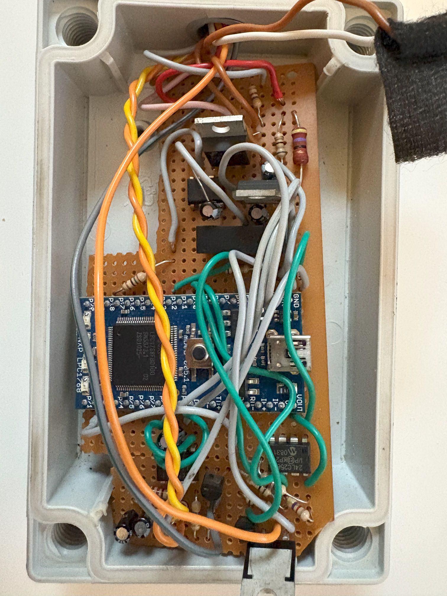

Hi all,
The Original ECM from the diesel engine is still in my Volvo V50 viewtopic.php?p=81063&hilit=v50#p81063. On the original conversion they connected an mbed NXP LPC1768 to the ECM (crank sensor, cam sensor and engine temp) and the CEM for the fuel sensor.
It looks like it is can controlled via the original (deleted) motorcontroller. How can I figure out how to control this (via the Zombieverter)?
- There is no code to be found (only Hello world) on the mbed (when I connect it to my laptop and it shows up as an USB station).
- There is an external EEPROM connected to the i2c. I tried to get the code from it via a dump with a arduino, but that gave only a long list of the numbers 255. In the beginning a few others, but not enough to be the code.
- One pin gives a constant pwm signal (so I assume there is some sort of program on it)
- Can the code be stored on an other place which is'nt shown on the usb interface? Is it possible to extract the needed can commands if I find the code?
My options are:
- Program the zombie to give the embed the correct commands (if I can find out what these are)
- write a new program for the mbed (that is difficult for me as I have no experience with this board an the support is stopping in 2026 so no usable interface anymore by then)
- change the embed for an arduino and write new code for it
- use the Zombieverter to provide the 2 pwm signals (with different frequenties) and the 0-5v fuel and temp sensor. Can this be done? Do I have to add this to the firmware? I only see one programmable pwm signal.
- A way better solution????

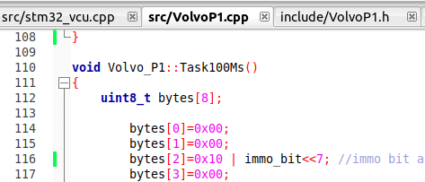

Posts: 4006
Been thanked: 1136 times
Re: Fooling the original ECM that the engine is running
Coming soon to a VCU near you...
Post by crasbe »
Damien! You're doing it WROOOONG!
Message 0x0300410E is sent in a 10ms interval! Your car will explode if you only send it every 100ms!

I am making little progress. It is an very steep learning curve. :? Using Damien his can logs is interesting (not realy working like in his video). Message 0x0300410E is starting the powersteering (and a lot of lights on the display, but not the engine malfunction light (that has been removed from the dashboard :evil: )). The power steering keeps running even when there is no more message sent. So blowing it to pieces with every 100ms a message is an real possibility :roll: . I found that sending signals to the ECM is difficult, but looks like it is possible. At least I can trick it easy so it thinks the motor is running so the powersteering starts working. But the rev counter is not reacting smooth to it. The fuel gauge is also possible to get working with a pwm signal. The temperature gauge is not working on a pwm signal.
