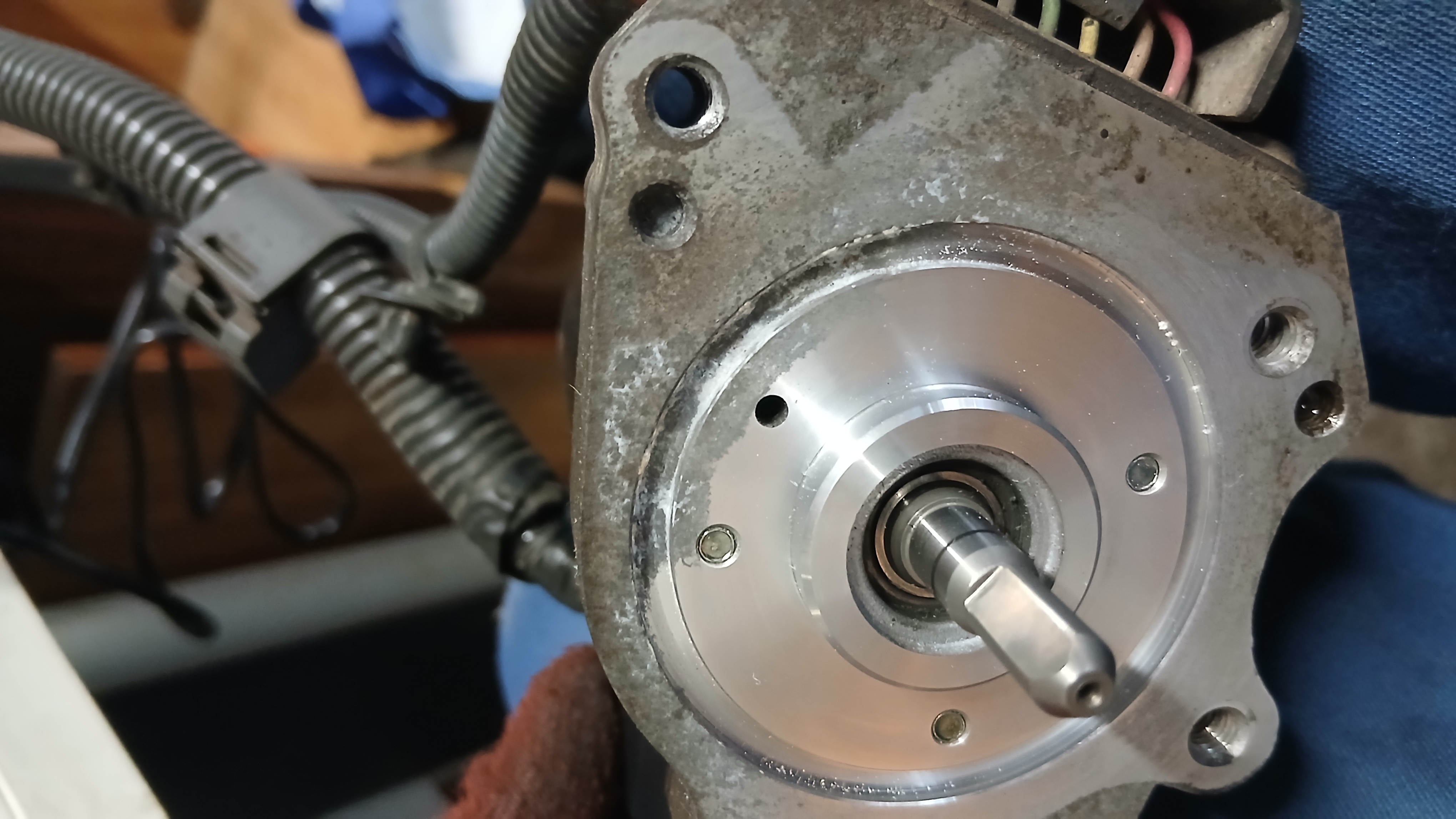

Mine has literal phillips screws made out of aluminium clay. Obviously impossible to unscrew to change the bearings. Sorry, but i forgot to take a photo of it. I thought there was supposed to be torx screws. Is anyone else on the same boat as me and have figured out how to unscrew them? Metal is so soft that I am 100% sure that filling the head for flat-head screwdriver is going to end up with the head being fully ripped off.

Mine was the same, I had to drill them out, and helicoil one. I did a rubbish video about it

Try Kroil soaking it for a day or 2. Transmission fluid with acetone is similar.
A few hits on the head may help shock it.
There are impact drivers that rotate the screw from a hammer hit, helps bite in while turning.
The body aluminum? you could try to freeze it first, aluminum will shrink more than the steel bolt letting off some tension.

Hi mate, I have the exact same problem, and my gasket and pump looks exactly like yours, did you have a workaround the problem?
And did you need to replace the bearings in the end?

Anyone soak it with kroil and try? Freeze it then try?
