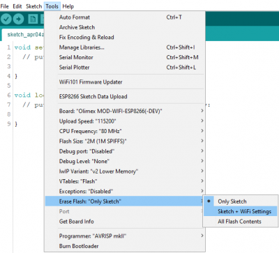

Got to flash the FS Browser file ! My PC can see it and it says it's connected - but the ssid is eps_F52560 ? Also no password asked for .
I followed Johnannes instructions to change the line beginning "WiFi begin " and put inverter as the ssid and a password, but they don't appear to have worked.
So I moved on and tried curl to flash the spiffs. I downloaded the web interface files to my pc . then I cd to that file and tried the curl commands
as in the post above . All I got was " unable to open /read local files " . I must be missing something ?
Re: Web interface problems V2.1 mainboard
Posted: Thu Apr 04, 2019 3:33 pm
by dima
A bit strange that SSID is set to default. Maybe try erasing WiFi settings?

After a lot of trial and error experiments with different versions of Arduino ide and esp8266 boards, I got to the point where
I could compile FSbrowser.ino . So I exported the .bin file and tried to flash it to the esp8266 , using esptool . After that my pc still sees"esp_56520",
but asked me for a password !, same source code ,different flashing procedure ! Will keep experimenting , somethings got to work soon !
Posted: Mon Apr 08, 2019 2:02 am
by dima
Are you sure you soldered GPIO0 to 0? After done flashing solder it back to 1.
Post your result screenshots.
