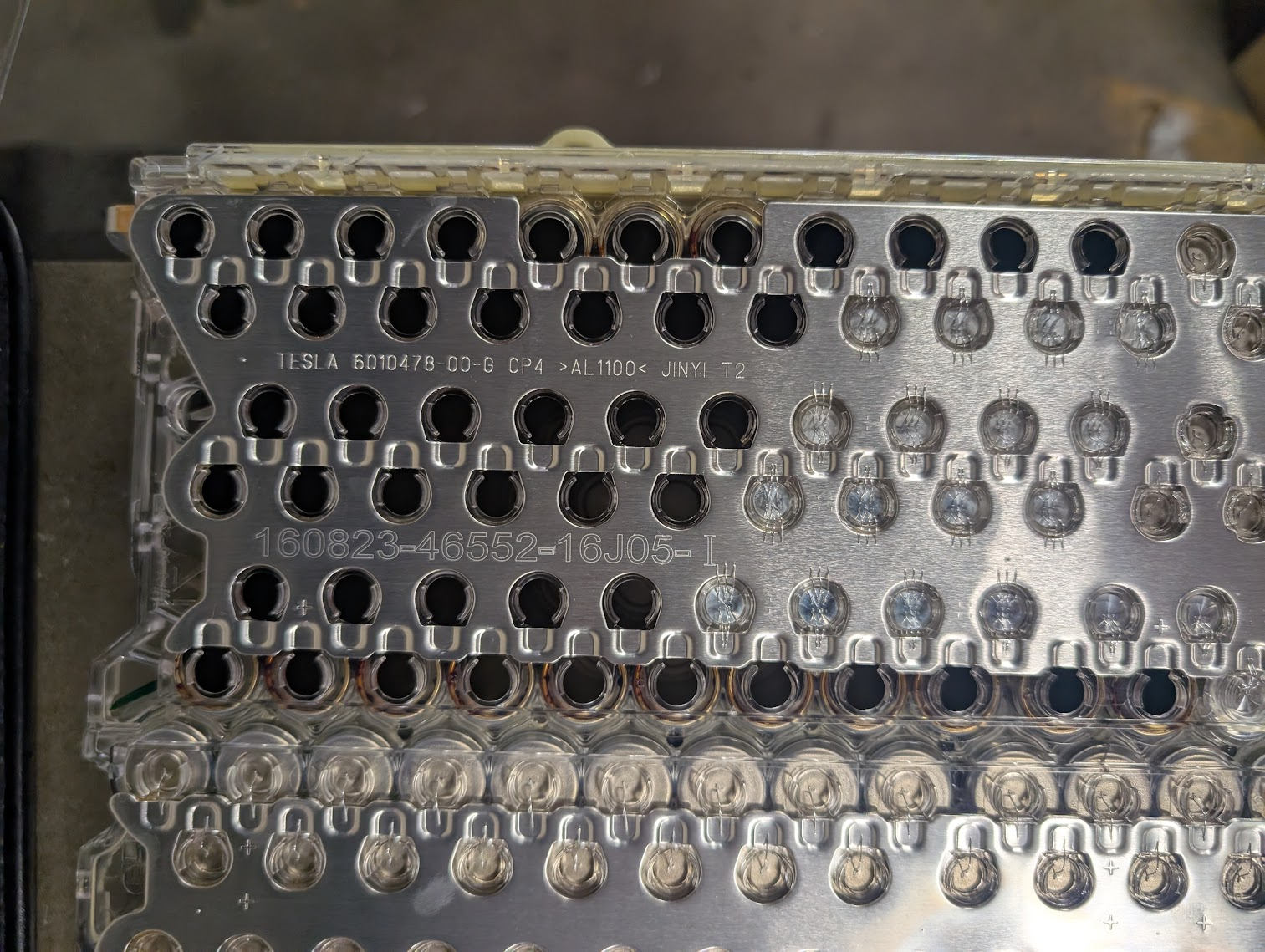

As I discuss in another post, I am having to swap out my 14 Tesla Model S modules and aquired a complete TESLA MODEL S / X LITHIUM ION HV BATTERY PACK 75kWh 350VDC. I took all of the modules out of the case and swapped out the BMS cards and took voltage reading on my BatteryGO device.
When I was doing this, 13 of the modules gave out readings between the 3.1 -3.2 range, but one of the modules gave off strange readings (only 5 cells showed up) and on closer inspection, 46 individual batteries were missing from the module.
Has anyone seen this before? They were right out of a pack, so not a one of purchase.
Assuming this is not normal or expected, can I add one more module from another pack to make up the 14 I need and just make sure to get it properly balanced in the first charge?

Yes there are random variants of modules out there. They went up in bigger capacity of 18650s so did not need all 96s groups so one module got one less cell group.
this is not an issue if you account for it in your cell tap wiring.

Can you explain that in more detail? I did some research and found out that the 5.3 kWh modules are 6s74p. I thought the 75 kWh battery packs had the same modules as the 85 kWh ones, but only 14 instead of 16. No matter how I calculate it, I can't come up with a reasonable distribution with only 46 cells missing; there would have to be 74 missing. Then it would be 83s instead of the usual 84s for the 75 kWh pack.

https://www.ebay.com/itm/204427547974
Not 100% sure how they done it exactly but there can be dummy cells in there to ensure they still get the series connections using the 6S busbars.
I believe I had seen more pictures but cannot find any more via google, internet seems alot more difficult to search lately.

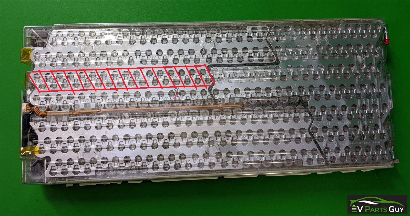

In the picture you can see 5 bondwires going to the dummy cells. Normal cells get one bondwire.

You could be right. If you look closely at the larger image, you will find 28 cells that have a different color. Together with the 46 missing ones, that adds up to exactly the expected 74!

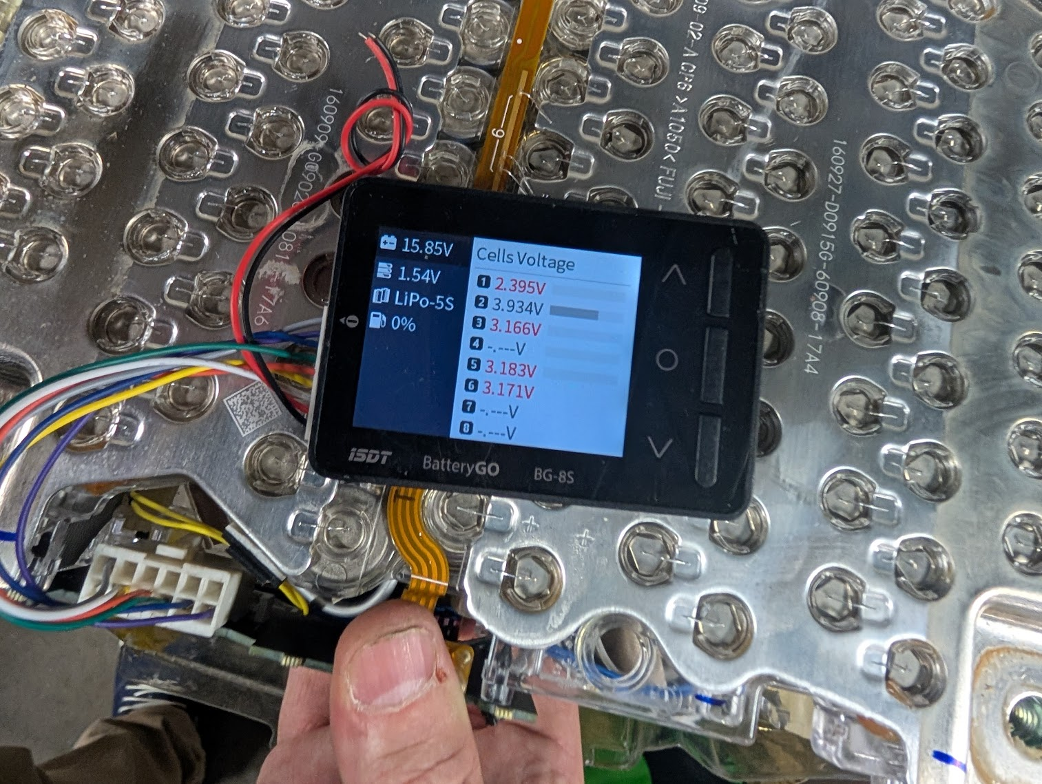

Battery 14 with the missing/dummy batteries in it came out as:
Battery 14
2.395
3.934
3.166
0
3.183
3.171 15.843
Obviously, the low reading of 2.395 concerns me, but with the higher reading next to it of 3.934 makes me wonder if because this battery is wired differently than the other ones, my BatteryGO is reading those incorrectly and I don't have a dangerous condition on cell 1. Together, the two of them average out to 3.1645, which would be consistent with the other batteries I tested. Since these all came out of the same pack monitored by Tesla's BMS up until going out of service for an accident, I feel like the Tesla would have prevented a cell from dropping this low. Thoughts on how to prove my thereom?

Do you think this is why I am getting the strange readings on Cell 1 and Cell 2?
Do I need to take a multimeter reading on all 340 active cells and see if they all land in the same range to confirm that this is a wiring or programming issue and not a bad cell?

I don't trust your Orion or your pack tester. You don't know how your tester handles the missing cable! The cable is probably free-floating, which ruins the measurement if you pretend you have 6 cells. Finally, use a multimeter, as you have been advised to do here several times, and measure the voltage between each two cables to find the correct order. You need it anyway to wire the Orion correctly. You now only have 83 instead of 84 in series, which you also have to set in the Orion. Measuring the 370 cells is pointless.

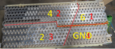

Don't worry about the physical position of the individual cells in the module. What you need to check is the connector that connects the module to the BMS. Your picture shows a Molex connector with 7 wires. This fits a module with 6 cells in series. The seven cables should be connected to the negative pole of the first cell, the positive pole of the last cell, and the respective connection points of the cells. Leave your tool plugged in during measurement and insert the measuring probes into the connector from behind to avoid short circuits, as this would certainly destroy the BMS cables in the module!!!! It is better to make a measuring adapter with the appropriate Molex connector and route the cables to easily accessible measuring points without the risk of short circuits, possibly even with 100mA fuses.
The order you need to find is :
module with 6 cells
1. 1neg
2. 1pos/2neg
3. 2pos/3neg
4. 3pos/4neg
5. 4pos/5neg
6. 5pos/6neg
7. 6pos
module with 5 cells
1. 1neg
2. 1pos/2neg
3. 2pos/3neg
4. 3pos/4neg
5. 4pos/5neg
6. 5pos
start with the black cable from your multimeter at any connection and use the red measuring cable to find the highest voltage. That is then point 7 (or poit 6 at 5 cell module) on my list. Now leave the red cable at the point with the highest voltage and use the black measuring cable to find the highest voltage again. This is then point 1 on my list. Now leave the black measuring cable at point 1 and use the red measuring cable to find a voltage of about 3.16V. This is then point 2 on the list. Continue searching with the red measuring cable for a point with about 6.32V. That is point 3. Points 4, 5, and 6 are then each 3.16 volts higher.

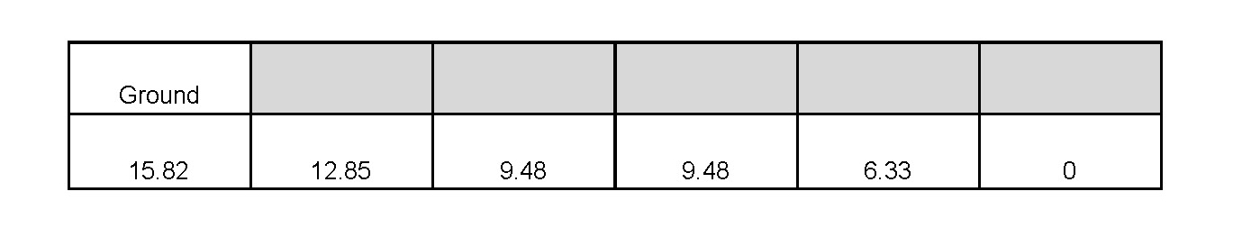

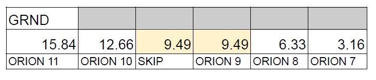

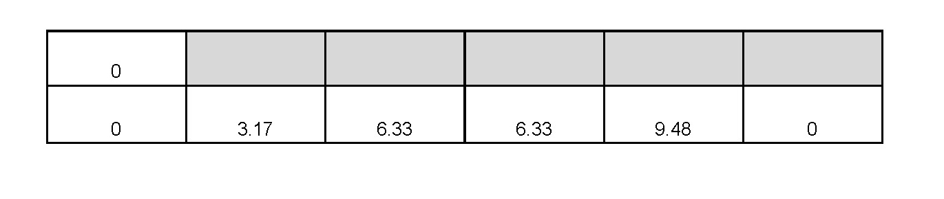

OK. So I went to the shop and followed muehlpower's instructions. On the 5 cell battery, here is how it came out:
There was never a 3.15v option, but two 9.48v readings side by side. I am not sure if this was expected or means something is wrong.
When I put the positive pole on the module positive connection and then touched the negative pole to each of the molex connectors, I got this:
Thoughts?
Thoughts?

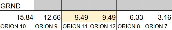

Two things bother me. In your first measurement, the top left is labeled “GND,” which makes sense. However, in the second measurement, 15.82V should be measured there. In the bottom right corner, the first measurement should be 3.13V and the second 12.85V. But both times it is 0V. From this, I conclude that the line to the cell is interrupted. Check the ribbon cable on the underside of the module, especially at the point labeled “1”. According to my logic, this point should be connected to the lower right pin of the Molex. 3 and 4 appear to be bridged, which I think is OK.
Translated with DeepL.com (free version)

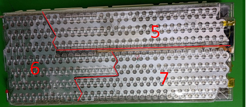

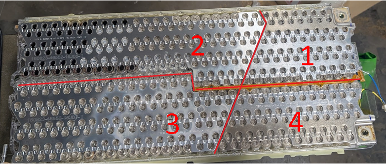

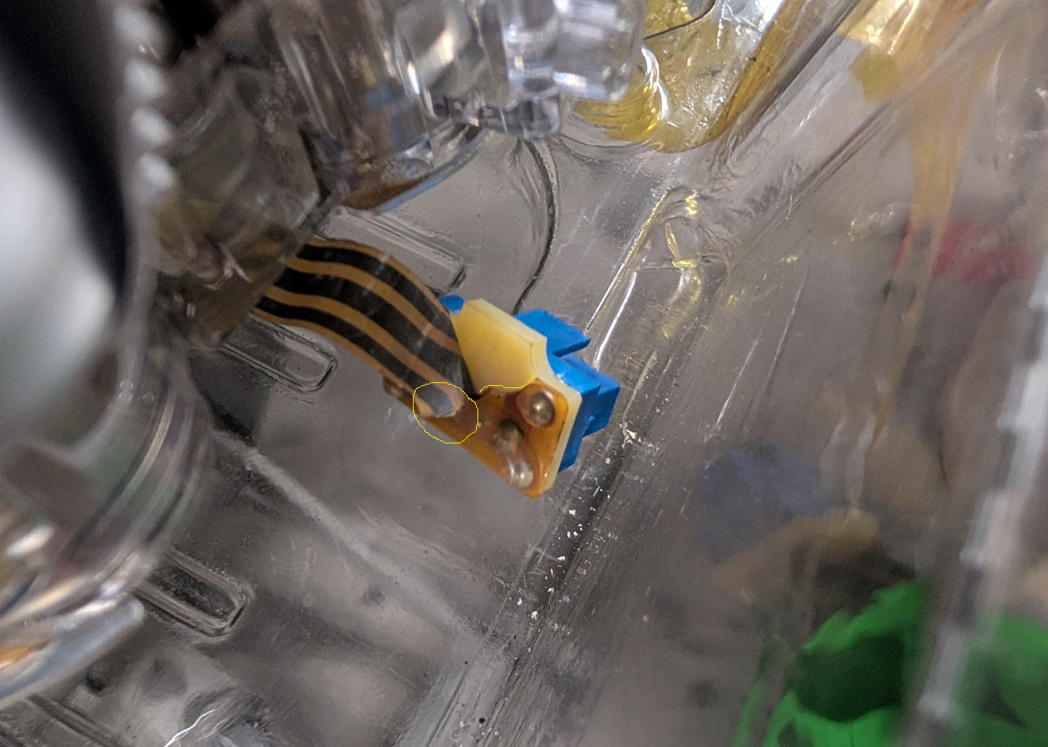

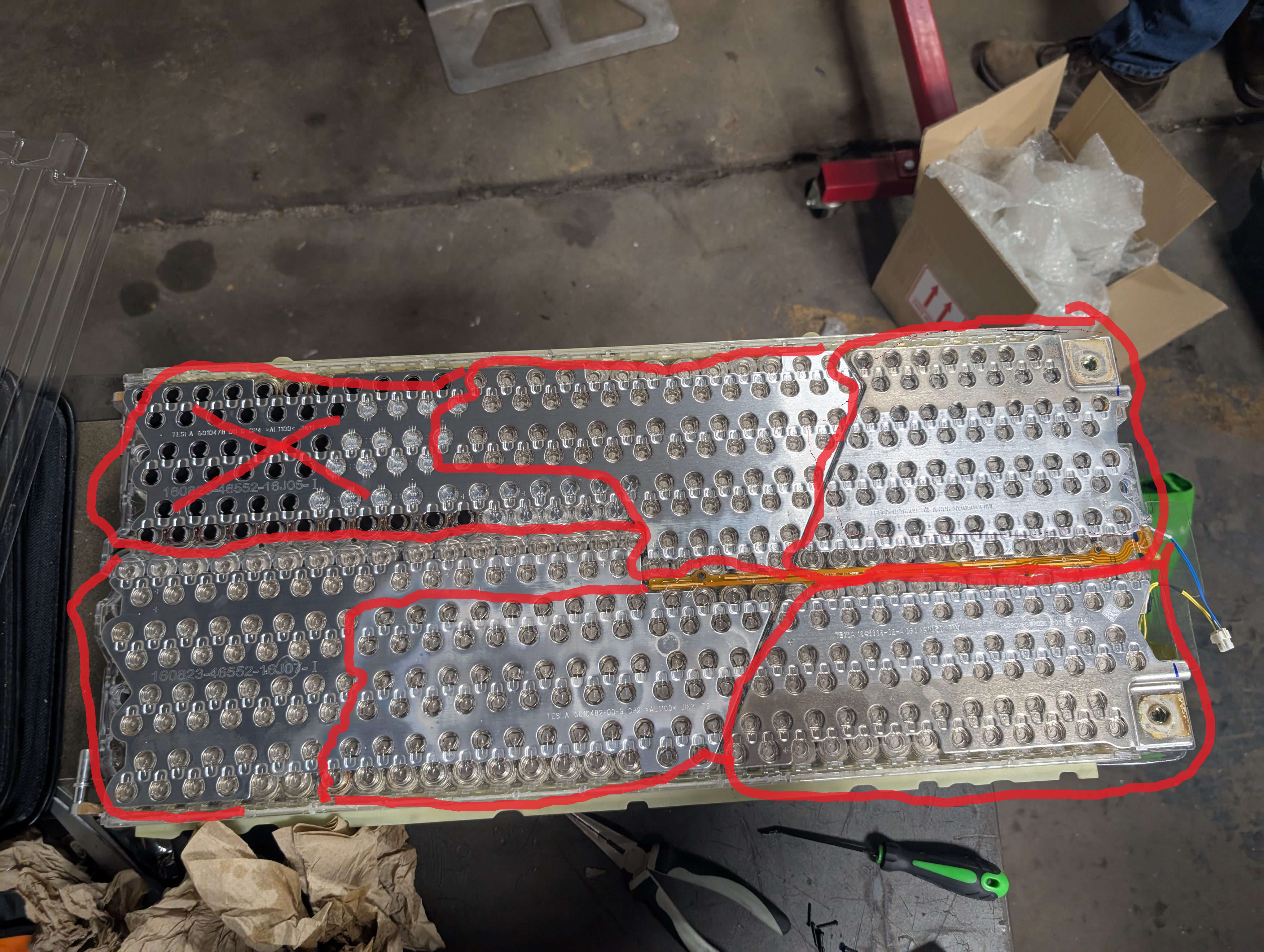

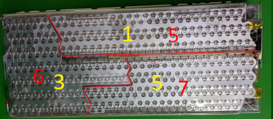

The more I think about it, the more I am convinced that the connection from cell 1+ to the board is interrupted. Your previous measurement with your tool says exactly the same thing. 3 bridged with 4 and line 1 free floating! I have marked which plates should be connected to which positions of the Molex connector (in yellow). I assume you are using a board like this!

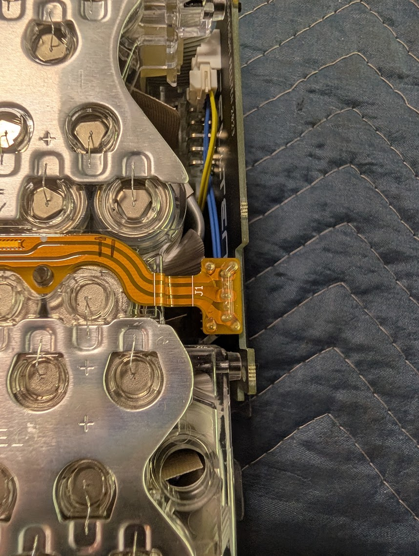

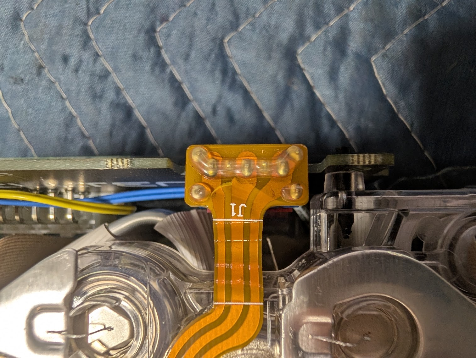

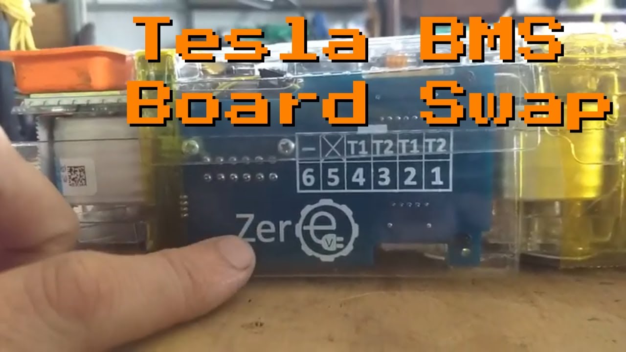

I am using one of the new Felten branded BMS swap cards like the one in your photo. I had 14 of them, so I did try more than one on this 5S battery to make sure the readings were not from a faulty BMS swap card.
I will use your numbers above to check out the readings on the plates today and report back.

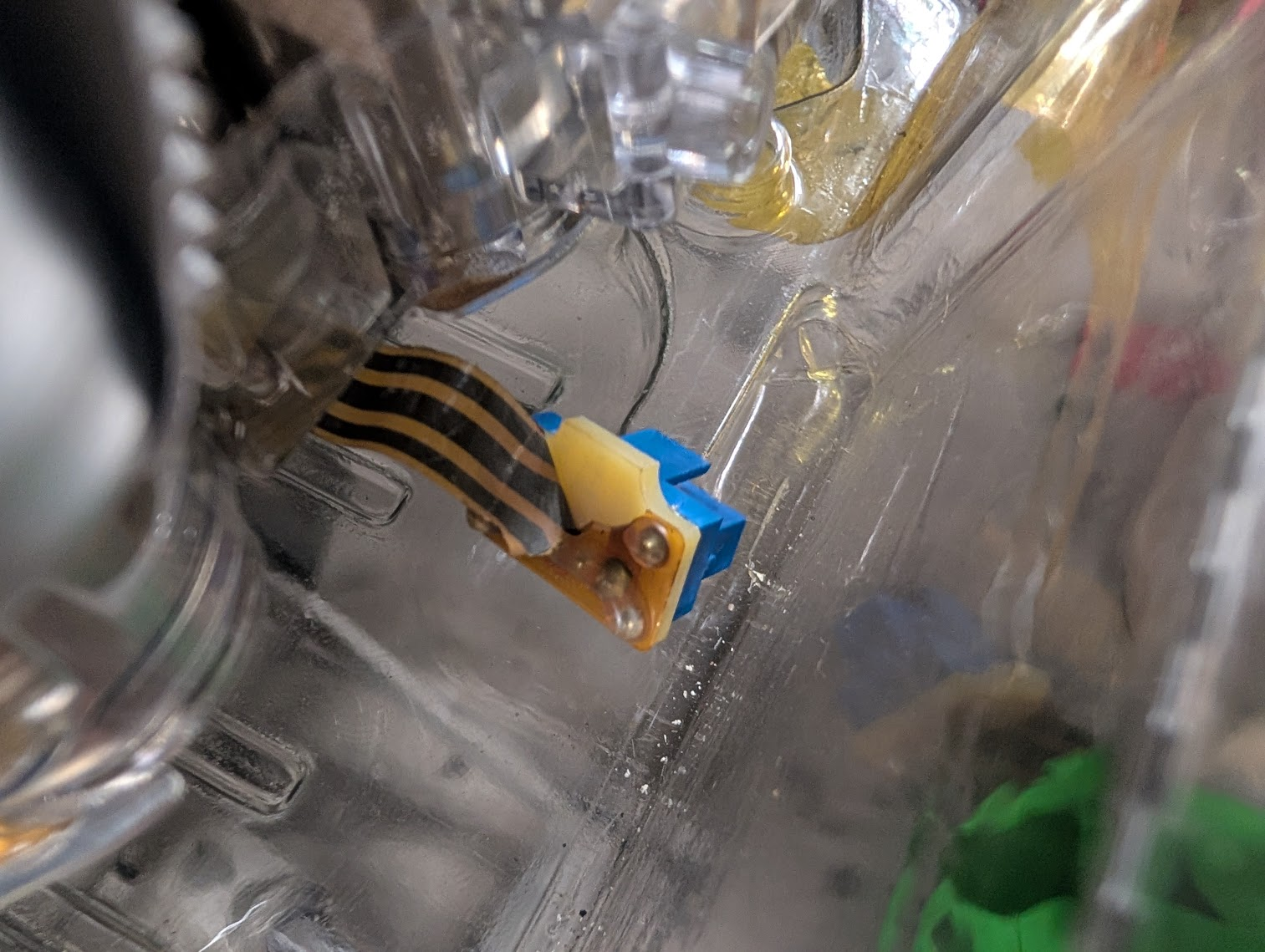

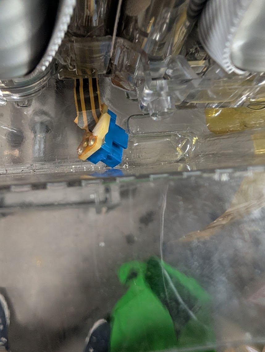

Here is a photo of the bottom connector to the BMS swap card from the battery. It does not look like anything is torn, but it feels like the cable it not fully connected to the connector piece.
I thought maybe because it is a 5S that the whole ribbon is not hooked up.

I can clearly see damage. The dark parts are the conductor tracks. One of the three is completely torn. It can't work like this, and my suspicion has been confirmed. You don't need to take any further measurements.

Well . . . I was afraid of this when I took the photo yesterday. Sorry I missed the tear originally.
Now, the internet is full of advice for what I can do at this point in time, but I always prefer the thoughts from this group of learned folks.
1. Fix the connection. How realistic is this at the connector vs. where it connects to the plates.
Additional photos of the torn connector:

Flat cables are easy to repair. Find a spot where the cable is wide, remove the insulation, and solder a cable in place, which you then connect directly to the plug.

Thanks. I will give this a shot next week. I fixed my Dad's old Black Knight pinball machine and had to deal with a lot of solder work on the analog copper wiring for the bumpers and such, so it will not be too unfamiliar to me.

Hi guys. I finally got around to repairing the 5S battery and took updated readings and it came out as this:
So the good news is that all cells are reporting in now. My next step will be sorting how to wire the MOLEX connector to the BMS for this 5S battery to address the fact that the missing cell reading is not at one end or the other. As I understand it, for the ORION BMS, I want to build up from 3 to 15V with the empty cell at the end of the line, as opposed to in the middle where it will think it has come to the end of the line and stop reading before we get to 15V. I will put this battery at the end of the line on the final harness (cells 73-83) in spots 7-12 of the harness and end up with 83 total cells as opposed to 84 with prior setup, so I want to understand this better before reprogramming the BMS with the new BMS.
I am not sure if it is as easy of this:

Hi again. I was thinking that it might actually matter to keep the cells in order of their ascension from 3 to 15, so would it instead be better to build it like this and just leave out one of the duplicate voltages?
I can ask the guys at Ewert as well, but wondered what you all thought.
