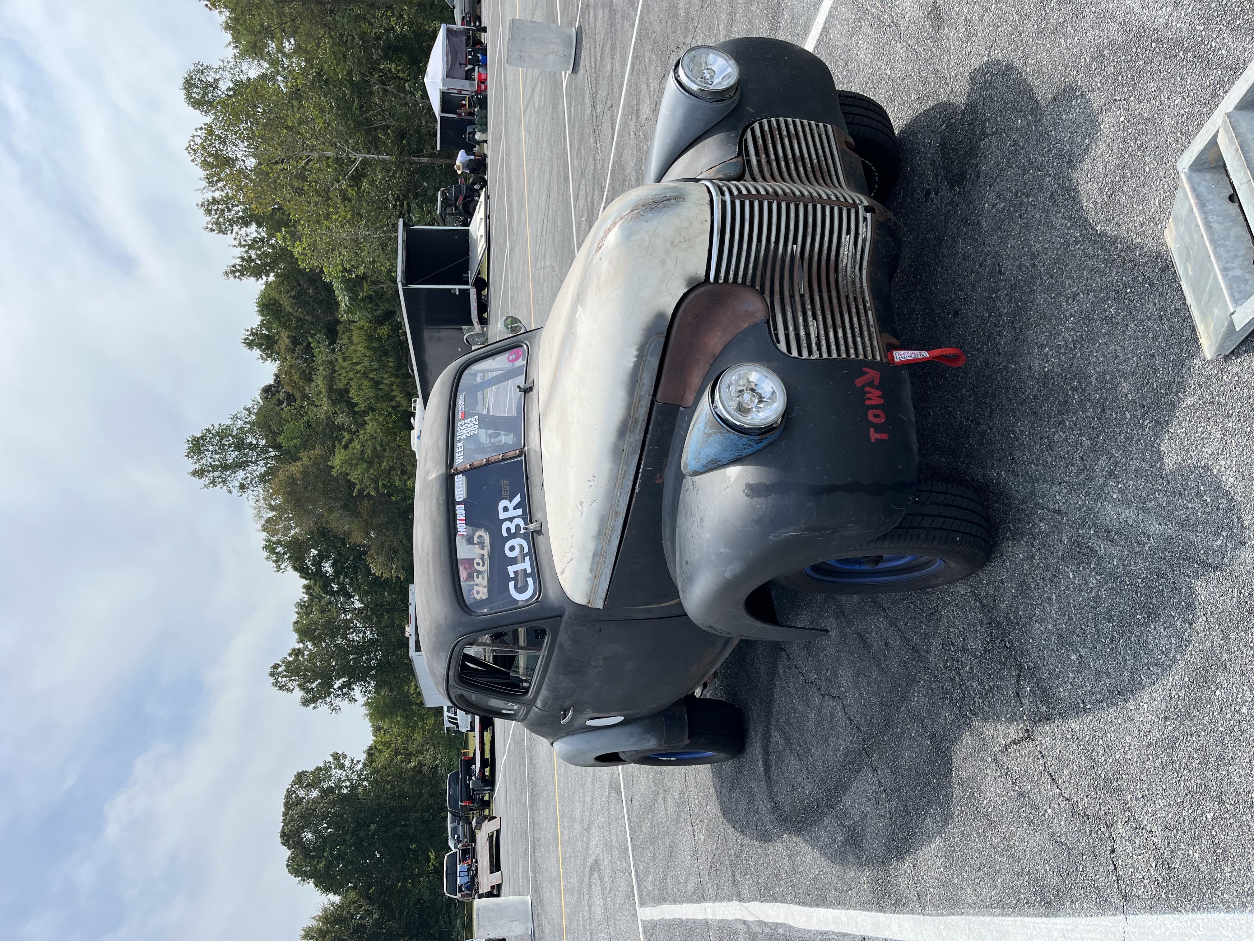

Well I'm fully registered and we are started on day 1! (Photos from last night) we have 3 EVs this year, me, a DC motored Elcamino, and a Lucid Sapphire.
Routes are here: https://www.hotrod.com/events/hot-rod-d ... tes-inside
I think that the car is finally what I thought it was from the start. Not perfect, but my goal is to put it in the 10s this week. The charging systems seem to all be functioning (even if the AC charging is still hacked together) and I mostly know what I'm doing.
