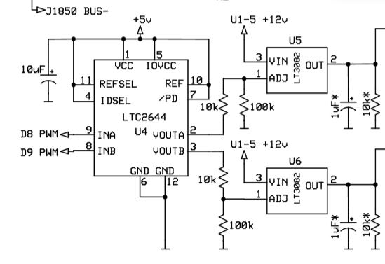

What about a LTC 2644, have used that many times where PWM filtering is not adequate.
https://www.analog.com/media/en/technic ... TC2644.pdf

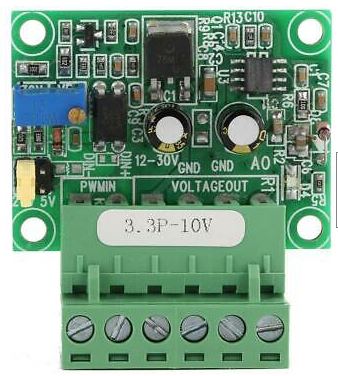

I used this module resently for a 0-5 volt controlled power supply:
https://www.ebay.com/itm/163596299408

I saw similar items on Amazon, my concern was quality due to the nature of emulating a throttle pedal I wanted as accurate as possible. I was actually looking at the LTC2644 - they have a LTC2645 demo board which is $75 unfortunately, and requires me to figure out how to get a 5V reference signal to it. Apparently the demo setup only does 0-2.5V output.
Also, wow that's crazy markup - the price of the device is $7 on digi-key. I guess I may end up designing a PCB for this (and probably something to handle cruise control as well). The non-CAN cruise control BMWs use a simple protocol that goes back to the 80s...but it's a pain to work with lol.
