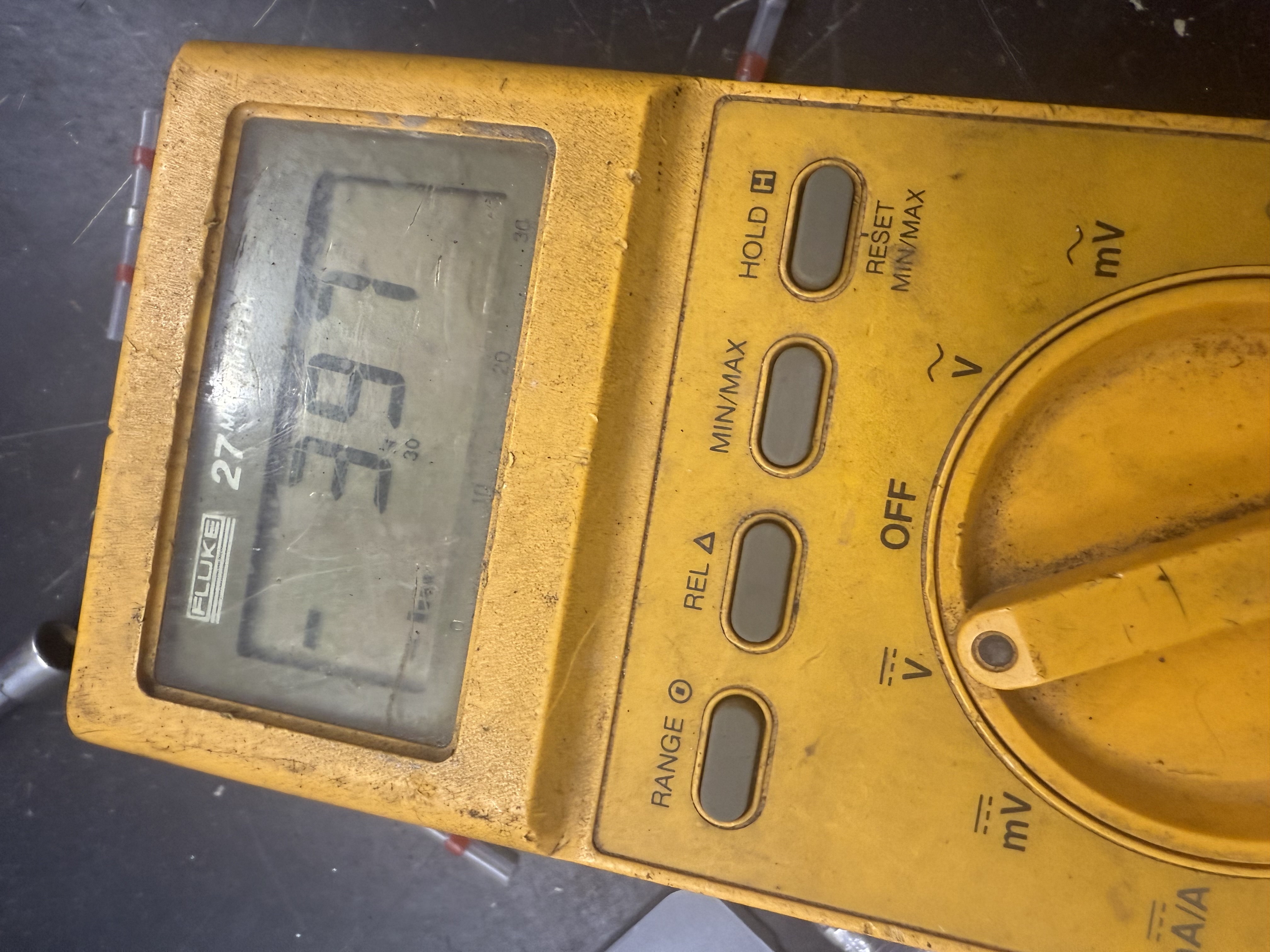

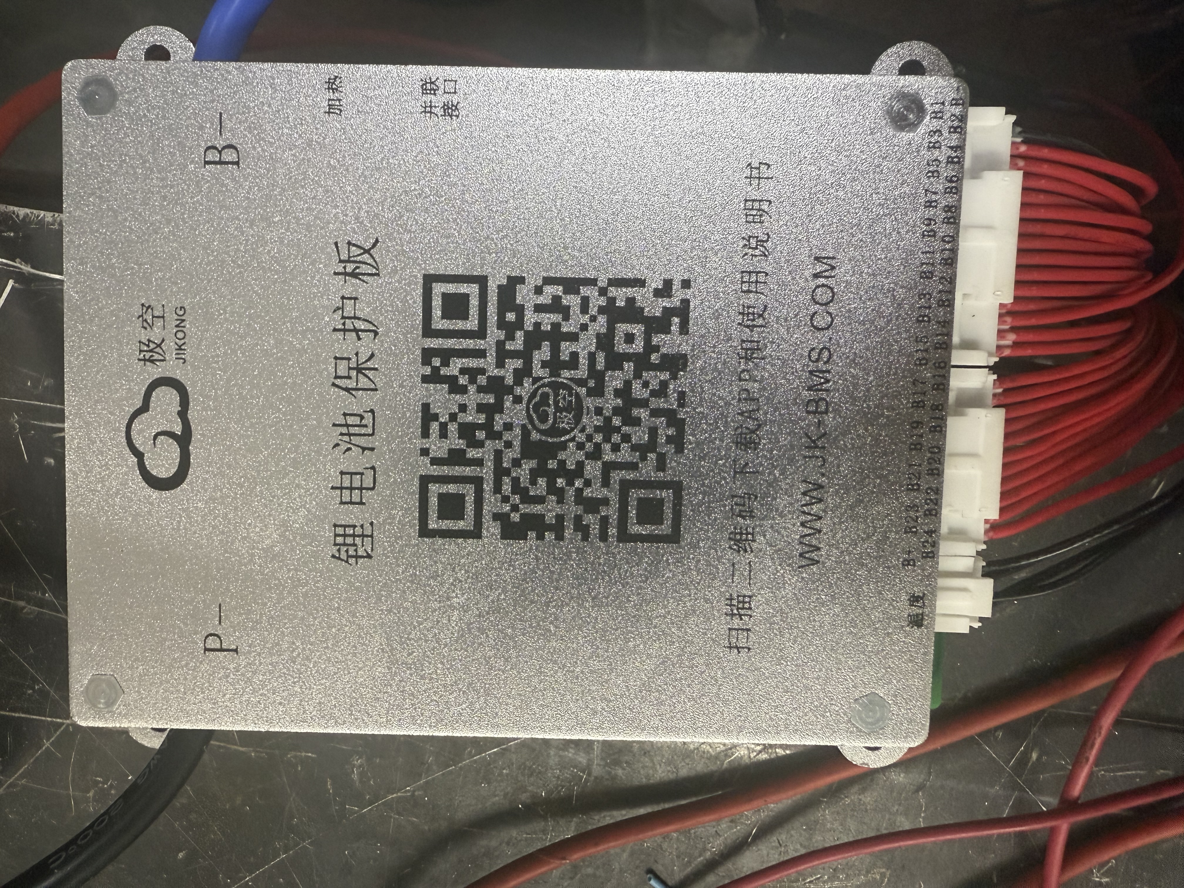

I’m testing battery packs from a Honda Clarity.

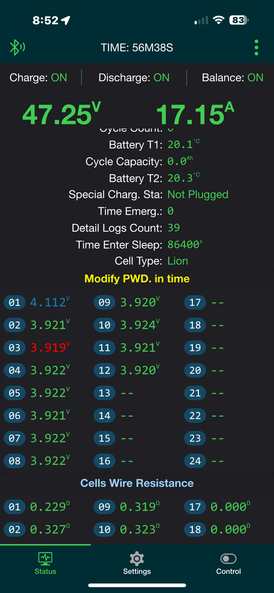

If I take my multimeter and check the cells they are all 3.97 but this reading is not the same in the jk app note cell 1 resistance and voltage. Any thoughts as to why? Image[/img]

Bad cell taps.. Chinese junk.. etc

Delete the chinese spyware app and try "overkill solar" app, there were some calibration offsets available there afaik, maybe those help

I found the calibration area ad put in a value nothing changed. Put the old value in and it is now correct. I'll take it.
