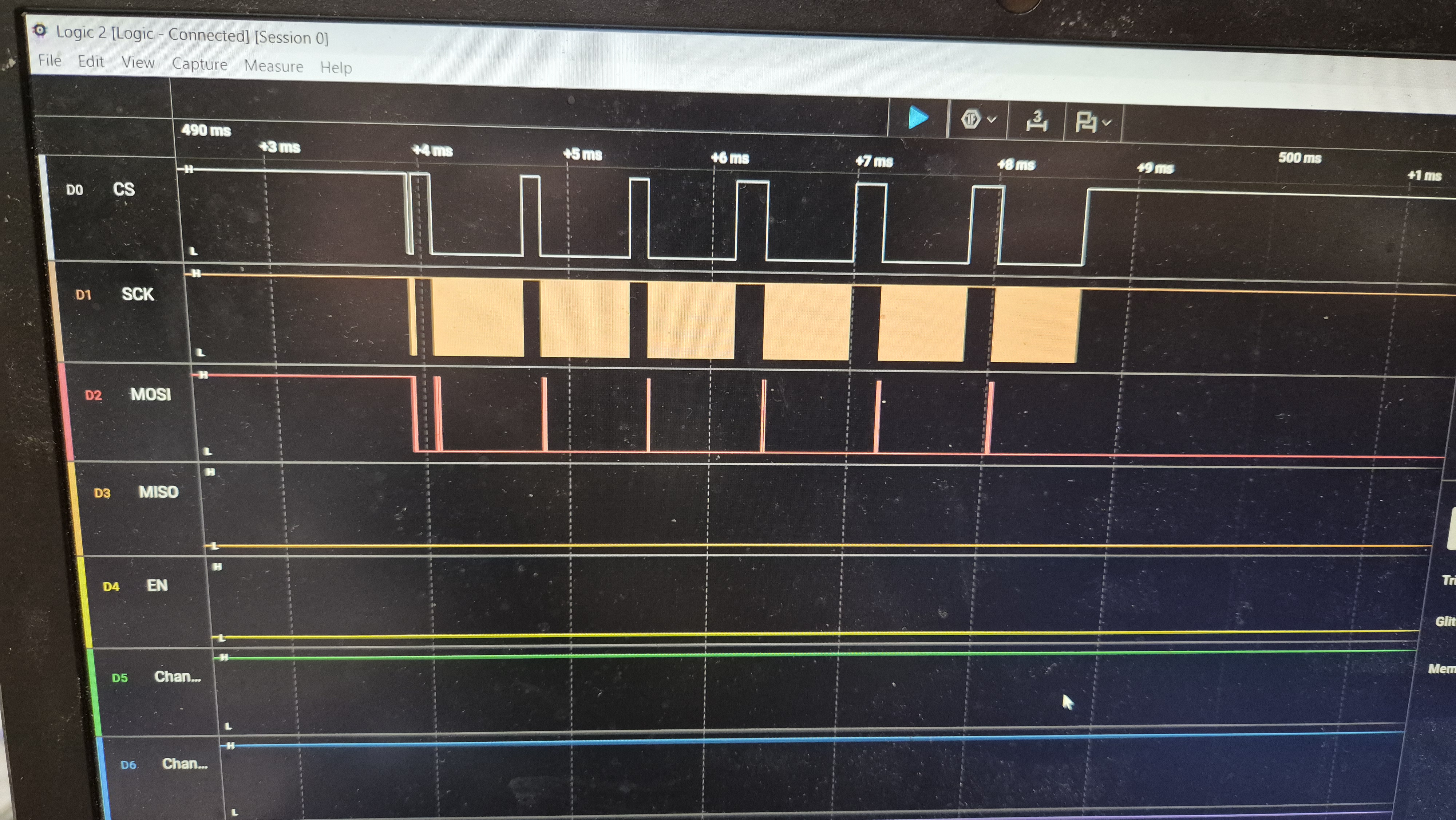

I dont think I have a logic analyzer, and how to catch up.
But why is CS and EN not the same as it is in batman.ods?

Posted: Tue Oct 07, 2025 2:57 pm
by hanskraayeveld
I have this logic analyzer in stock :D
I think: connect GND (power also needed?) and miso channel 1 mosi channel 2?

Re: Tesla model 3 BMB control boards
Posted: Tue Oct 07, 2025 4:33 pm
by tom91
Please grab a capture of a minute or 2 long and save it in the logic2 format and share it with us.
