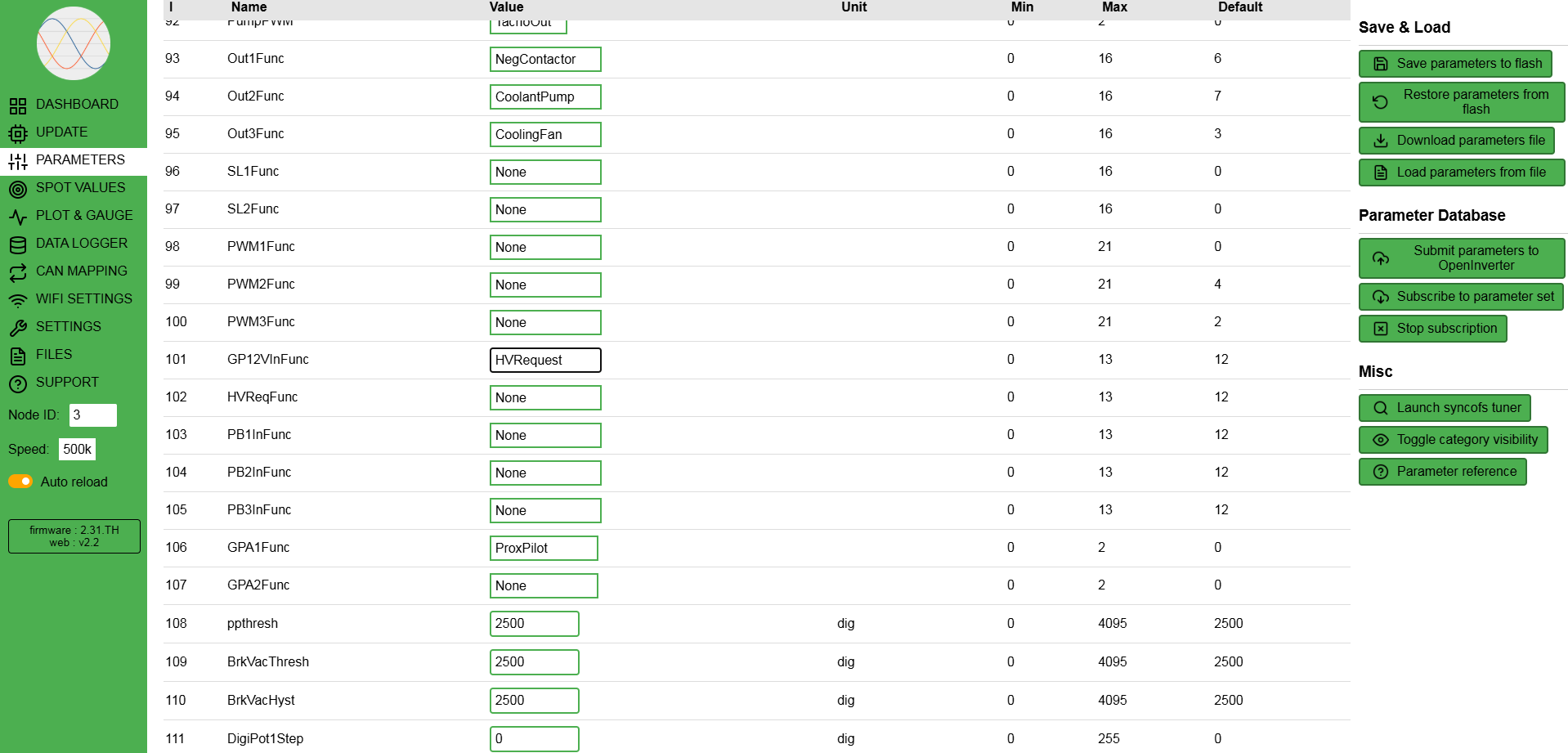

Re: AC charging with the VCU
Yes, I've already read that in the wiki, but what do I set in the VCU so that it goes into charging mode
is that right?
What software version are you on?
Main branch currently this pin function is not working. In vehicle testing banch: HVrequest just has it enable contactors for charging. No need for other settings.
Edit: Checked, you need to set charger to ext digital
