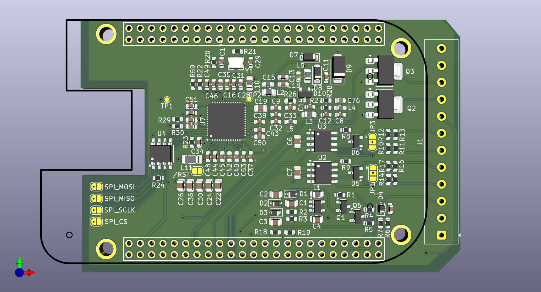

As mentioned here I've always wanted to create an all-in-one energy controller to clean up the mess in my basement. It is based on the popular BeagleBone Black or Green, so it's called a "cape".
Hardware-wise it is mainly communication stuff. The task of the thing is to control various energy conversion equipment such as
- PV inverters
- Batteries (or BMSes to be precise)
- CCS
- Relays
It also talks to web services such as spot market price providers, data loggers and of course has infinite connectivity over Wifi or Ethernet.
I pretty much copied the hardware that I currently use so the interfaces are
- 2x CAN
- 1x PLC for CCS charging, including CP signalling
- 2 relay drivers
- Input for push button with LED (button just shorts out LED current
I might add RS485 as well as I have only used up 10 of 12 screw terminals.
So far this is how it looks PLC part still to be done.

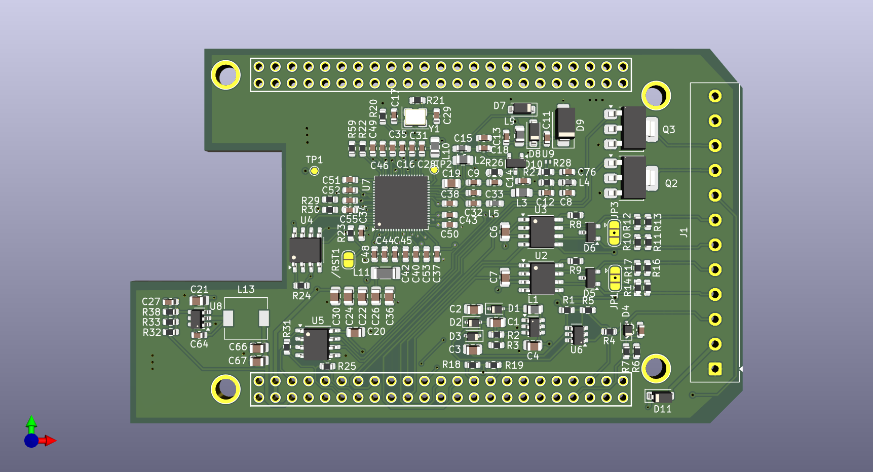

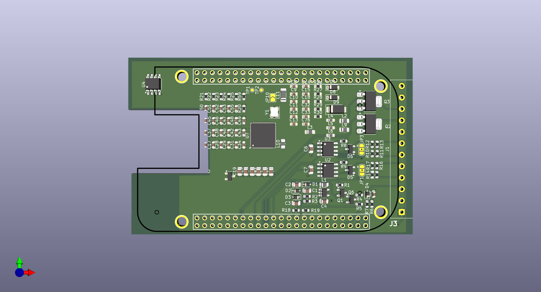

First cut done, only RS485 missing SPI flash can be connected to the SPI bus for initial programming by the BeagleBone itself

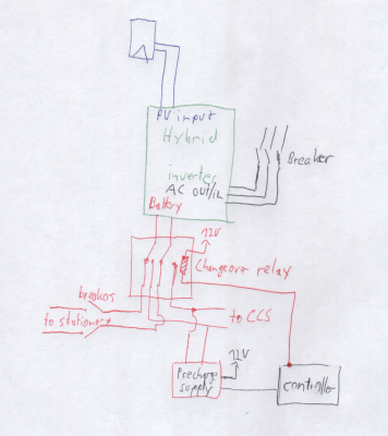

Super interesting subject ! Could this be used to do bi-directional charging from solar / to house ?
- uhi22
- Posts: 1244
- Has thanked: 245 times
- Been thanked: 684 times
Re: Energy Controller including CCS interface
This is exactly the topic. However, this is just the control box, it needs an additional power device like a hybrid solar inverter.

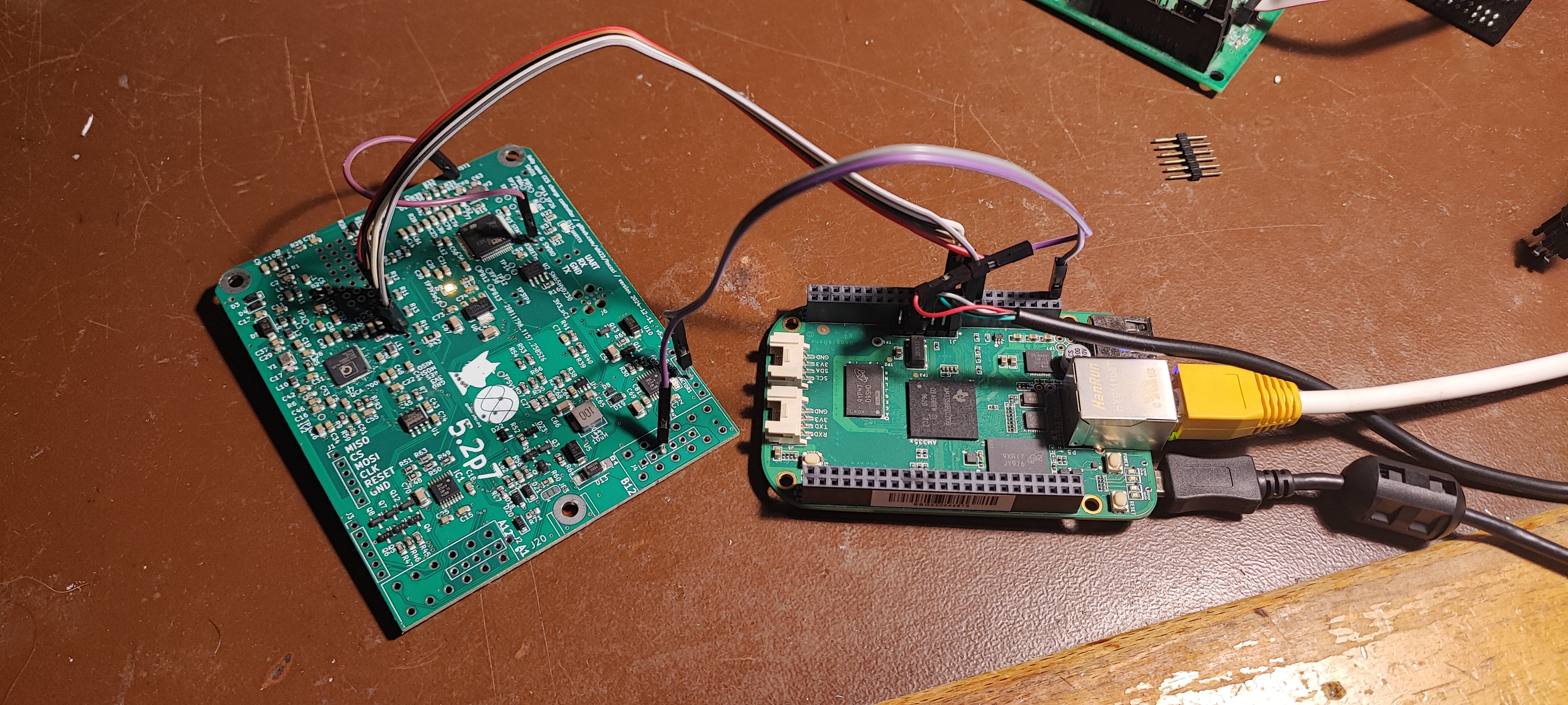

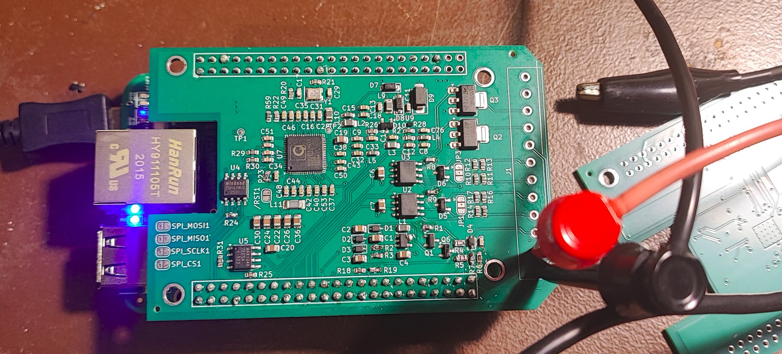

Almost worked out of the box, some resistors were not fitted and there ist a minor mistake in the pin mapping of the boost converter that makes +-12V for CP PWM.
With that fixed we have PWM and the QCA chip is detected and communicates

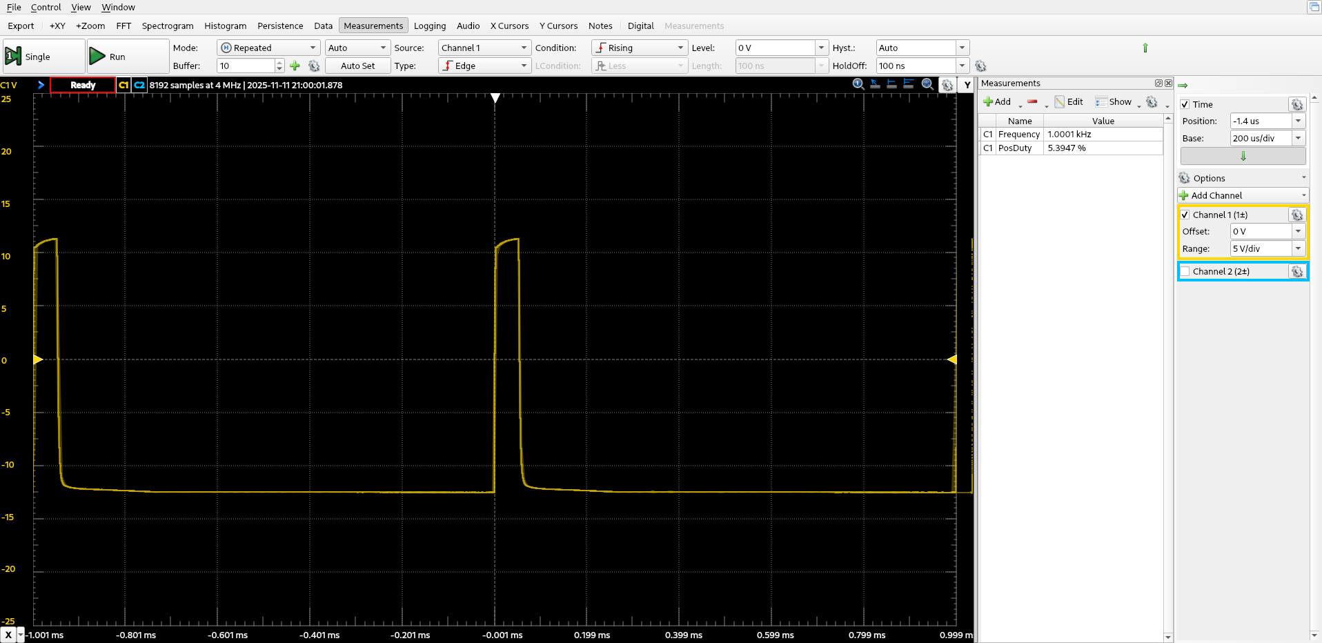

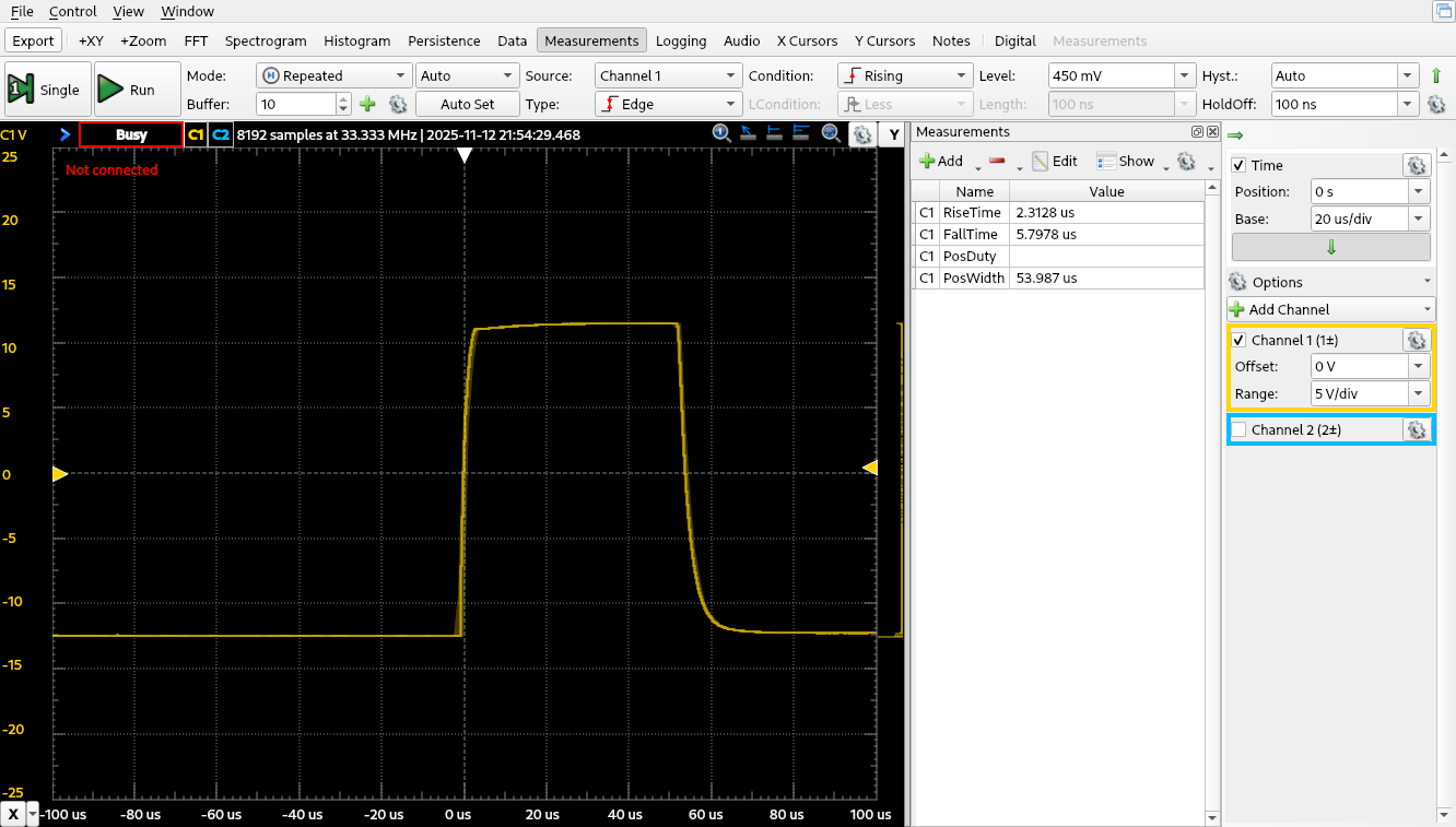

Flashed the image directly today, works well with the solder jumpers.
Changed the PIB file for EVSE use and simply flashed with plctool. I had to change more than the 4 items commonly mentioned here, used this script: https://github.com/qca/open-plc-utils/b ... ac/evse.sh
I also changed the MAC address using "modpib -m" as otherwise it's the same as Focccis.
Then started CP PWM, connected to Foccci which woke right up and off we go into CurrentDemand
Analog reading of CP PWM divided value reliably detects states A-C
Also tested CAN which also works. Very suspicious, no mistakes? huh

- Been thanked: 1918 times
And here's another closeup of the CP PWM slew rate
On V2 will probably change it to TLV1805

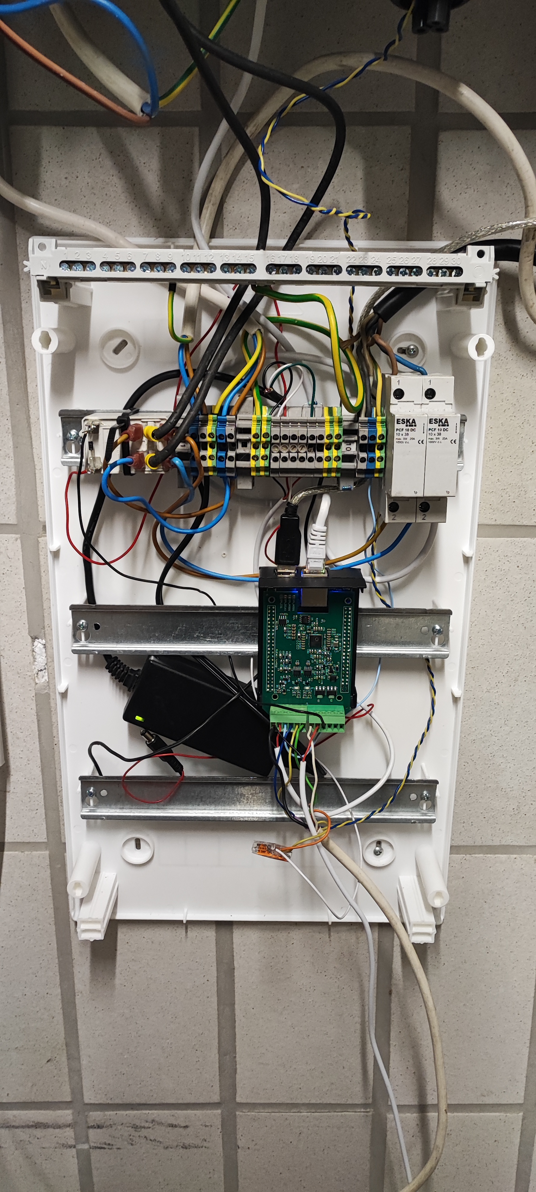

And it's in
Just a reminder of what it used to look like
The switch became redundant for now because Ethernet is now only needed for inverter comms.
With a bit of consolidation I could go back to my single DIN rail enclosure

haha, managed to boot strap the SPI flash without solder jumpers on my second module
All you need is the firmware image from uhis repo (https://github.com/uhi22/Ioniq28Investi ... _33_79.bin) and open-plc-utils.
We start with
See how it says "BootLoader"? That's what we want.
Then do
First command results in 3 files from the "file system" of the flash. We merge them back together.
Then we splice 64k from the beginning of the file which brings us to the firmware "partition" and repeat the same trick. Same with the PIB file which we modify for EVSE use.
And now we get
So the new firmware and the new MAC address from the PIB file.
We start with
> int6klist -v
< 00000000 00 B0 52 00 00 01 AA 38 9F A8 13 32 88 E1 00 00 ..R....8...2....
00000010 A0 00 B0 52 00 00 00 00 00 00 00 00 00 00 00 00 ...R............
00000020 00 00 00 00 00 00 00 00 00 00 00 00 00 00 00 00 ................
00000030 00 00 00 00 00 00 00 00 00 00 00 00 ............
00000000 AA 38 9F A8 13 32 00 B0 52 00 00 01 88 E1 00 01 .8...2..R.......
00000010 A0 00 B0 52 00 06 0B 42 6F 6F 74 4C 6F 61 64 65 ...R...BootLoade
00000020 72 00 00 00 00 00 00 00 00 00 00 00 00 00 00 00 r...............
00000030 00 00 00 00 00 00 00 00 00 00 00 00 00 00 00 00 ................
00000040 00 00 00 00 00 00 00 00 00 00 00 00 00 00 00 00 ................
00000050 00 00 00 00 00 00 00 00 7C 58 1B 00 00 00 00 00 ........|X......
00000060 01 00 00 00 3F 00 00 00 00 00 00 00 ....?.......
00:B0:52:00:00:01
Then do
nvmsplit -v CCM_FlashDump_SpiFlash_2MB_Ioniq_00_33_79.bin
nvmmerge CCM_FlashDump_SpiFlash_2MB_Ioniq_00_33_79-0* > softloader.nvm
tail -c +65537 CCM_FlashDump_SpiFlash_2MB_Ioniq_00_33_79.bin > firmware.bin
nvmsplit firmware.bin
nvmmerge firmware-* > firmware.nvm
tail -c +917505 CCM_FlashDump_SpiFlash_2MB_Ioniq_00_33_79.bin > pib.bin
nvmsplit pib.bin
nvmmerge pib-0* > evse.pib
setpib evse.pib 74 hfid "EVSE"
setpib evse.pib F4 byte 2
setpib evse.pib 1653 byte 2
setpib evse.pib 1C98 long 10240 long 102400
setpib evse.pib 1F80 byte 0
setpib evse.pib 16D2 byte 0
setpib evse.pib 16D3 byte 1
modpib -M 04:65:65:FF:FF:00 evse.pib
plcboot -F -S softloader.nvm -N firmware.nvm -P evse.pib

Love how this project combines a whole bunch of open source projects into one.
Would it be possible for you to draw a simple overview diagram of how the energy flows work?
I am not 100% sure how you move the power in and out of the Car and the stationary battery.

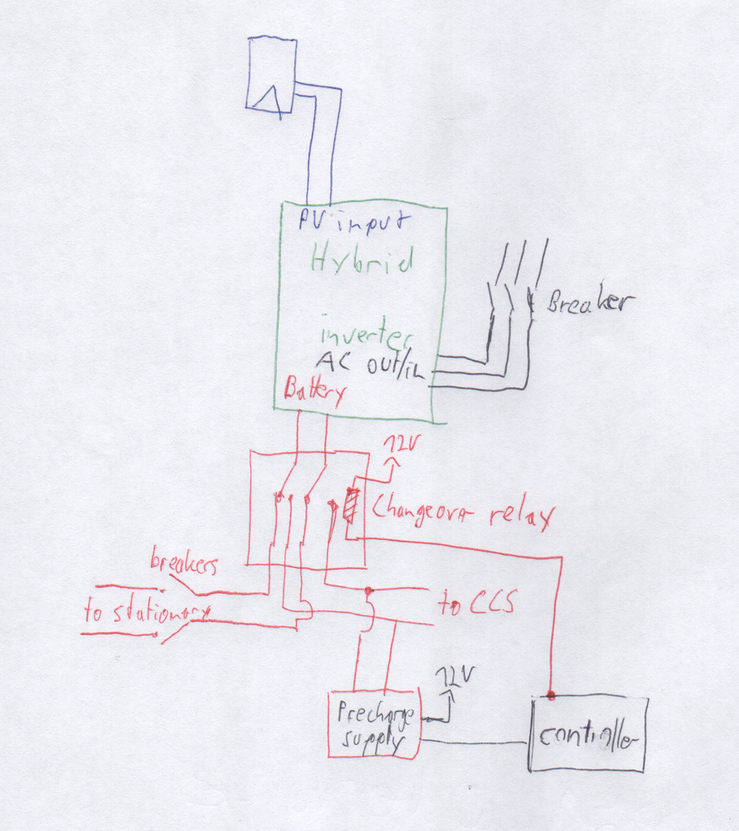

Thanks. Would love to base it on something fancy like HomeAssistent but have 0 experience with these platforms. At least now it's very slim.
Tried to make a diagram. You can see that no energy can be exchanged between stationary and car battery. Perhaps you could connect the stationary to a free PV input if you really wanted that option. Not sure if inverters with 2 battery inputs allow exchanging energy between the two?
- Posts: 2962
- Has thanked: 330 times
- Been thanked: 848 times
Thank you for the clarifying diagram.
Ah so you are doing a change over between the two. Which is fine really, unless you are looking to do "cheap" EV charging, but could always just use the AC charging for that.
Of course you could look at a DC-DC stage to link the vehicle via CCS to the battery bank.
I am currently working on Battery Intergrated Chargers with multiple power modules AC/DC and DC/DC. Im sure one could get second hand modules or "abuse" a Hybrid PV inverter some more. Key issues with PV inverters is the referencing they do as they are not galvanically isolated so you have a to be extra careful.
Did some minor changes for V2
It has a 7-20V 28V power supply now and a comparator for PWM generation.
Removed the Flash SPI for now as it can be programmed from the host.
- Posts: 2962
Can you not go to 30V make it 24V compatible? Lots of industrial gear is 24V.
Does it have reverse polarity protection?
In fact it's the TPS54302 also used on Foccci, so takes 28V. Yes D11 protects against reverse polarity.
