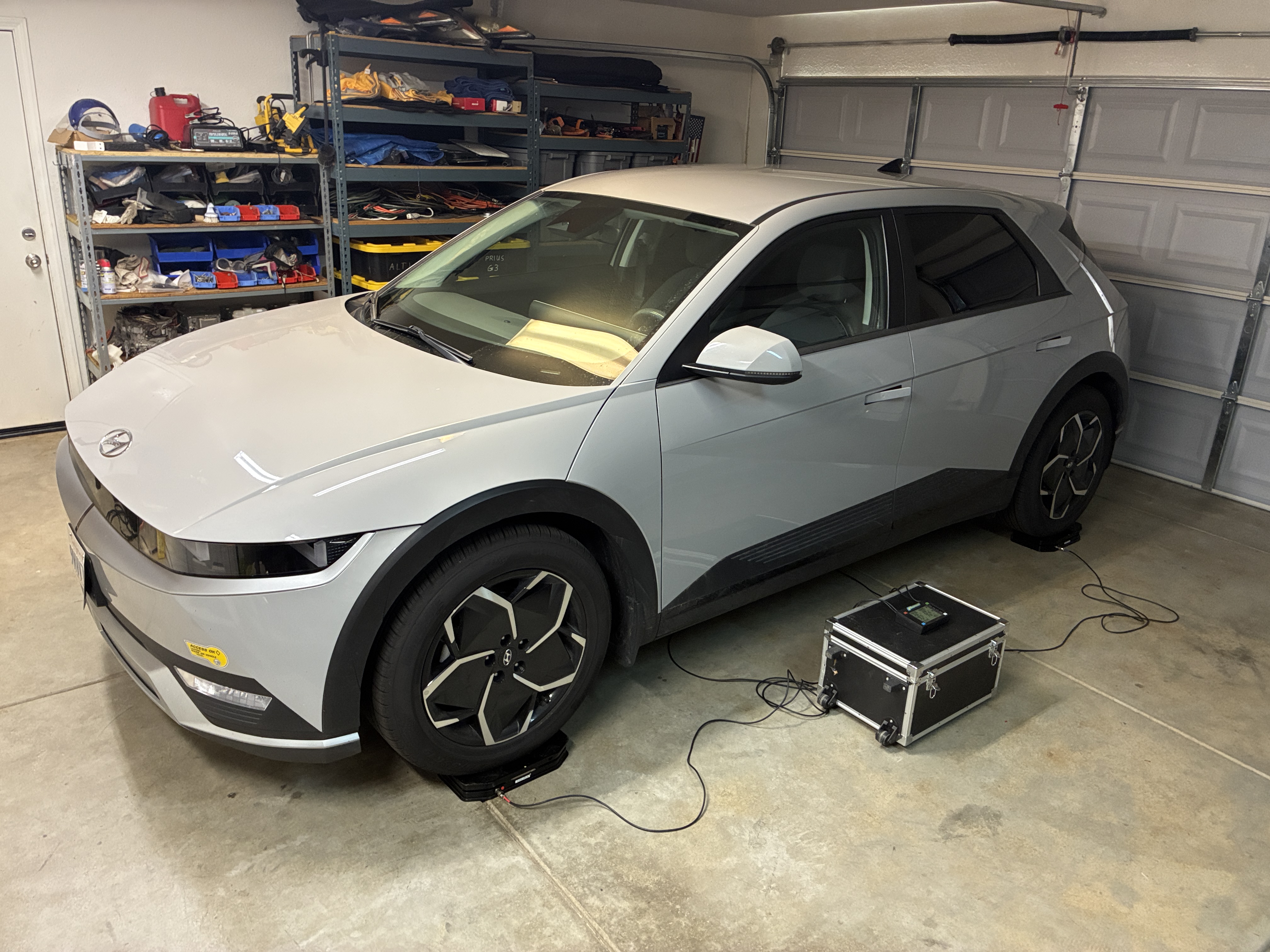

please forgive me as this is not a DIY conversion, but you may find the information useful
since the weight on the Wiki is all over the place I decided to find out for myself what my 2022 77.4 kWhoured rear wheel drive only Ironic really weighed

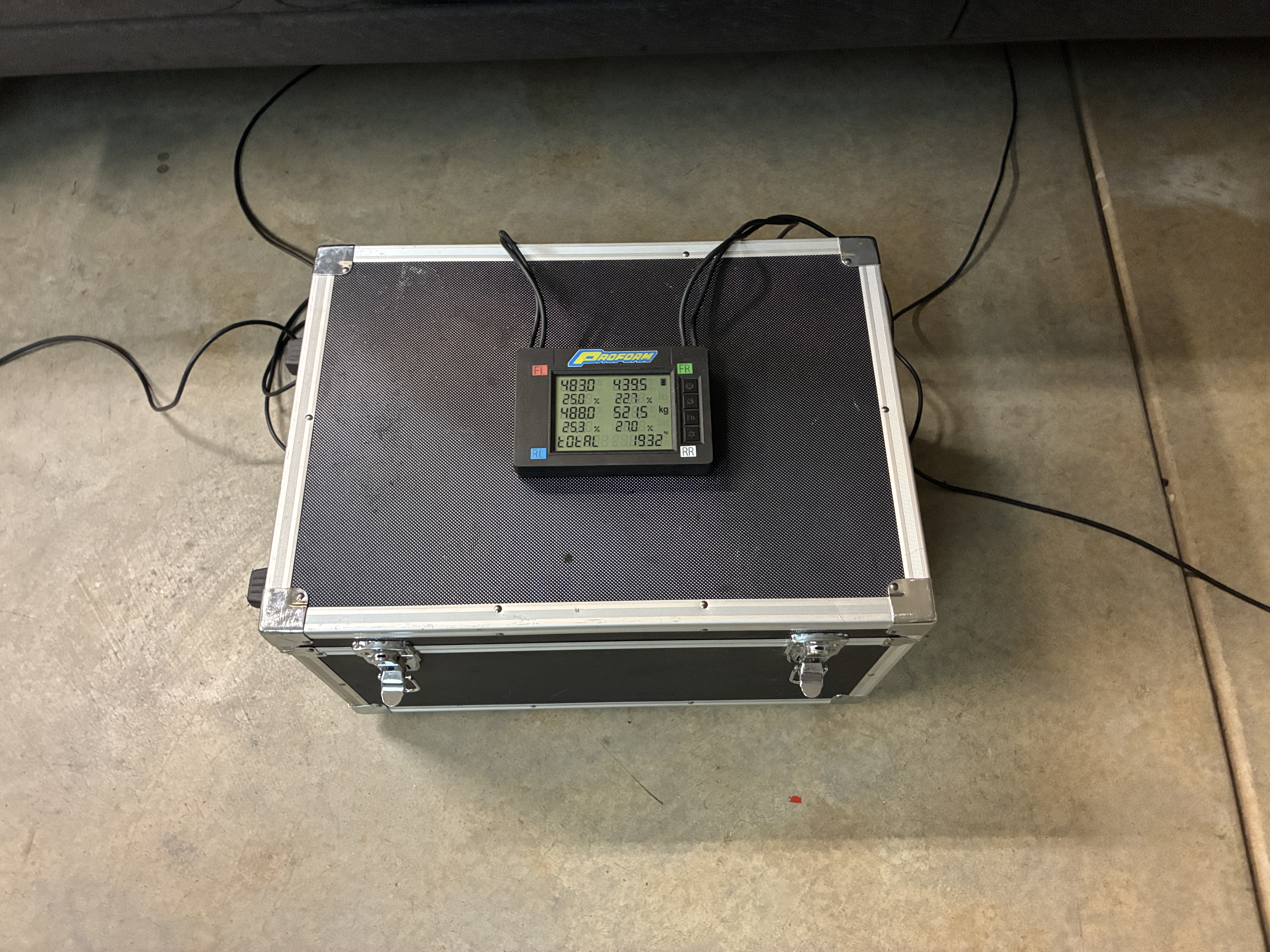

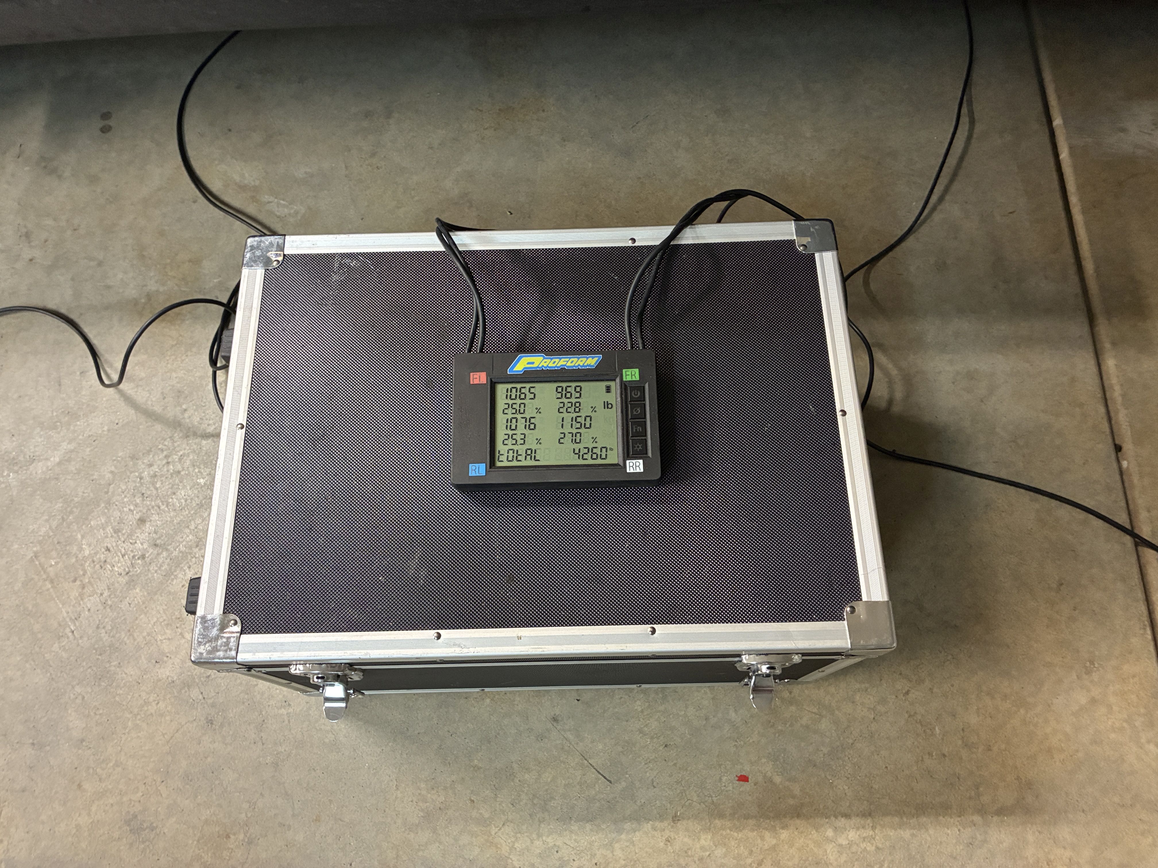

PROFORM
5000 Vehicle Scale Syste
Part No. 67650

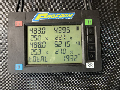

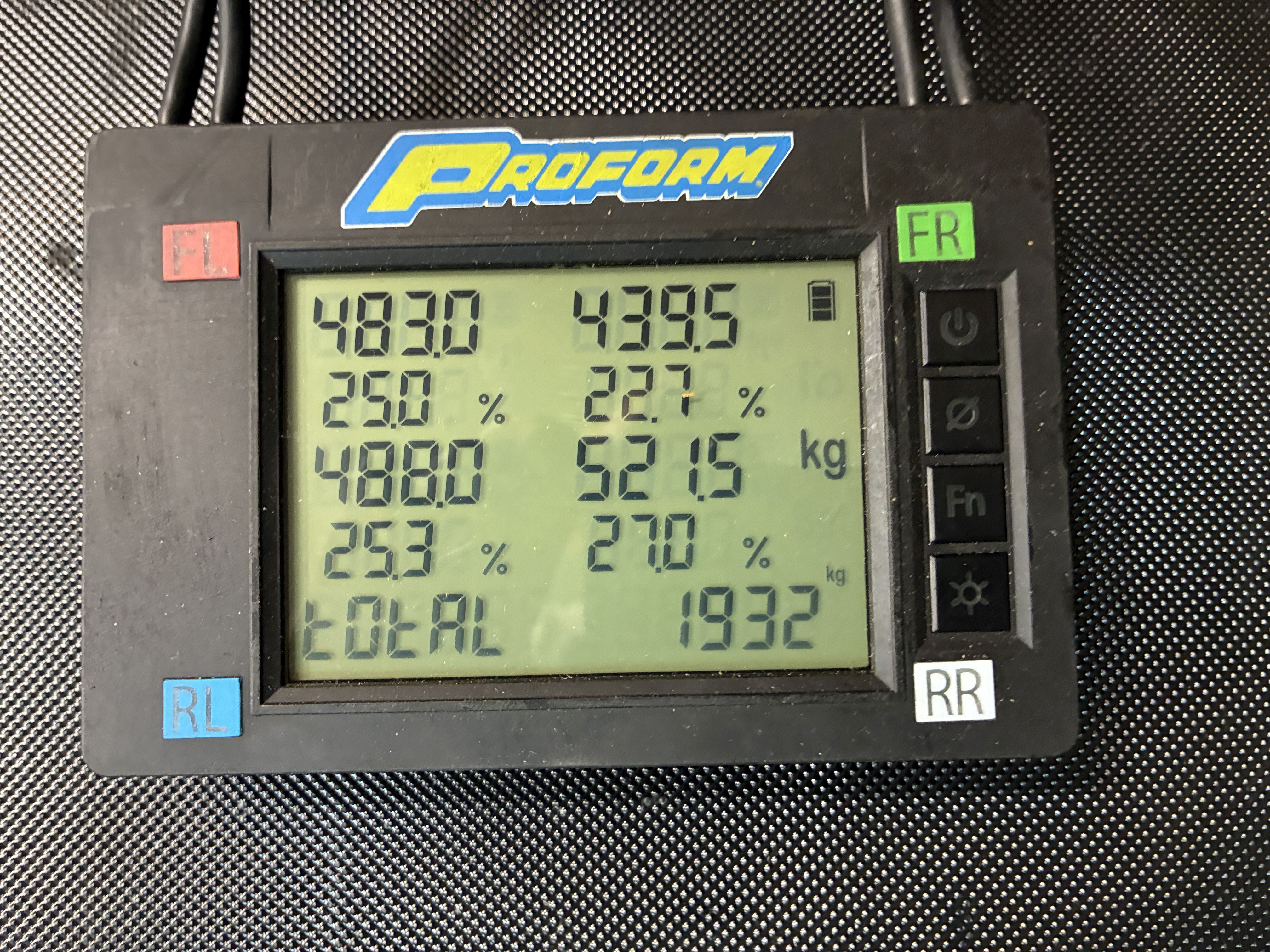

First in KGs

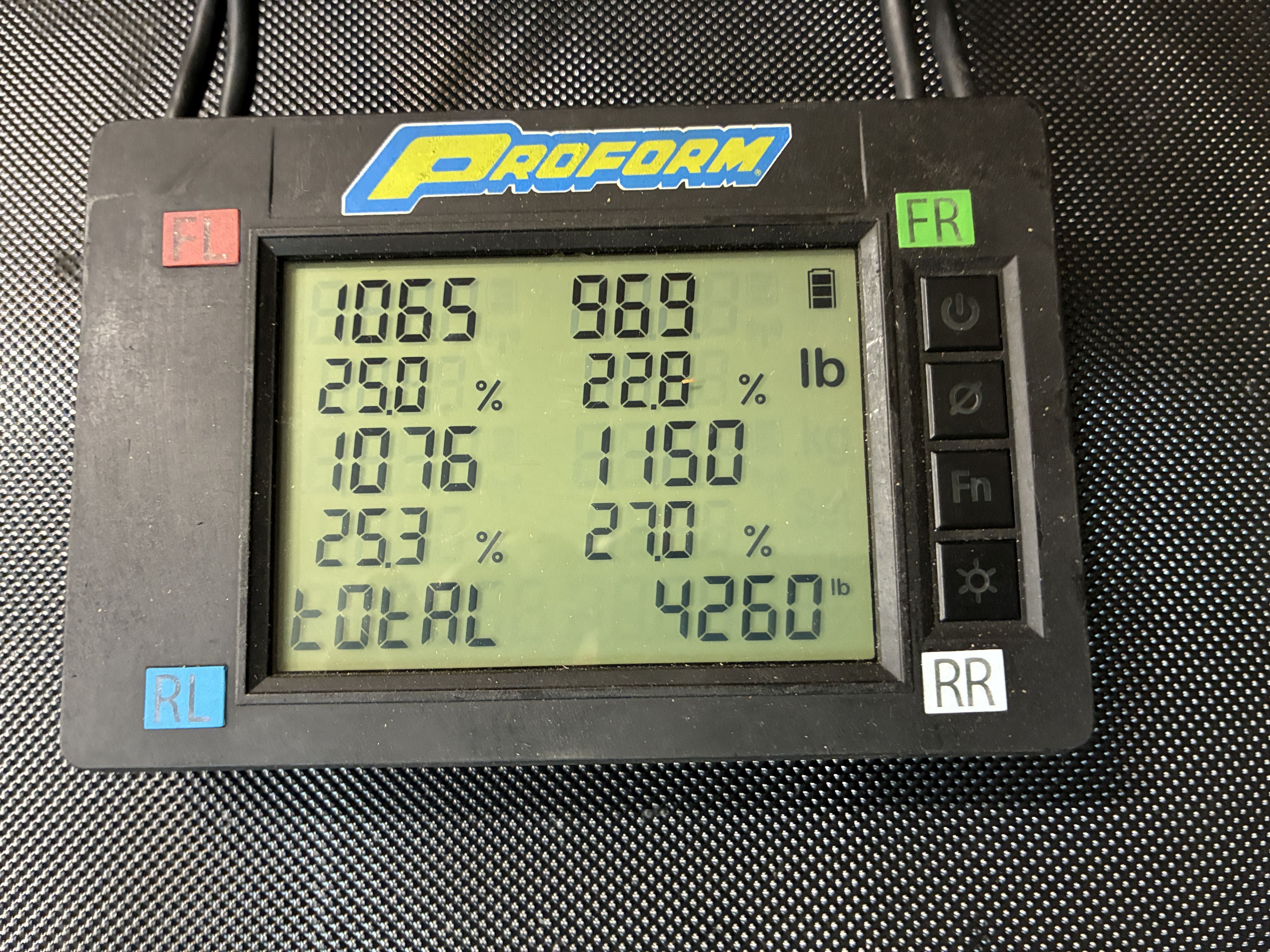

and now in Freedom Units
I weighed my 2022 RWD Ioniq 5
