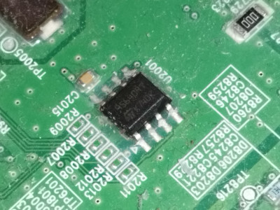

hi all, i need some help, i'm not used to working with E.V's but a friend asked me for some help, he bought a 2018 ioniq with a bad motor, it blew the capacitor in the inverter and apparantly the whole board is fried, he bought a replacement but when installed immo error comes up, he's asked me if it's possible to clone the replacement but i honestly have no idea if it's even possible, any help or suggestions are welcome, i've posted some pic's,

The guys on german goingelectric forum did this, by using the CPU board of the original car in the exchanged inverter.
An other option could be to read out the two controllers, there are 14-way socket pads on the board. I have no info whether they enabled the jtag lock.

i found an eeprom 95640 with the vin number inside, i took a chance and swapped the eeproms

Indeed, this is great. I would have espected they use internal flash for this purpose.
Now I see
Ioniq EEPROM in PCU
Ioniq EEPROM in PCU

Ok guys, I got an update, when I swapped the 95640 eeprom into the doner inverter the immo faults have gone but still have these faults that were on the original inverter, at this stage, I'm lost
