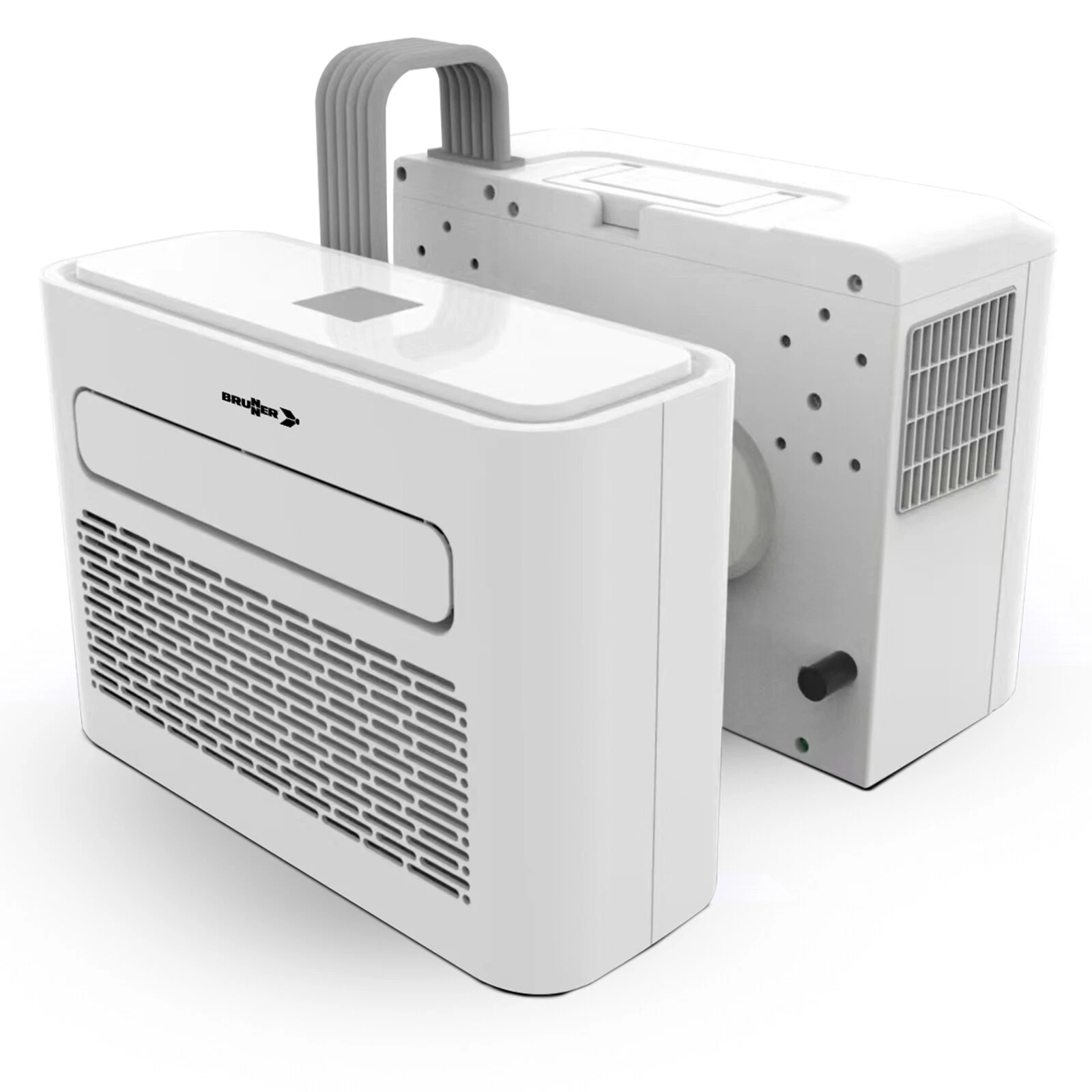

Yes I have. I found 3 models on ebay: https://www.ebay.de/sch/i.html?_nkw=sta ... &_osacat=0
Perhaps I could make them fit in the trunk but they are rather bulky.
There is also split versions: I have space below the wheelwell because the muffler used to sit there. Just a whole lot of debris there

Please correct me if I am wrong but are these pretty much the same as so called "mono block" heat pump heaters/air conditioners?
I am looking for things for my Triumph Spitfire project but I think this is too big and heavy...
Still, an interesting idea!

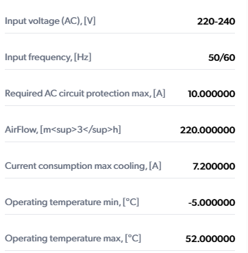

Hm...johu wrote: ↑Thu Dec 04, 2025 6:26 pm Typical compact heatpumps output about 2.5 kW of heat and use like 500-800W of electricity. The slimmest one I found is 260mm. Also currently looking at caravan air-to-air heatpumps (e.g. https://www.dometic.com/de-de/produkt/d ... 9620013224) as they would skip the tiny heater matrix and losses in the engine compartment. Not sure if I can find one that fits though
I have given this some thought and it seems you already have some components that were made for the car enviroment...
The DC to AC inverter which you can use to power climate module in your trunk
https://openinverter.org/forum/viewtopi ... 142#p86142
Yuo would have to be carefull as 7.2A fuse means about 1600W which is just out of range for that Mitsu unit... Maybe it can work with a little overhead... I bet you can have a remote to switch the unit ON and set it to heating or cooling...
- Been thanked: 1913 times
Re: Heating and Cooling the car with a heat pump
Wouldn't be a problem to roll with the Chinese board for now which happily supplies 10A all day long, as long as none of it's shortcomings stop it from working alltogether.

Hm... for car i think those units are a bit shady. They are not meant for harsh enviroment that a car is. Namely vibration and temperature variations.MattsAwesomeStuff wrote: ↑Mon Dec 08, 2025 11:54 pm Unrelated to cars, but related to homes, I think this new A/C design will basically make everything else obsolete. It's amazingly more efficient for a small modification to existing A/Cs.
Motorhome units however would do i think... need to try one
If you find a unit that has the specs you want, but you can't fit it in its current physical form in the space you'd like to utilize. I've taken units such as these before and "repackaged" them into a form that'll better physically fit the new purpose. You can take units apart and relocate major parts such as the evaporator, condensor, compressor without invalidating the design and control electronics of the unit. You just have to have some HVAC service tools. Which I have anyway because they are so useful on all kinds of projects.
The only tricky part is recalculating the new refrigerant volume. Because this kind of repackaging typically involves lengthening refrigerant lines. But it's not that hard to do if you measure superheat and sub-cooling on the unit at a reference running condition and then use that data and the same running condition on the re-packaged setup to get the refrigerant charge right. Plus, most of the new variable compressor speed system have to account for such a wide range of operating conditions, and have such a large refrigerant accumulator, that if you get the refrigerant charge in the ball park, they'll work fine.
