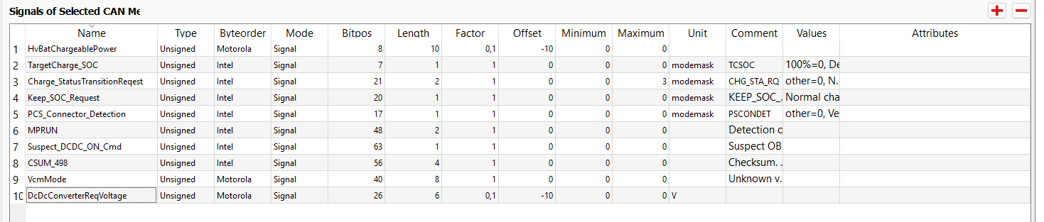

Like Dala states in his repo readme
Browse database file with an editor like Kvaeser database editor 3
The information you need should be there (row 10) :)
This snip is from EV-can_AZE0.dbc
In current Zombieverter implementation, there is a fixed value 0xAC for byte 3.
I'm not fluent in Bits and Bytes, but I think this translates to 14,3V as constant voltage request for the DCDC. If I recall, I have measured such voltage from battery when my setup is in run mode.
Interested to see your implementation, if you would be kind enough to share.
This has also been on my list of interests as I also want some smarter charge logic for my 12V battery charging. Especially since I have an electric winch which has a hefty amp draw on high load pulls (+400A)
