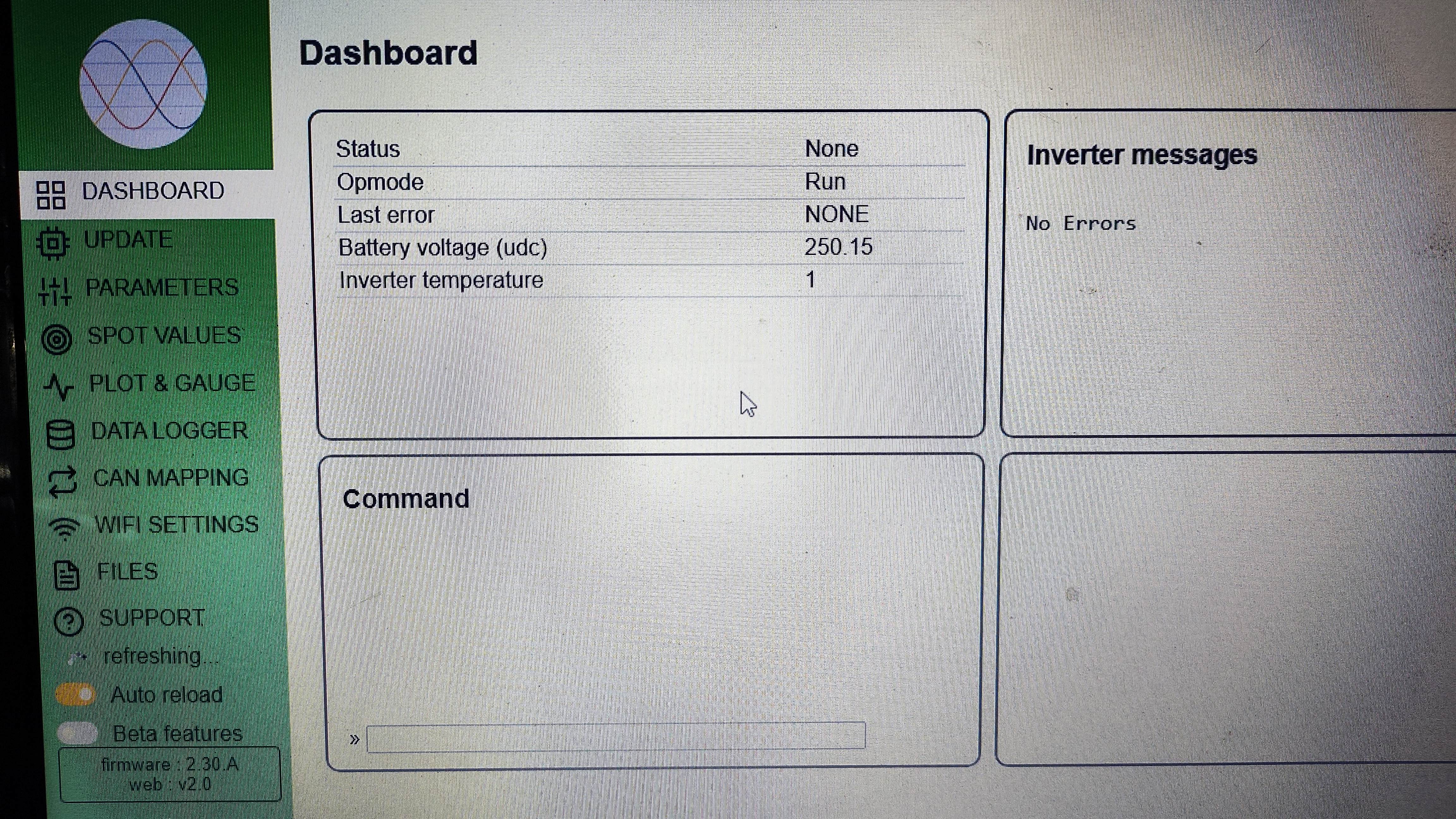

Hello,
I need help getting my Outlander Rear Inverter running under zombieverter.
I couldn't get it running on version 2.22a, so I updated zombieverter to version 2.30a, which didn't work.
Connecting a different inverter also didn't work.
Parameters INVudc, tmphs, tmppm the receive stably from inverter.
The resistance between CAN H and CAN L is 59 ohms. The resistance on the ISA and zombieverter is 120 ohms.
I probably missed something important.

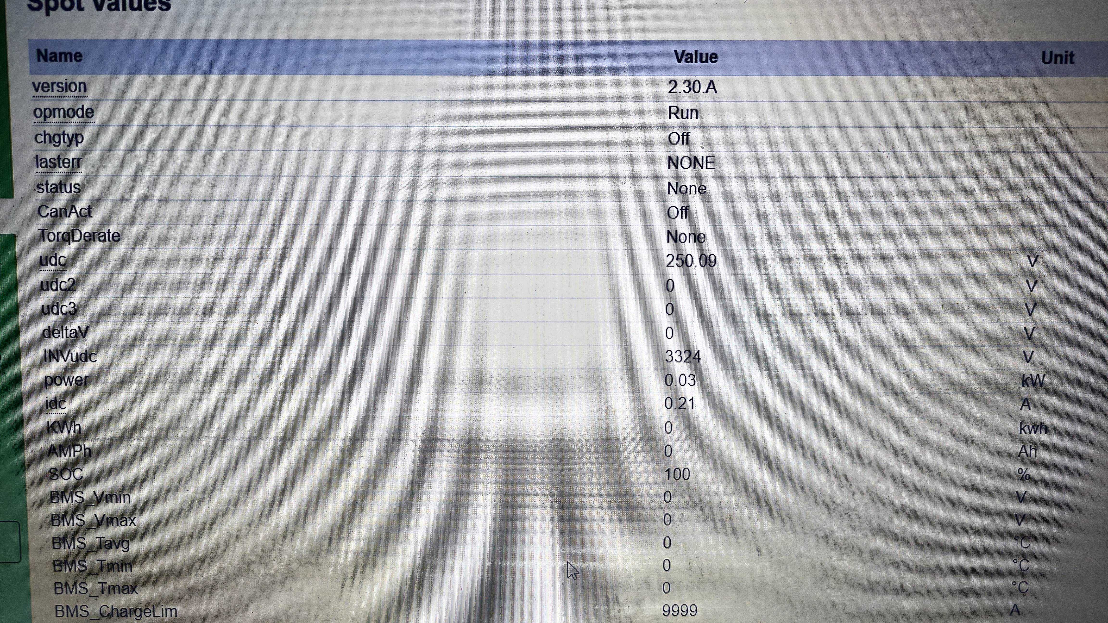

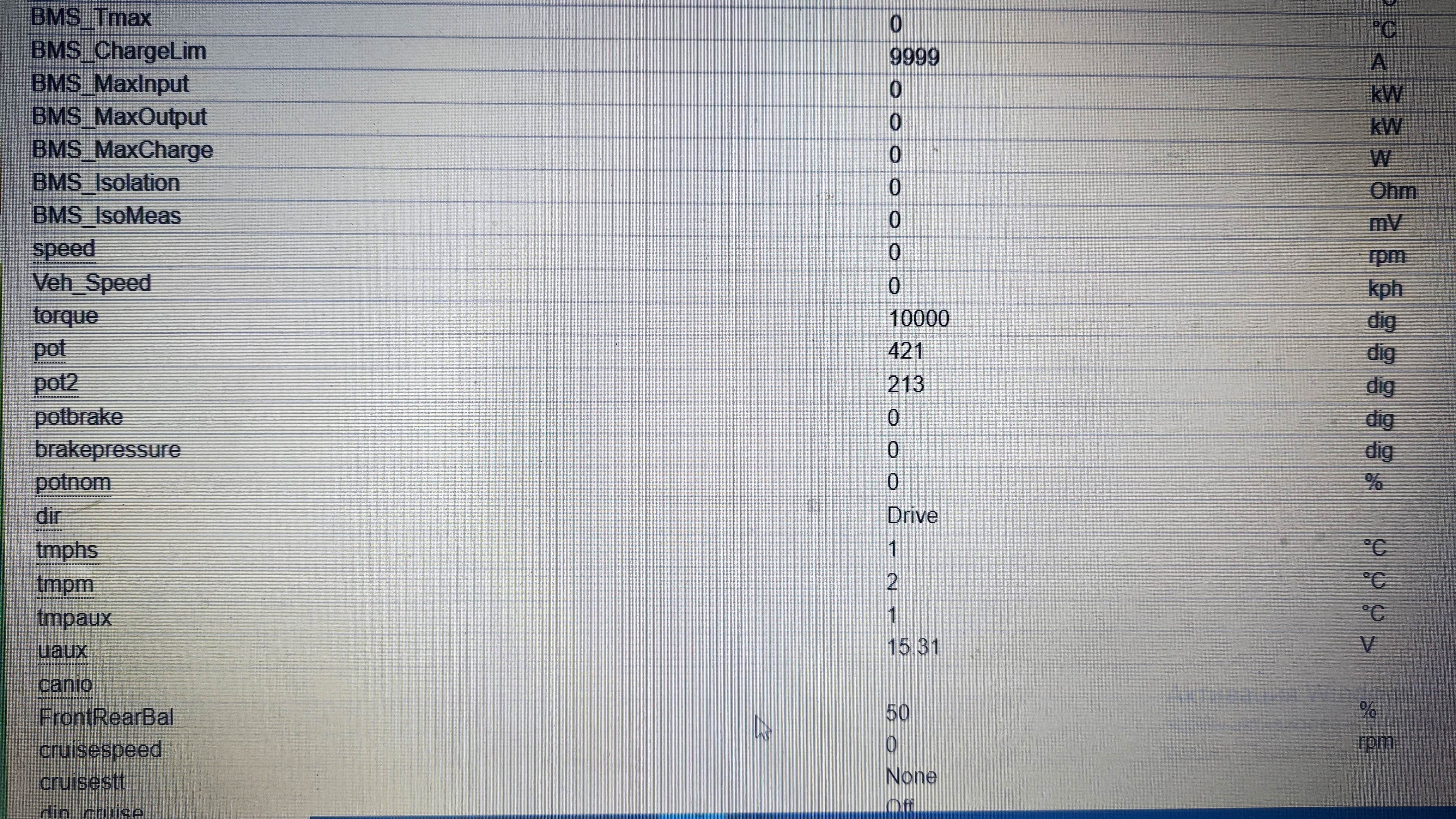

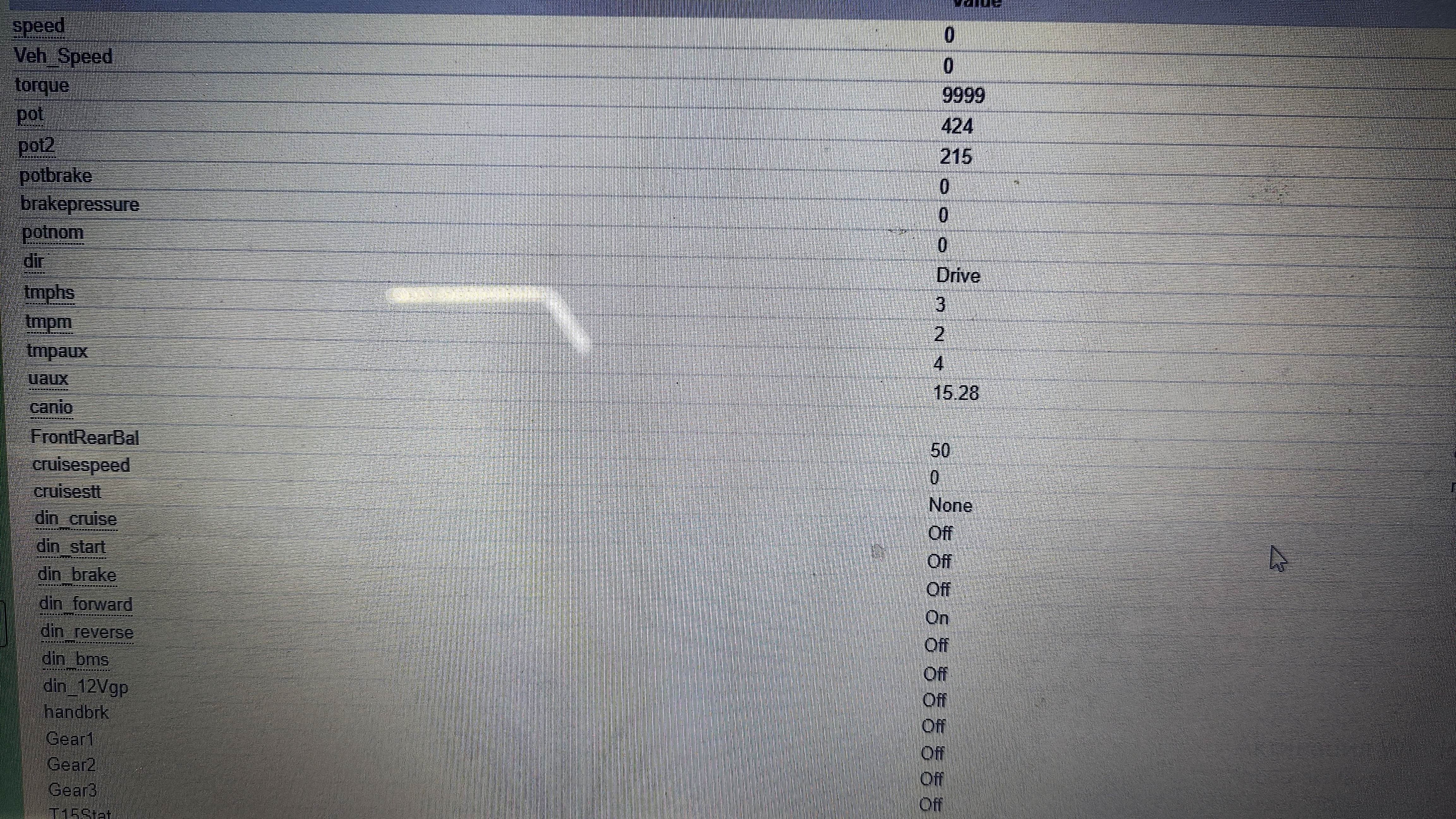

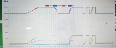

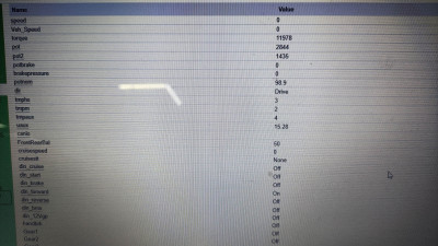

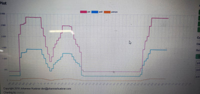

student wrote: Mon Feb 23, 2026 4:29 am INVudc, tmphs, tmppm the receive stably from inverter.
Good, and pictures shows also udc and power values so CANbus should be fine to both inverter and shunt.

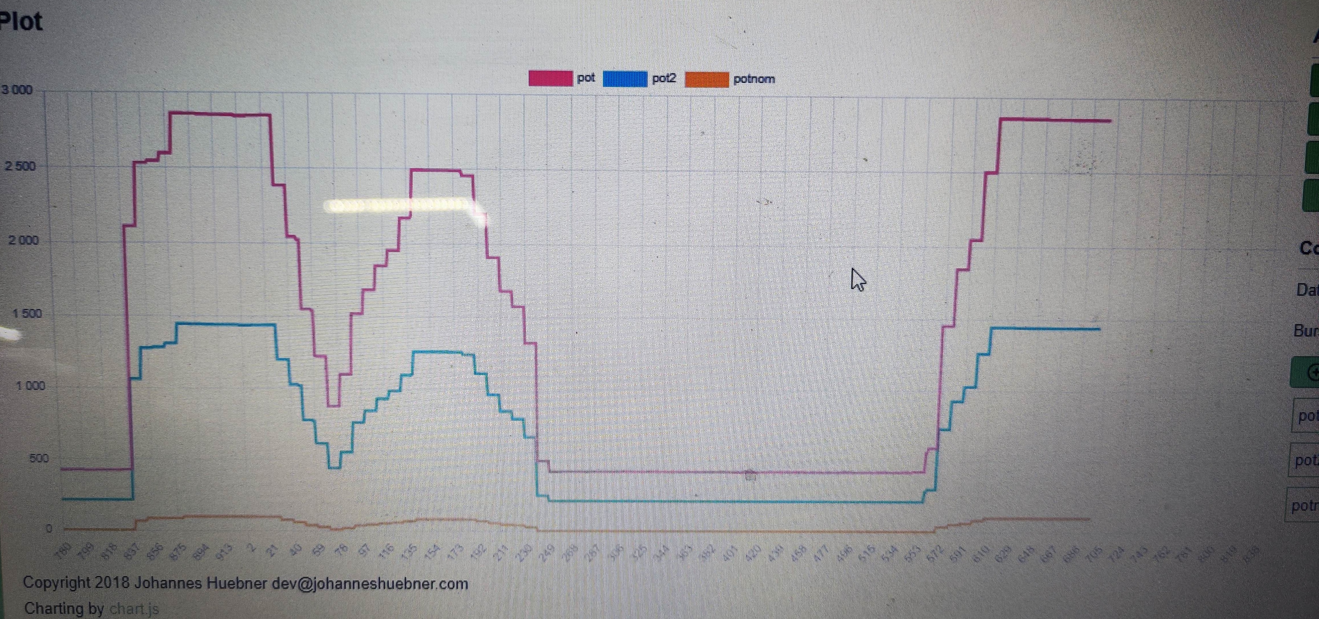

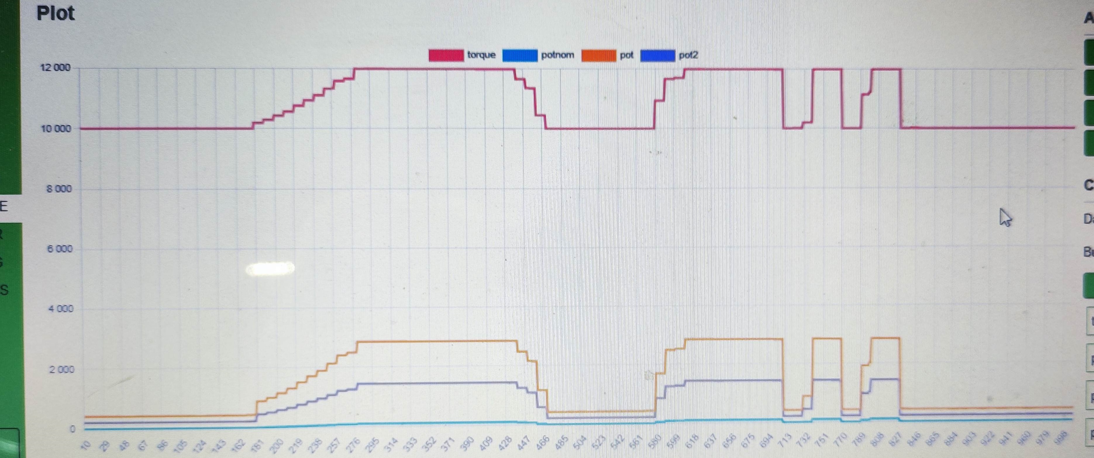

When you press throttle, pot and pot2 are getting higher, right? And how about potnom and torque, does those change value too?
student
Posts: 7
Joined: Mon Feb 23, 2026 1:09 am
Re: Zombieverter VCU <> Outlander RWD <> ISA IVT-S
Post by student »
evMacGyver wrote: Mon Feb 23, 2026 10:36 am When you press throttle, pot and pot2 are getting higher, right? And how about potnom and torque, does those change value too?
recorded a graph of parameters potnom, pot, pot2

Post by student »
parameters potnom, pot, pot2 and torque

Posts: 2962
Has thanked: 328 times
Been thanked: 847 times
All of these look good to us.
Please show your wiring of the inverter to motor and the HV wiring.

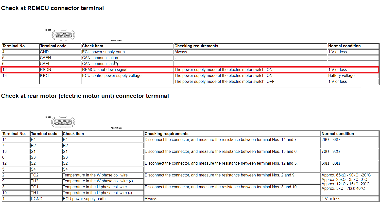

tom91 wrote: Mon Feb 23, 2026 8:45 am We need wiring info and pictures of your setup.
Thank you. I started drawing a connection diagram and checking the necessary signals on the inverter contacts. It turned out that I had mistakenly connected the +12 volts to the RSDN.
Now everything is fine, the motor started to rotate.
aot93 wrote: Thu May 20, 2021 11:00 pm Note that RSDN should be pulled low.
