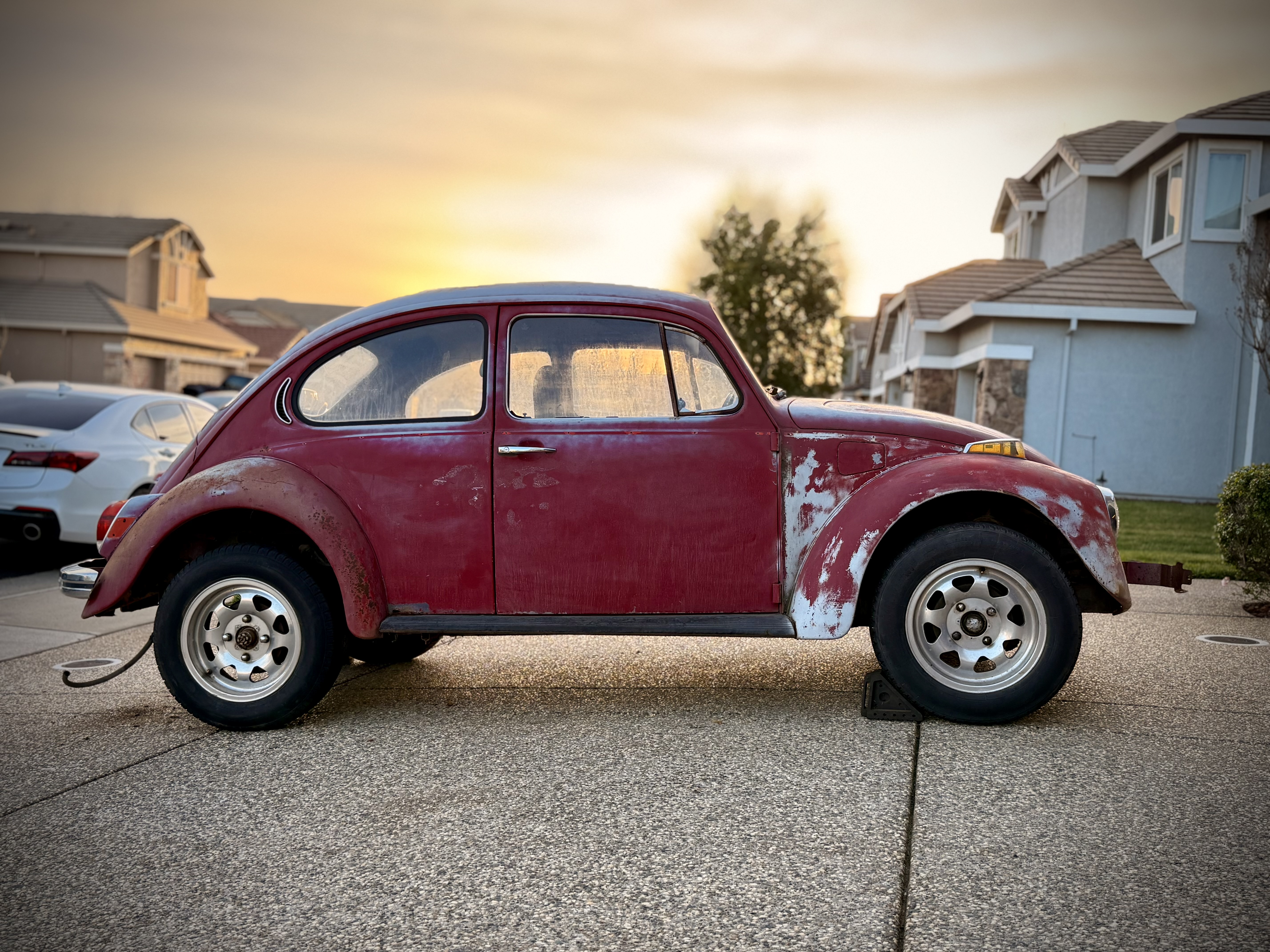

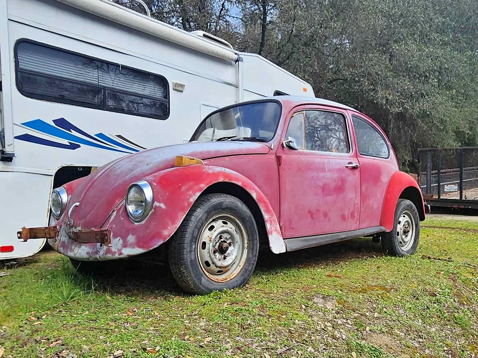

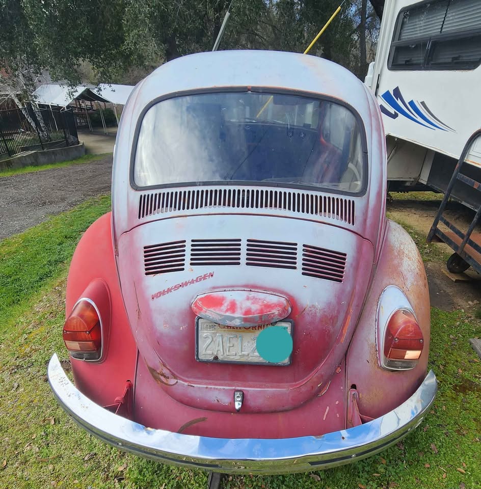

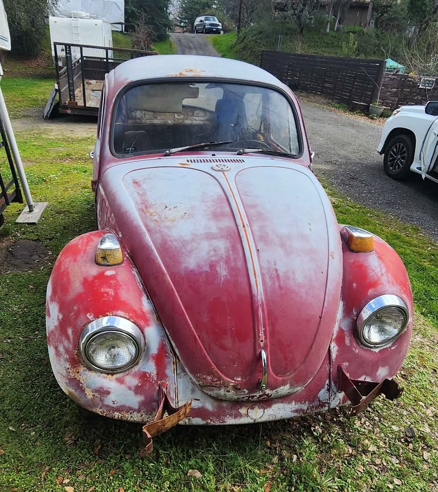

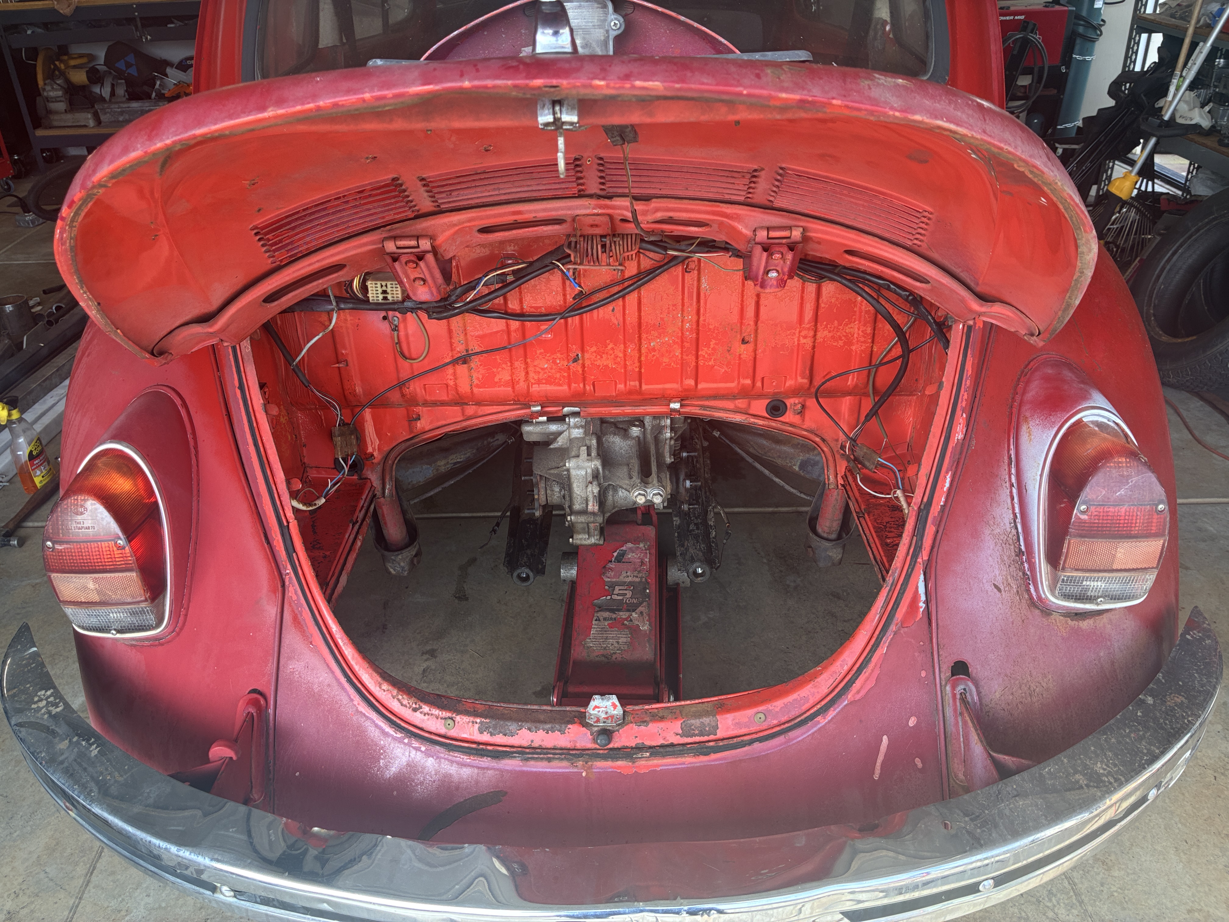

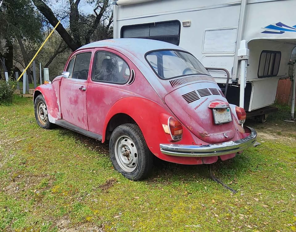

so let's meet Bunky...

I pinky promise I will not liter this thread with non EV related updates as I tackle all the mundane restoration tasks on this magnificent automobile (and when I say restoration, I take that term very loosely) if you would like to keep up with those shenanigans please take a peak at my Bunky the eBug: A 30 Day EV Conversion thread on the VWVortex forum, please and thank you
having said that, I just have to share this pic of her and her new shoes, how can you not love this sexy beast?

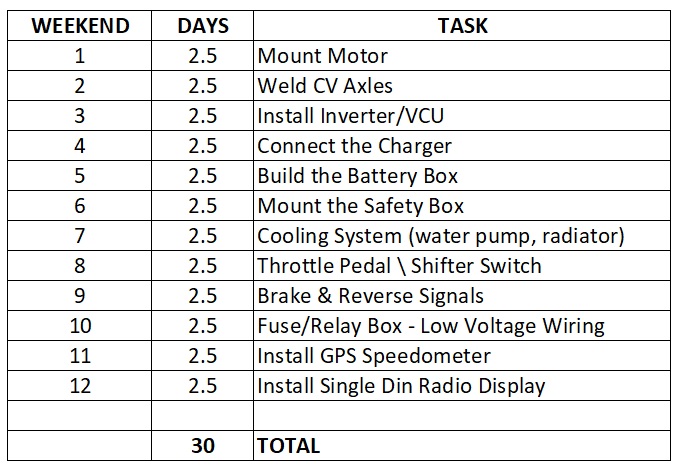

here's the proposed Bunky Build Schedule once we get started, which I hope will be in March, aka March Madness 2026, and I know some of the tasks won't take an entire weekend so they include some buffer time as well, also realistically I doubt I will be able to wrench on Bunky for 12 consecutive weekends, lemme know if you wanna come down and help, ha ha (cold tacos and warm beer shall be served)
2.5 days means start after work on Friday hence the half day, then all day Saturday and all day Sunday type of pace

Gregski wrote: Thu Feb 26, 2026 2:25 pm lemme know if you wanna come down and help, ha ha (colt tacos and warm beer shall be served)
If I wasn't on the other side of the continent, I'd take you up on that offer.

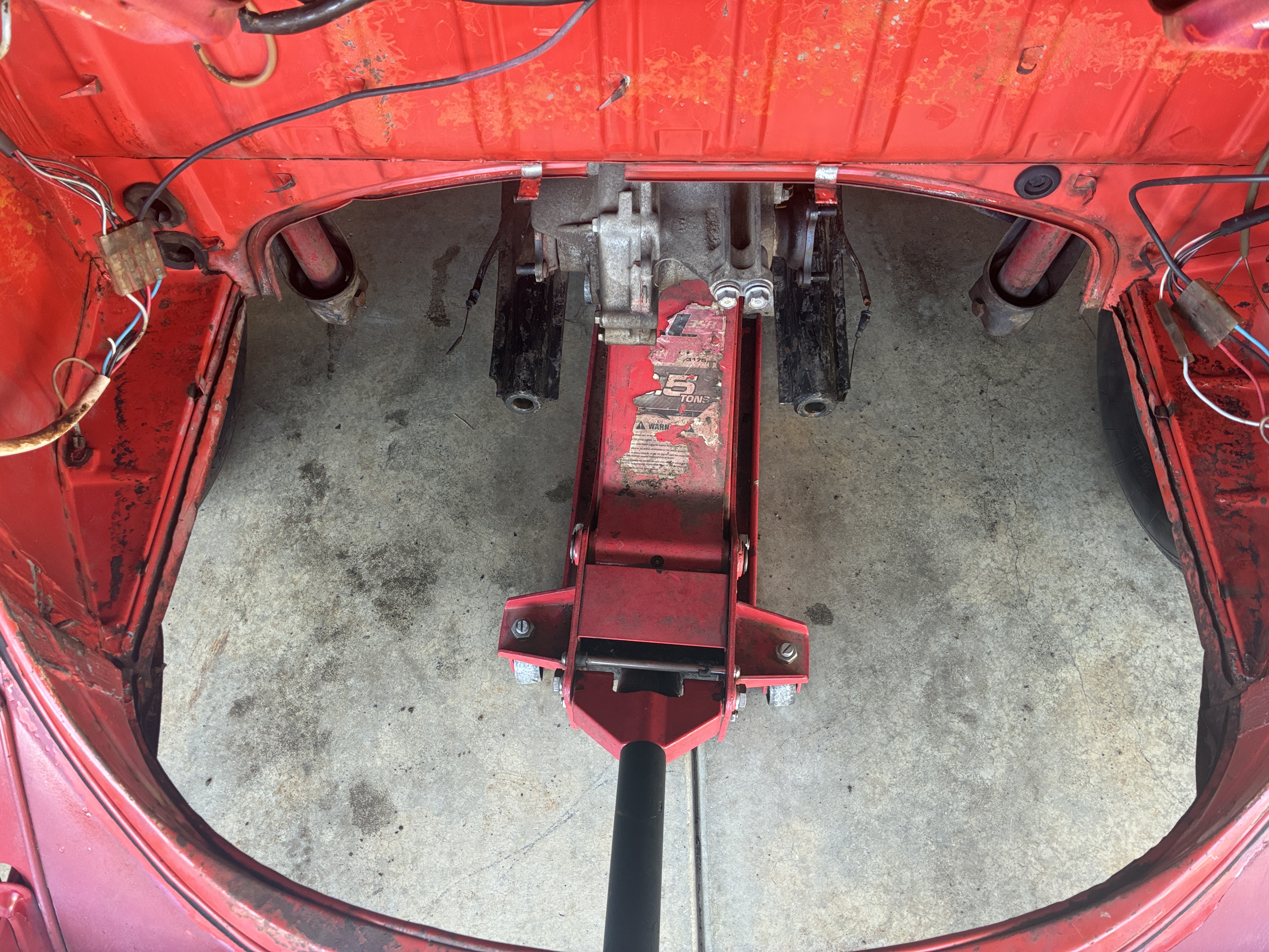

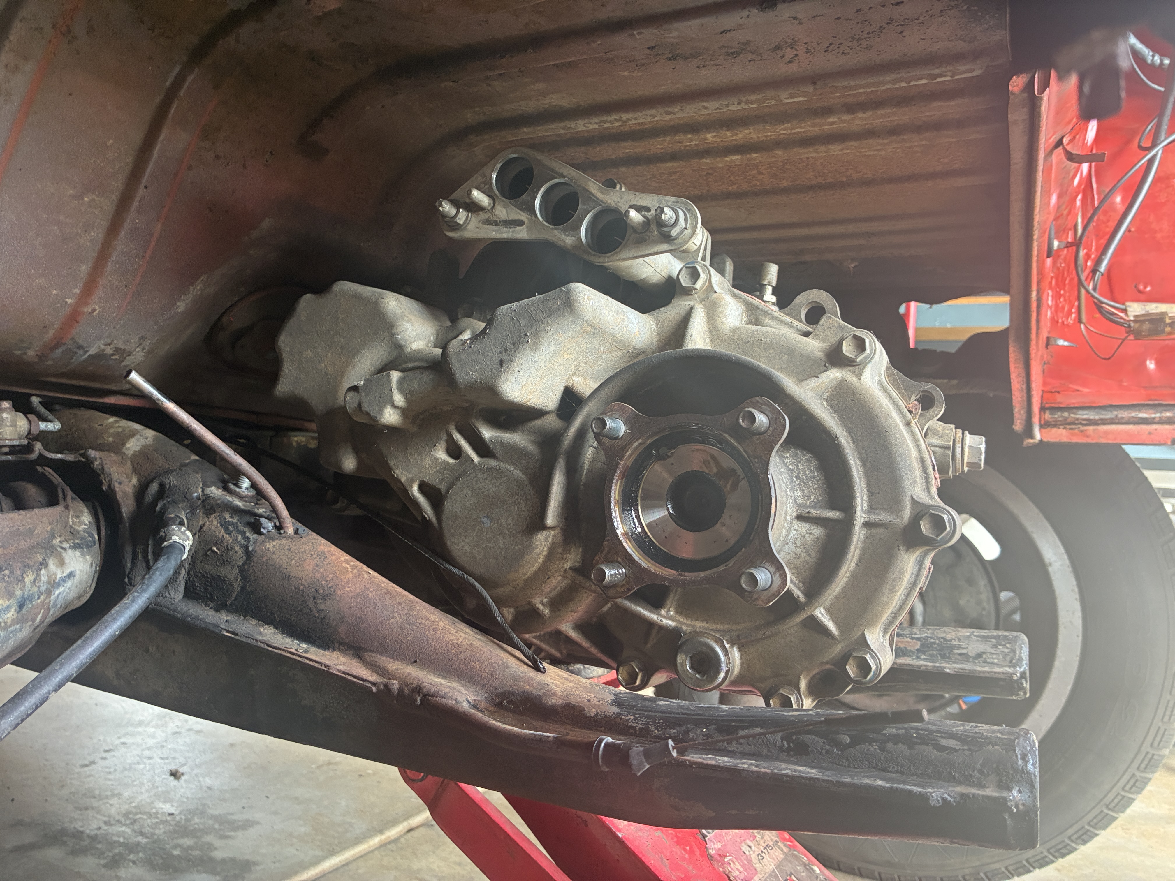

Gregski
Posts: 3171
Has thanked: 635 times
Been thanked: 1611 times
Re: Bunky the eBug: A 30 Day EV Conversion
Post by Gregski »

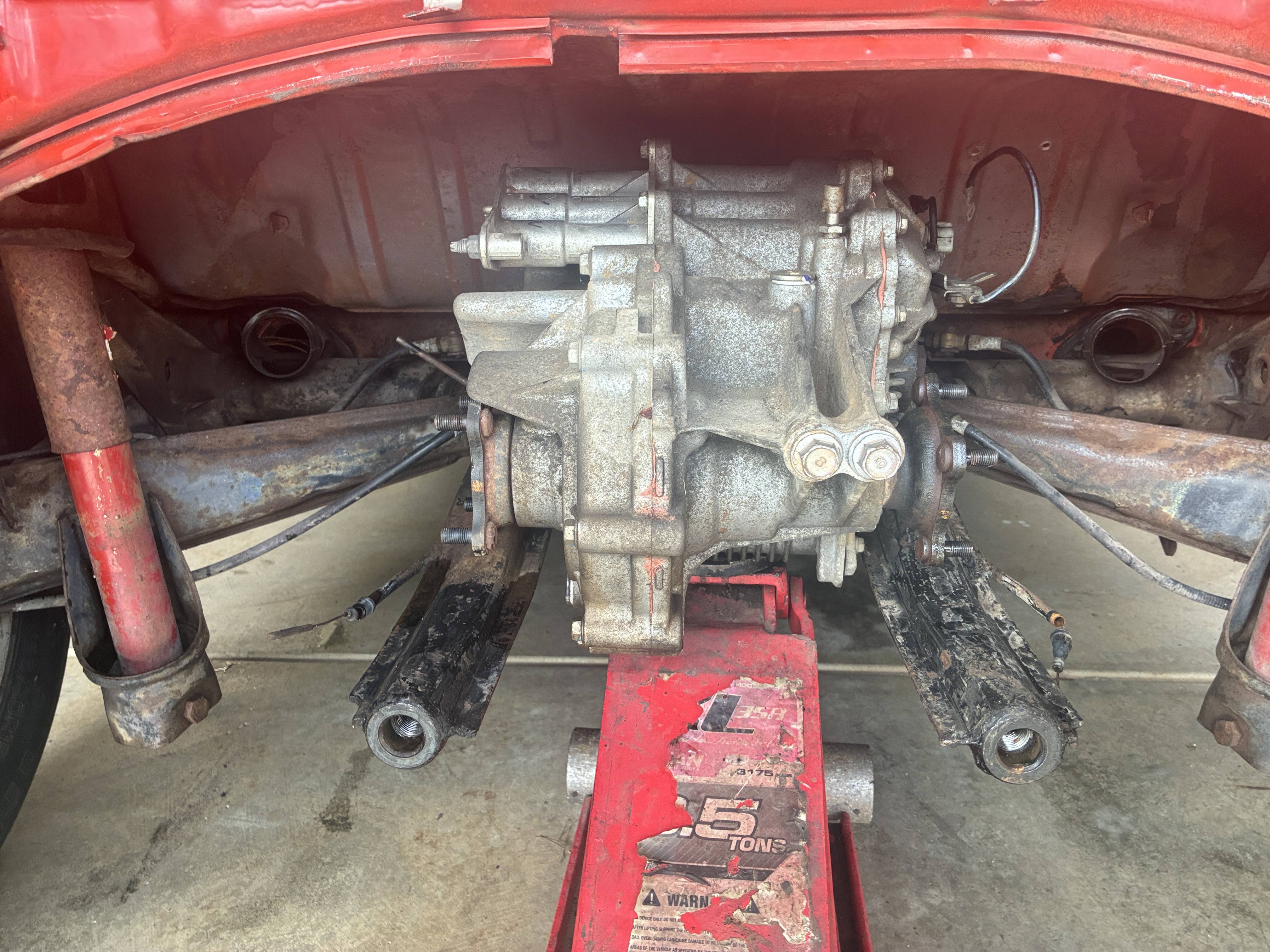

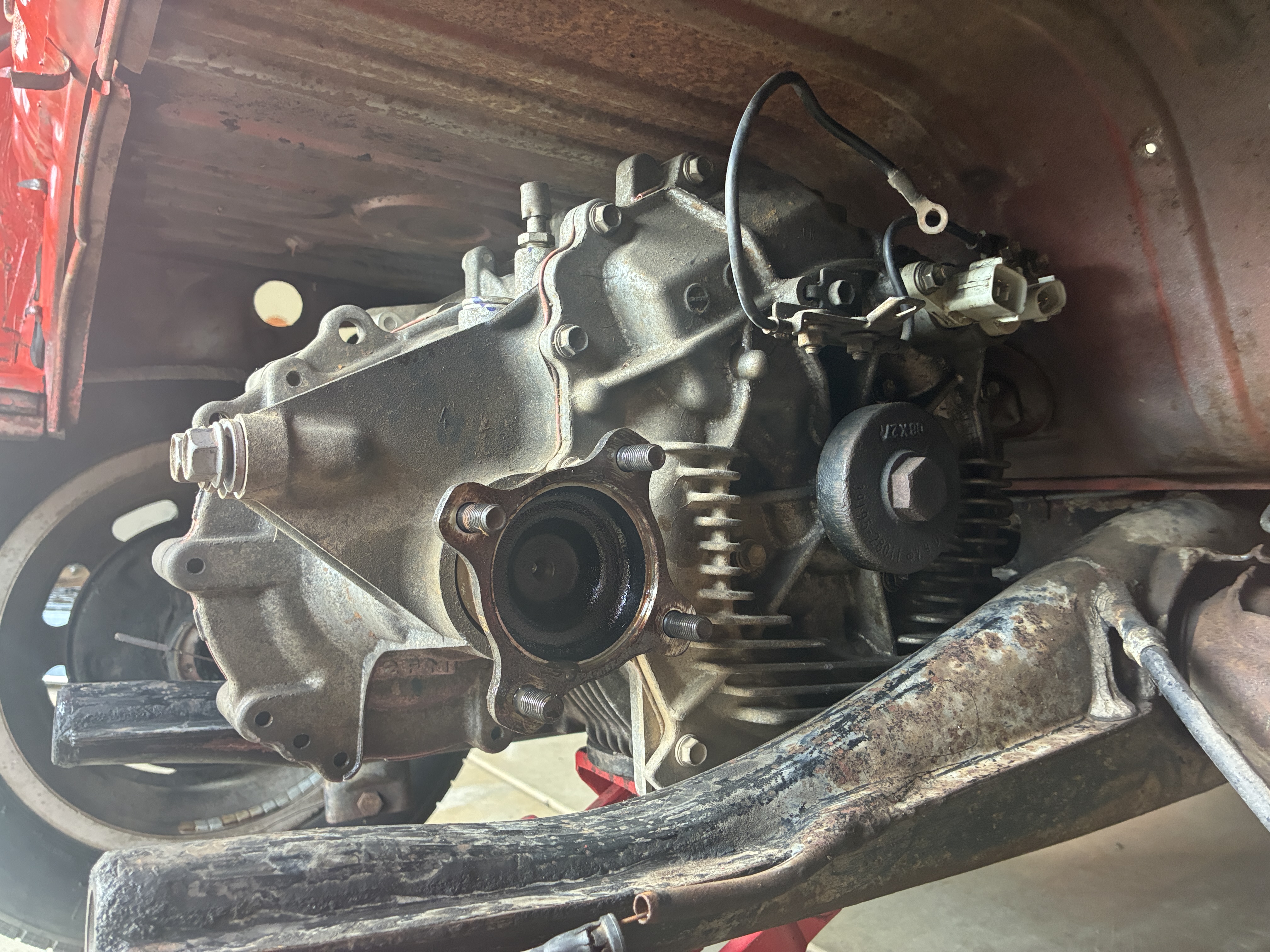

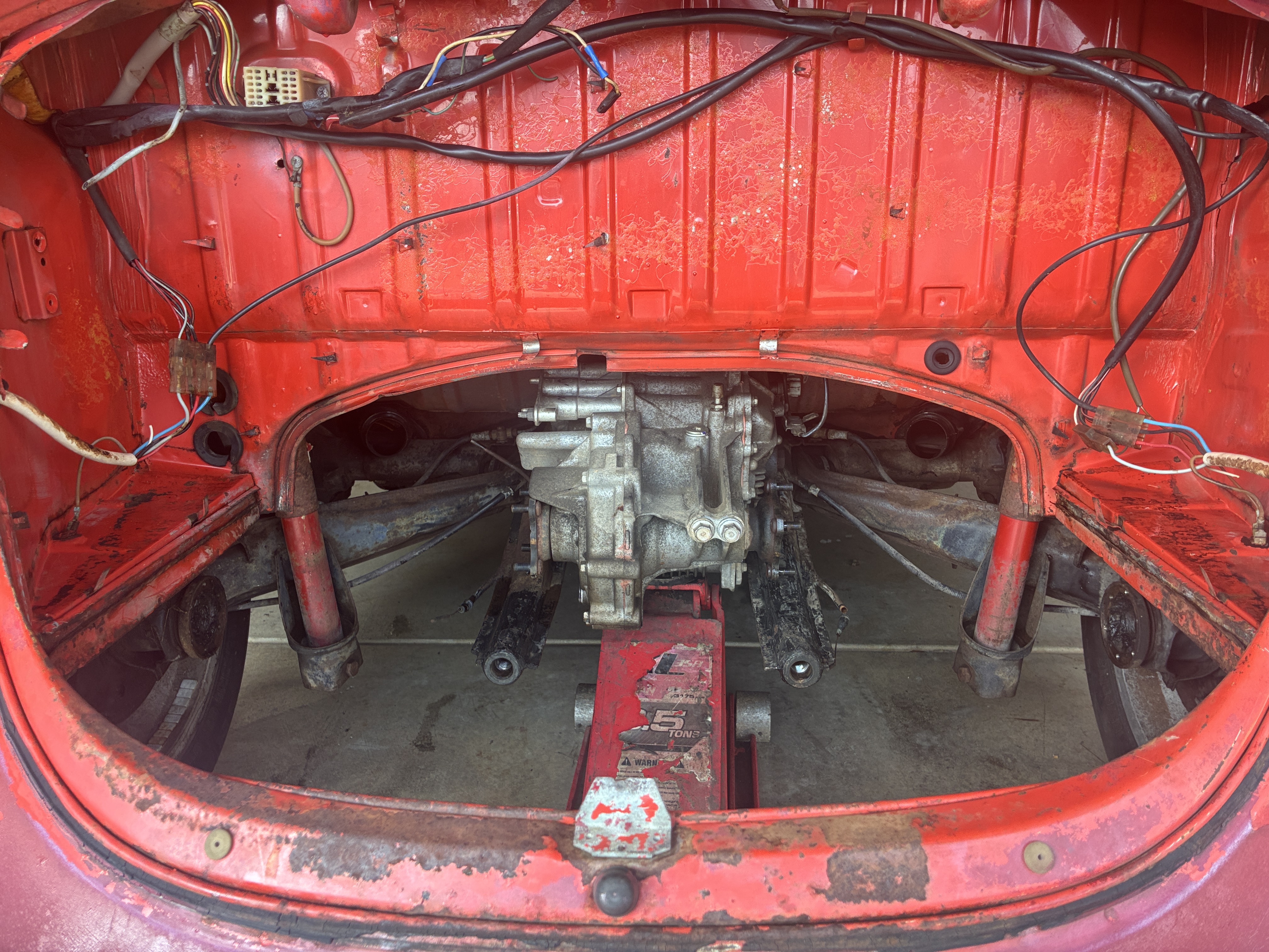

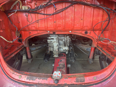

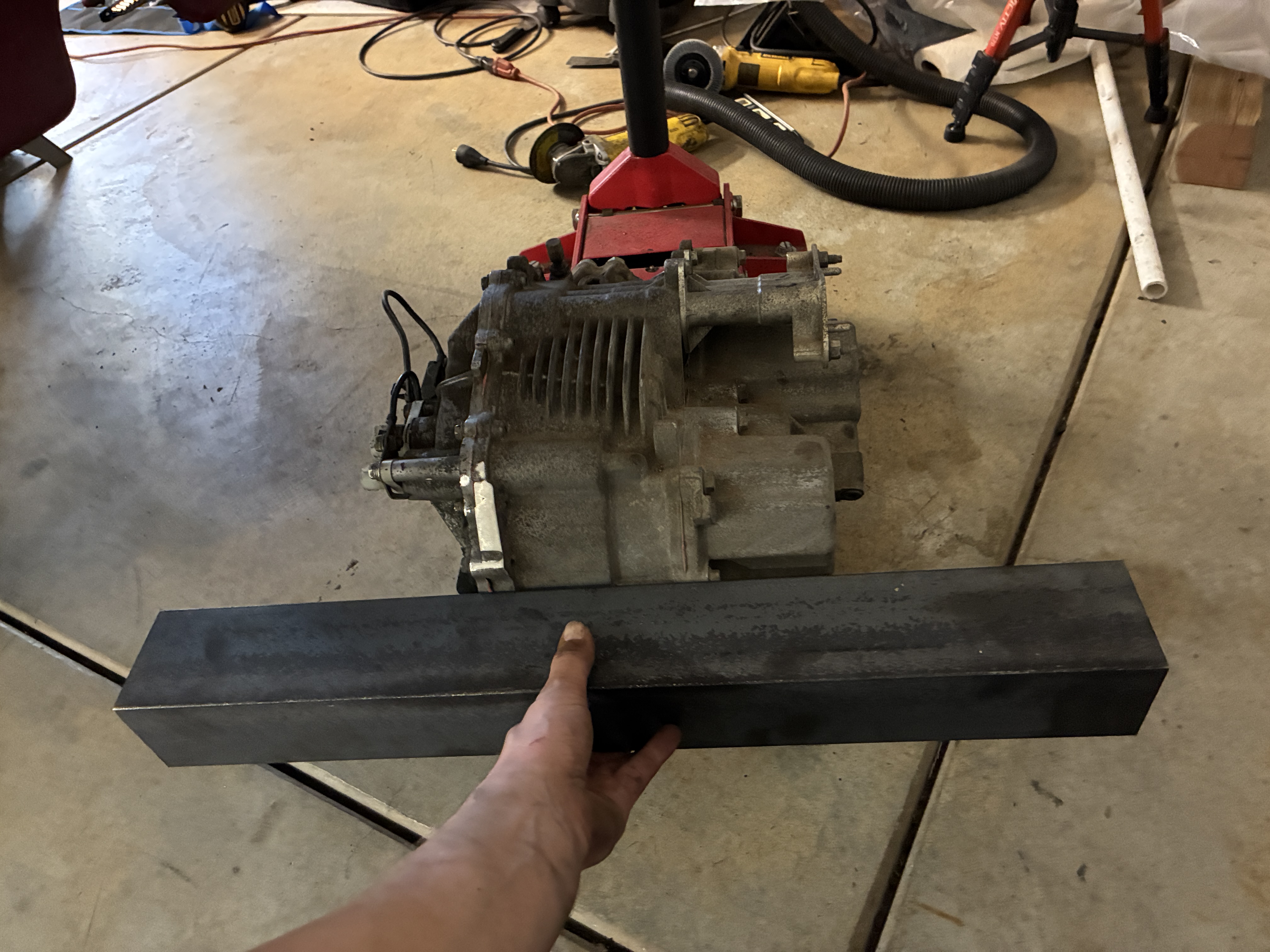

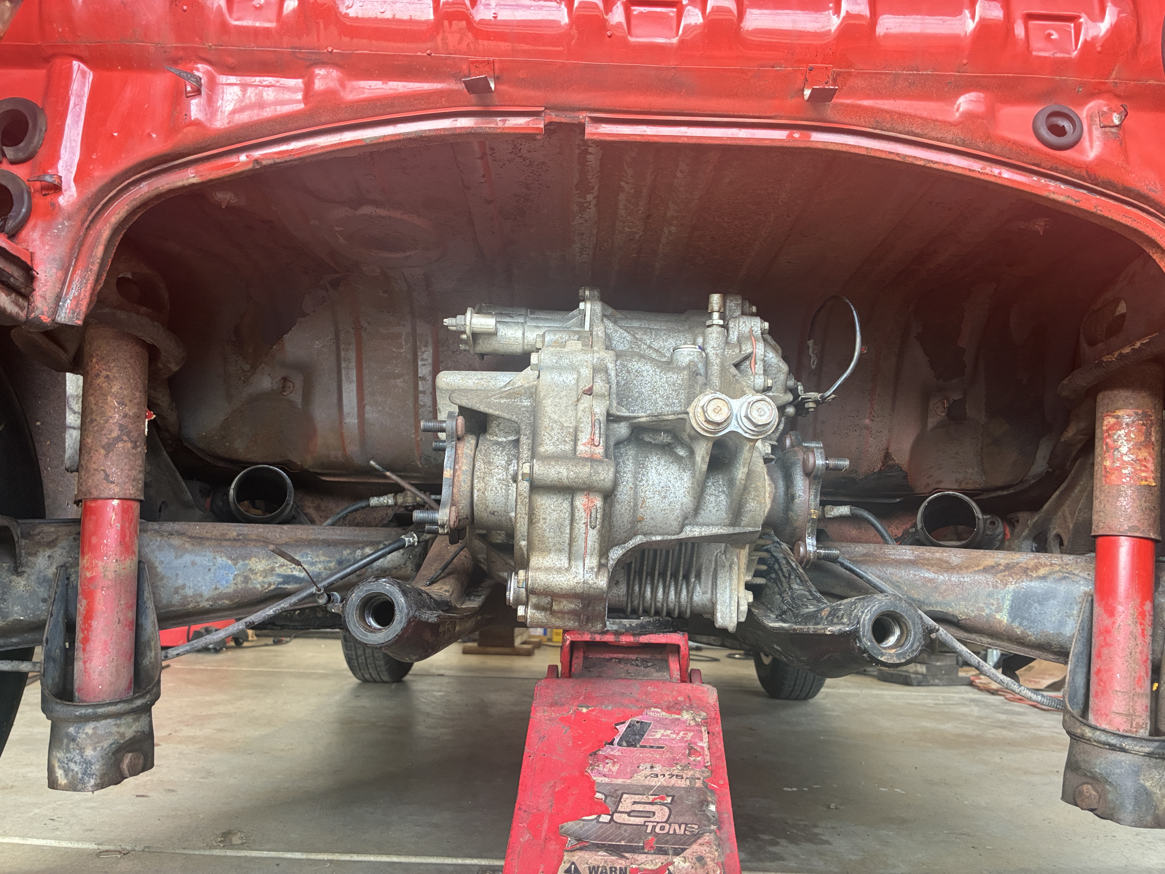

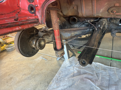

fits like a glove
plenty of room in front (or behind the motor) depending how you look at it, for the inverter and charger

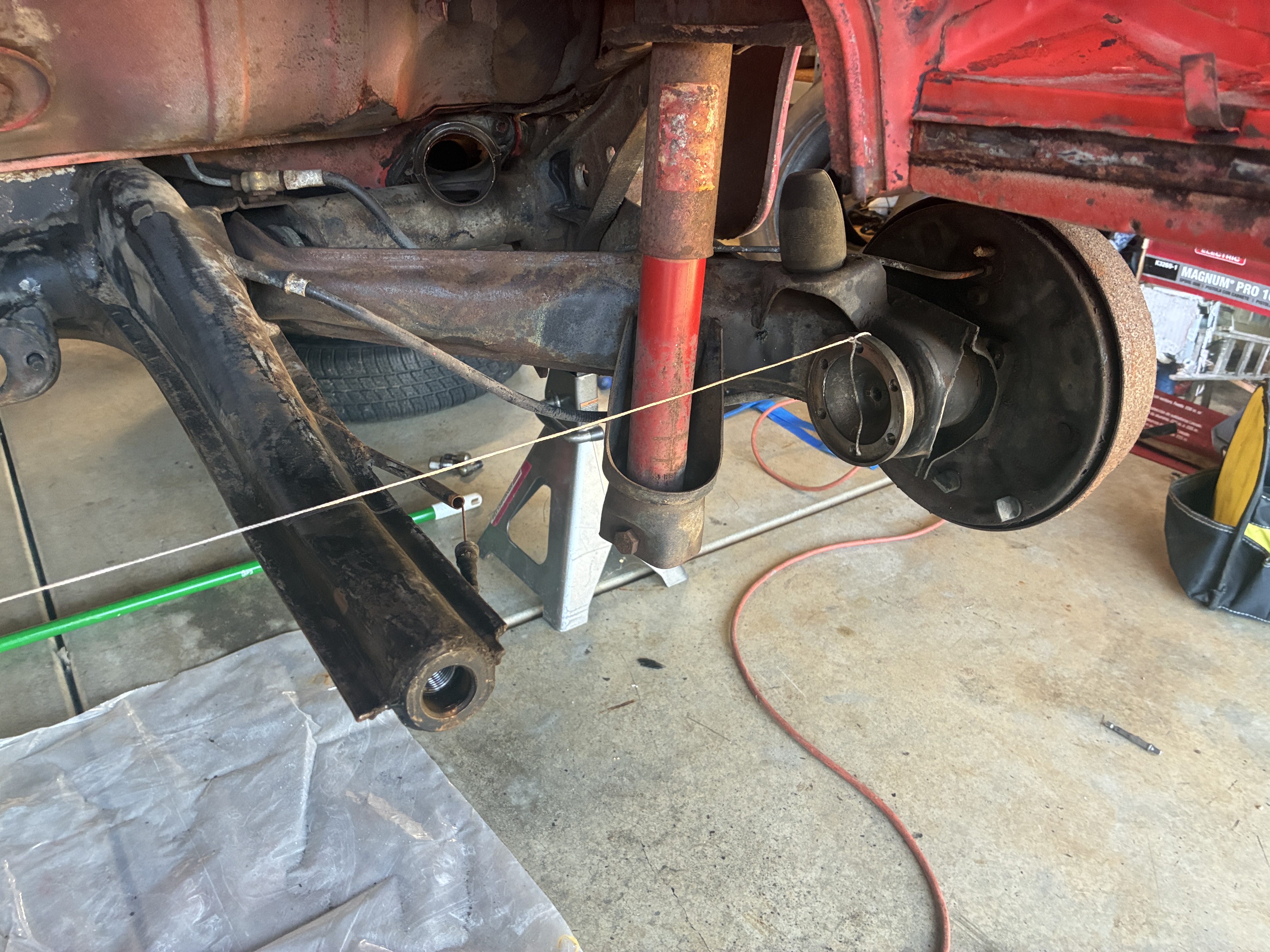

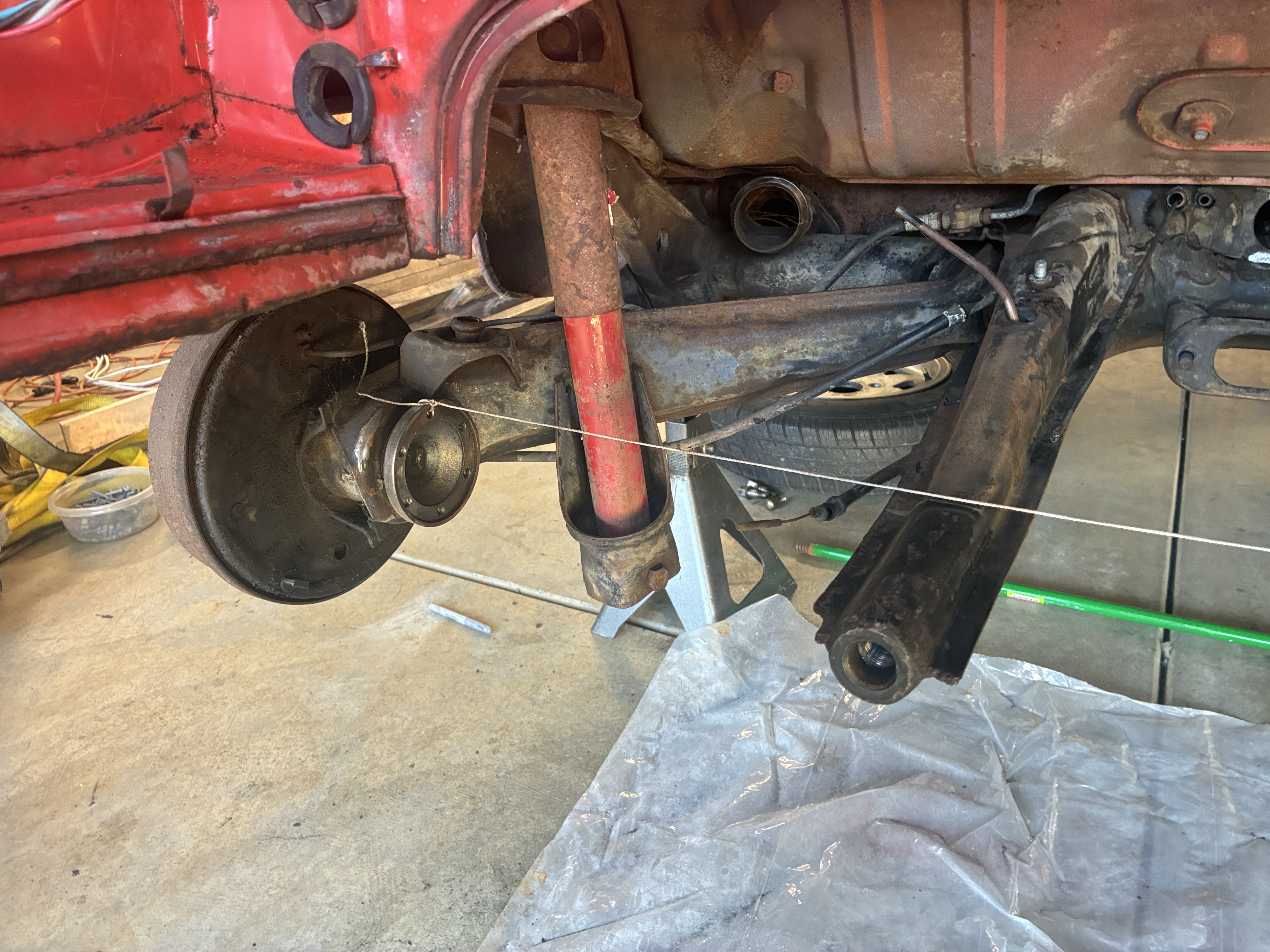

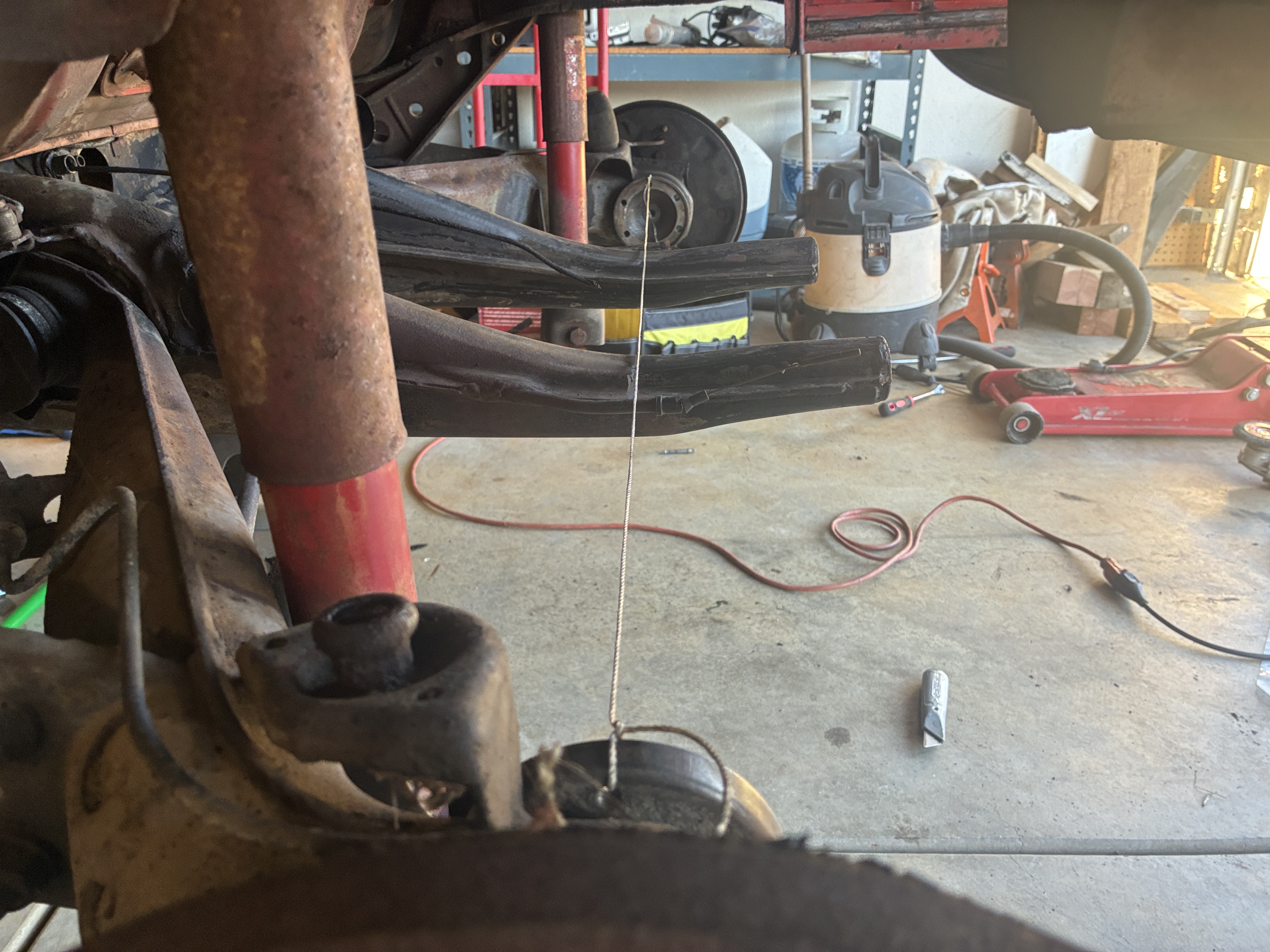

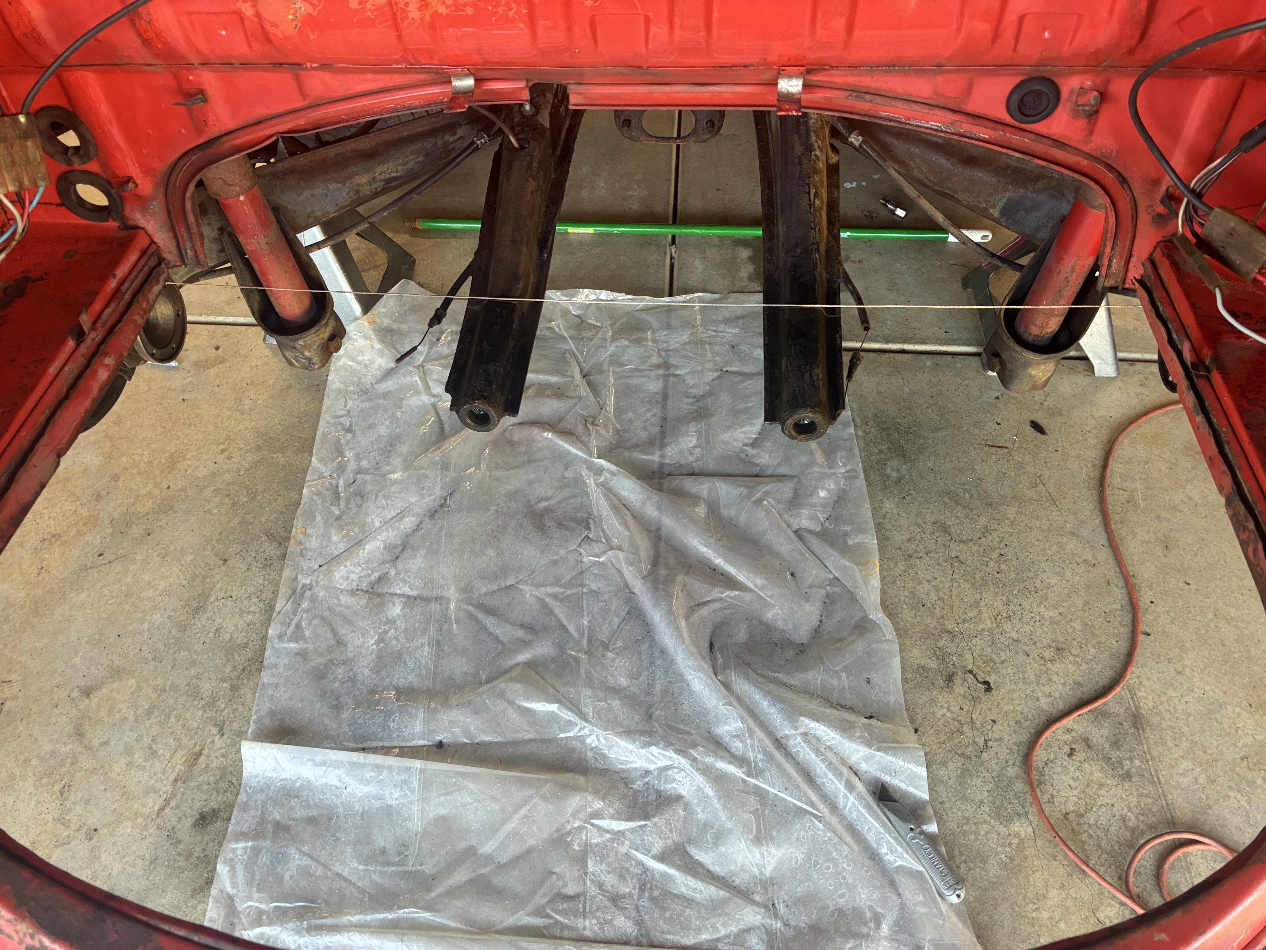

Stringanometry

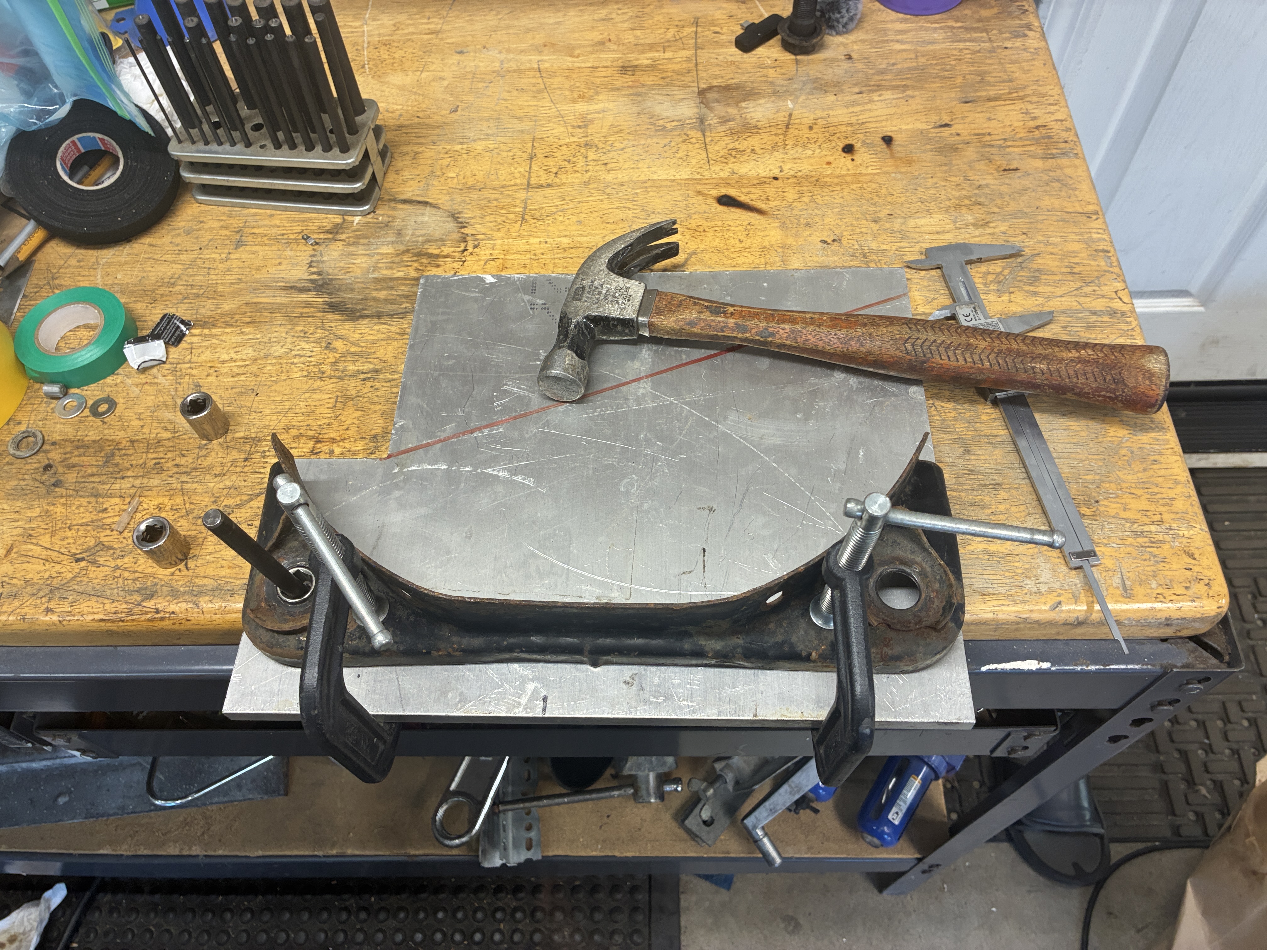

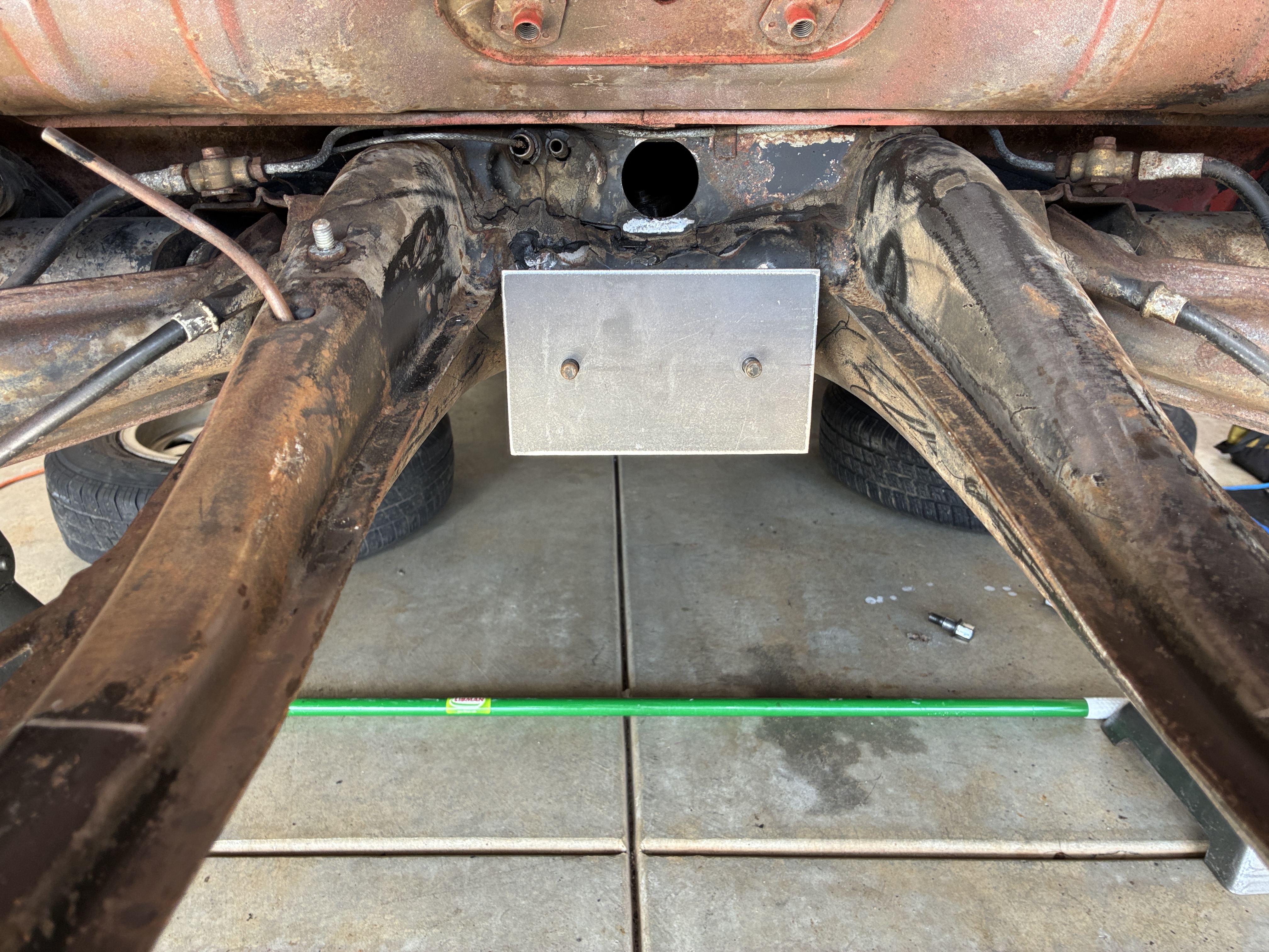

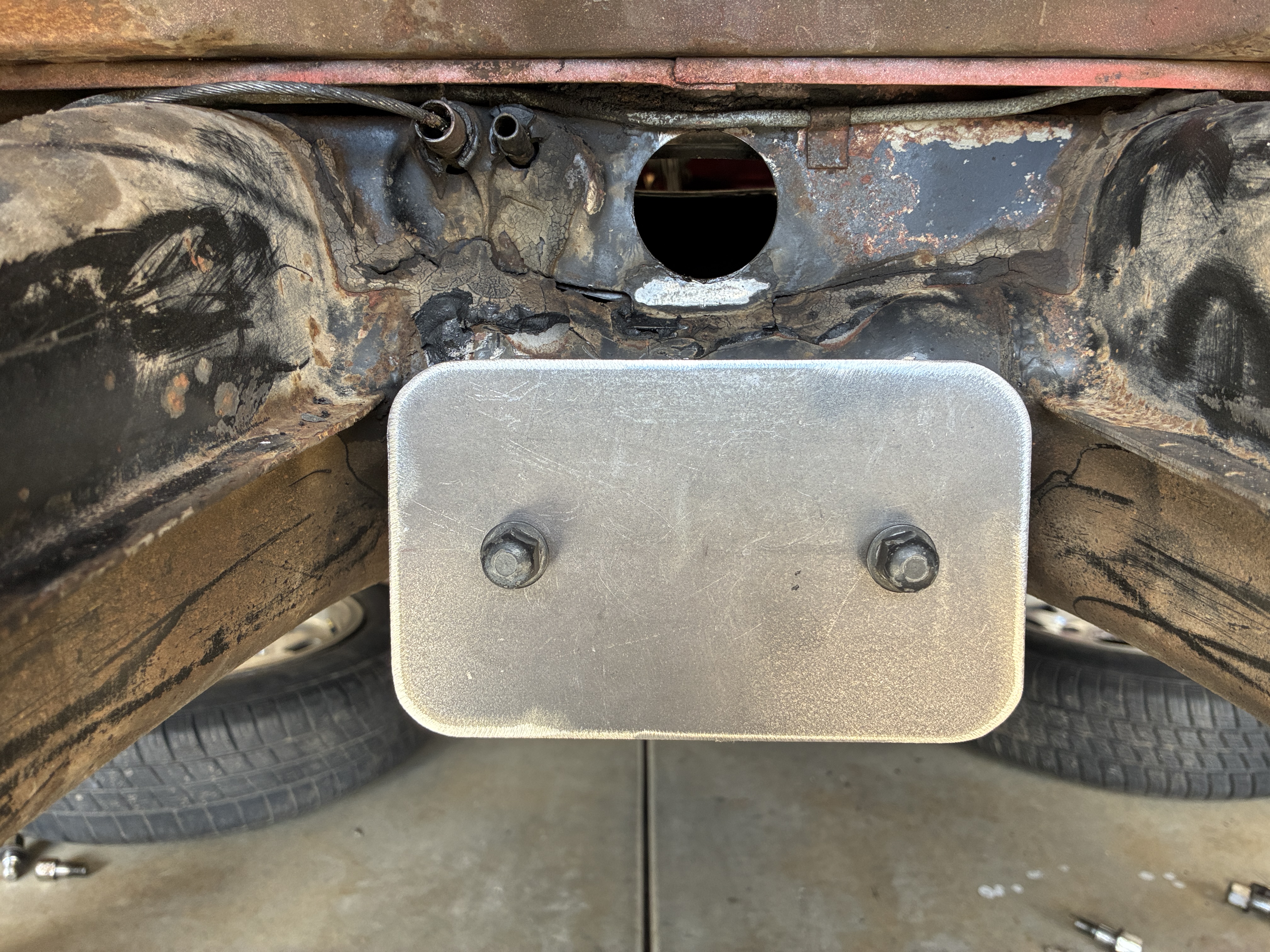

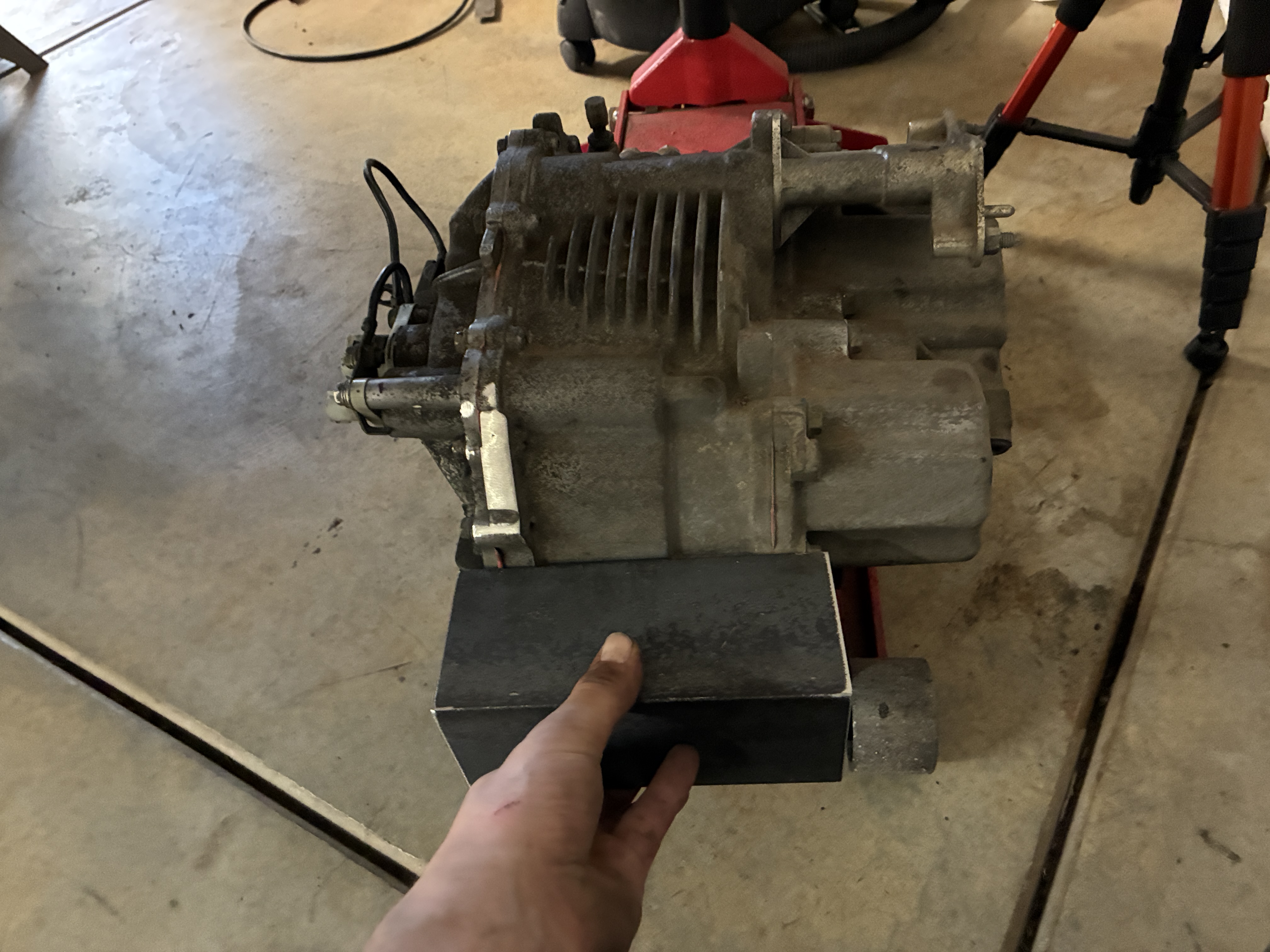

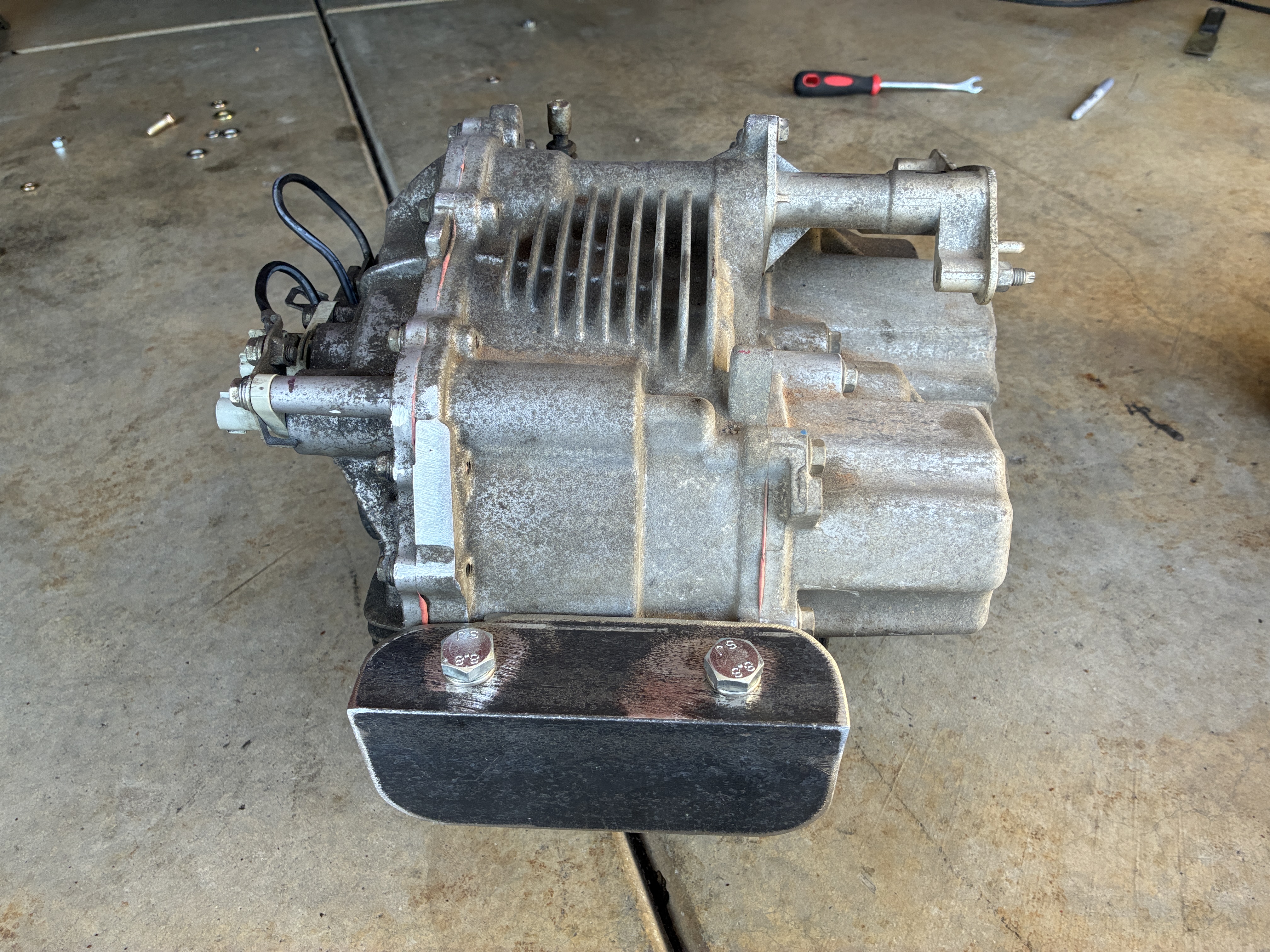

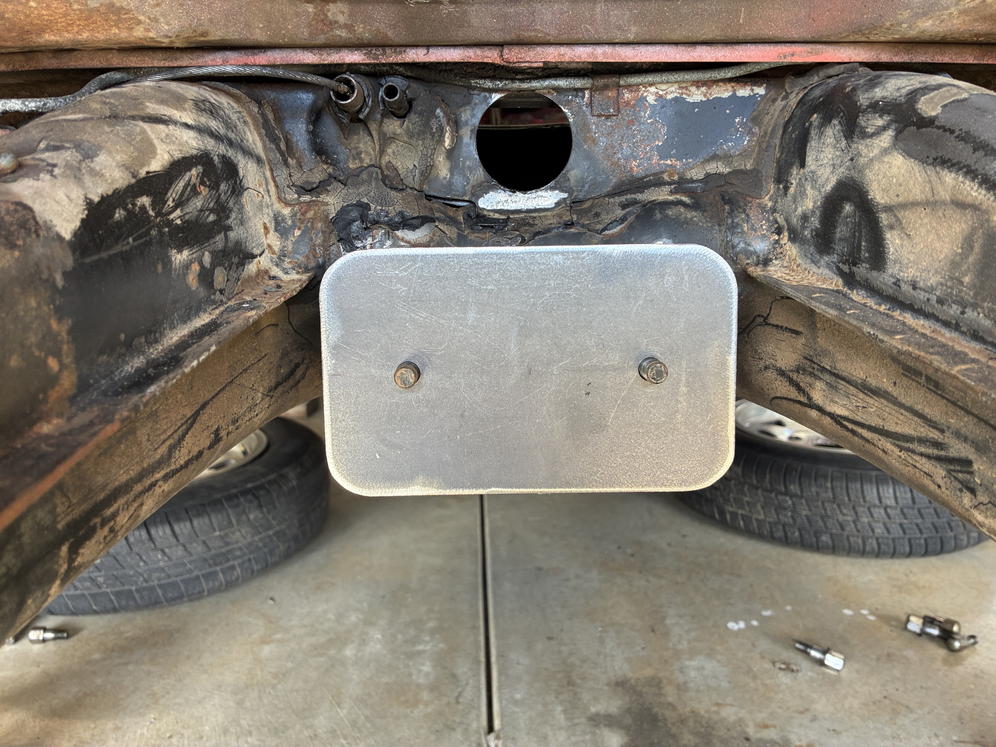

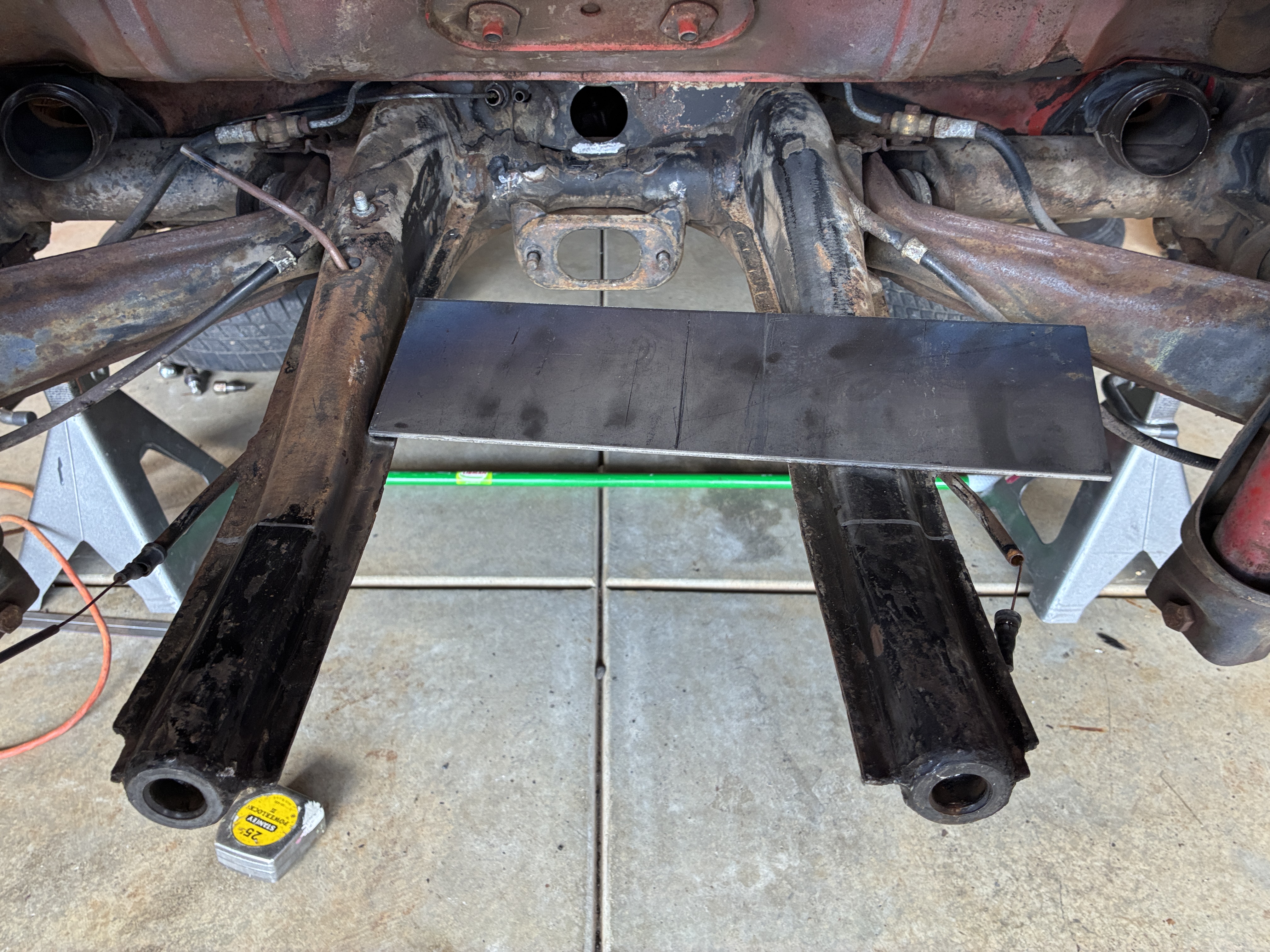

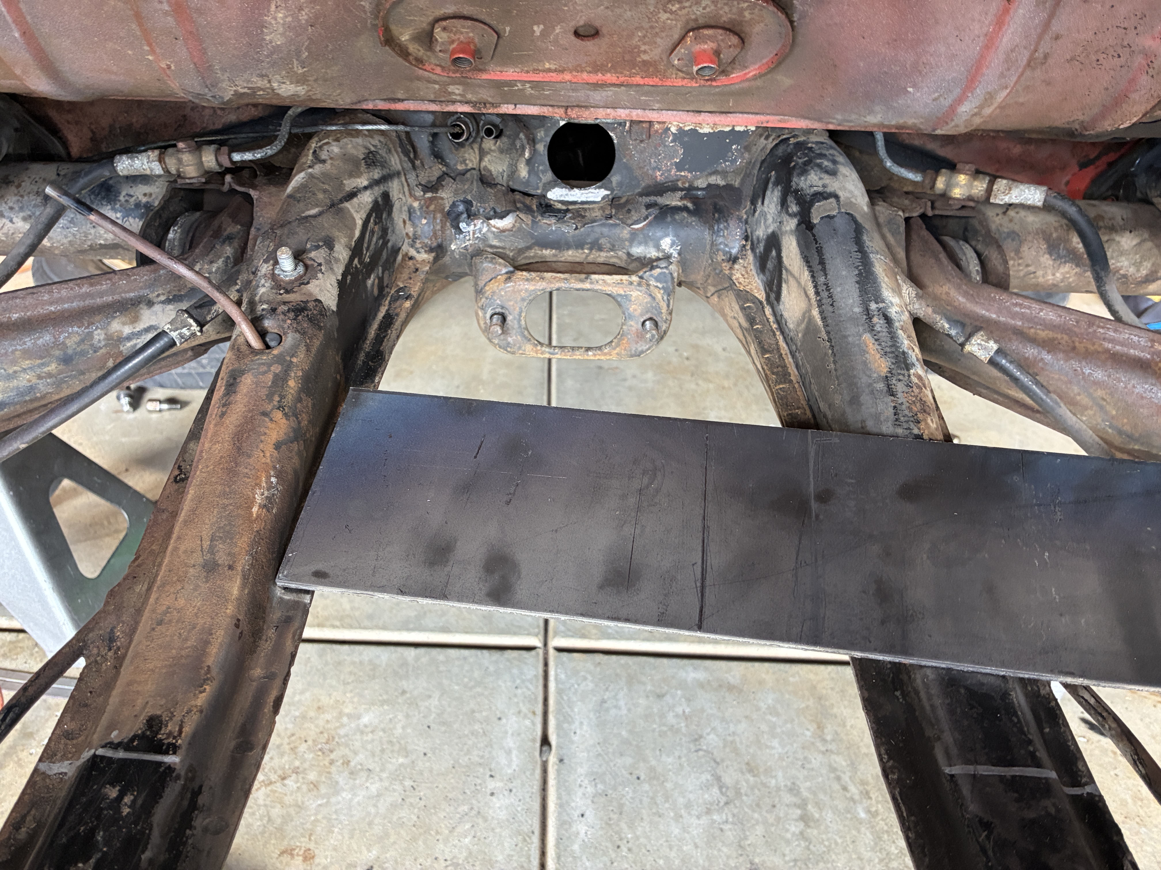

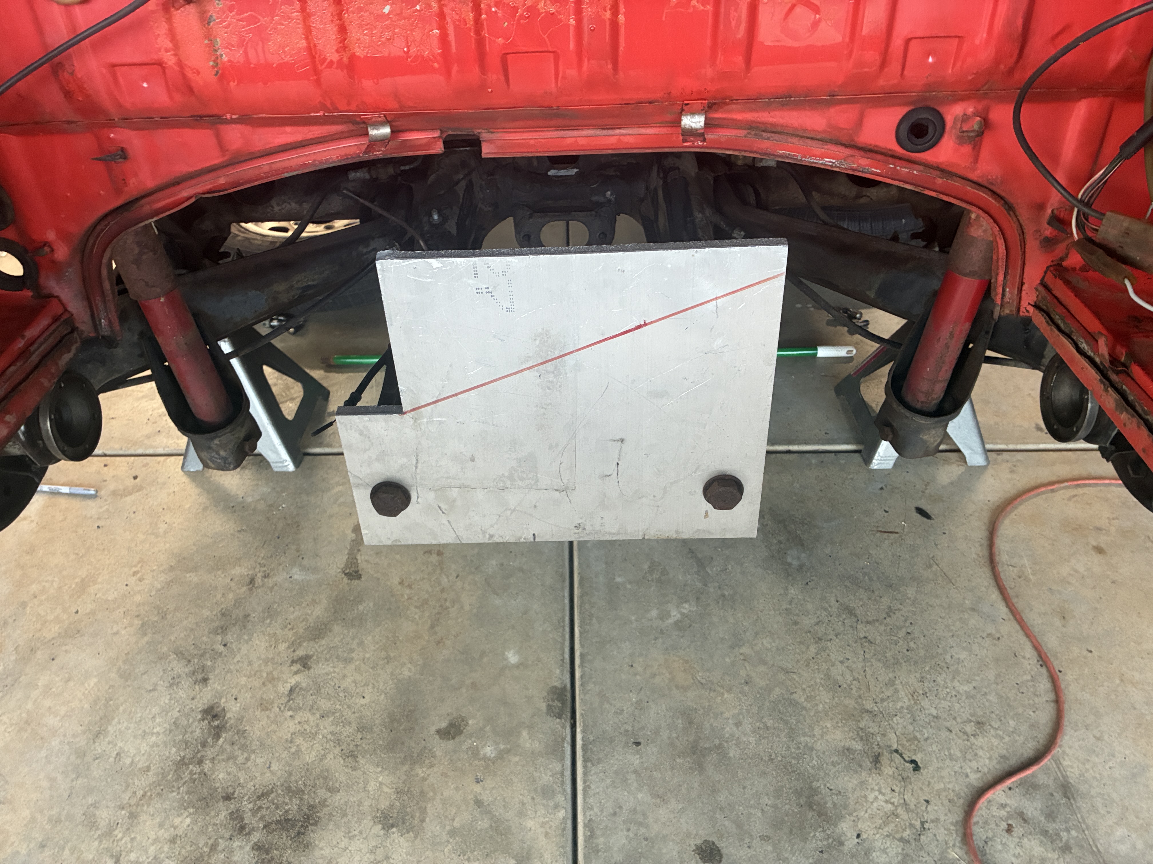

Front Plate: this aint our only option, but we're going for simple first, hoping we can come up with a bolt on kit, no welding required
here, I'm using the stock OEM transmission bellhousing bracket as a template for the holes
please ignore that diagonal red line, it's from a prior project

I hope you dont cut and splice axles, as a simple adapter flange is all you need to keep stock vw axles!
Gregski
Posts: 3171
Post by Gregski »
Bratitude wrote: Mon Mar 02, 2026 6:36 pm I hope you dont cut and splice axles, as a simple adapter flange is all you need to keep stock vw axles!

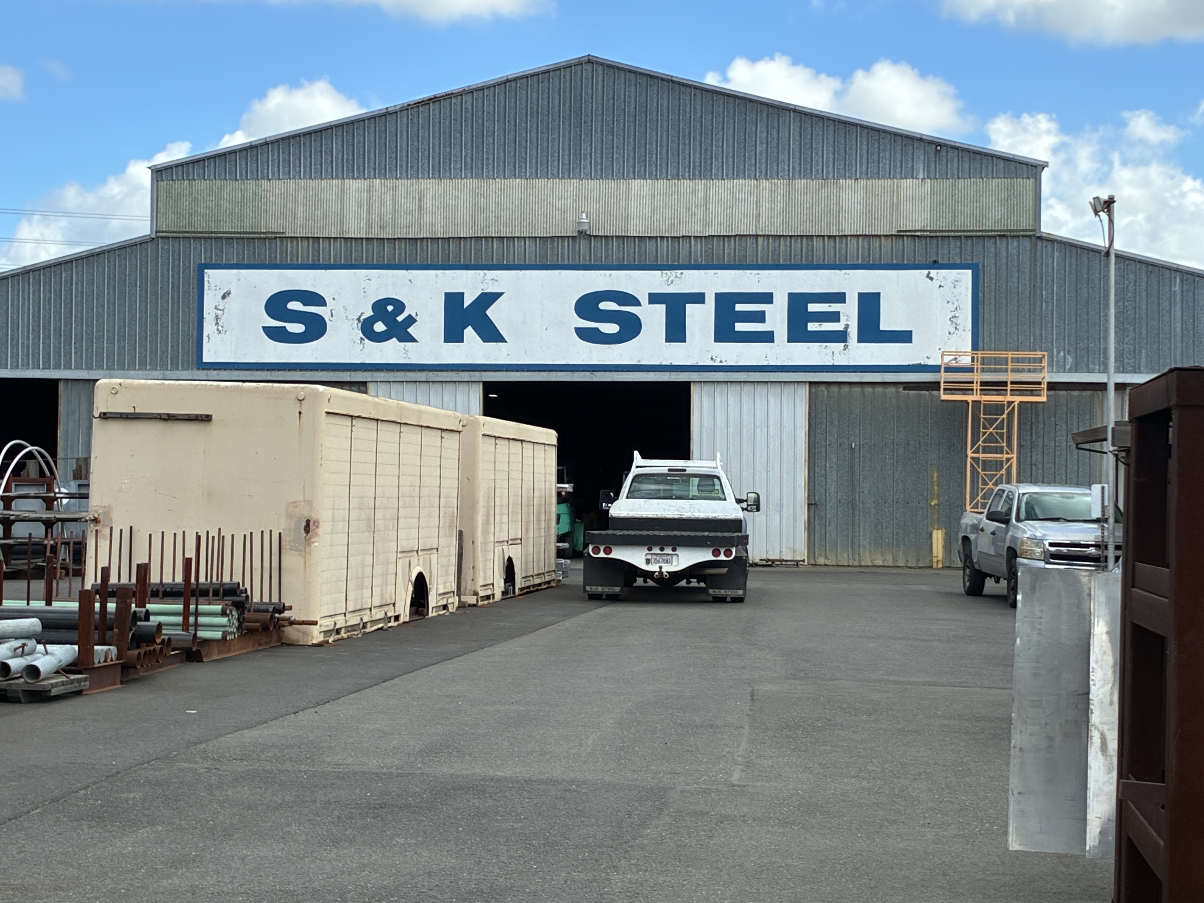

swung by my favorite mom n pop steel place today, may be the last one of it's kind, North of the Mmiissiissiippii
I love it cause they sell remnants, and let you wonder around their yard and warehouse aimlessly, so this is what $20 bones buys you these days, not too shabby at all, 3/16th" flat and angle, and 1/8th" rectangular tubing (gloves not included)

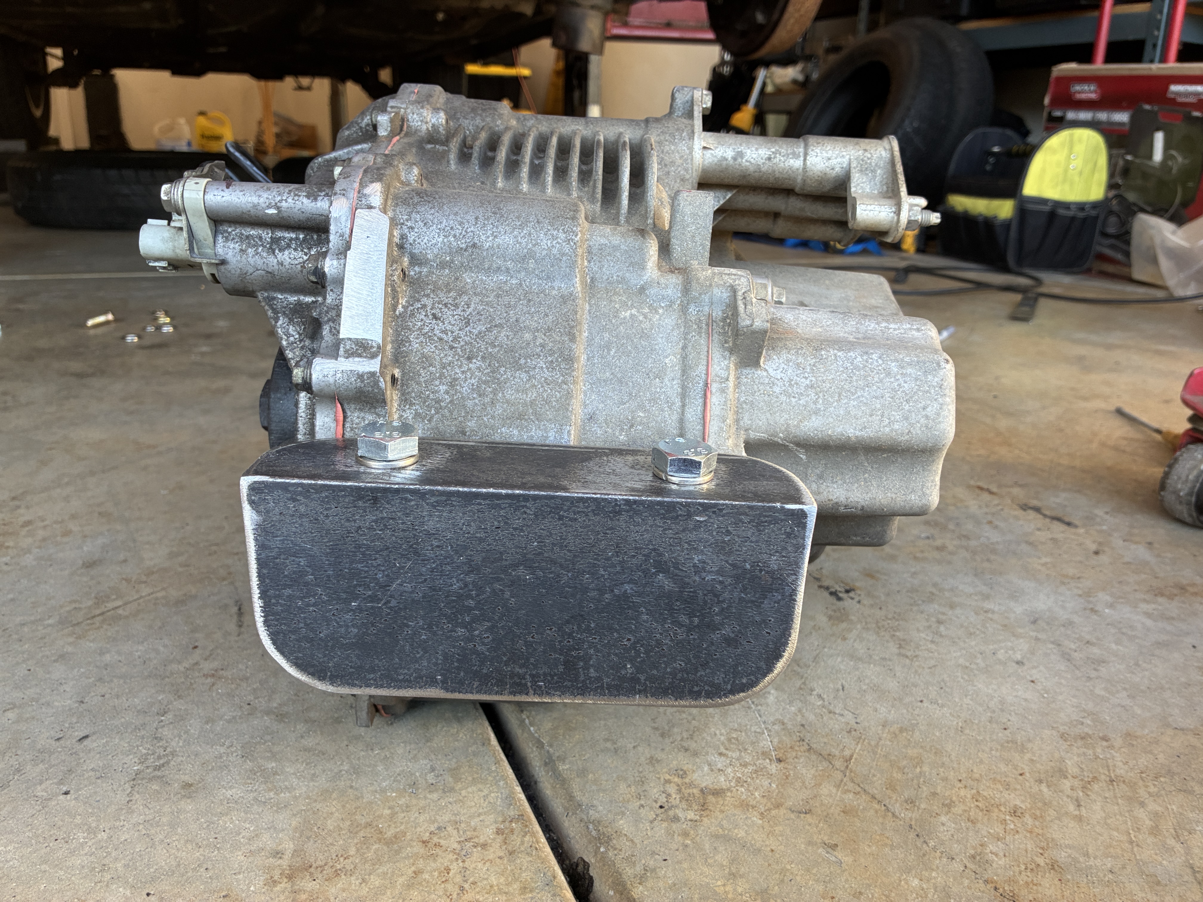

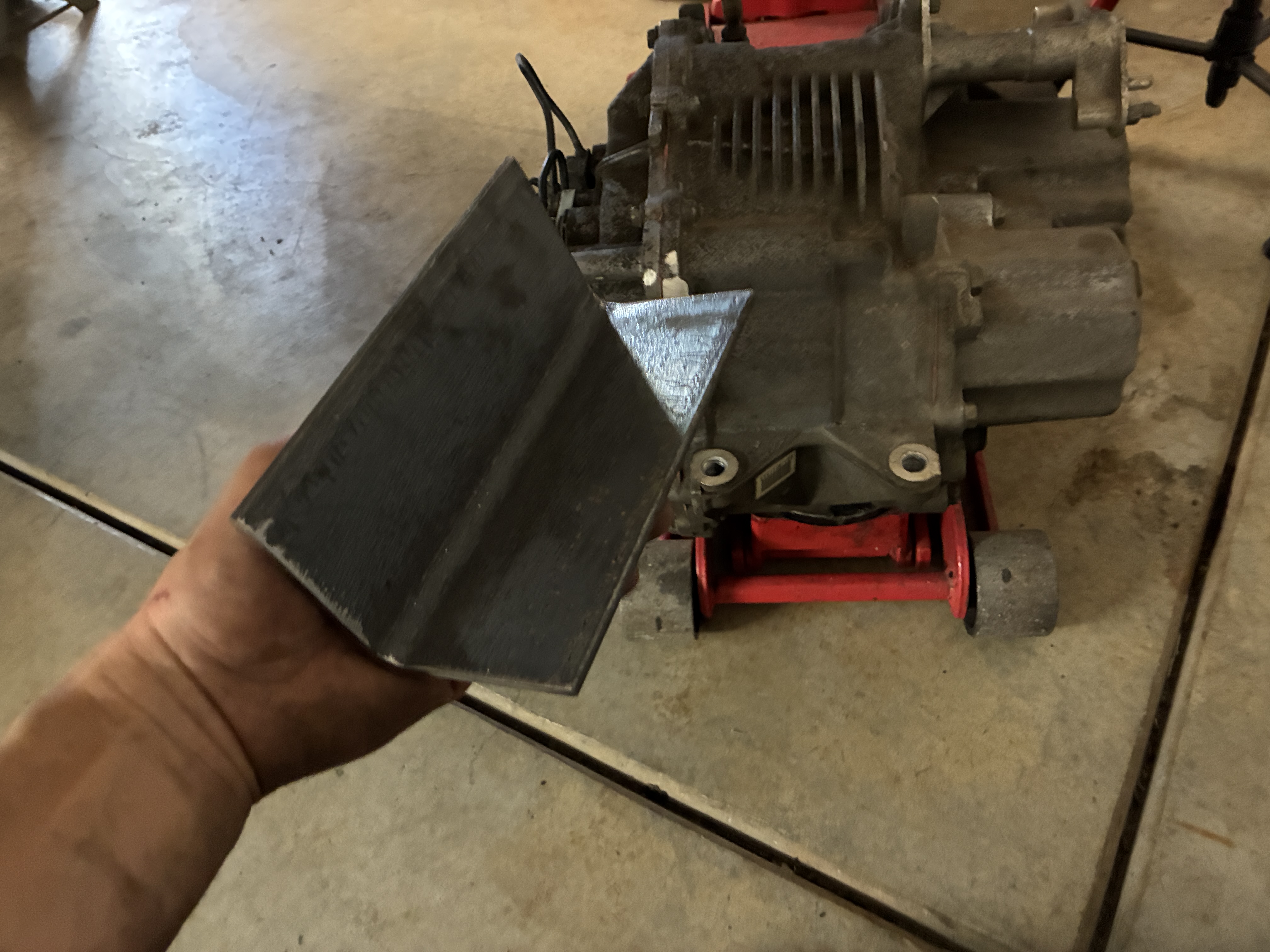

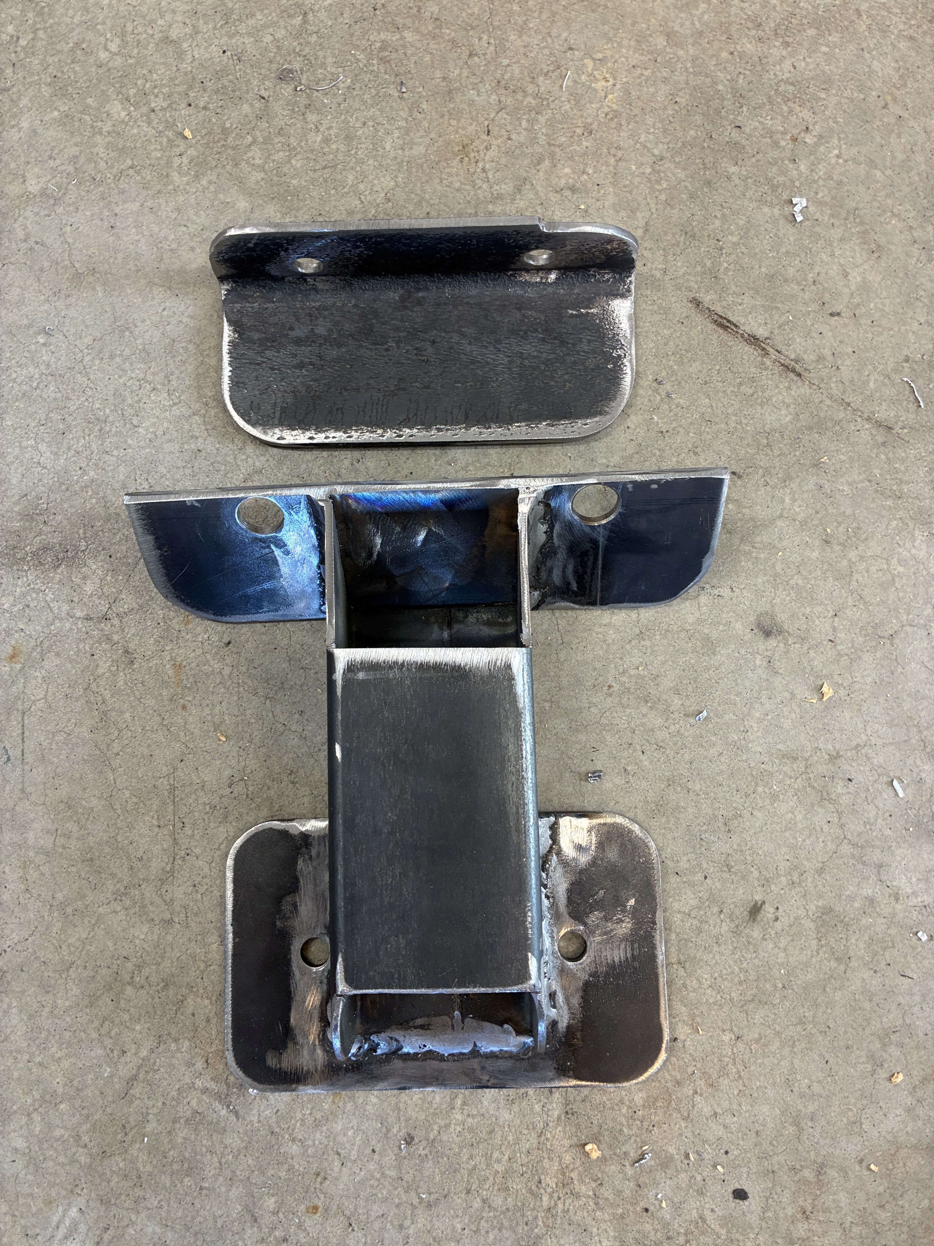

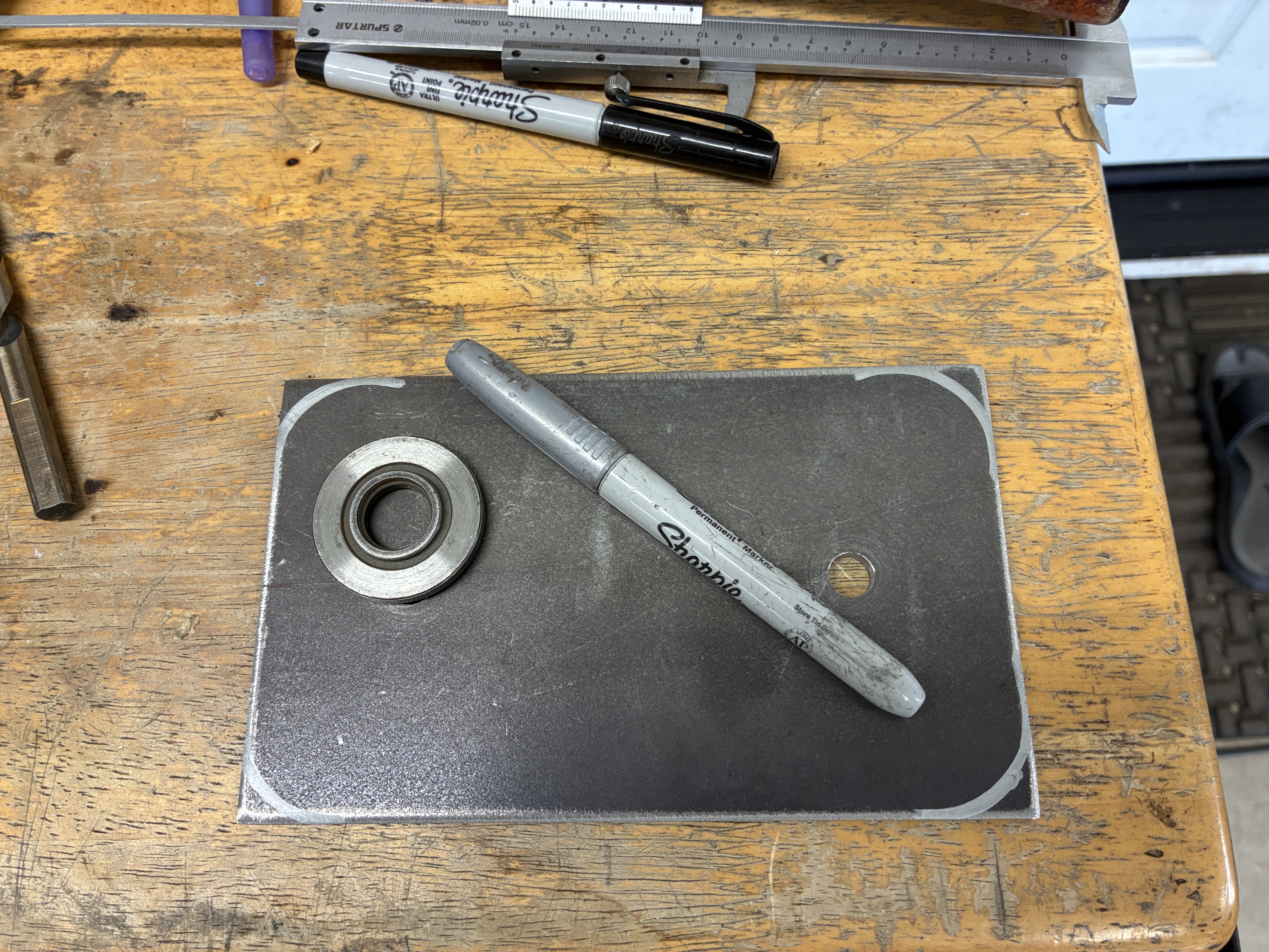

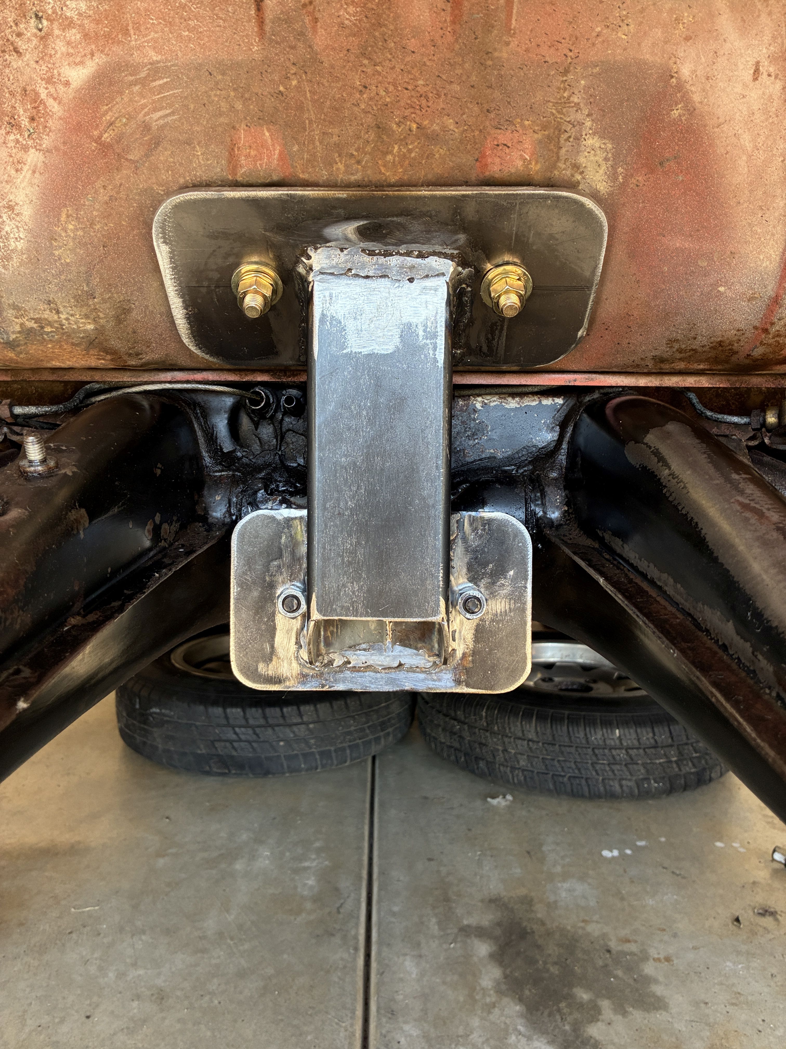

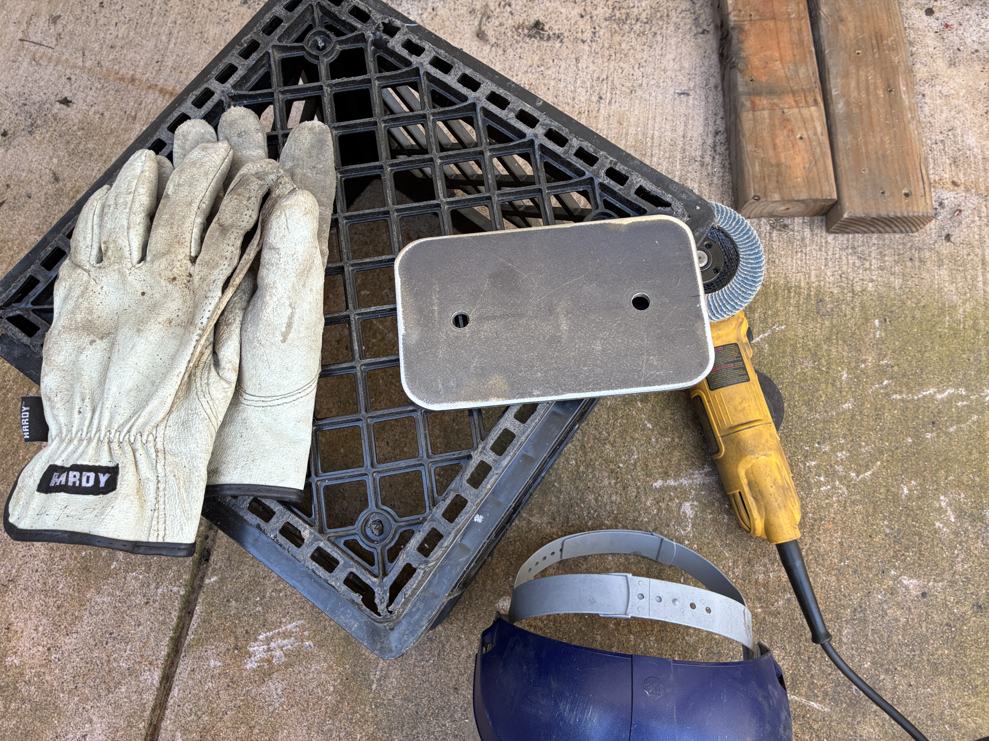

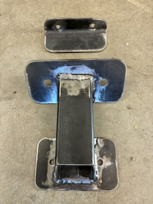

today we focus on the front motor bracket, and since it needs an odd offset and slant at an angle (all to be explained in the coming soon video) we opted to use the much cheaper and bugger welder friendly steel
and then it was off to Send Hack Send...
for the love of God, can somebody please move that annoying green broom stick!
we don't just cut corners here at the Good Enuff Garage, we round them !

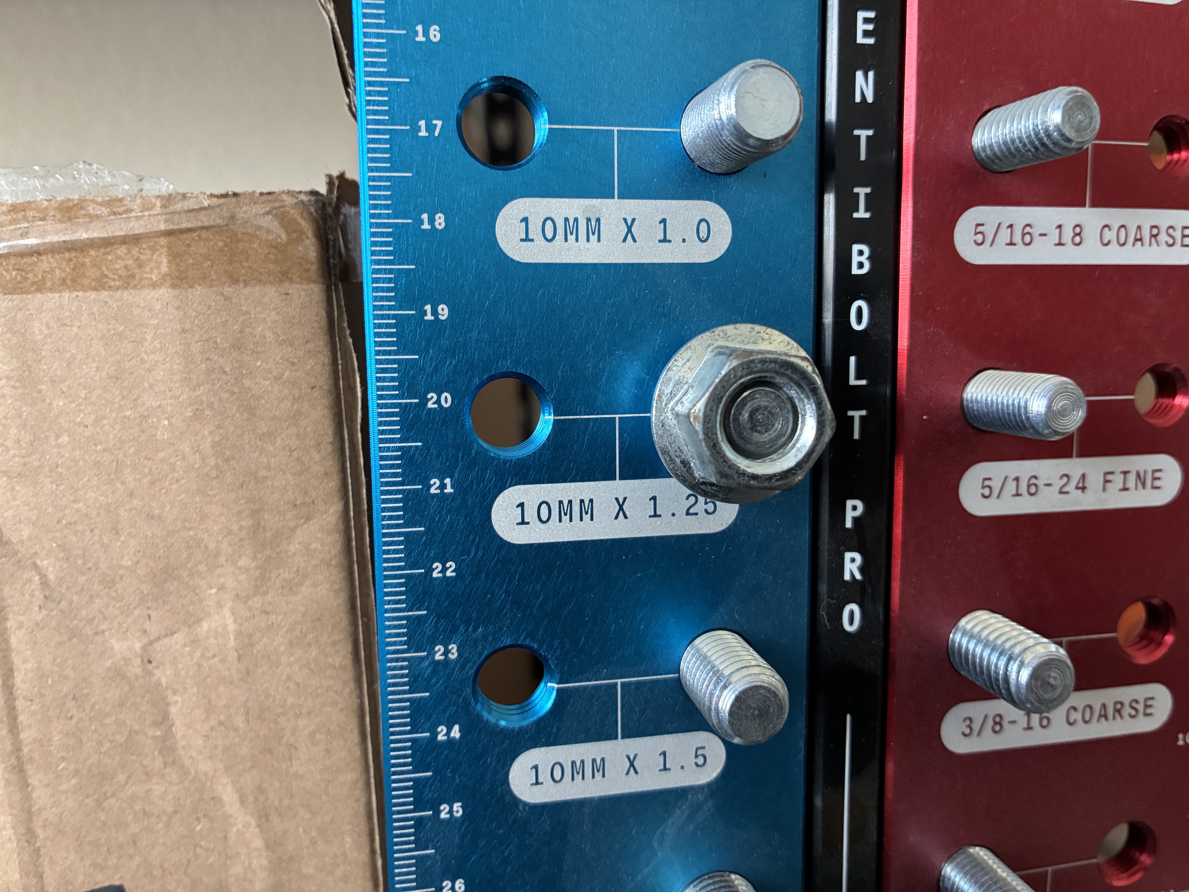

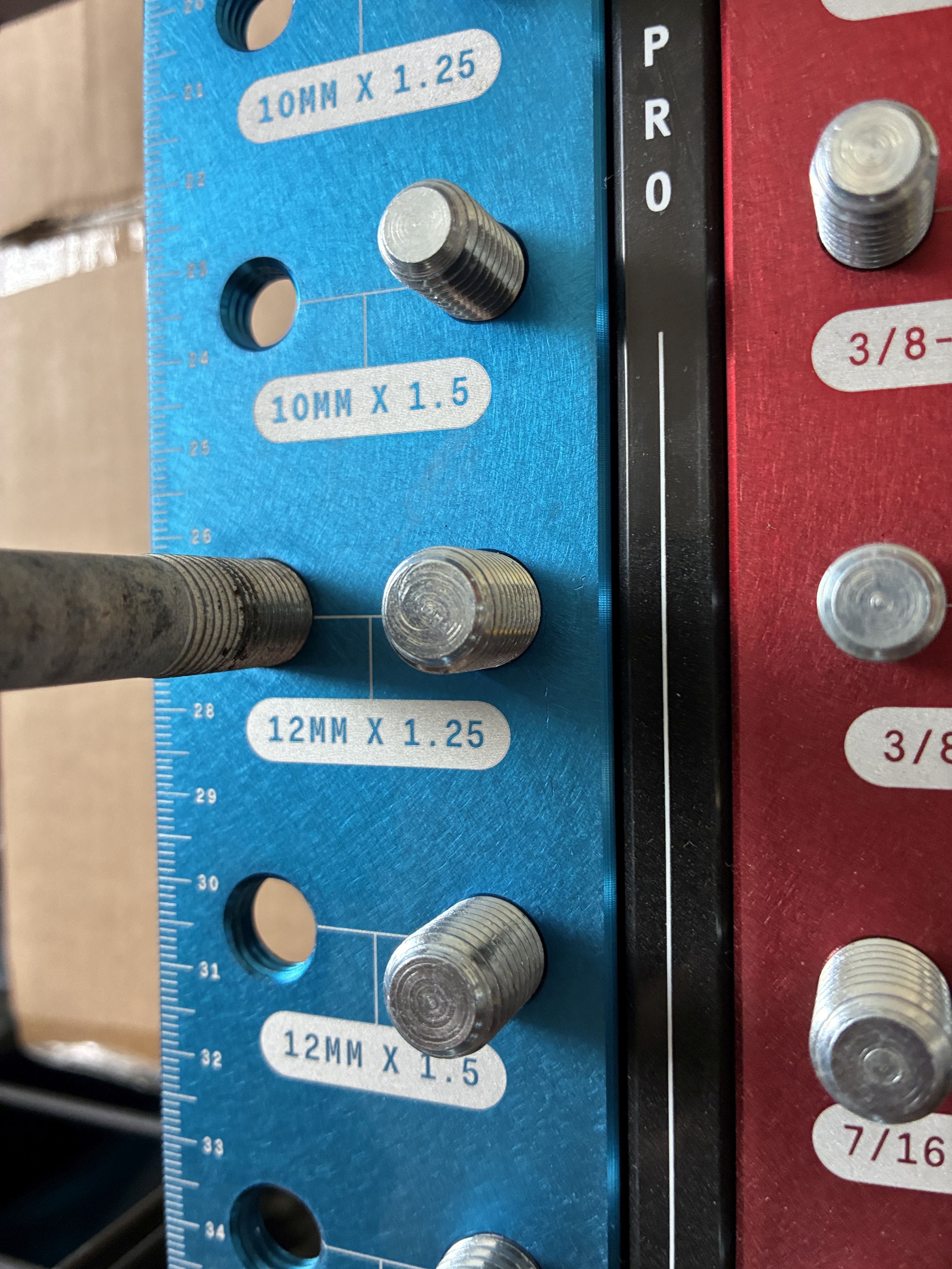

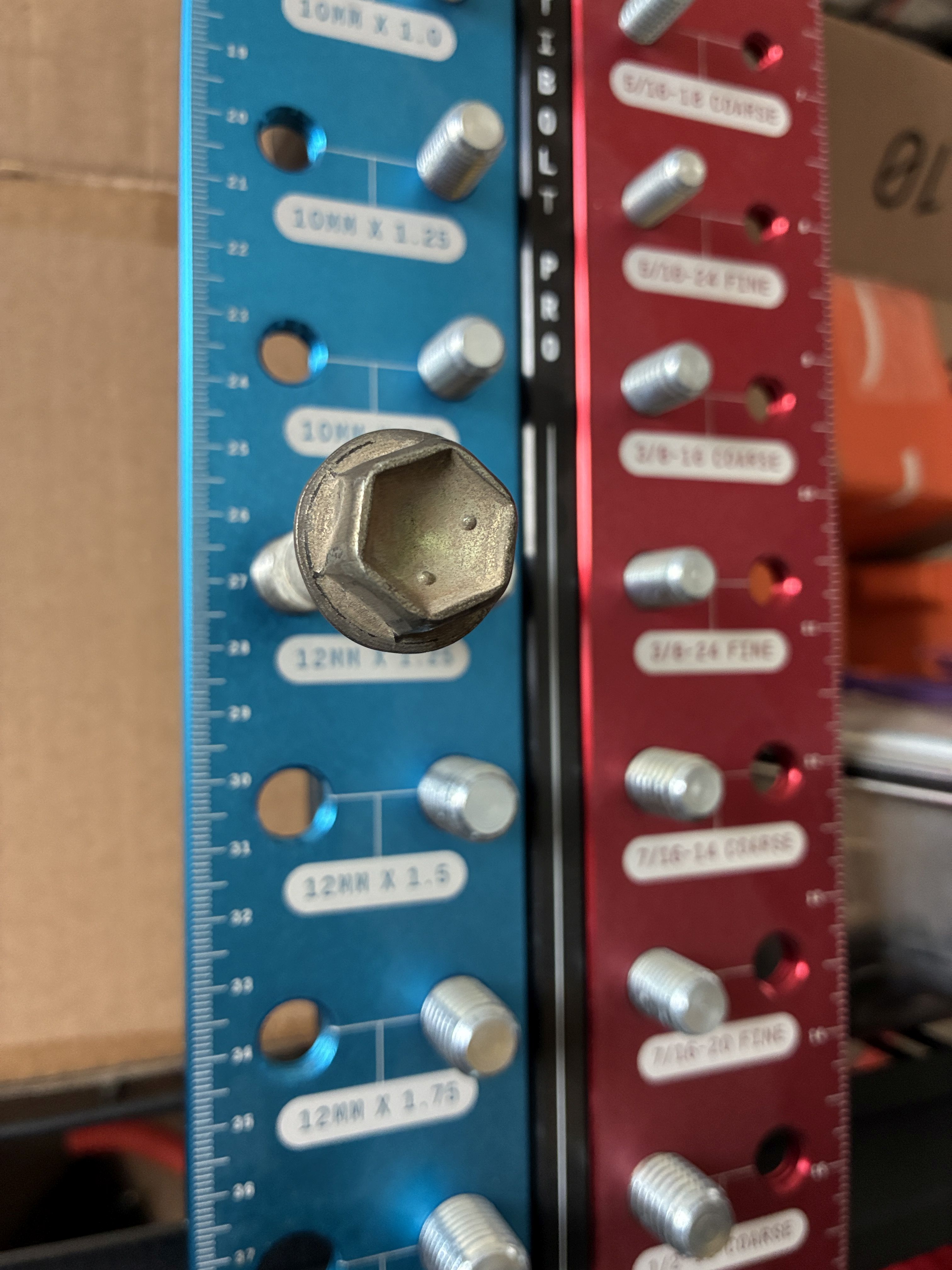

I had the toughest time finding the right 10mm pitch nuts for these two studs
here I'm using my super duper favorite and best nut identifier thingie, I absolutely love this thing, so I used it here to narrow it down to an M10 but as it turned out it was the 1.50 thread

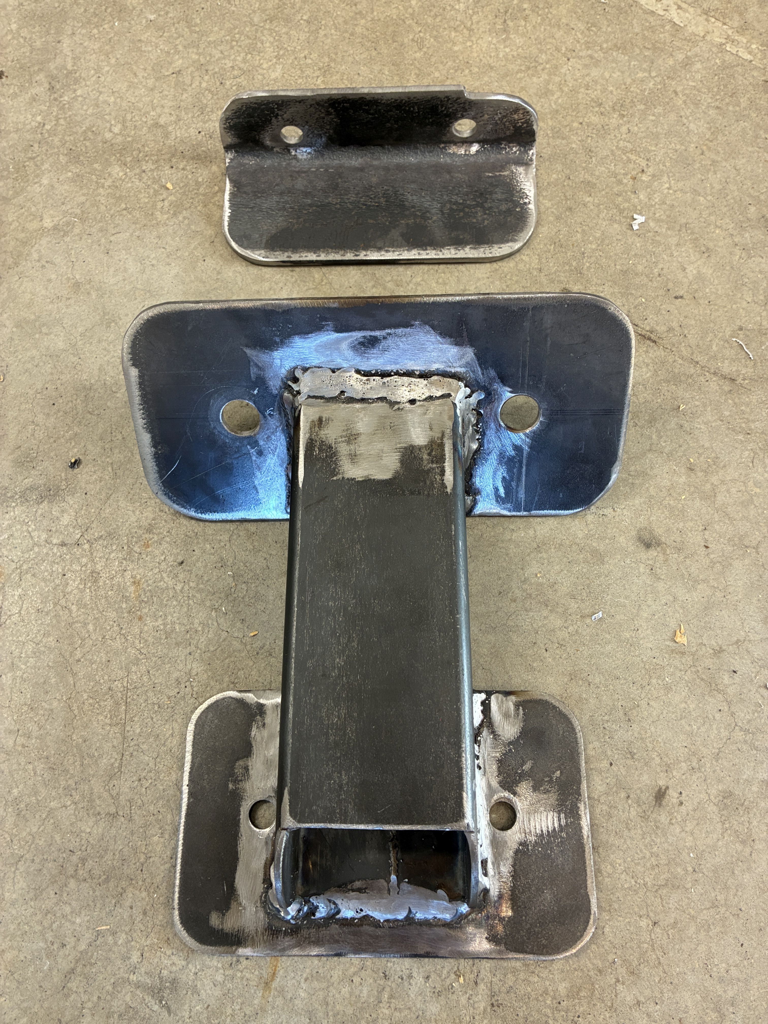

Post by Gregski »

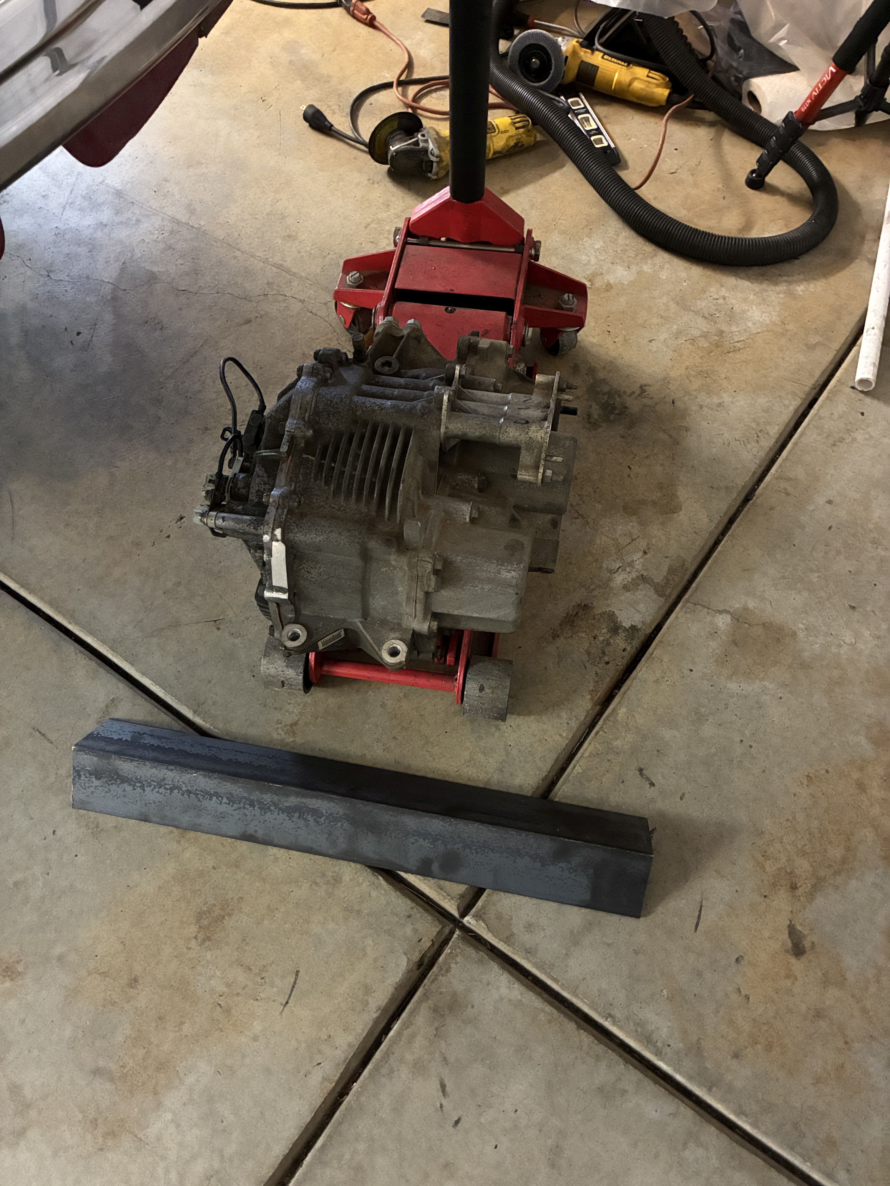

the vertical piece was next, but we'll have to wait till tomorrow for the finished product, wonder why ?
I swear, never fails !!!

Gregski wrote: Thu Feb 26, 2026 2:25 pmhere's the proposed Bunky Build Schedule ... I doubt I will be able to wrench on Bunky for 12 consecutive weekends
Wait, hol up. Is that how we're counting days now for this "30-day build"? As if they're billable hours on a law firm, and the time elapsed is just on retainer?
And people think this is a legitimate way of describing automotive projects?
*wipes forehead*
Whew. This makes my 7 year long conversion more like a 2 month conversion. Easy peasey. Heck, at 2 months it technically still qualifies as a "summer project"!
I've had it all wrong. I've been using spouse-days to measure my (lack of) progress. Spouse-days of course being how long this unfinished, torn apart, POS vehicle has been sitting on the lawn/driveway/garage, being an eyesore and taking up space and not fulfilling its role as an object that benefits their lives and accomplishes things like transporting people and products.
Neither I nor you currently have a spouse, so, your argument is very convincing to me at the moment. Derelict vehicles? No. I'm surrounded by treasures of my own choosing.

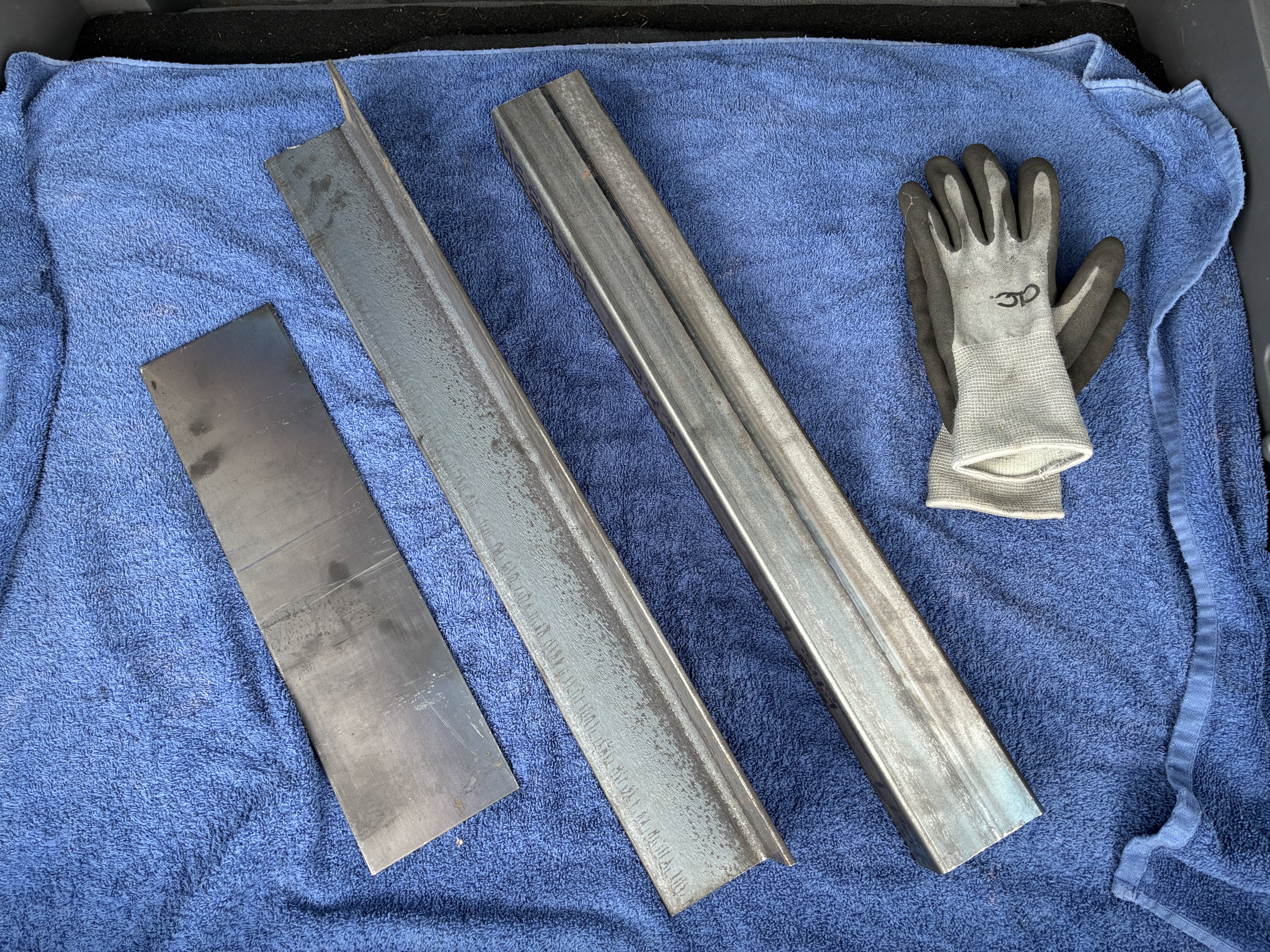

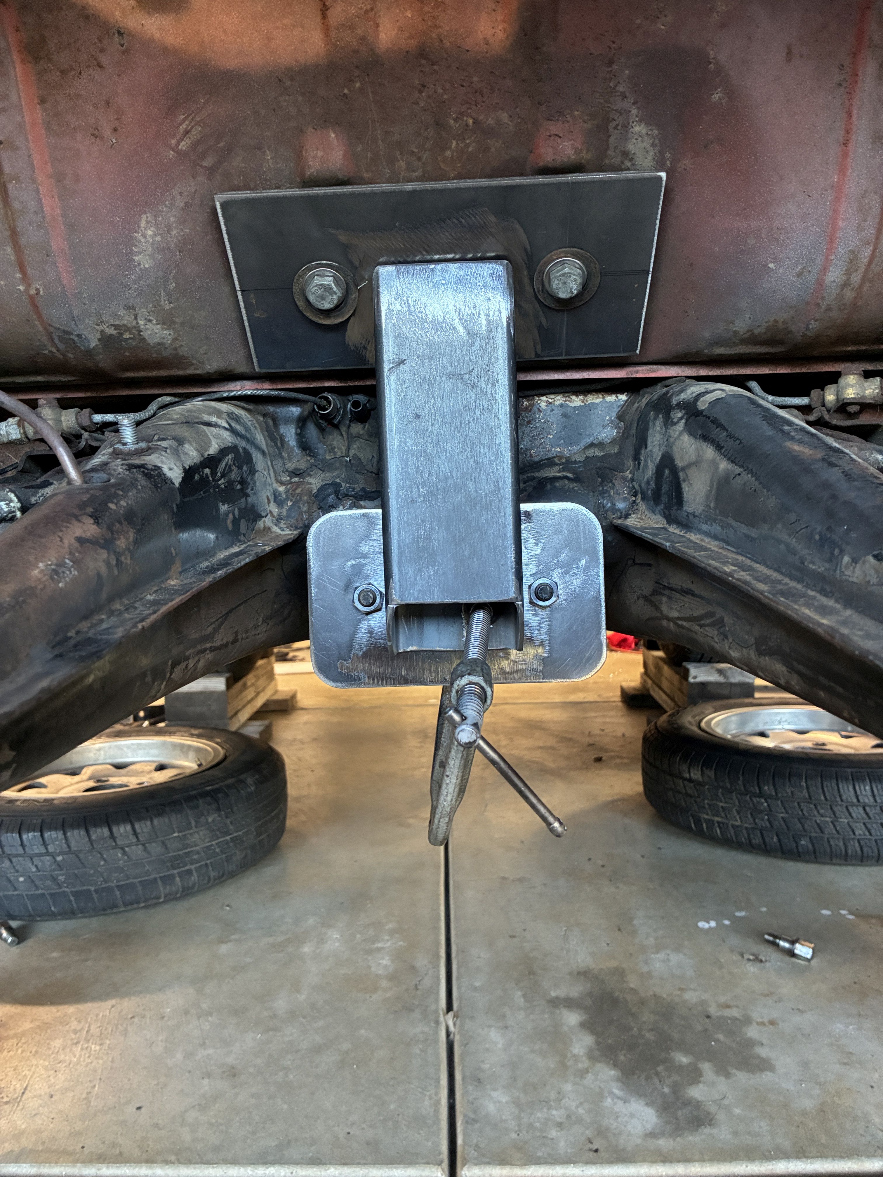

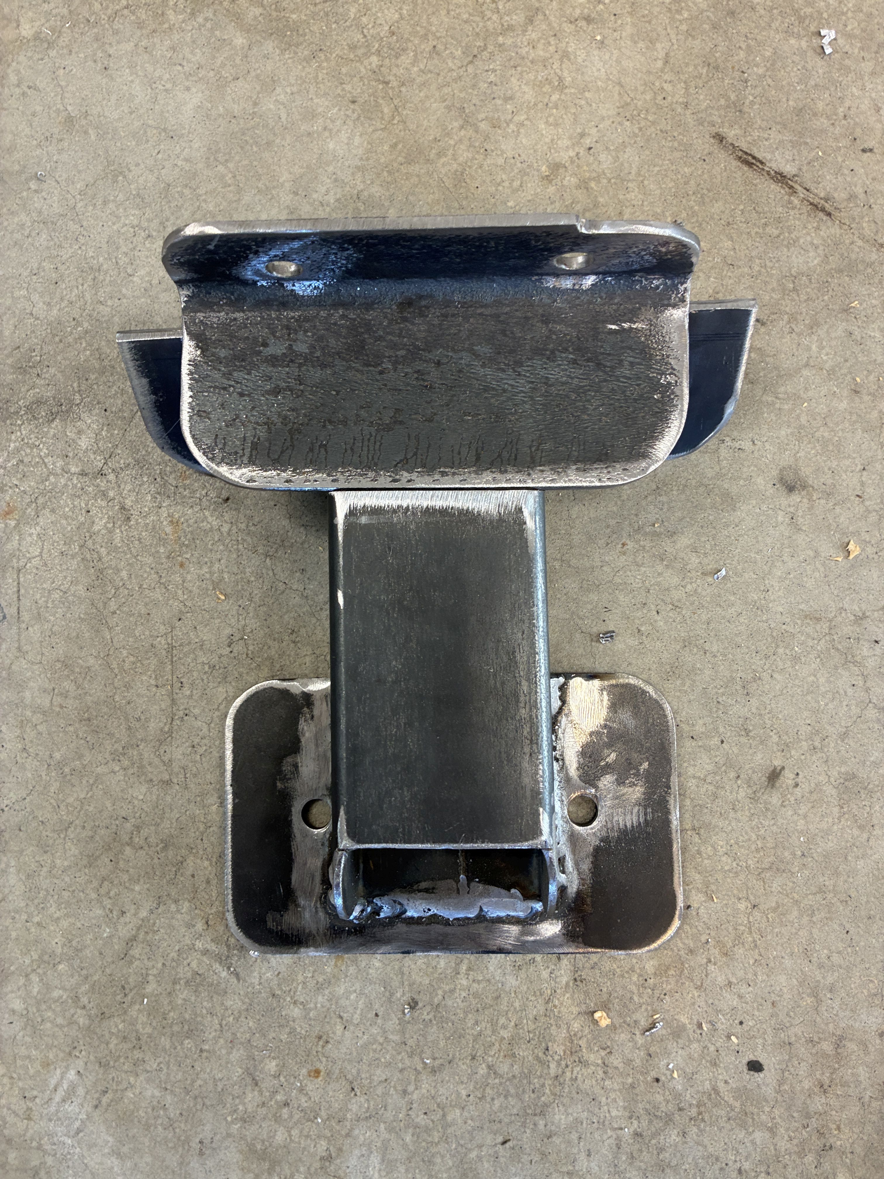

then it was time to work on the piece that would attach to the front of the little MGR
a chunk of 3" angle iron 3/16ths thick
we round the edges cause we're not Barbarians!
we needed some shorter M12 x 1.25 bolts

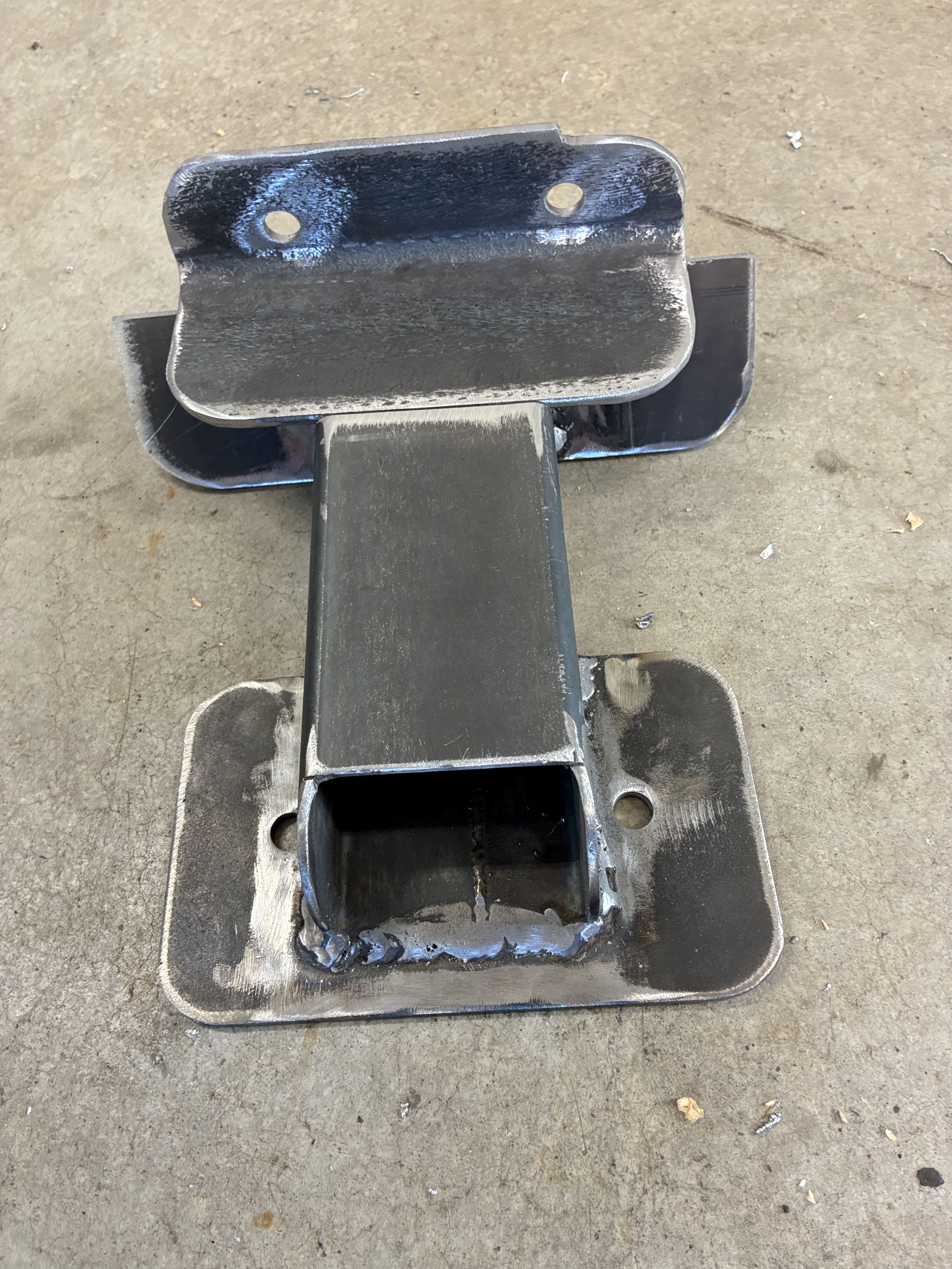

all welded up this pretty little thing had no idea what was coming...
death by a thousand cuts !
yes that cut was crooked, I aligned the straight edge with the cab, silly me! (I corrected it with a speed square later)
