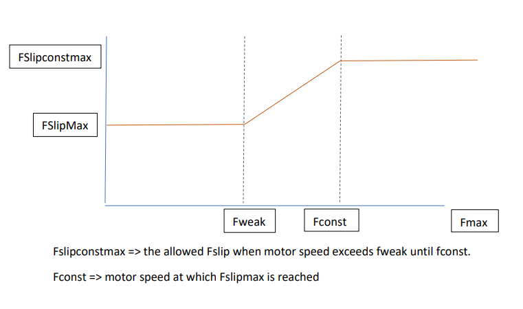

Some info I found on my PC around tuning
Parameter settings
Fmax = 600hz or 18K rpm
Fweak = 250hz - motor base speed
FSlipMax = 3-5 - application dependent, tune it for low end acceleration
Tuning
Fslipconstmax
Needs to be larger then FSlipMax, increasing it will give more top end power.
Increase it starting at 1 or 2hz increment until you can reach Fmax
Fconst
This needs to be higher then Fweak, set it at Fweak + 100 to start. Move the value closer to Fweak if there is a dip in power in the mid range. If there is a drop off after midrange move it further away.
