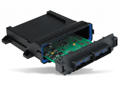

I'll have to check whether adapter + V3 mainboard fit in a ModICE enclosure. I would use the 20+20 version and loose 6 of the 26 controller pins. 12V/GND come from the inverter, emcy_stop, mprot, and 2 outputs will be dropped.

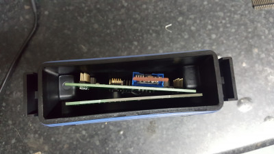

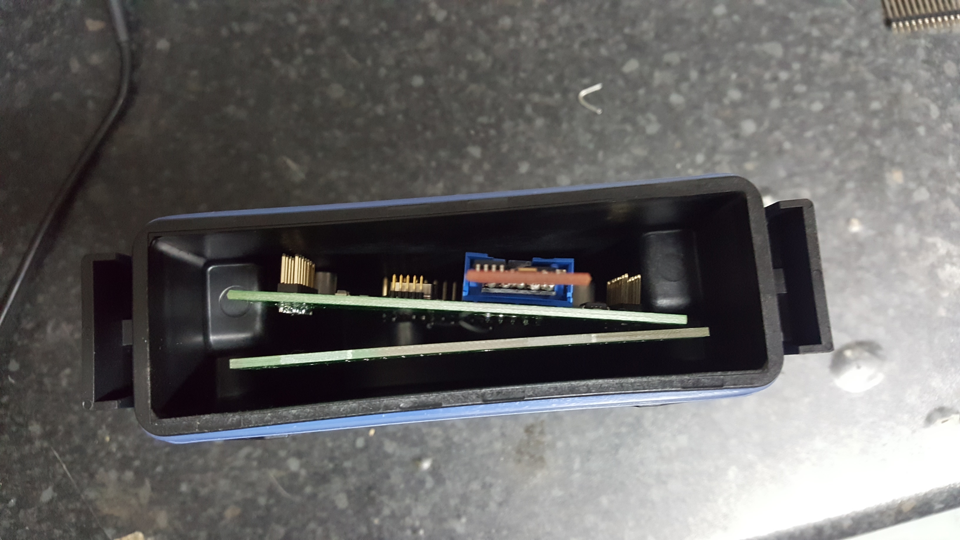

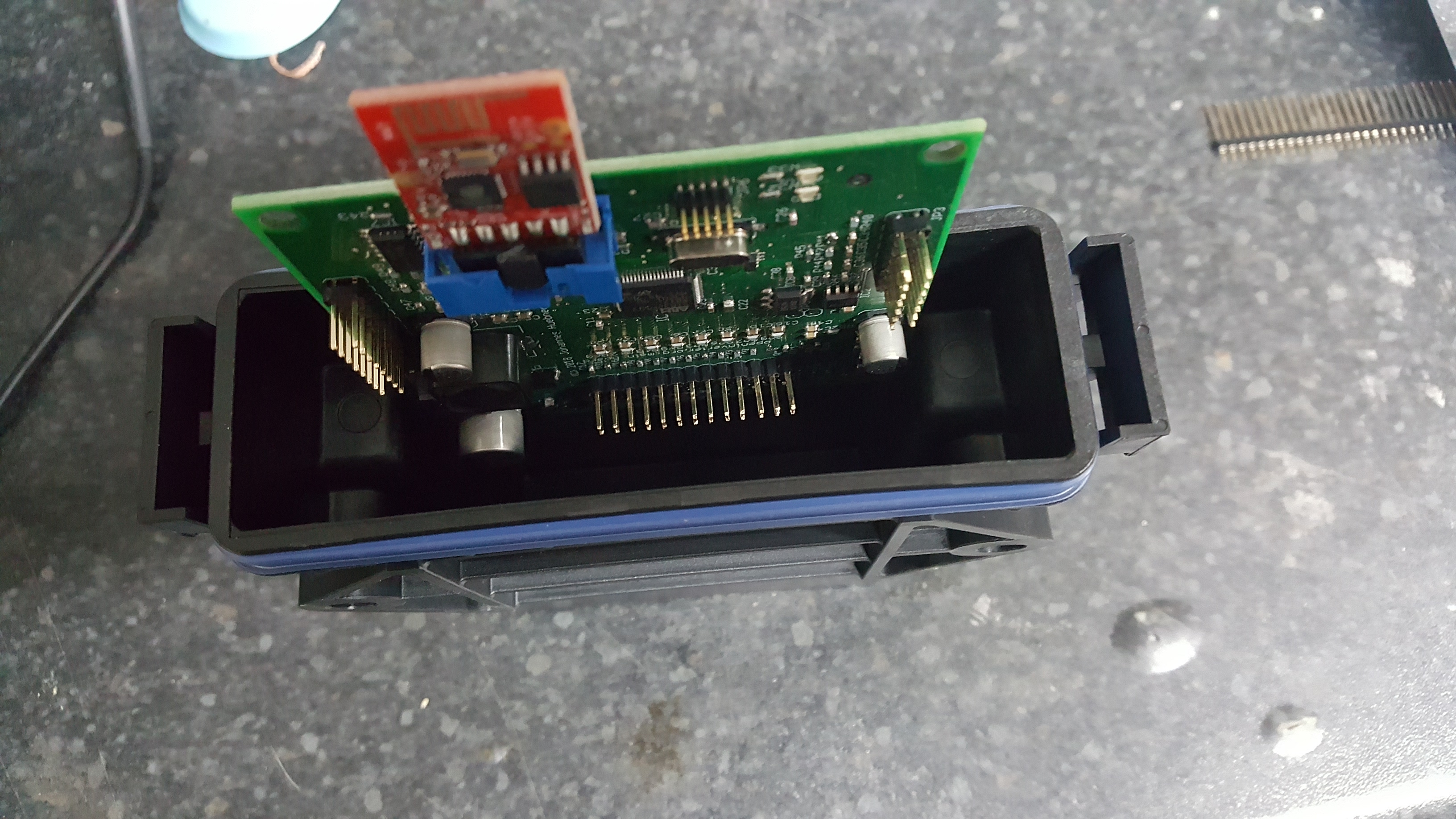

I have a few modice enclosures here. I'll do a quick test and see if a v3 mainboard will fit on top of a lexus vcu board:)
Posts: 4000
Been thanked: 1117 times
Mainboard about 2mm too wide to fit an me mx enclosure :(

Jack Bauer wrote: Sat Apr 18, 2020 10:19 am Mainboard about 2mm too wide to fit an me mx enclosure :(
ok, so either I shrink the main board by 2mm, or find another enclosure, or reconsider putting it inside the inverter. Thanks for checking, anyway!
