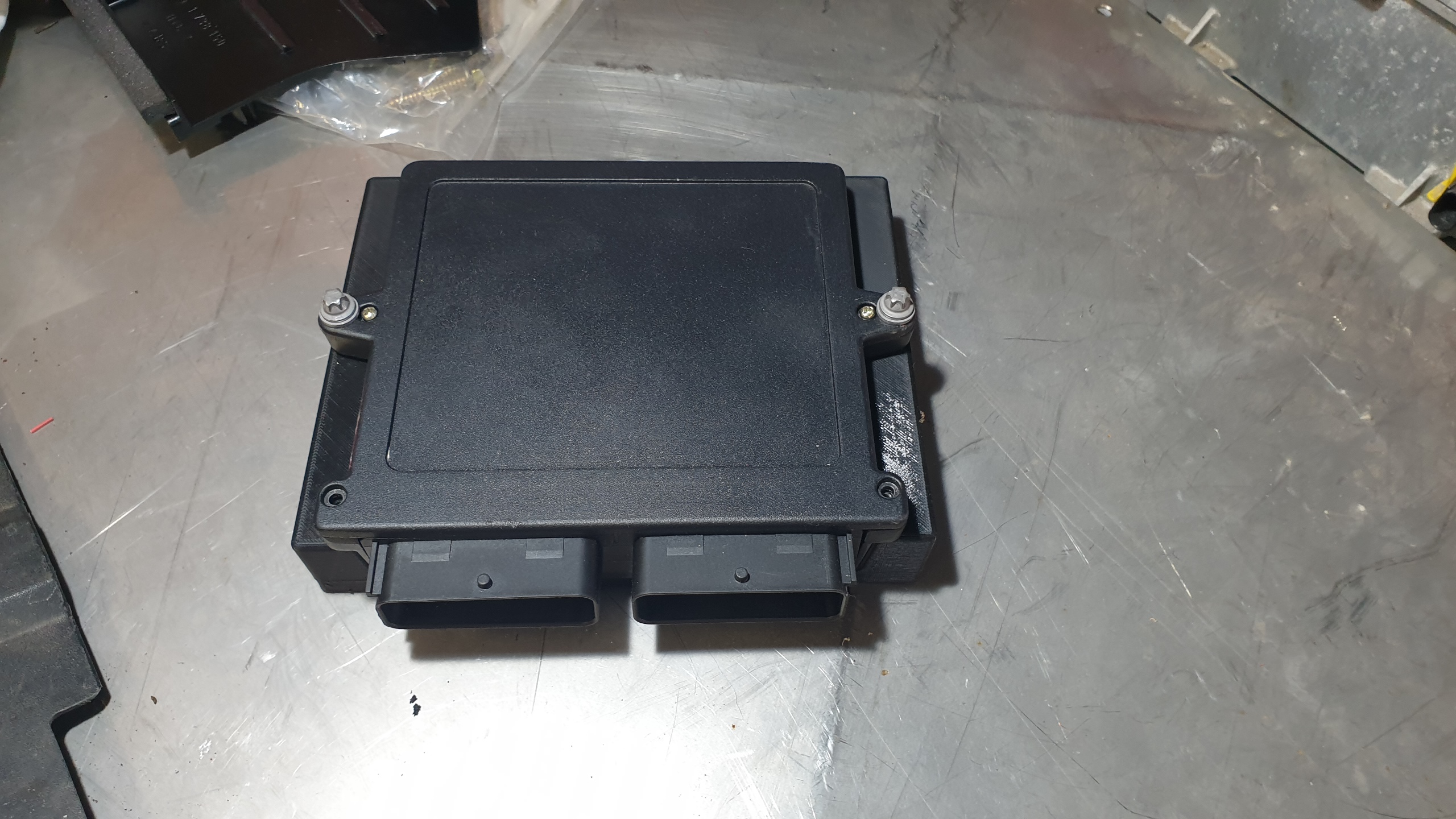

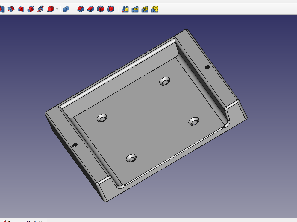

Simple 3d printable mounting bracket for Zombieverter VCU. Threaded holes are 6mm and will need to be cleaned up with a tap after print. I used PETG at 25% infill.
