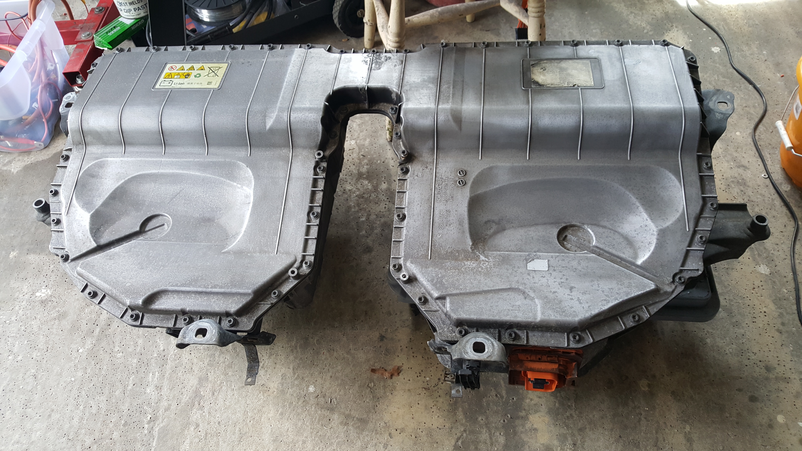

Battery just arrived. No idea on power beyond what is listed on newtis. Will find out when driving.

clanger9
Posts: 203
Location: Chester, UK
Post by clanger9 »
That was quick!
