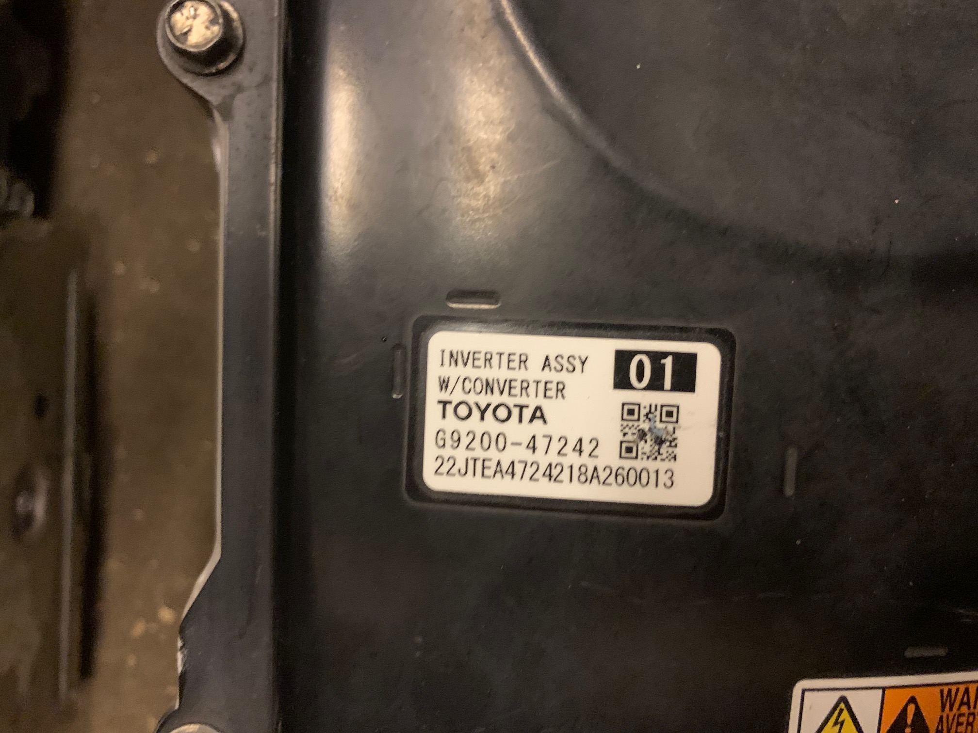

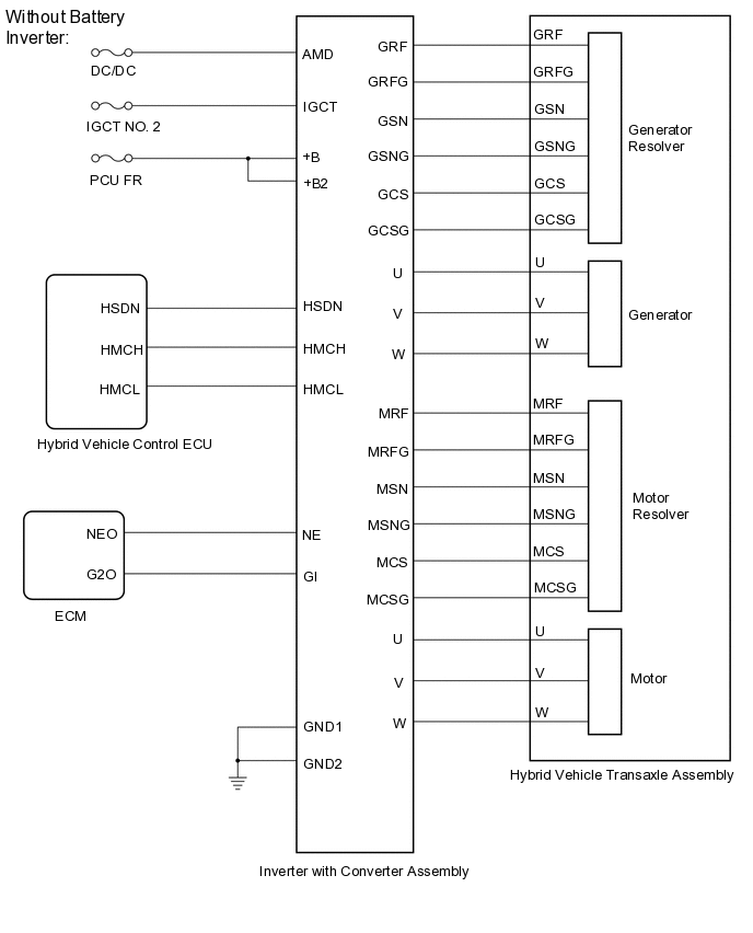

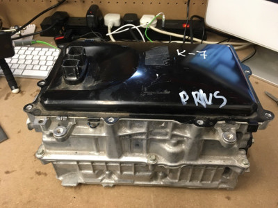

Due to a kind donation I now have a Gen 4 inverter / converter for reverse engineering / hacking. Starting a thread to document the progress.

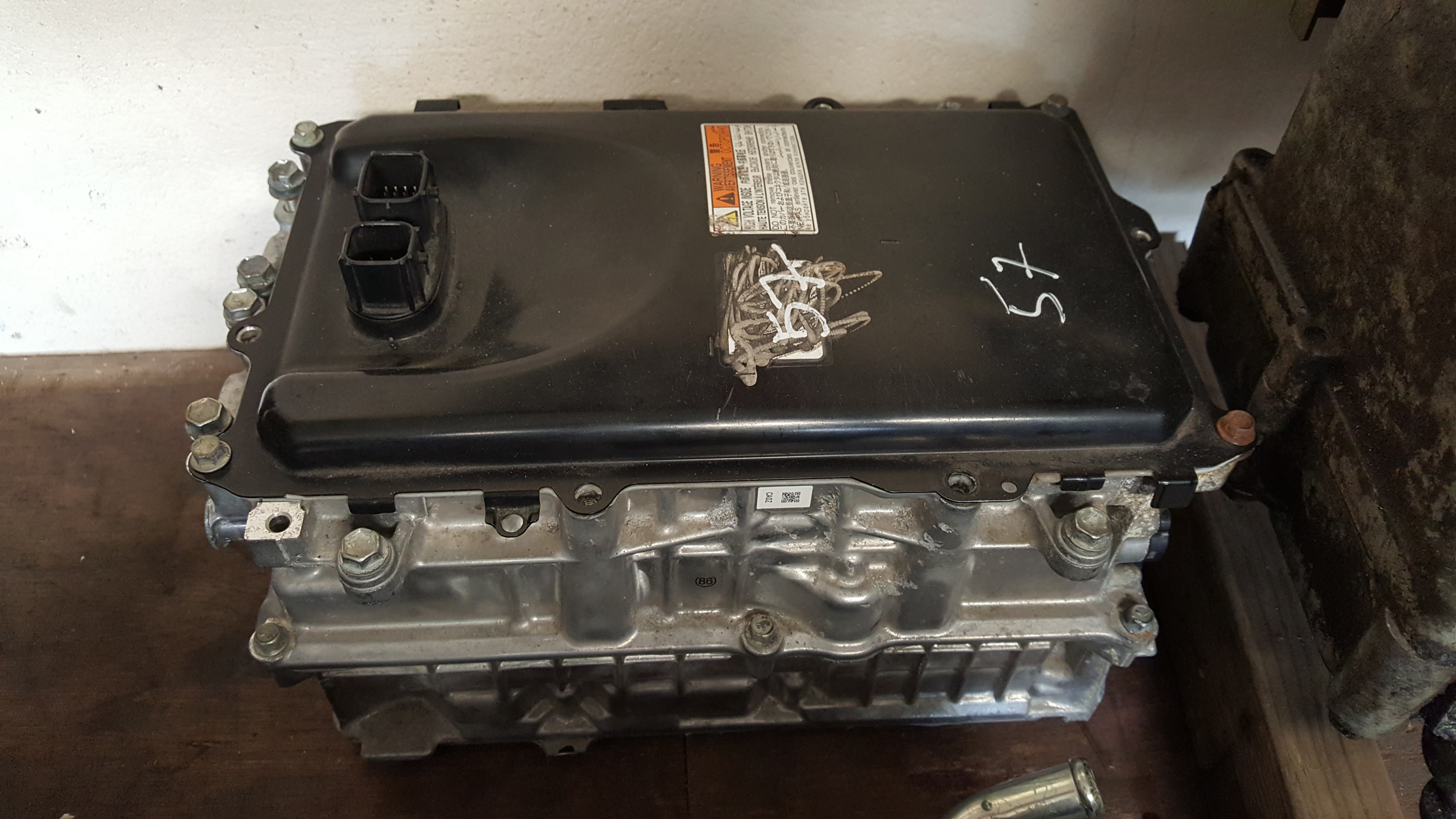

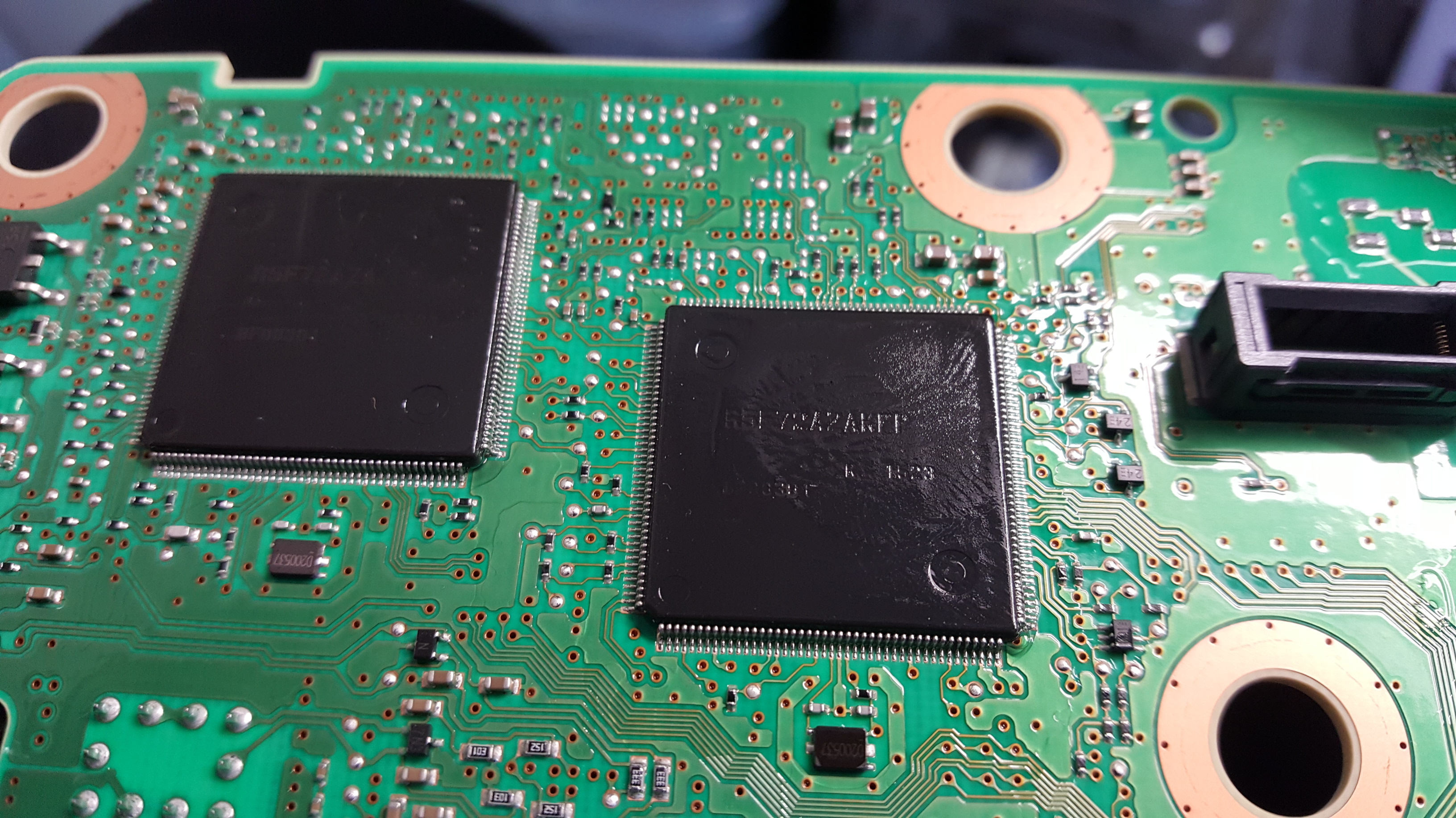

Got the inverter on the bench for a first look. I love these Toyota boards. 5 minutes of visual inspection and your half way there. Very logical layout.
The two big square qfp parts have part number : r5f72azakfp
A quick search yeilded this document with some good info :
https://www.energy.gov/sites/prod/files ... 2017_o.pdf

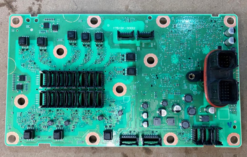

Prius Gen 4 inverter hacking
So, I have a cheap Chinese 'scope and a bunch of crazy ideas.
I'm going to have a go at destroying hacking a Prius Gen 4 inverter, with a view to maybe doing a Damien-style modboard.
So far, I removed the control board from the inverter. I guess the first step is to power it up with 12V and see what makes it tick...
Has anybody tried playing around with this inverter, or am I starting with the proverbial blank sheet of paper?

As this model has the logic and driver functions combined on a single board, would it be easier to go the plug and play separate VCU approach? As with the Lexus GS450H VCU?
- clanger9
- Posts: 203
- Location: Chester, UK
Re: Prius Gen 4 Inverter Hacking
I think the VCU approach would make a lot of sense for controlling a Toyota MGU.
I'm not sure it will work for my application, where I want to do something very different with the inverter hardware...

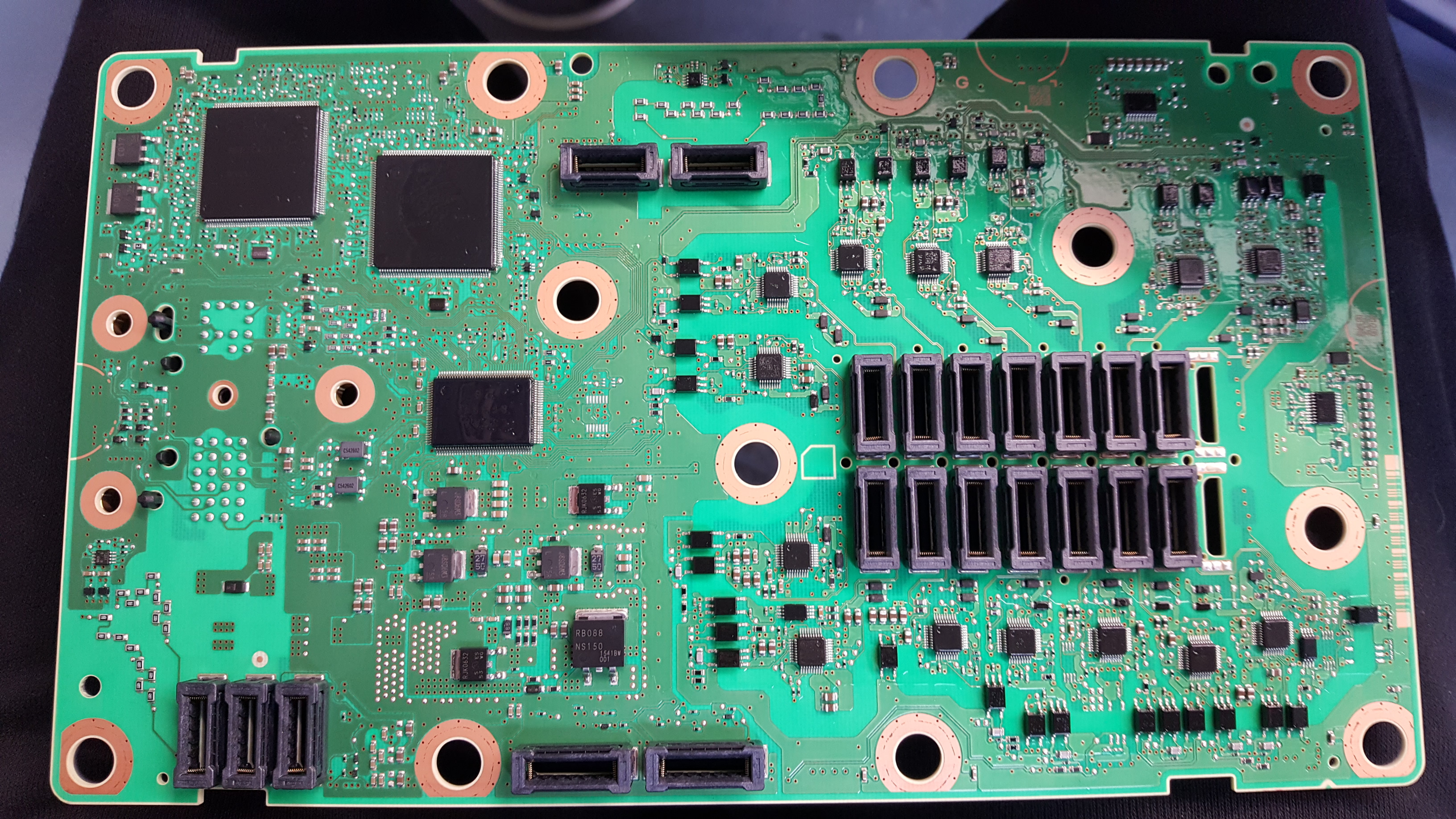

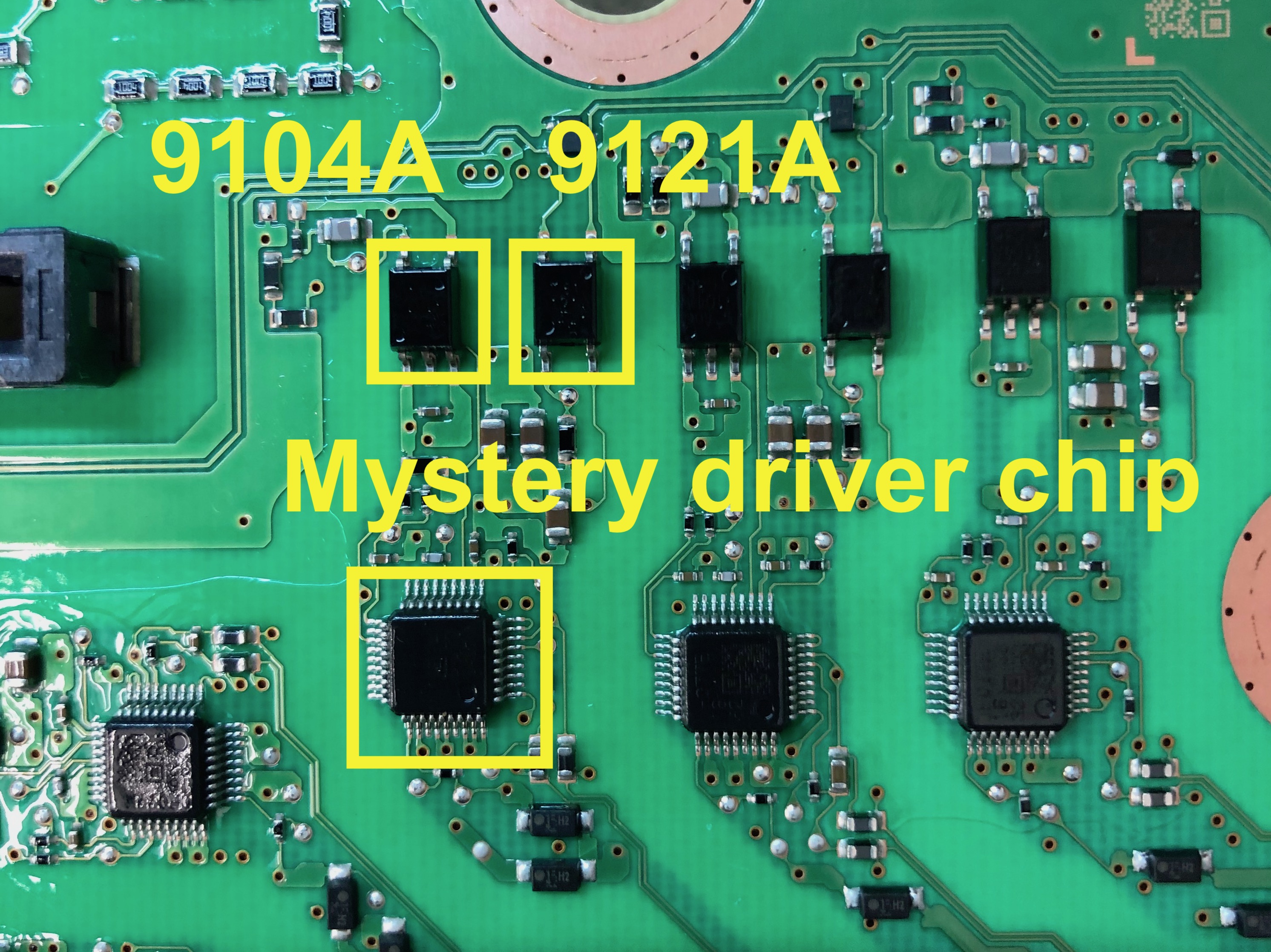

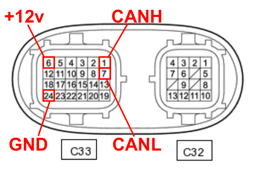

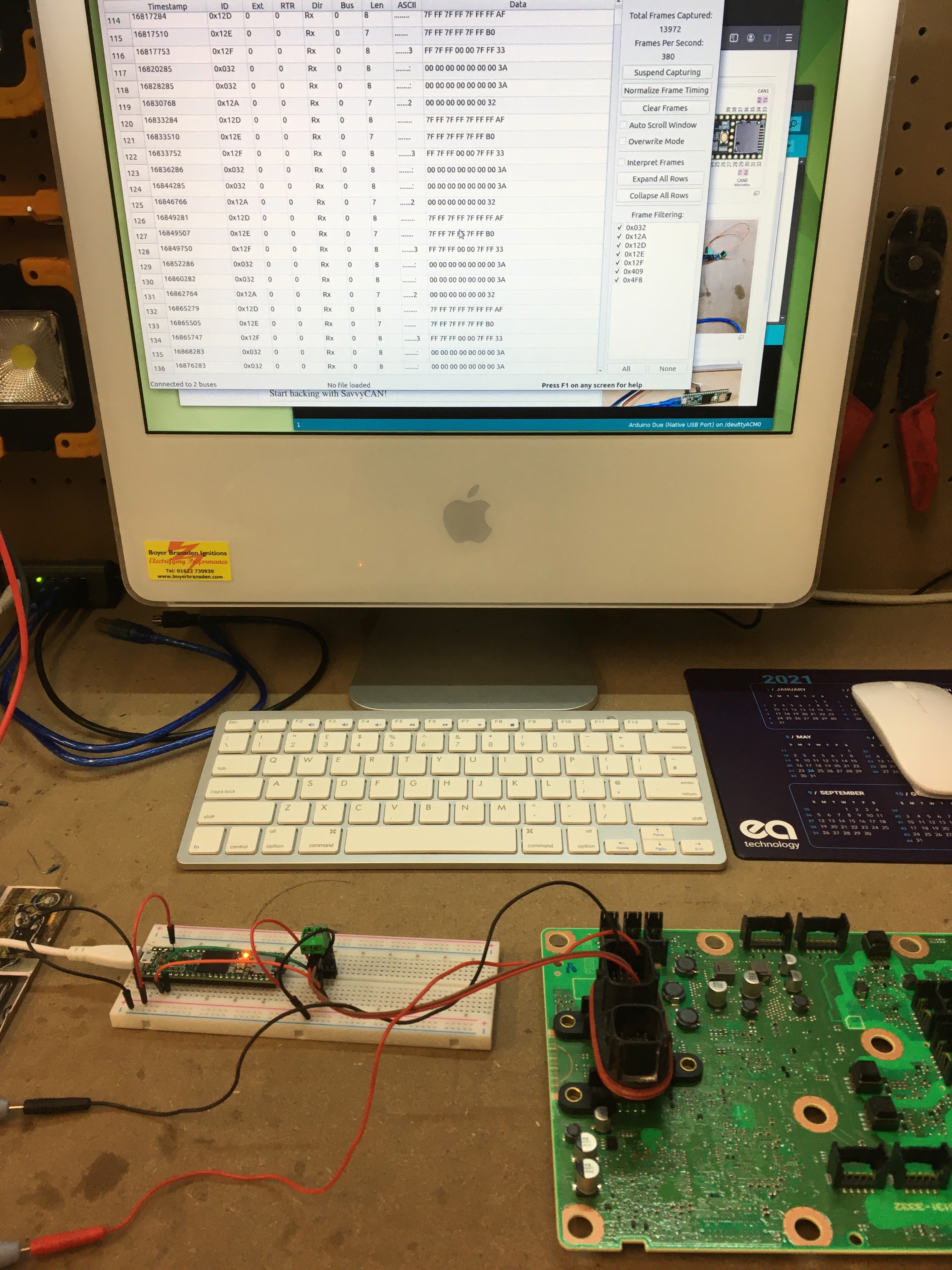

Thanks to Damien's pin-out data, I was able to power the board up. Which is a nice start.
The board pulls about 8 watts. There are no blinkenlights, which is always a minor disappointment. CAN traffic appears almost immediately, which I was able to capture with SavvyCAN. I don't know what the messages mean - presumably something like "Help me; my car appears to be missing..." The inverter itself consists of 14 separately controlled IGBTs (2x 3-phase stages + 1x buck-boost stage), each with its own mystery high-side controller chip that talks to the low-side via a pair of opto-isolators (1x 9104A, 1x 9121A). One for send and one for receive?
At this point, I run out of knowledge, although a quick trace of the boards suggests the opto isolators are daisy-chained together. Is this a typical arrangement in vehicle inverters? How will the low-side comms be arranged? Some sort of SPI signalling or something else?
Any suggestions as to what I should try next? I guess my ultimate objective is to be able to control the inverter stages directly using Johannes-style software.
I will have a poke around and see if I can see any chatter on the low side...

I will get myself a new Gen4 inverter and also the RAV4 version (which looks the same except it has an addition inverter for the rear wheel drive).
My idea for starting to figure out the CAN messages would be to use the SavvyCan changes feature (can't remember what it's called) and then start changing things. Obvious things would be to change the 12V voltage and see which message changes. Then connect HV side and start playing with voltage there. Rinse, repeat, post findings here.

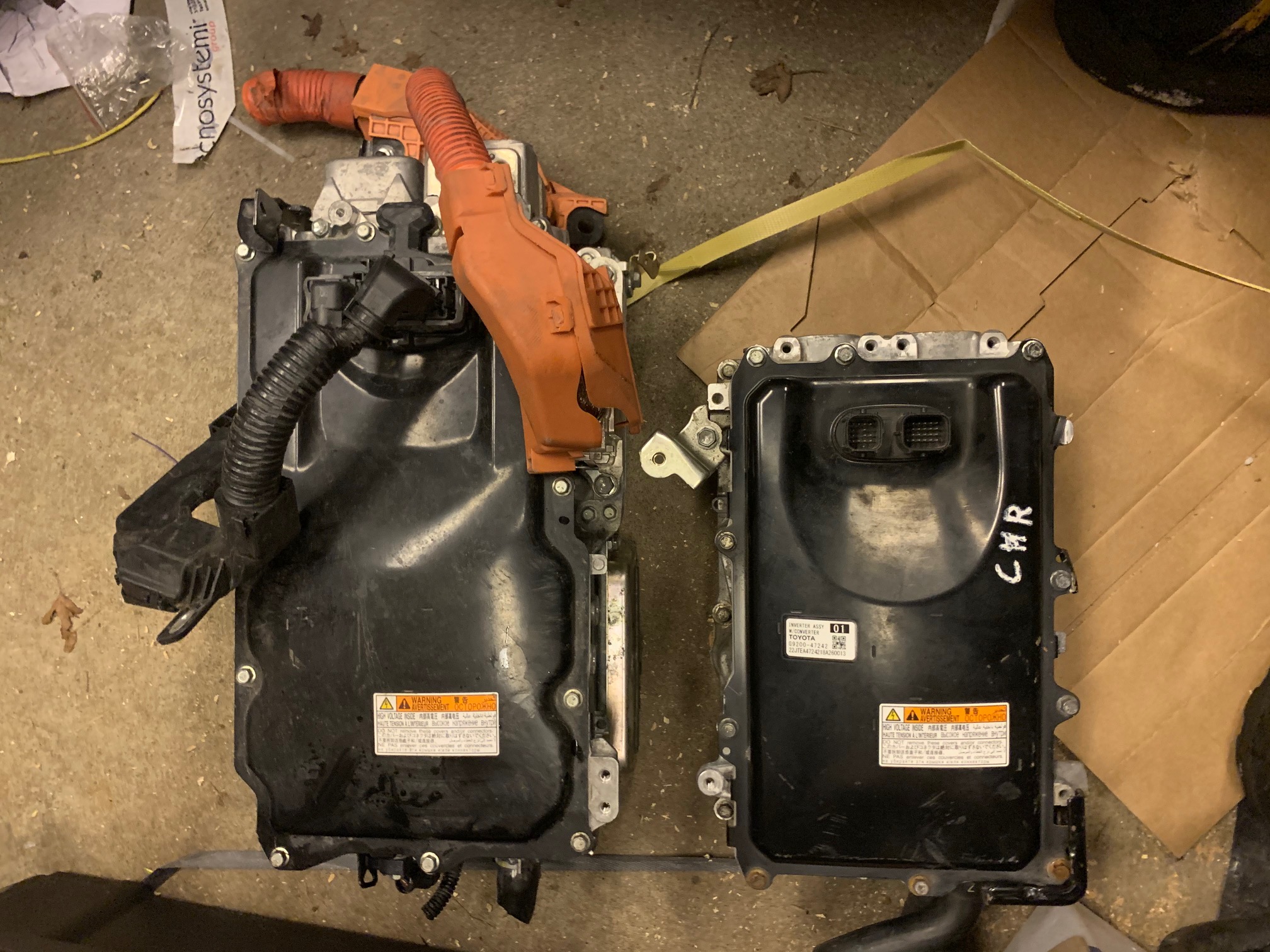

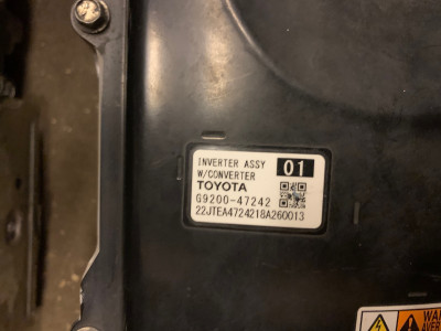

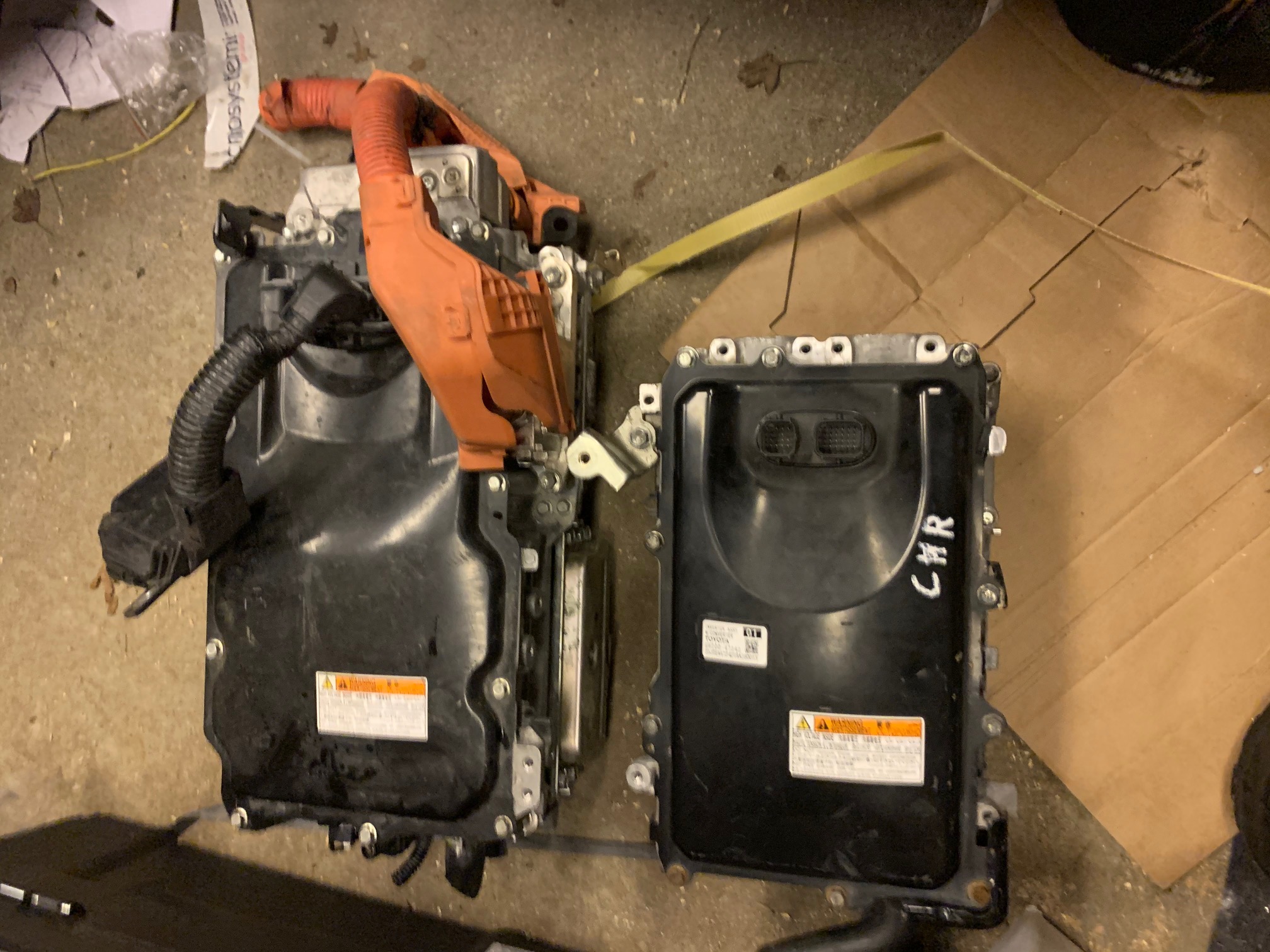

I could not resist when I saw a CH-R and a 4WD RAV4 Gen4 inverters available for 100 euros each.
To my surprise the RAV4 inverter is much larger than the CH-R. It has 3 inverters in it but it still looks much beefier than I could have imagined.
I will crack them open sometime and post more photos soon.
Do you happen to know the weight of both the units?
jnsaff wrote: ↑Fri Feb 19, 2021 6:03 pm I could not resist when I saw a CH-R and a 4WD RAV4 Gen4 inverters available for 100 euros each.
