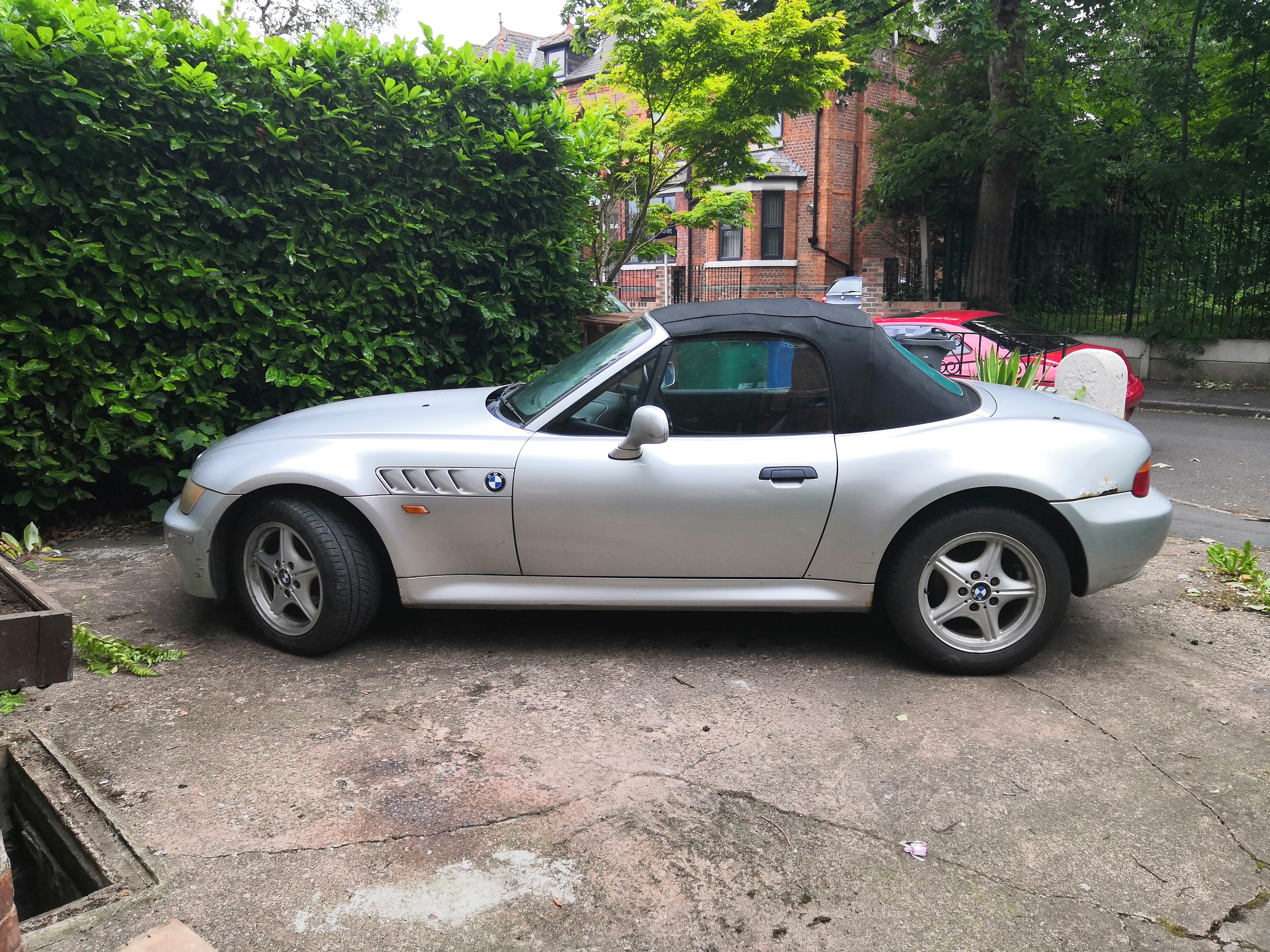

After a few(!) glasses of wine yesterday, I took the plunge and actually bought the car we're going to convert. Which means I guess the dabbling phase is over and I ought to post something here.
The 'we' is my increasingly car-obsessed 10yo daughter and me. She's both the inspiration and the motivation for this project. And the learning she will get helps me to justify spending the money on it.
The plan is initially to build an electric BMW Z3. To that end I broke all the rules yesterday and bought one off Gumtree, unseen and with very little investigation, from the other end of the country (I'm in Manchester (UK), the car is in Cornwall). In my defence, it was only £600 so even with shipping I'll be into it for less than a grand. With a bit of a tidy up and some minor repairs, I'm fairly confident we could sell it for more than that.
But if all goes to plan, it's going electric. Right now, I'm playing with a Prius inverter (stripped down and just waiting on a board from Damien) and Outlander front motor but increasingly think that might just be for learning. The Bexus route is very attractive and if it would fit in the tunnel then a 300hp roadster sounds like a lot of fun.
Battery-wise I want to experiment with the packs from the 330e. Hoping between the work on the i3 and the 530 packs, someone will have nailed down the CAN messages for those soon. Need to measure up but wondering if I could squeeze one of those in under the bonnet - especially if I go down the Lexus route. That would make for a neat (and cost-effective) initial conversion, with the option of adding more packs at the back of the car down the line.
Once we have a working car, then the aim is to do a body conversion using the Tribute Z300s kit. Daughter rather likes the 60s-style roadsters and I think she has excellent taste :-)
Trying to keep it simple for now though: can we make a car move under battery power?

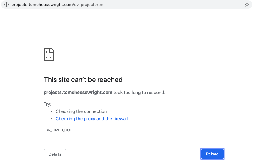

bobby_come_lately wrote: Sun May 17, 2020 5:35 am Documenting everything I do and have learned over here - so far mostly about the Outlander front motor: https://projects.tomcheesewright.com/ev-project.html
Can you please post some pictures/information here not just via a third party website? We don't want to break the thread when the host inevitably disappears in the future (or stops working like today).

Absolutely - will repost stuff from there. My bad on the link - so used to typing https I forgot I don't have a certificate on this site yet: http://projects.tomcheesewright.com is the right link.

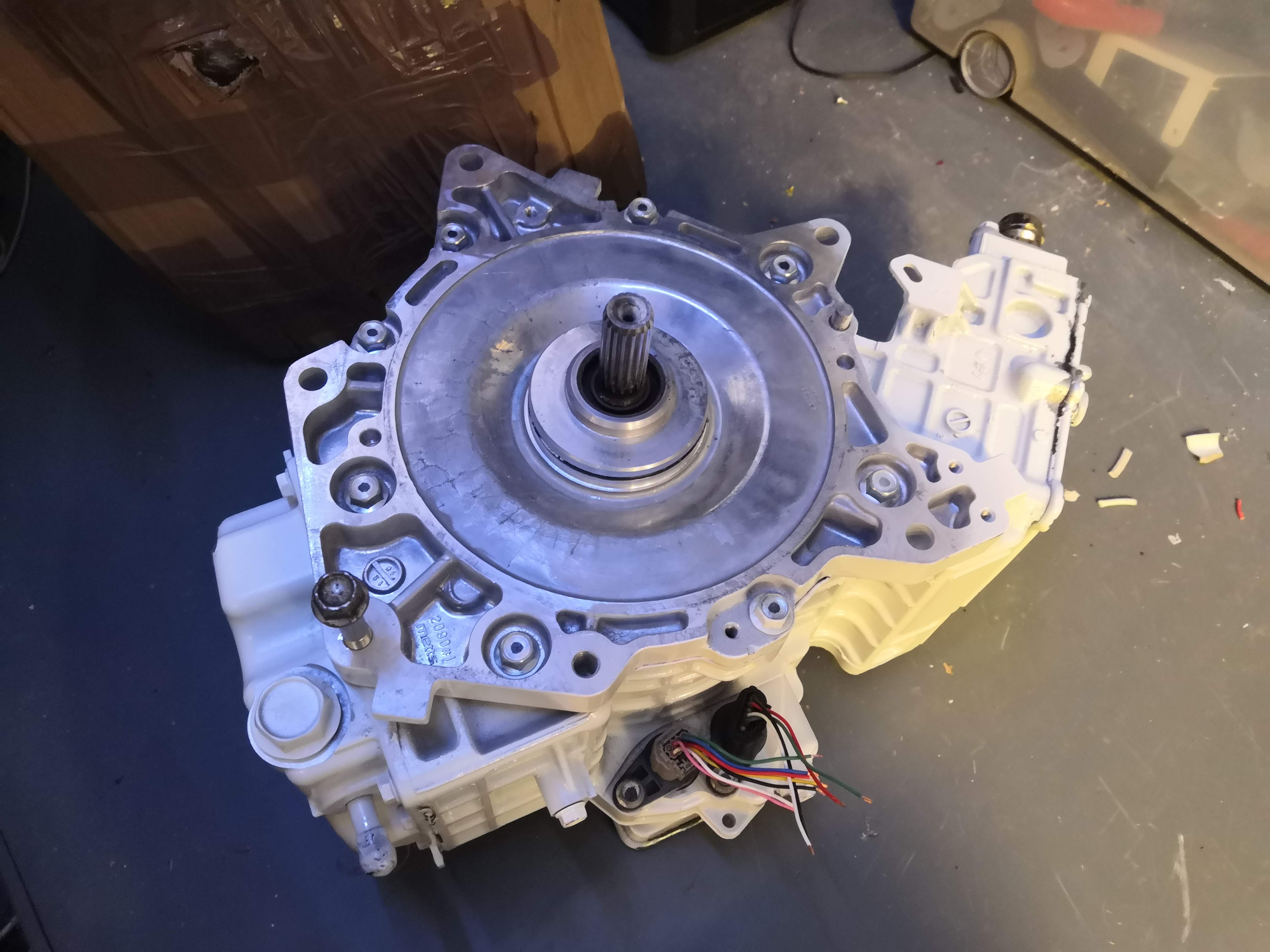

The Outlander motor has two multi-pin connectors on it, one with eight pins and one with six. Fortunately, Second Life Batteries also supplied me with the plugs for these connectors, and they still had some cut off wires from where they were installed. Four wires coming from the 6-pin connector and seven from the 8-pin connector.
A little googling brought me to a Russian online service manual for the PHEV, which contained heaps of useful information. To save you the ads for Russian brides, and because I think it is wrong in places, I've tried to aggregate that information and improve on it here.
6-Pin Connector
Outlander PHEV 6-pin motor connector
Written on this connector I found the numbers "12303". A little googling revealed that is used to connect the throttle pedal on Toyotas and Subarus. The first search results that came up all led me to the US for replacement parts at exorbitant cost. But a trip over to AliExpress turned up some bargains. In the end I bought two (just in case) for just £1.70 each including the pins and the cable shrouds that seal then junctions.
The six connections here are to three temperature thermistors buried in the body of the motor. One measures the U-phase coil temperature, one the W-phase coil temperature and one the general oil temperature via a separate thermistor. Here are the pins for measuring each of those:
Pin 11 (sticking with the numbering on the service manual): GTH1 - temperature in the U-phase coil (+ve)
Pin 12: GTH2 - temperature in the W-phase coil (+ve)
Pin 13: TH0 - oil temperature thermistor (+ve)
Pin 14: GTG1 - temperature in the U-phase coil (-ve)
Pin 15: GTG2 - temperature in the W-phase coil (-ve)
Pin 16: TG0 - oil temperature thermistor (-ve)

8-Pin Connector
Here's where things get a little more complicated - at least for me, as this was new territory. The 8-pin connector is for the resolver.
Pin 1: R1 (sticking with the naming from the manual again) - the first connection for the exciter coil
Pin 2: S1 - the first connector for output coil 1 (perhaps we should rename this S1-1? looks like this is a standard naming convention so will stick with it)
Pin 3: S2 - the first connector for output coil 2 (S2-1)
Pin 4: R2 - the second connection for the exciter coil
Pin 5: S3 - the second connection for output coil 1 (S1-2)
Pin 6: S4 - the second connection for output coil 2 (S2-2)
Pin 7: GGND - earth connection to the ECU
Again the manual helpfully supplies some resistance values for checking the condition of the resolver coils.
Between R1 and R2, you should see 29-38Ω
Between S1 and S3, you should see 70-92Ω
Between S2 and S4, you should see 60-83Ω
Checking mine I saw 37.3Ω on the exciter coil, 86.1Ω on the first coil, and 78.4Ω on the second. All good. (Phew).
BTW 8-pin connector is marked as 12520. As far as I can tell this is listed in the Toyota parts catalogue as 90980-12520. This will set you back $20 and $60 shipping from the US, but AliExpress comes to the rescue again. I bought a couple at £3 each including pins and shrouds, with just a couple of pounds paid for shipping.
So, as I understand it, hooking up S1 and S3 should give me SIN and S2 and S4 should give me COS, which both feed back into the inverter.

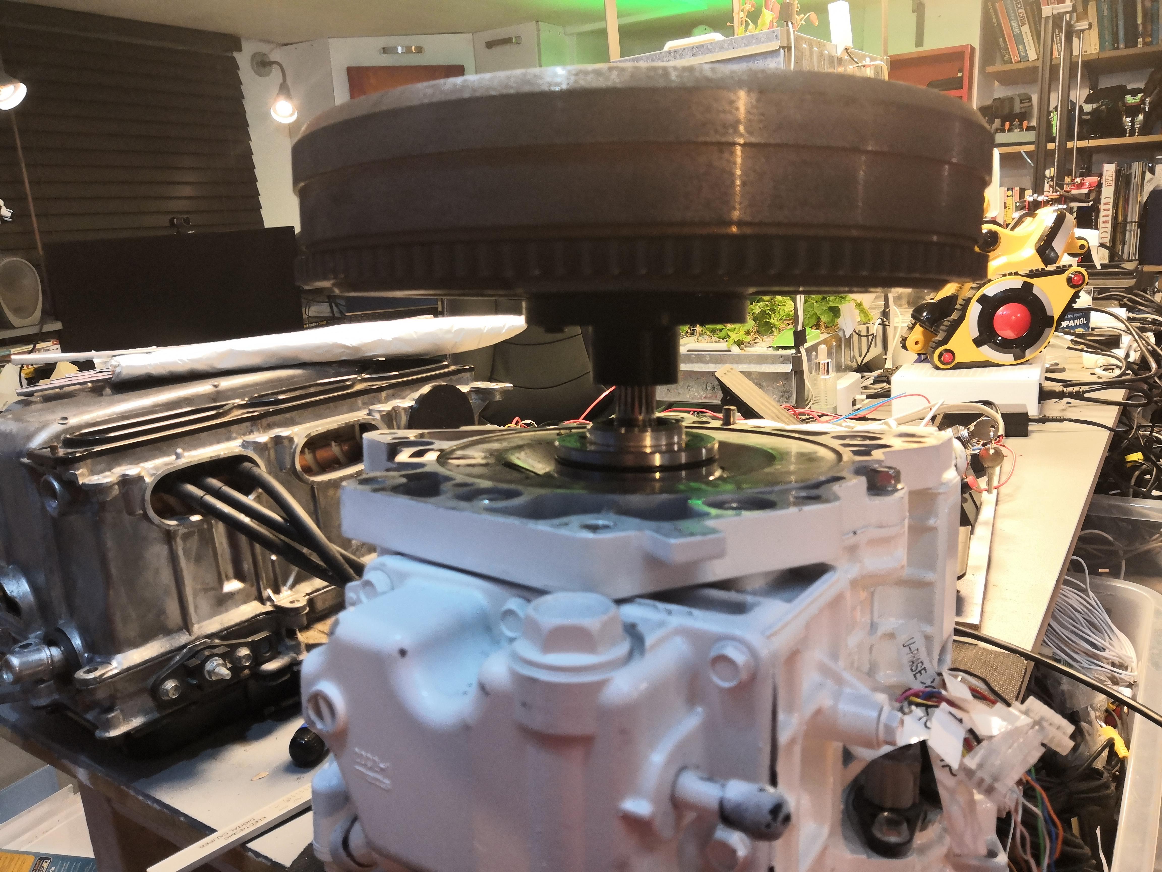

That's really useful - thank you. I'm planning to keep the 5-speed box and just bolt the motor to the front of that so plenty of gearing. Weakening shouldn't be a problem at motorway speeds in high gear with little torque needed?
This reinforces my plan: get up and running in this configuration as a learning exercise then maybe come back to the Lexus set-up down the line.

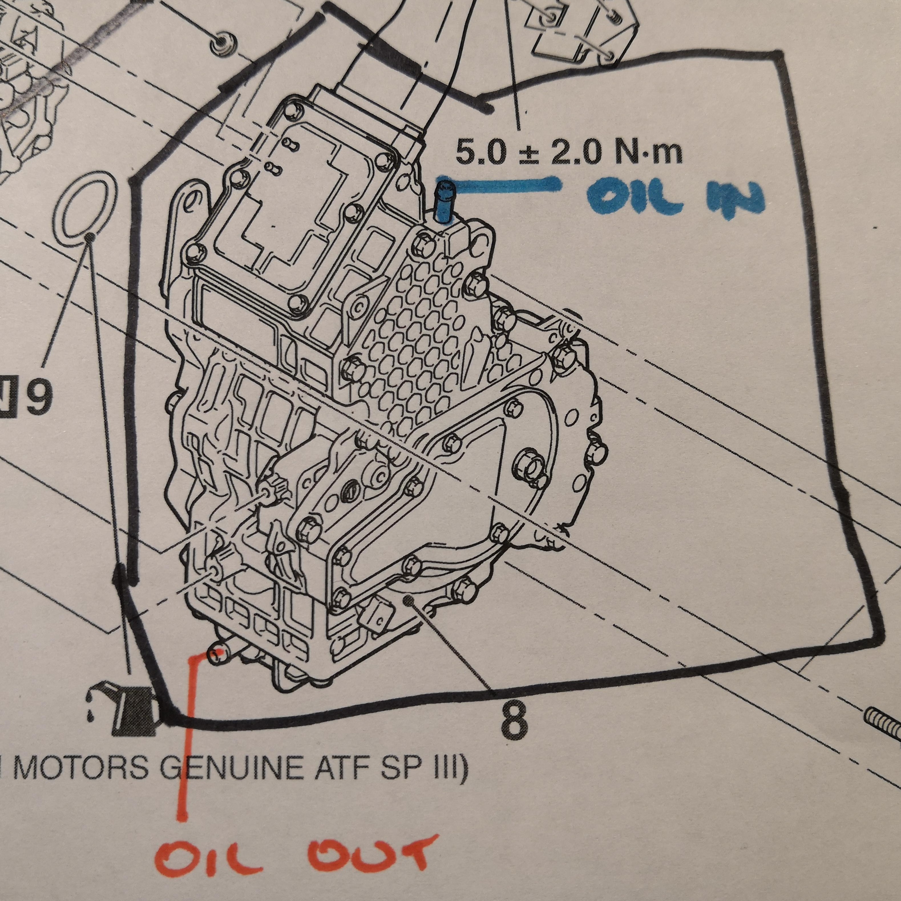

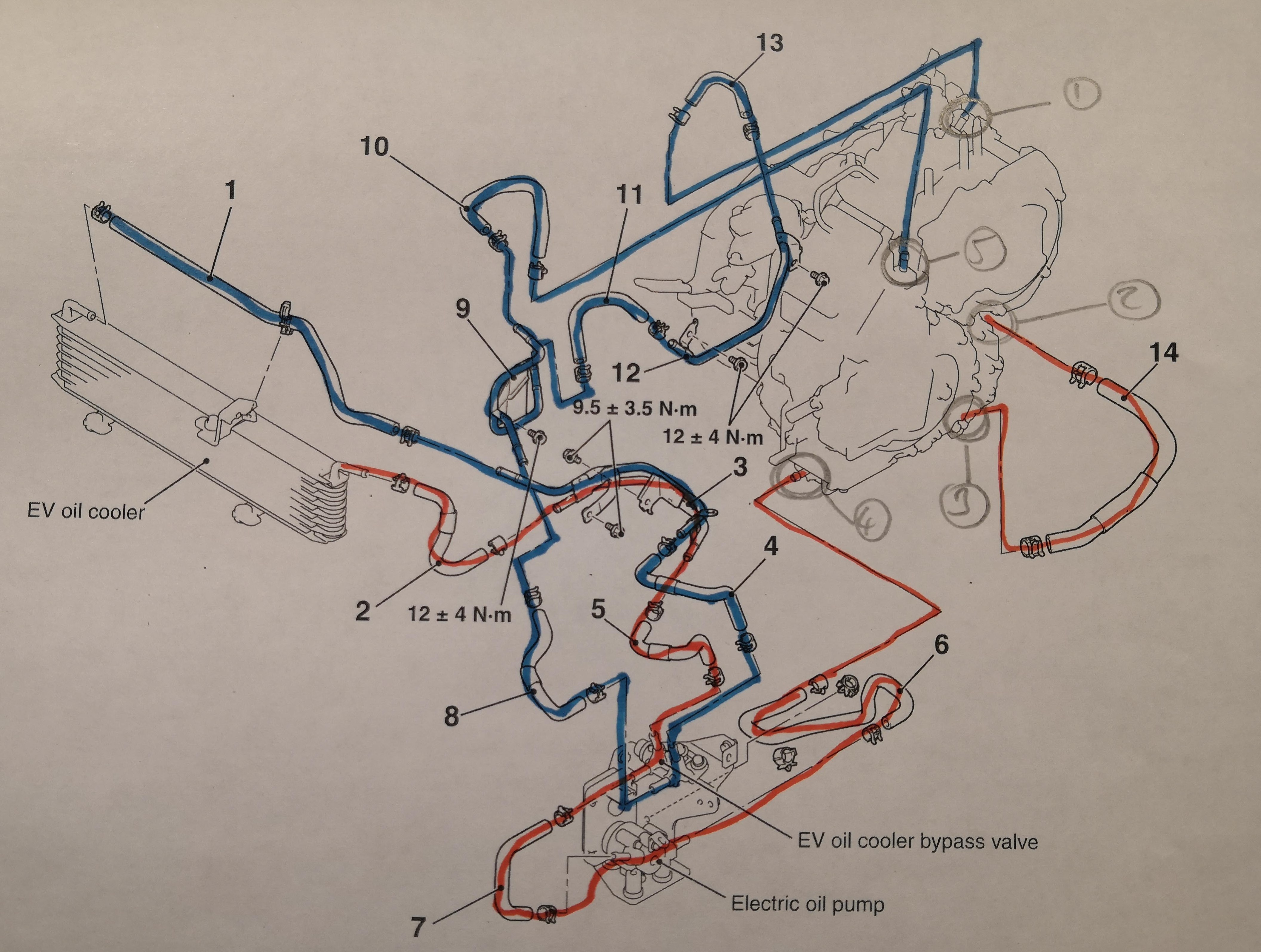

Bit more on that motor re: orientation and cooling.
It wasn't immediately obvious to me which way the motor should be oriented, so back to the service manual I went. The diagram (below) was very helpful (forgive my atrocious drawing skills over the top of it). Once you realise which way the motor goes, it becomes pretty obvious: there's a lifting eye for craning it in and out at the top, and the oil pipes are fixed at the top and bottom.
It was while looking at the cooling system diagram that I realised why I couldn't match my motor to lots of the pictures very easily. What this shows is TWO motors (or a motor and a 'generator') mounted side by side into a gearbox. Hence the split inputs into the cooling system (9) and the pipe (14) that connects the cooling output of one motor to the input in another. Most of the diagrams in the service manual show everything as part of this larger assembly.
The good news is that the oil cooler here is pretty small. I count seven rows, so a nine or ten row cooler should give plenty of headroom, even if we're working the motor hard. We will need an electric oil pump (I picked up a used MOCAL unit for £50), and some pipes to hook it all up. The outside diameter (o/d) of the barbs on the motor is 10.4mm according to my cheap calipers. I'm guessing this means 10mm internal diameter (i/d) for the pipes for a snug fit. Plus some spring or jubilee clips to keep it all tight. There's no reservoir. As the diagram shows, you just top the level up straight into the filler plug...which is on the other motor to mine. So I'll need to rig some sort of filler neck with a t-connection and a non-return valve spliced in above the entry point in the top of the motor casing. At least I have the drain plug and the fill level plug.
Fluid-wise, it looks like the specification is for CVT fluid - "MITSUBISHI MOTORS GENUINE CVTF-J4". You can find a few CVT fluids that claim to meet this spec at around £7/litre.

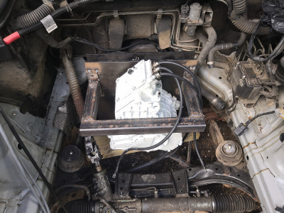

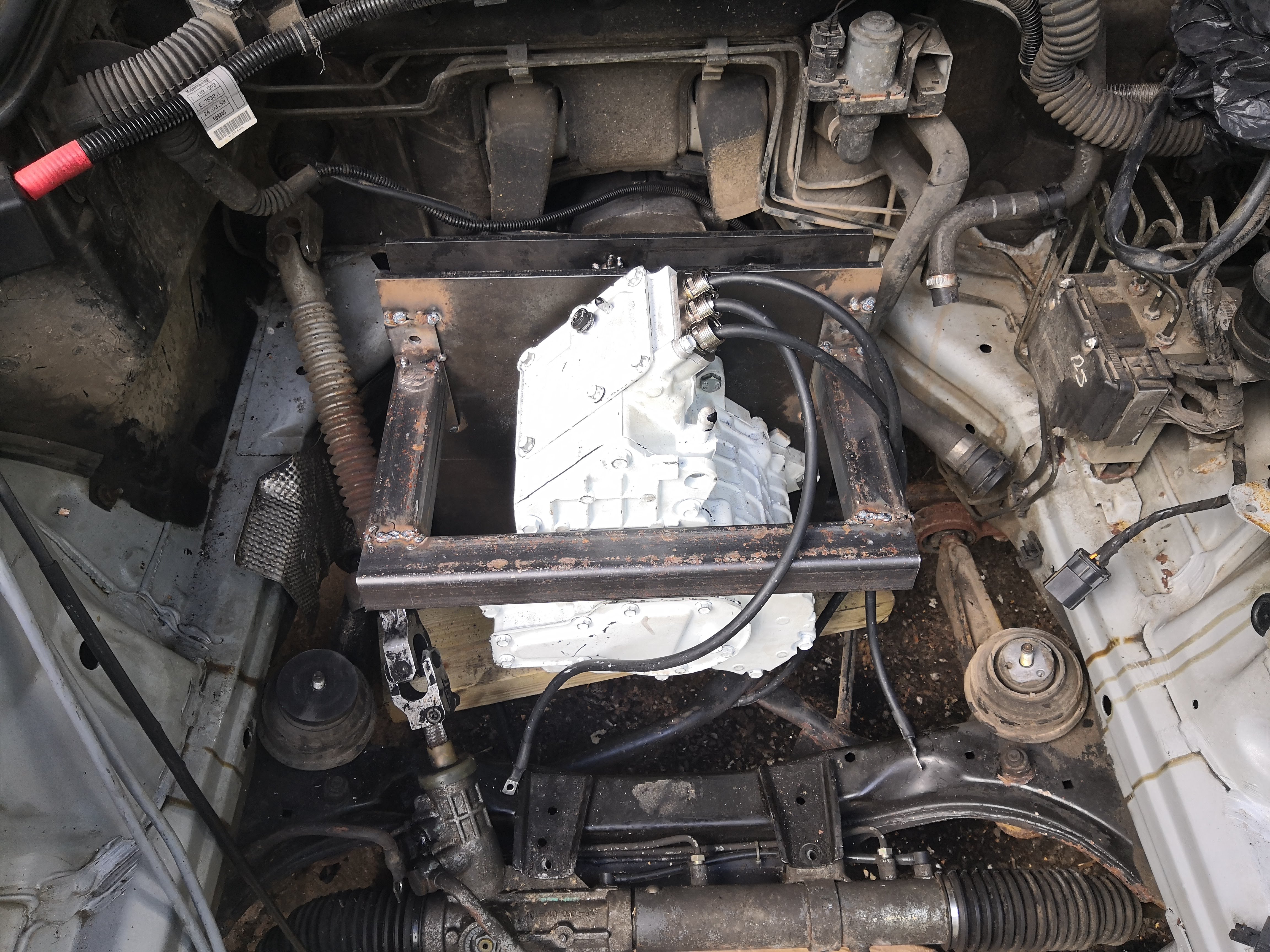

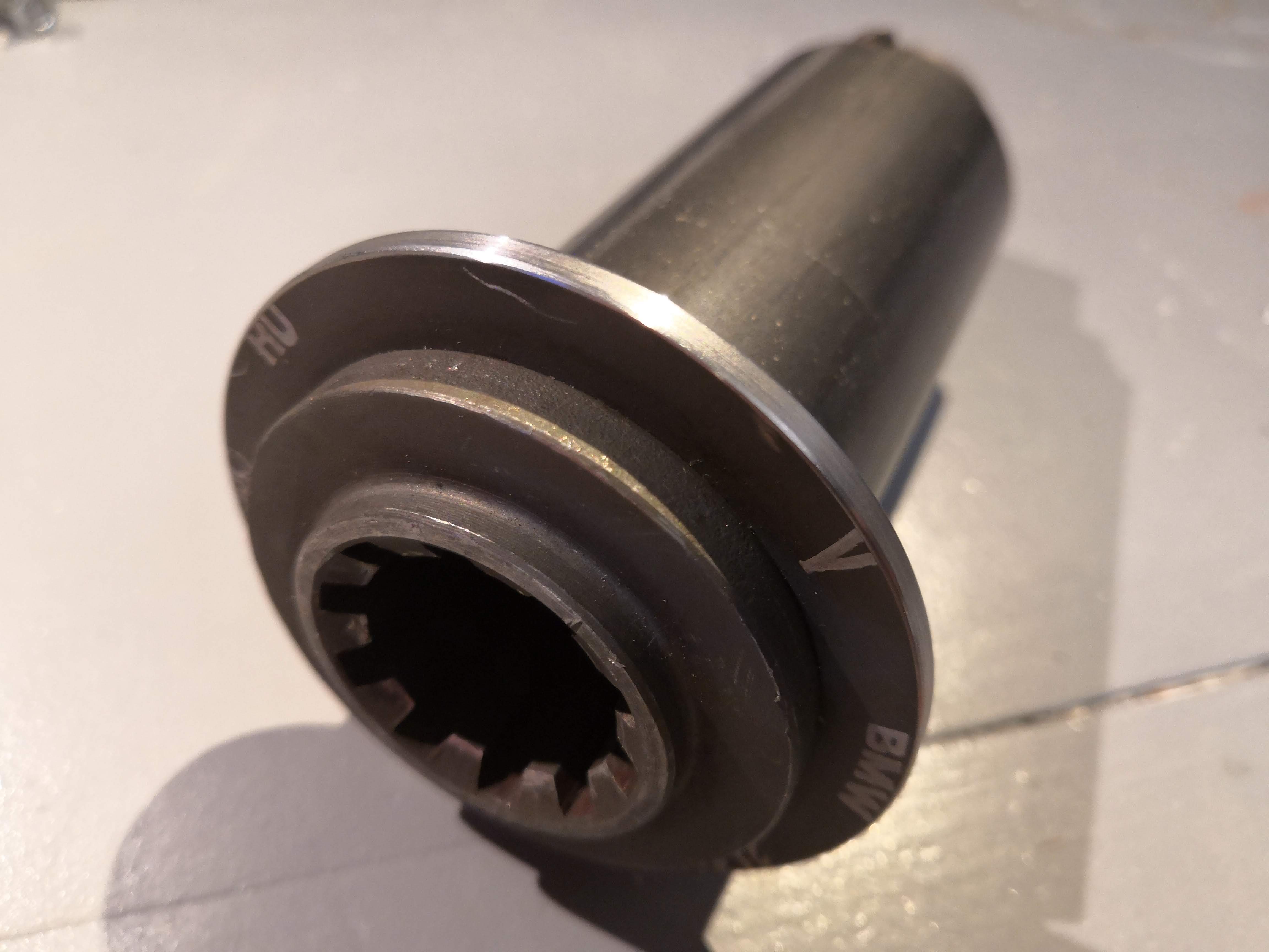

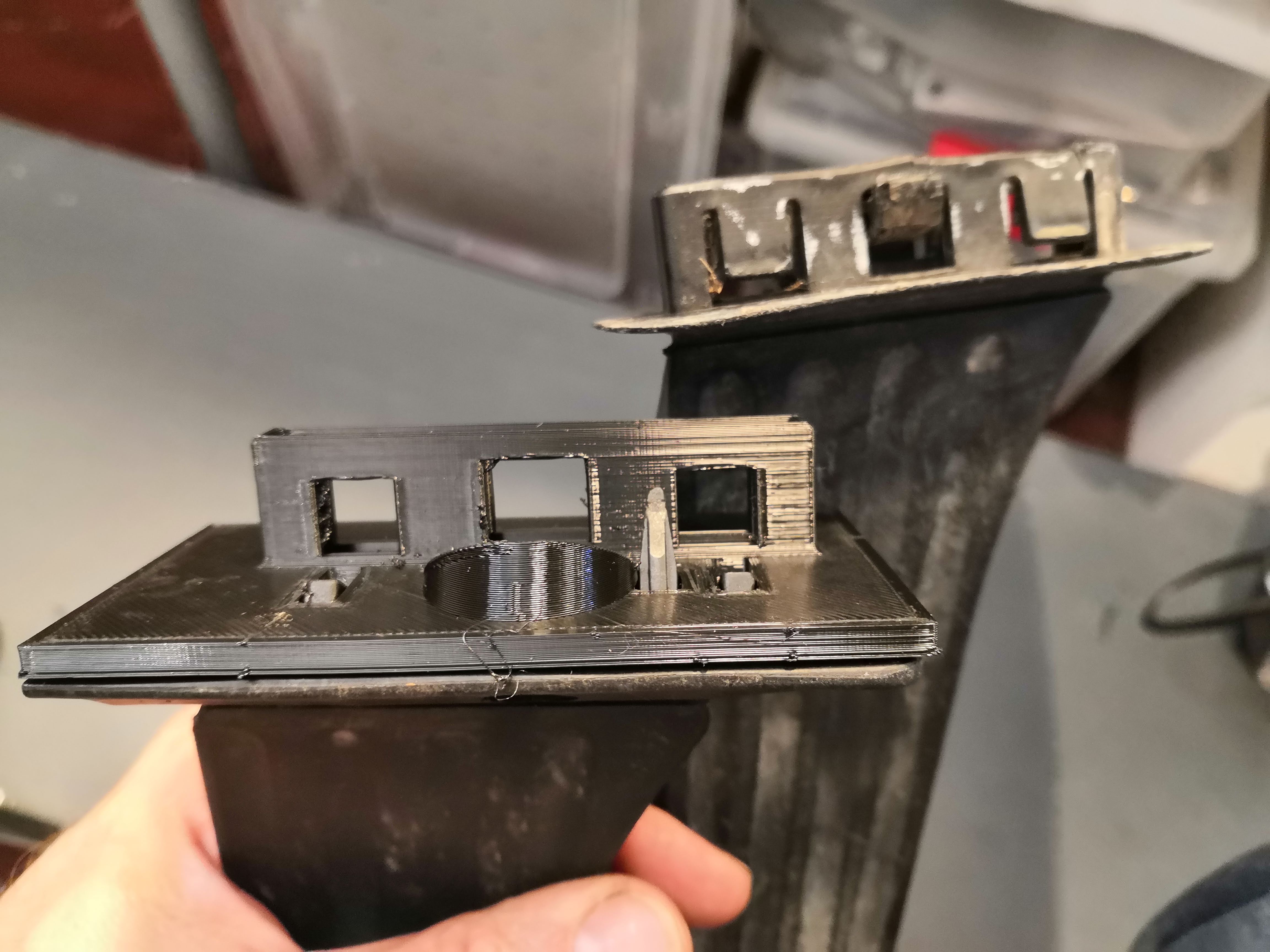

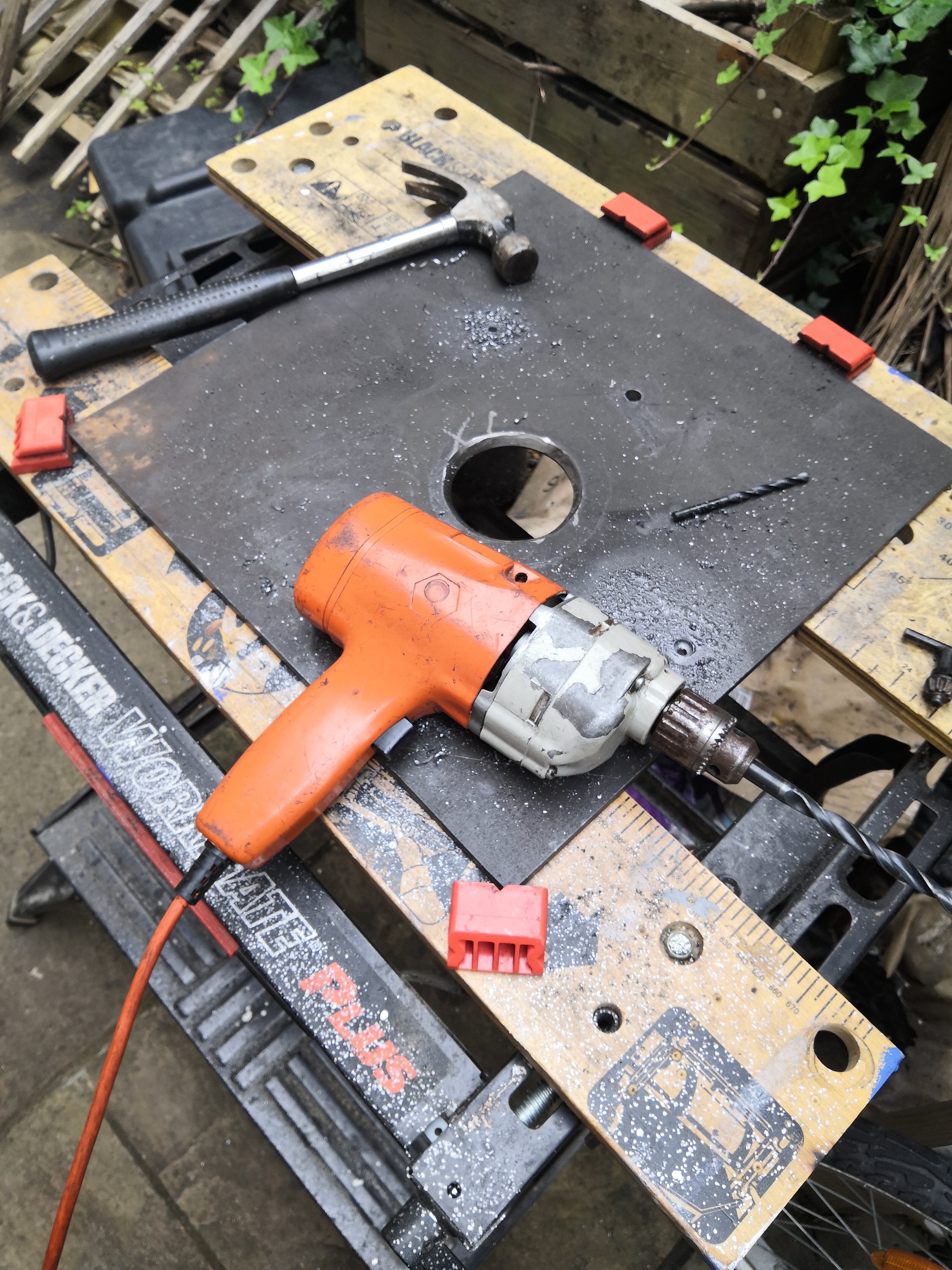

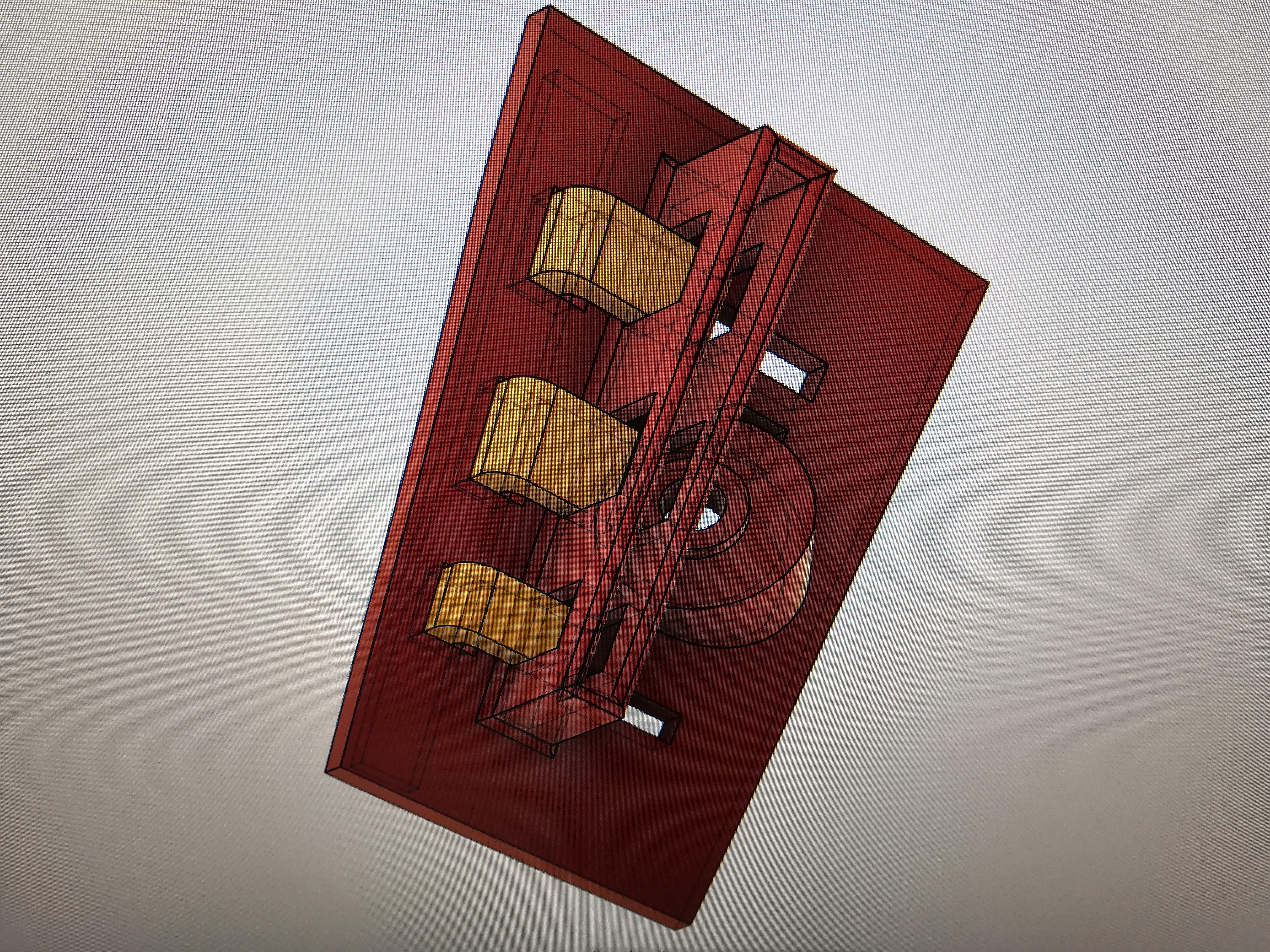

Bit of a motor update. I couldn't find any diagrams of the mounting points for the PHEV front motor. At least, not ones with measurements. So I set about making a simple CAD model of the motor face in order to map out the bolt pattern.
Without a 3D scanner (a hole in my toolkit I would very much like to fill), my best option (other than maybe a paper template) seemed to be to try to measure the rather uneven surface with calipers and a ruler and transfer those measurements into Fusion. I then 3D printed a simple template with a hole for the single dowel and plugs for the two M8 threaded holes and four 11mm holes. After about ten iterations of the 3D printed model, I finally had a model that fitted accurately - at least to within a few fractions of a millimetre (note - this is not the one in the picture below). Good enough for government work, as Mr Bauer would say.
I have a little more testing to do but then I'm happy share my template with others looking to use this motor. When the car arrives and we have removed the gearbox, I will map the motor mounting holes against the ones on the gearbox and design up a full adaptor plate. Then I can sort out the adaptor between the splined shaft and the BMW flywheel. Looking at places to get that machined at the moment.

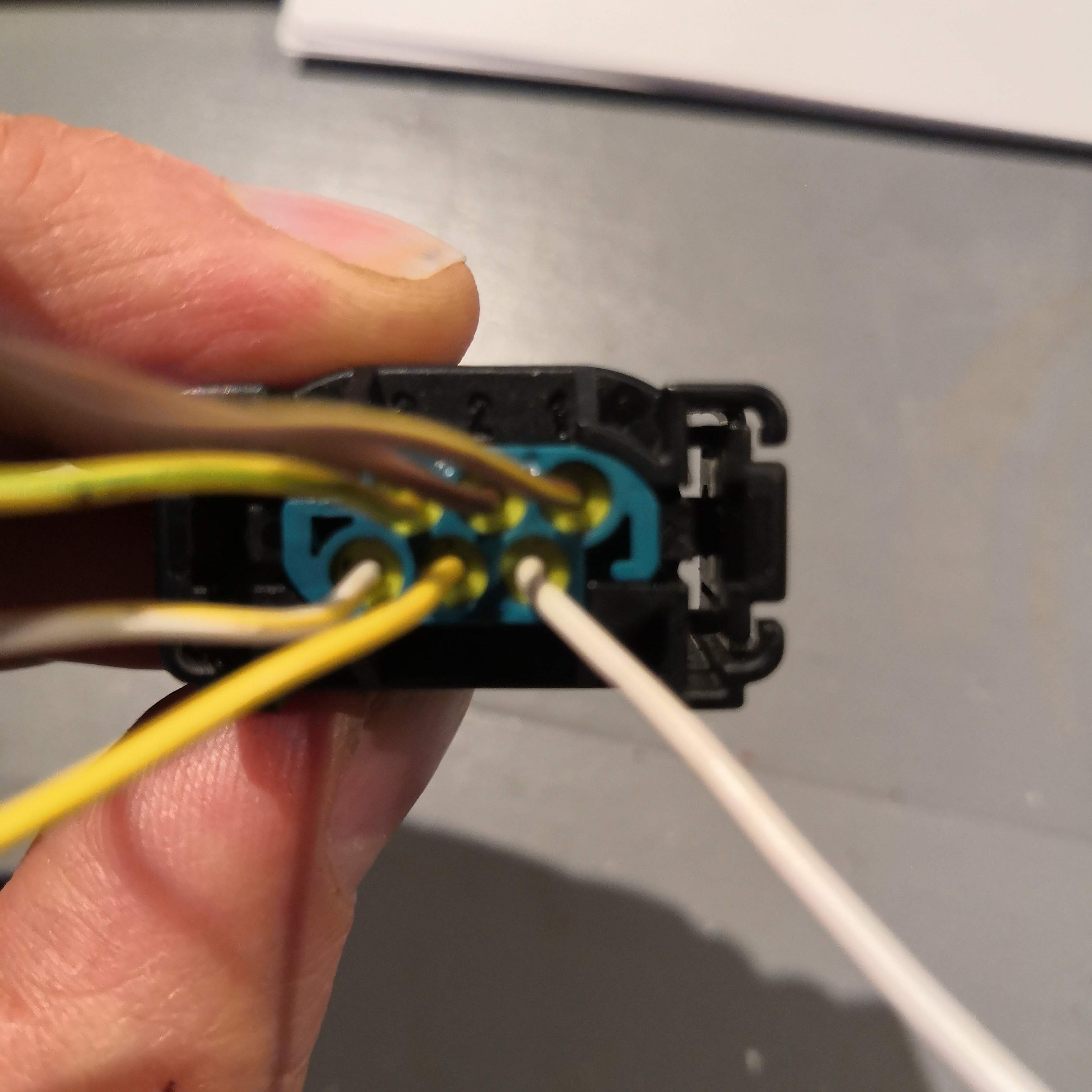

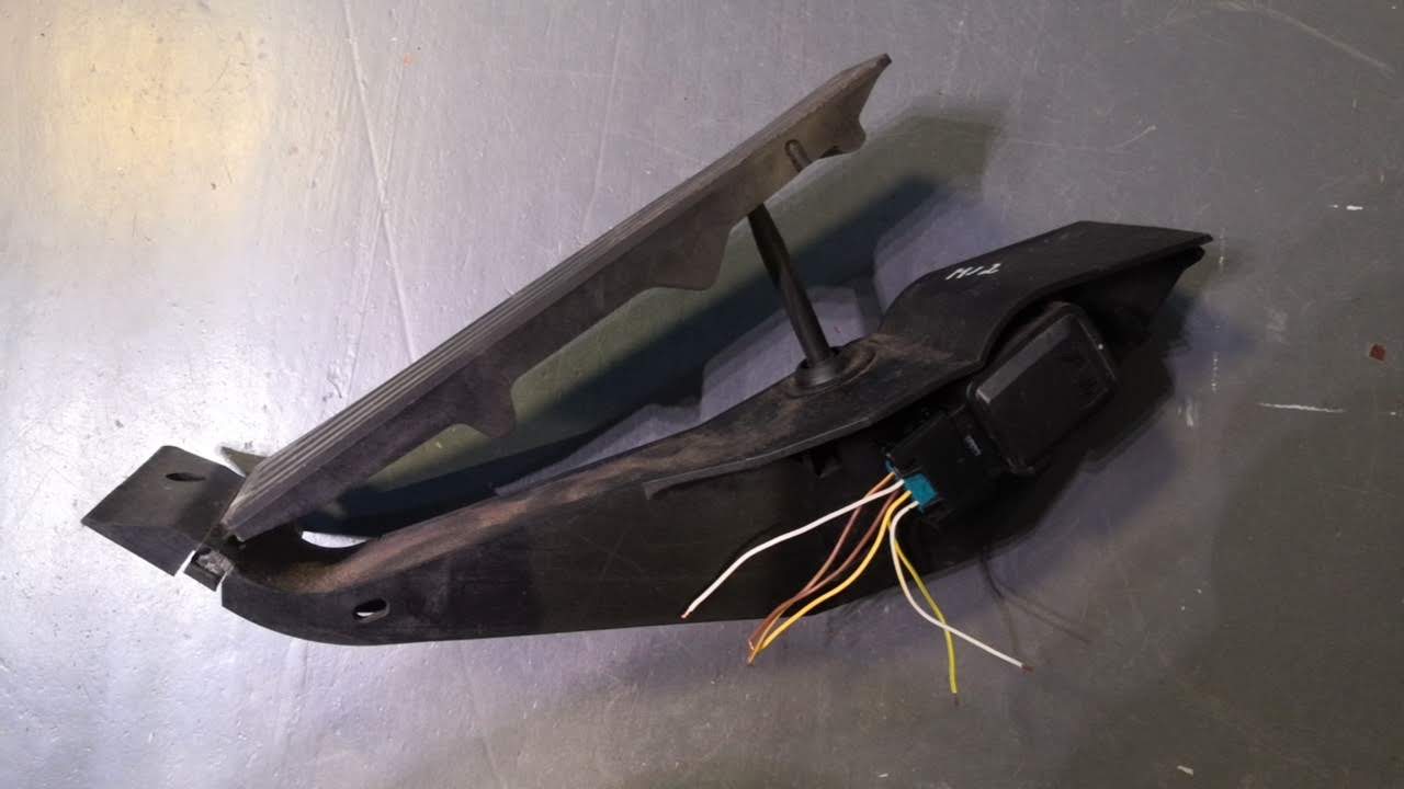

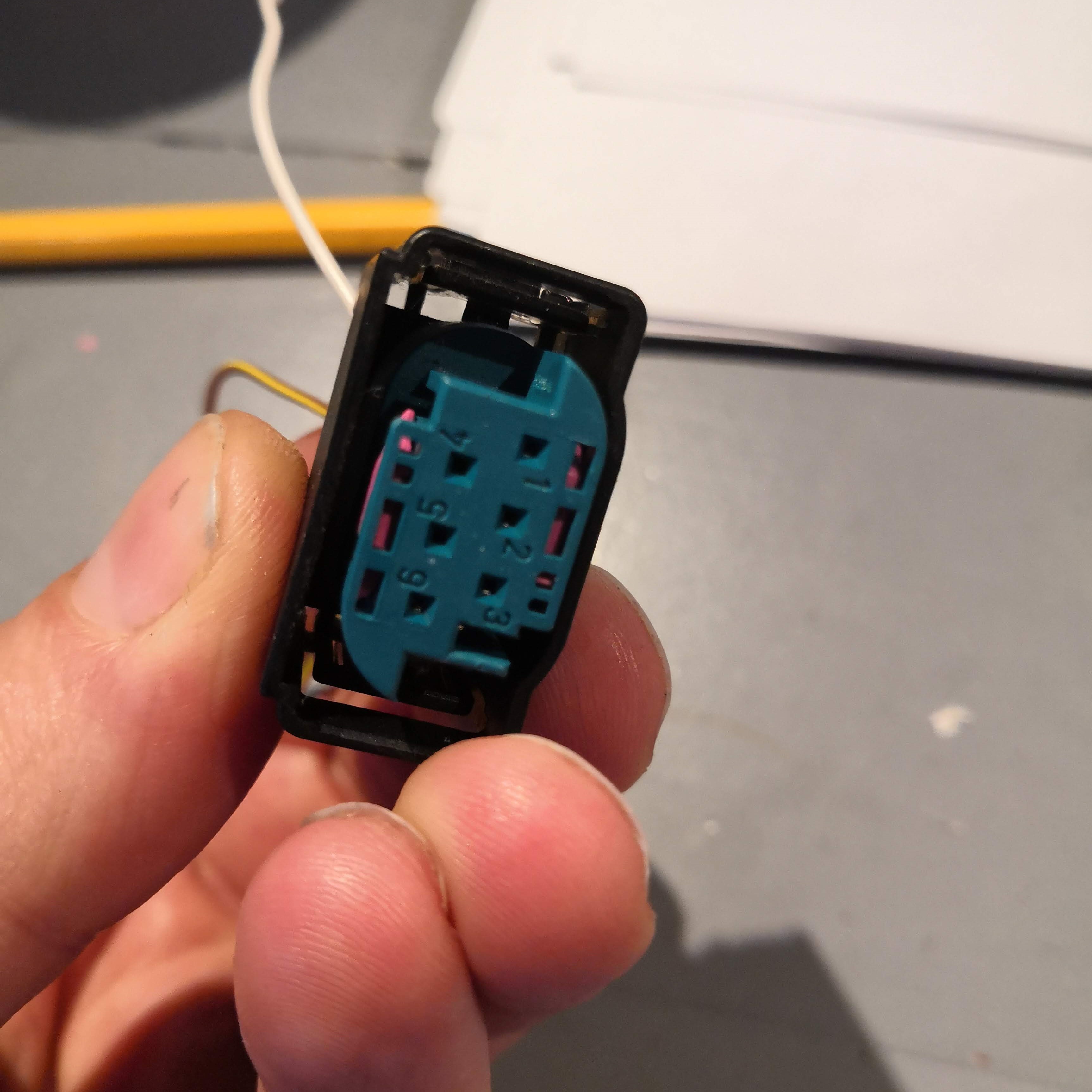

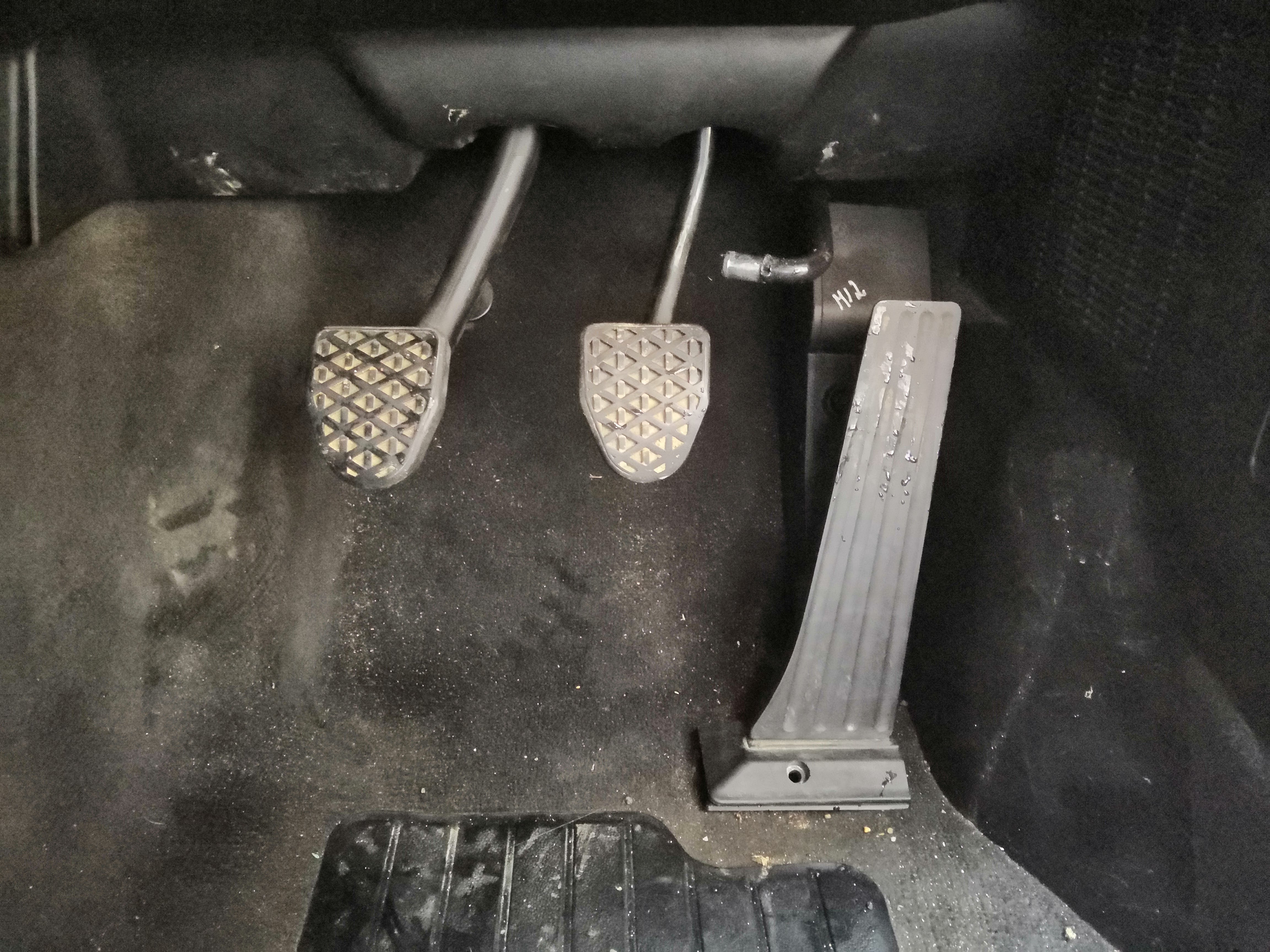

Finished soldering up test cables for the motor and throttle last night. Probably not necessary for testing, but using some of the shielded twisted pair I bought to use in the car where there will be lots of EMF noise. Replicating some of the stuff from the blog for posterity here.
I'm planning to use a BMW 1-Series Throttle Pedal, though I think they are fairly similar across a number of cars. This cost me £10.49 inc shipping from eBay, which seemed very reasonable. My unit came in good condition with the connector plug attached and some decent length tails on it.
I found the pin out information on a forum post on a racing simulator site (https://www.isrtv.com/forums/topic/2171 ... -throttle/) of all places:
Pin 1: GND 1 - Brown/Yellow (apparently brown and green on the E46 pedal)
Pin 2: GND 2 - Brown
Pin 3: VCC 2 - Yellow/Green
Pin 4: SIG 1 - White
Pin 5: VCC 1 - Yellow
Pin 6: SIG 2 - White (apparently white/green on the E46)
From this I could tell that the pedal probably has two position sensors that each take an input voltage and return a signal. But I wasn't sure if it was resistive or encoder-based at first. A bit of googling told me the electronics expect 5V on a modern BMW so I hooked the pedal up to the bench power supply and a multimeter and took some voltage readings (i.e. 5V to VCC 1, Ground and multimeter ground to GND 1, and multimeter to SIG 1, then repeat for SIG 2). My bench power supply is actually an old PC PSU (I do love to recycle) so it isn't adjustable and doesn't give me exactly 5V. Measured at 5.13V while testing.
Here are the results:
SIG 1
Throttle at rest: 0.73V
Throttle at full travel: 4.00V
SIG 2
Throttle at rest: 0.36V
Throttle at full travel: 2.02V
So, the output of SIG 1 has exactly twice the resolution of SIG 2. Guess there are two for safety reasons? [this website confirms that - https://www.picoauto.com/library/automo ... l-position]. Either way I now know how to get the output of my throttle and feed it to the inverter control board.
Note on the connector: It's a Tyco unit (expensive) but there are nice cheap clones available on AliExpress - search for 967616.

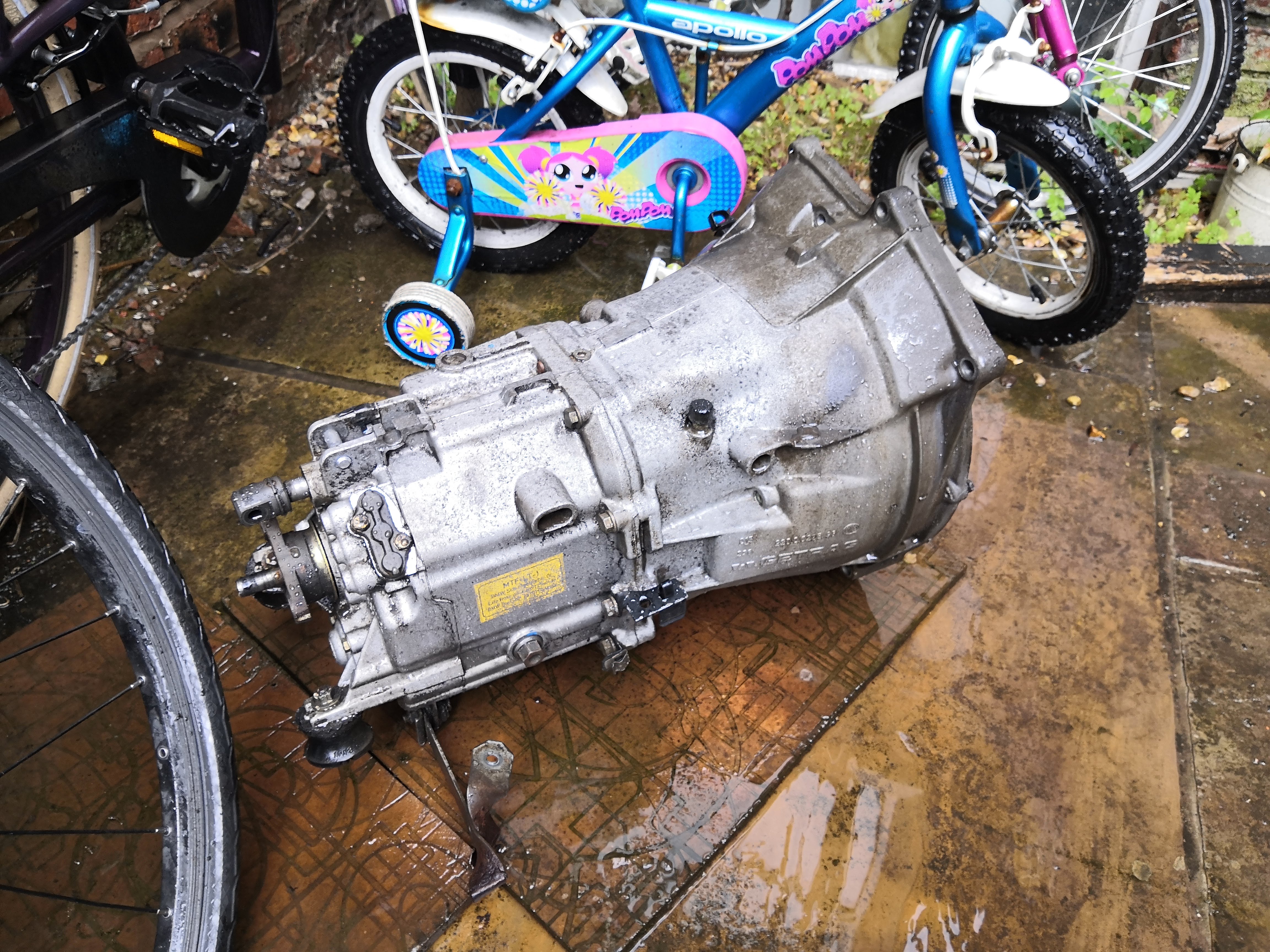

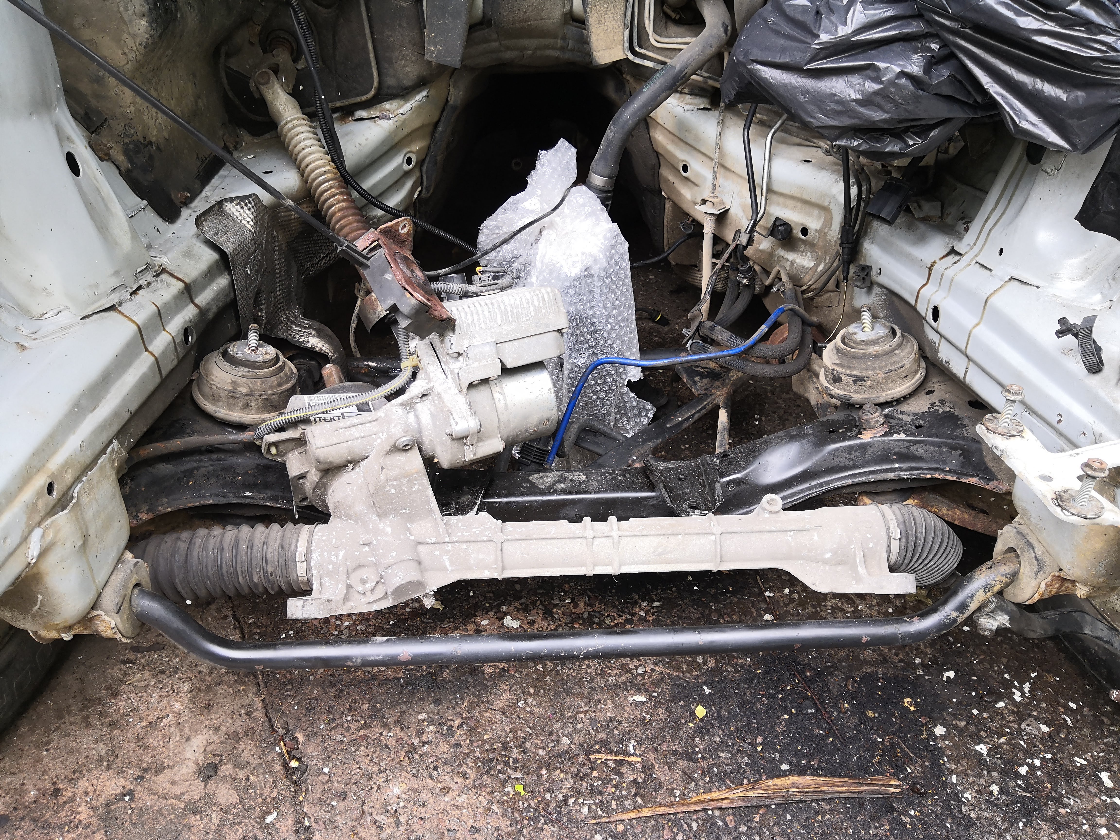

Things looked up today in any case: the project car arrived. It's pretty much what I was hoping for at £600: cosmetically crap but that doesn't matter as planning to replace most of the body panels. Doors only need a skim of filler before they are repainted. New sills are only £30 a side.
Mechanically and structurally seems - at least on first inspection - to be really sound. Not got under it yet due to pressures of work, but planning to take some time off after next week to really get into it.
Only EV snag I may have hit is how high the bellhousing comes into the engine bay. Was hoping it would sit a little lower so there would be room for the 330e battery pack to sit over the top of the motor. It will fit length and width-wise, just might be too tight in depth. May be able to fit it underneath (which would sit the weight lower - all good) and may be able to re-orient the motor. Lots of investigating to do. But was hoping to be able to avoid having to build a new battery box to save time and money.
Anyway, if anyone wants a BMW fourpot with 'only' 174,000 miles on it, let me know!

Talking of 3D printing, I've designed up a new two-part plate to hold Damien's AMPSEAL connector daughterboard onto the Prius Gen3 inverter (attached). This clamps the board and seals against the white silicone on the plug. It draws on Konstantin's initial design but I had to choose between making the plate much thicker or ditching the red sealing ring from the original plug. I went for the latter and will probably put a skim of silicone on when it is fitted finally. There's enough slack in my IDC cable to allow the top of the inverter to be removed with the plate in place. Maybe need a separate thread for 3D printed parts for this inverter?
Few more blanking plates to design and print, including something to seal around the battery connections. I have a pair of Damien's brass standoffs for the battery connections and hoping I can make something to go around those. Resistance of PETG seems to be higher than my multimeter can measure so only issue I can see would be is moisture was trapped around the connectors. Again, if anyone knows different I'd love to hear.

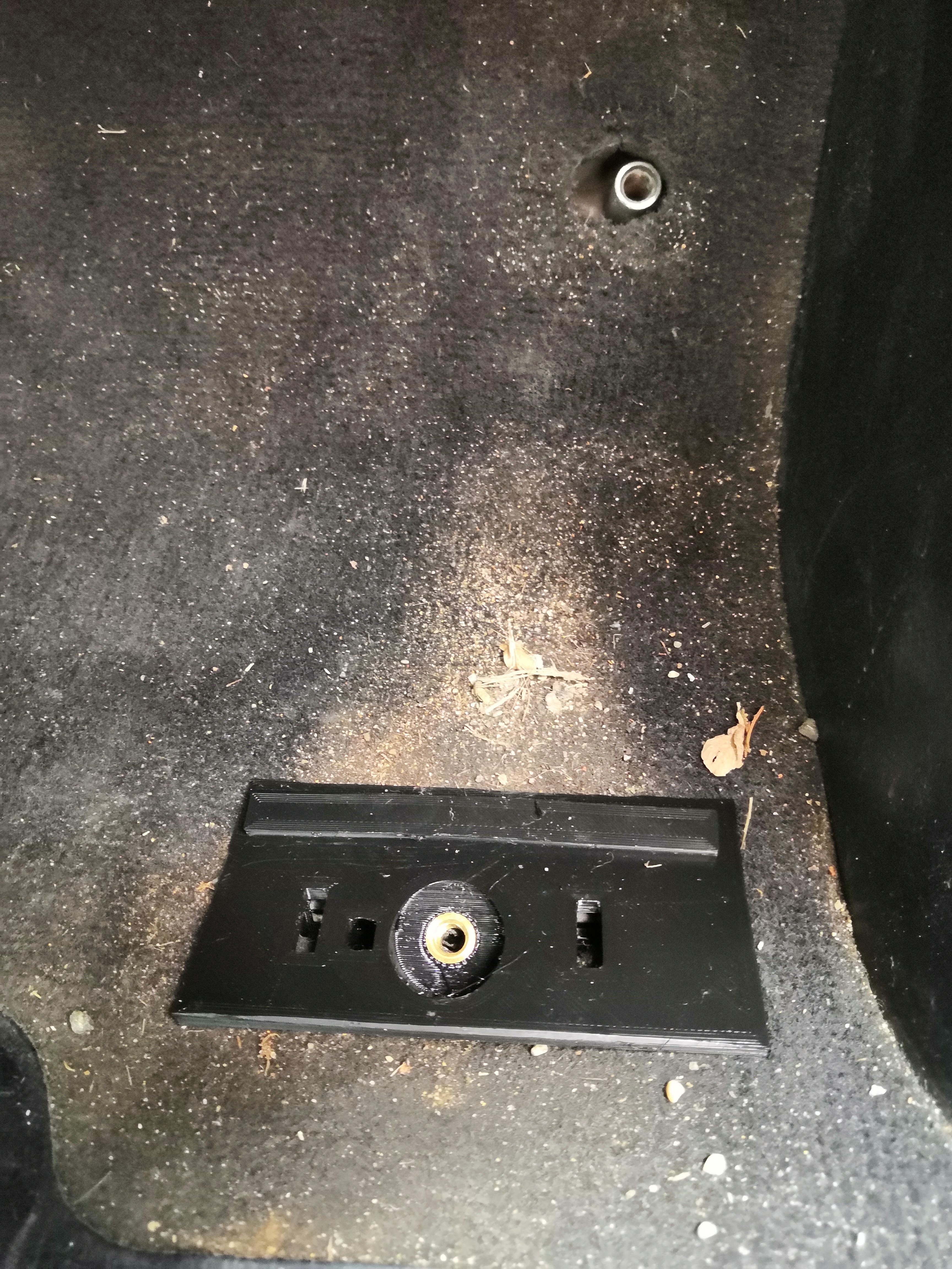

Pedal fitting is pretty much finished. Designed and 3D printed an adaptor to allow me to mount the 1-Series electronic pedal to the old Z3 mounting bracket and really pleased with how that has turned out.

Engine Removal
With only one minor mistake (I missed a pin on the gearbox so ripped the shifter out with the transmission - fortunately nothing damaged) and two minor breakages (the plastic heater pipes both got cracked), the engine and transmission came out. Was a fantastic day working with my daughter on everything, who proved she has excellent instincts for all things mechanical. Over the next few days we stripped out the remaining parts like the steering rack (more below) and gave the whole engine bay a really good clean. This uncovered a few spots of rust but nothing serious. Though the X-frame under the engine is not in good shape. Suspect I will have some welding to do there.
Plan is to give it another clean and a coat of paint before reassembling everything. Not original colour and not expecting a perfect finish. Just something to protect it and keep it looking fairly clean.

Steering Rack
The idea of putting a hydraulic steering rack in an electric car, when there are electric steering racks, just seems odd to me. But it may be what I end up doing. I tried a 1-series steering rack first but it was just too big in every dimension. So I thought I'd try a Mini steering rack, which looked a lot closer to what I needed. This will actually fit really nicely and I'm holding on to this option. But, the motor did protrude up into the middle of the engine bay where I will want to be putting batteries. Plus, the fewer parts I change the easier it is going to be to get this car through an MOT.
So I went back to the drawing board, or rather eBay, and bought an electric power steering pump from a Vauxhall Zafira. This seems to be the one everyone in the DIY EV community uses. We'll clean up the old rack and cooling loop and see if we can get it all hooked up.
Anyone want a 1-series steering rack?
Coupler
I'm at the stage of needing to connect my electric motor to my gearbox. I have had a plan for this from the start: design something in 3D, send it off to a company called Protolabs, and with their incredible CNC machinery they'll just knock it up for about £300 (based on a rough quote I got in the early days of the project). So, once I had the engine and gearbox out, and had separated the two, and extracted the flywheel, I finished up the design I had started around the motor splines. One thing gave me cause for concern though: the weight of that dual mass flywheel. That was going to put a lot of load on the motor bearings. Hmmm.
I cracked on and 3D printed a couple of test versions of my coupler before sending it off to Protolabs for a quote. They came back the next day with a quote of £350. I could live with that. Until I examined the quote more carefully and realised that it showed me their machines couldn't cut the splines for my motor more than about ten millimetres into the shaft. OK, so maybe it just needs manufacturing a different way. They did tell me they could 3D print metal. Sure enough, they could. For £1400.

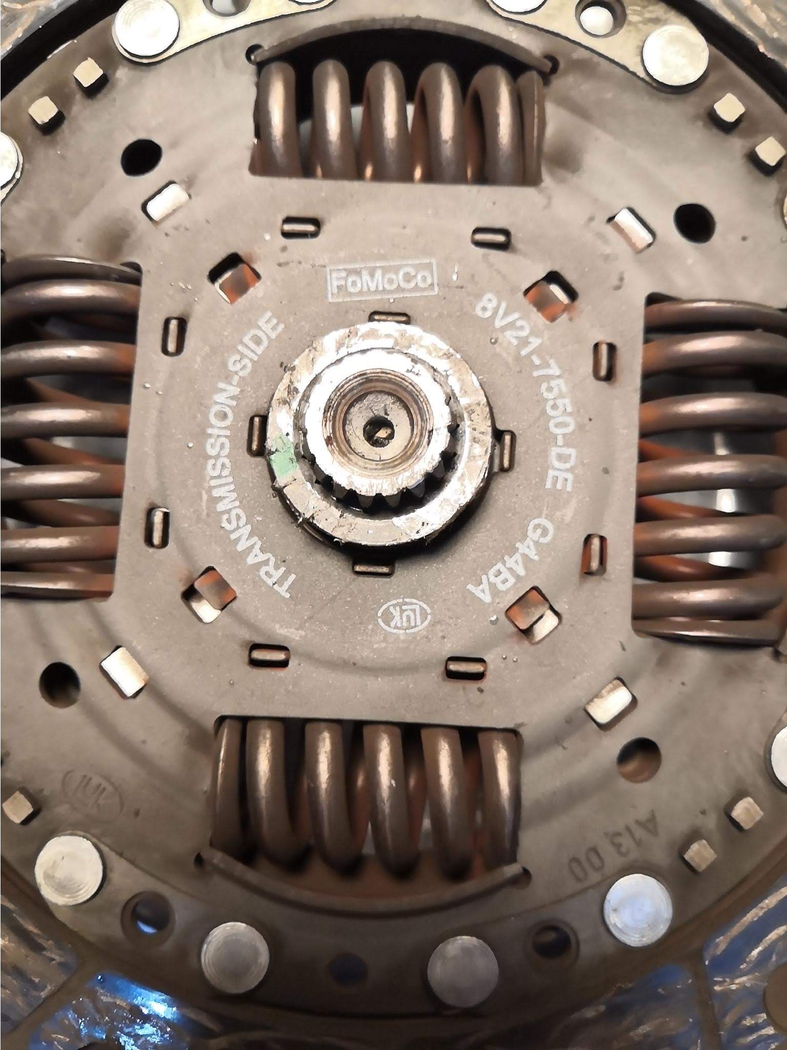

Back to the drawing board again. While I was pondering, a chat with a fellow DIY EVer got me thinking about the quick and dirty option: find something that has the same spline pattern and weld that to one end of a tube, and the clutch centre to another. This would a) be very cheap and b) weigh a lot less, albeit with the loss of a clutch. But I won't be changing gear very often anyway...
Question was, what has the same spline pattern as a Mitsubishi Outlander electric motor. I stuck "19mm 17 spline" into Google and what comes up? A Fiesta clutch. Driving past my local garage a couple of days later (the one that has agreed to MOT my EV), I asked if I could have a dig around in their recycling bin for old clutches. Top of the pile was one marked 'FoMoCo' and sure enough, it had a 19mm bore and 17 splines. I got home and dropped it on the motor: perfect fit.
So, amongst the steel I have ordered (below) is a couple of pieces of thick walled tube. I've got a plan for how I might be able to do this at home. Obviously the ideal would be to get someone to make it up and balance it. But I have a few ideas. We shall see...

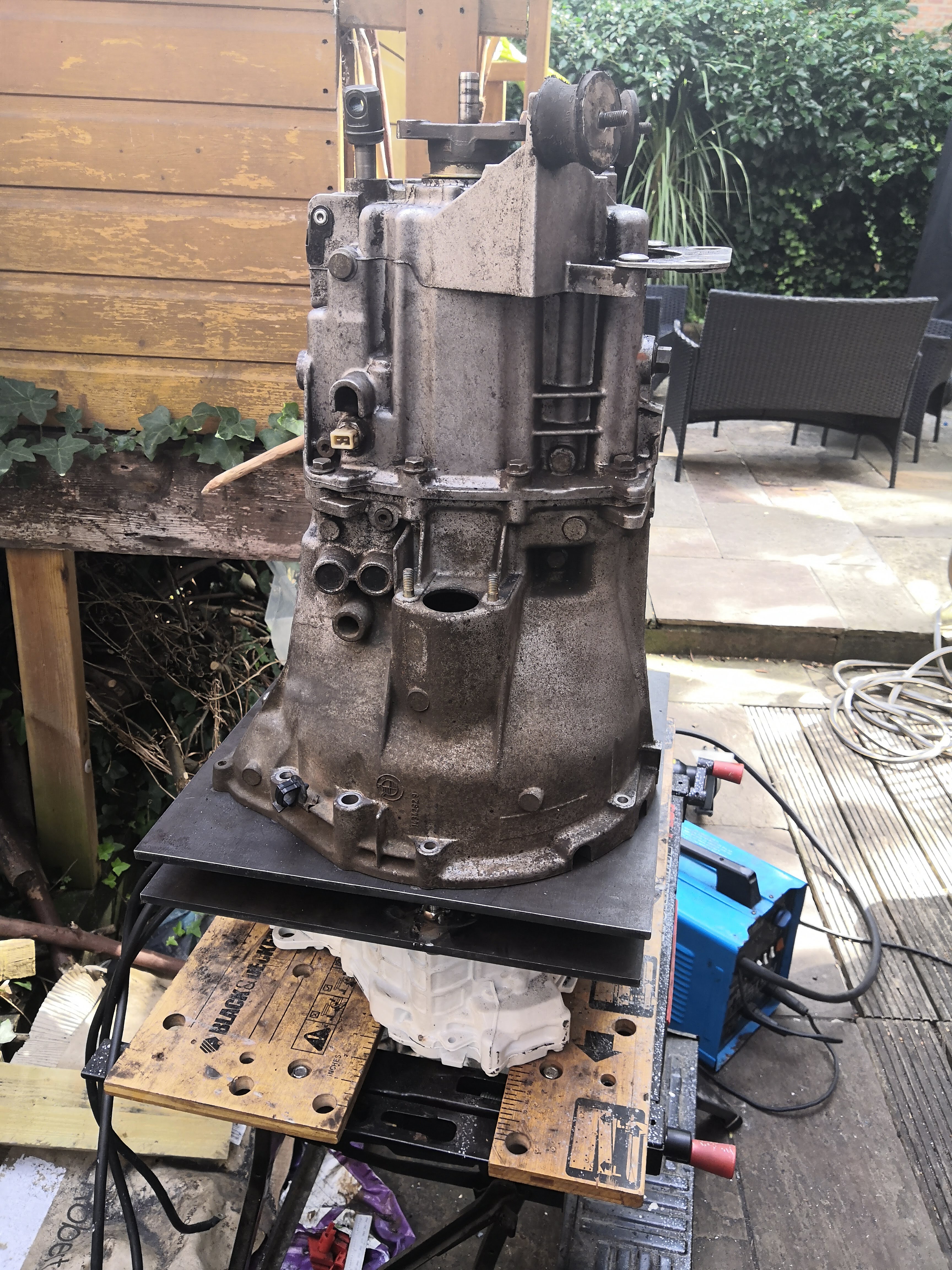

The steel stockholders were great. They provided two 8mm thick steel plates, cut to size (400mm sq), 2m of 40mm box section, 2m of 20mm box section, a metre of 37mm i/d thick walled tube and a metre of 28mm i/d tube. Amazingly, I managed to squeeze all this into my Alfa GTV!
The plates are thicker than I was intending - it was a case of what they had. And I've had to crank my welder to the max to get a decent joint. But actually the measurements with the two plates and the box section in between turned out to be absolutely perfect to give the space I needed for the motor spindle.
Over the last week my daughter and I have measured and drilled the holes in each plate (marking them out with a transfer punch), bolted them up to the motor and gearbox respectively, welded on some captive nuts, then welded the two plates together with a square made from the box section in the middle. It took two hole saws and a lot of sharpening of bits but we got there in the end. As of today the whole assembly can be bolted together and it is ready to go into the car for test fitting.
There's still lots of work to do on the adaptor plate. It will need cutting down to save a bit of weight. Some of the holes need adjusting. A few more welds wouldn't go amiss. And then it needs painting. But first we need to make sure it all fits, and work out how the engine mounts will bolt up. Plan is to use some of the 40mm box cantilevered off the motor plate to bolt up to the existing engine mounts. The two circles of steel cut out from the centre of the plates are actually a perfect fit for the mounts. So those will be welded on underneath. It will all make sense when you see it.

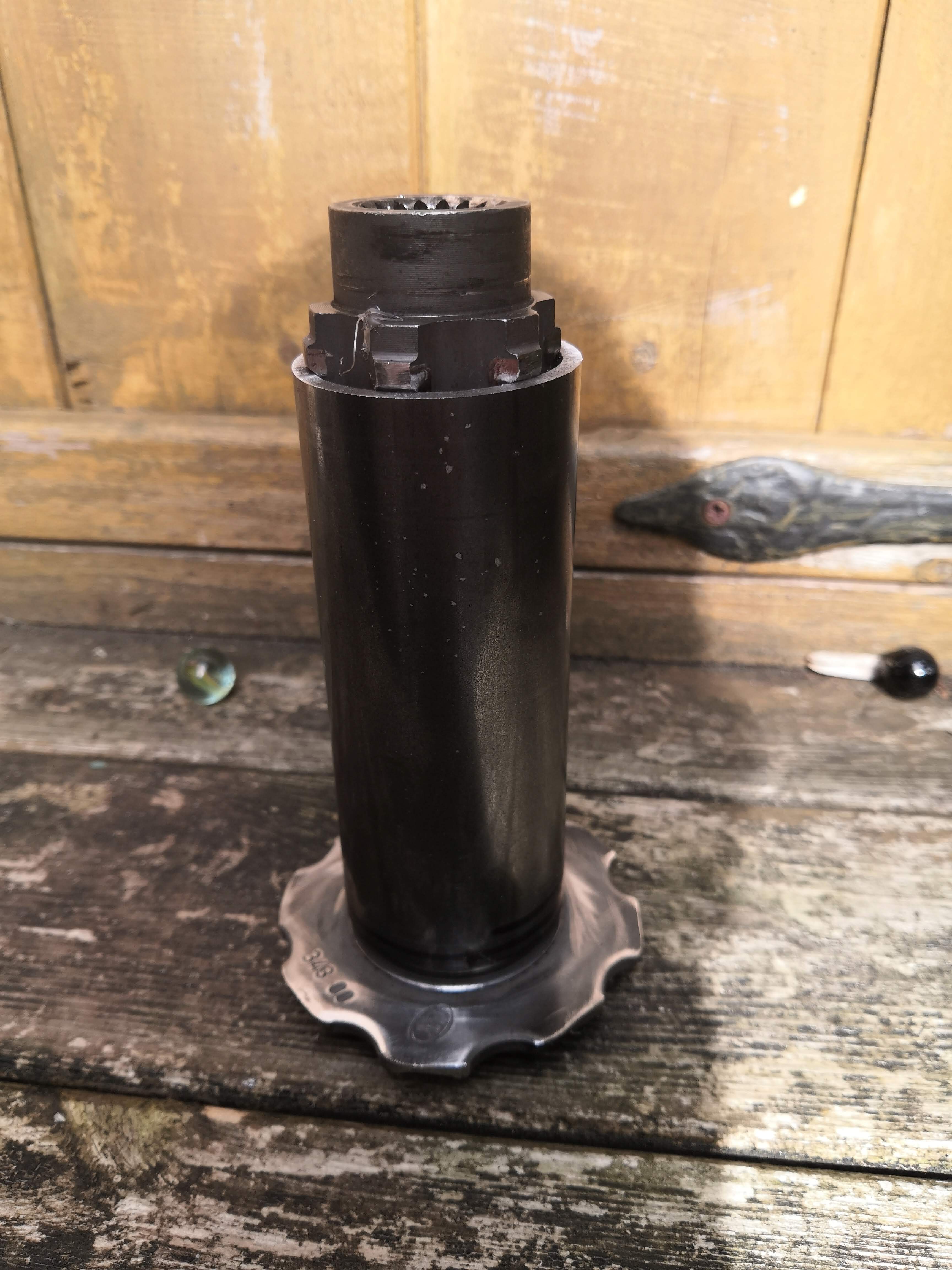

Coupler
The steel tube was for the coupler to link the gearbox and the motor. Turns out I only needed the 37mm as both clutch centres will sit inside it if turned the right way around. The BMW clutch is a really nice tight fit so getting that square was fairly easy. The Fiesta clutch less so. It has funny little stepped splines that take a little balancing to get them square. And when I say 'balancing', I mean welding it, spinning it, cutting one of the welds off, hitting it with a big hammer, welding it again, until it looked pretty straight.
This just left me with the outside of the clutch centre to sort out. There's a few rough bits from where I cut it out with the angle grinder. I'd been looking for a local company to turn it down in a lathe. But then I got chatting to my neighbour from three doors down and it turns out he has three lathes in his basement workshop! It's with him now.
Before I dropped it round to him, we used it to make sure everything aligned properly before putting in the final welds on the adaptor plate. Sticking the box into gear I could rotate the prop end and watch the motor turn through the hole left by the clutch cylinder. Despite the rough way in which the coupler was put together it all seems to spin pretty smoothly. Hoorah.

Test-fit
After the last update I did indeed get the motor and gearbox into the car where they remain now. It wasn't as hard as I expected and it all slotted in beautifully as you can see from the pics below. A bit of 2x4 was used to level it up over the x-frame, ready for engine mounts to tack it in place.
This obviously isn't the final fitting. Some holes need opening up to fit larger bolts, the welds need reinforcing (I may need a different welder - mine struggled with the 8mm steel), and it all needs trimming and painting. But this is good enough for us to begin the big game of Tetris that comes next: fitting all the components into the engine bay and making up brackets to hold them.

Engine mounts

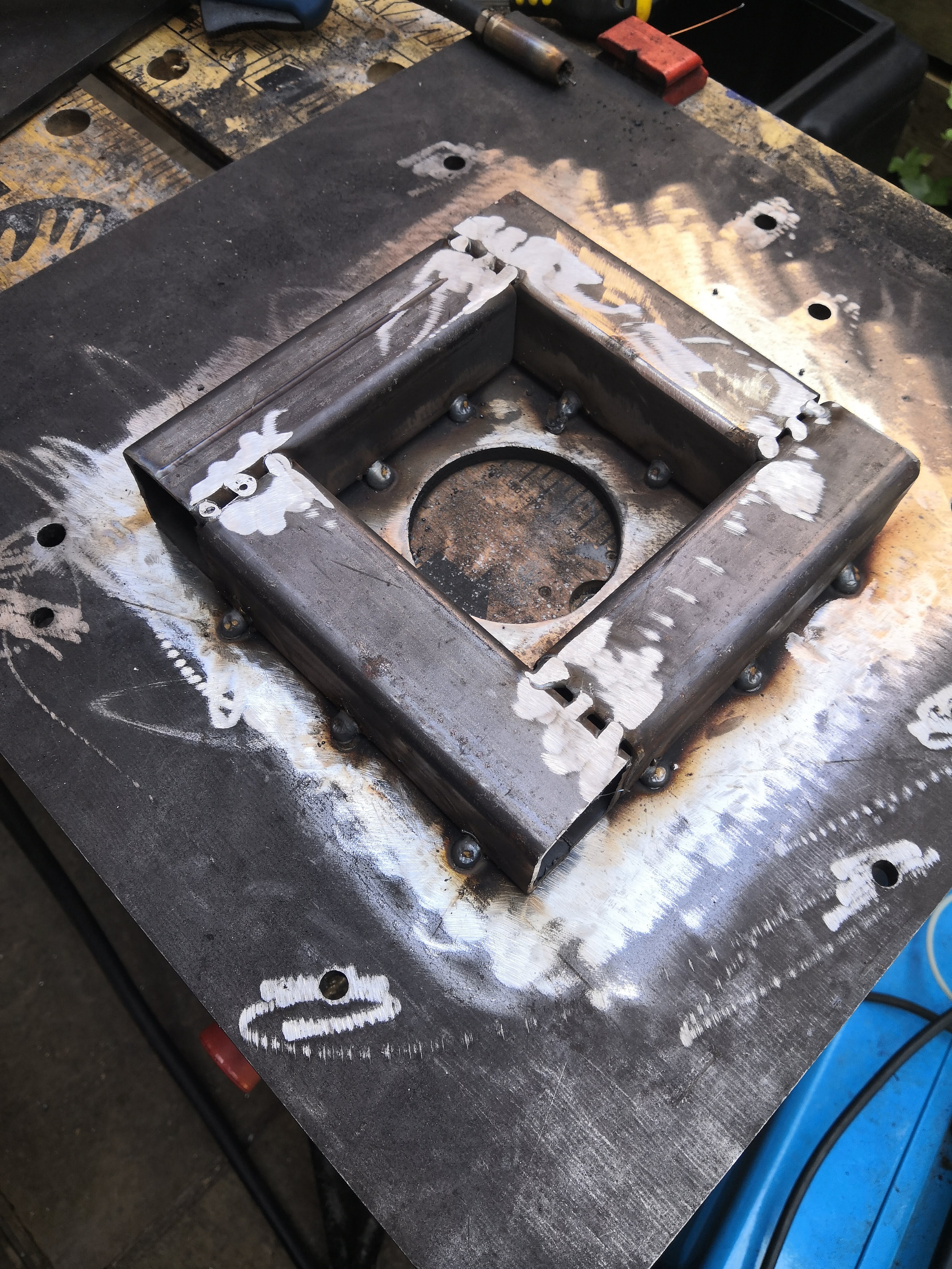

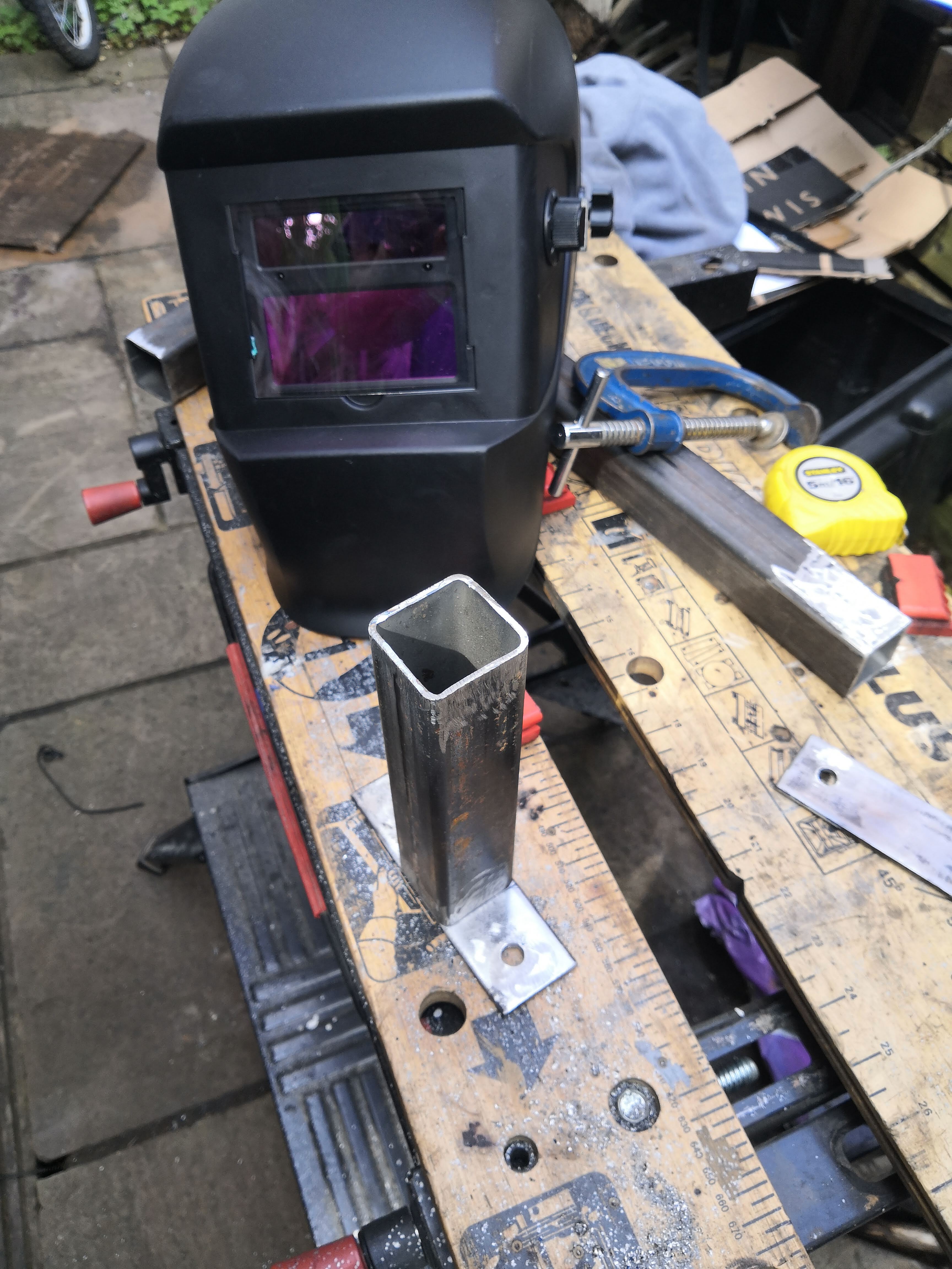

We need to finish the mounting of the motor with a couple of struts to tie in to the old mounts on the cross member. Originally, I had planned to just do single struts at a diagonal from the front of the adaptor plate. But once the motor was in it became clear these might be quite awkward and uneven. Instead, having test fitted the inverter my daughter and I settled on a U-shaped bracket coming around the engine from the front plate that would allow us to do a couple of simple struts down to the engine mounts from its corners. Picture might make more sense.
This has the advantage of forming the base for the mounting brackets for the inverter and the high voltage junction box and maybe some of the cooling pumps. We set the height of the U to be right for the base of the inverter, allowing relatively easy access to the various connections - 35-way connector for i/o, AC input for charging, AC output for the motor, and DC input from the batteries, plus cooling in and out.

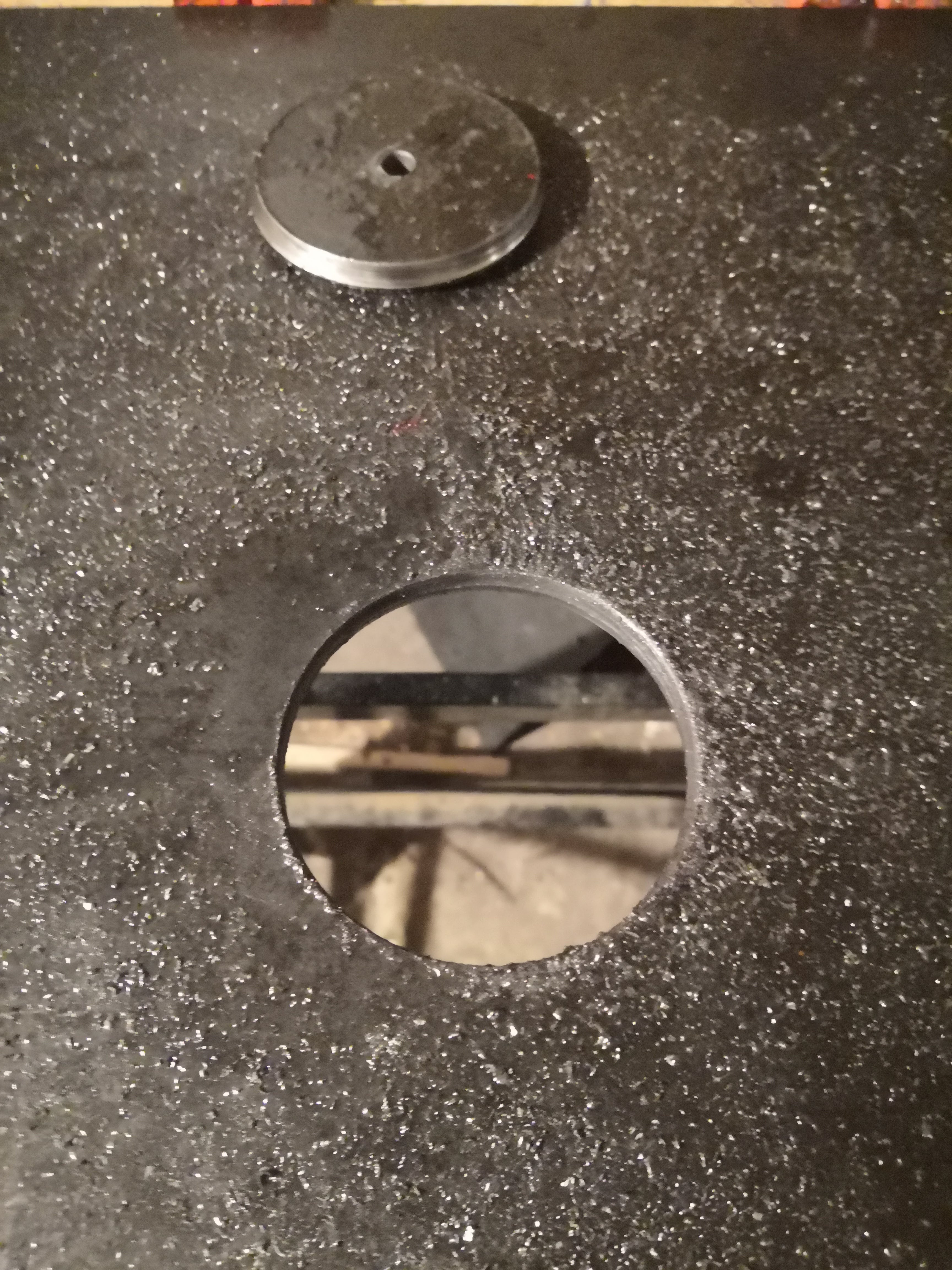

My daughter measured up and we cut three lengths out of 40mm box, as well as two plates from a length of 3mm strip that may once have been the mounting bracket for an IKEA float shelf. I don't have a metal blade for my mitre saw yet so this was done slightly unevenly with the angle grinder. I think that might be a smart purchase. We tacked this all together but putting it up against the adaptor plate realised it was all a bit skewed. So instead we tacked the sides of the U to the adaptor plate as straight as we could and then welded the base piece across them. That worked a lot better.
Eventually the U will be bolted rather than welded on, but a few tacks will hold it for now while we measure everything else up.
The two circles I drilled out of the 8mm plate will form the base of the final two struts. Just need to mock up the struts themselves now to get the angles right. More cardboard engineering.
Coupler
Our neighbour, Doug, dropped the coupler back round having machined down the rough nubs left from my cutting the centre out from the BMW clutch. Looks nice now. I'll probably leave it with just a couple of welds for initial testing and then if it spins smoothly, put a seam on all the way around. If it isn't straight enough he has offered to help me align the two clutch centres as he has the kit to do it on his lathe.

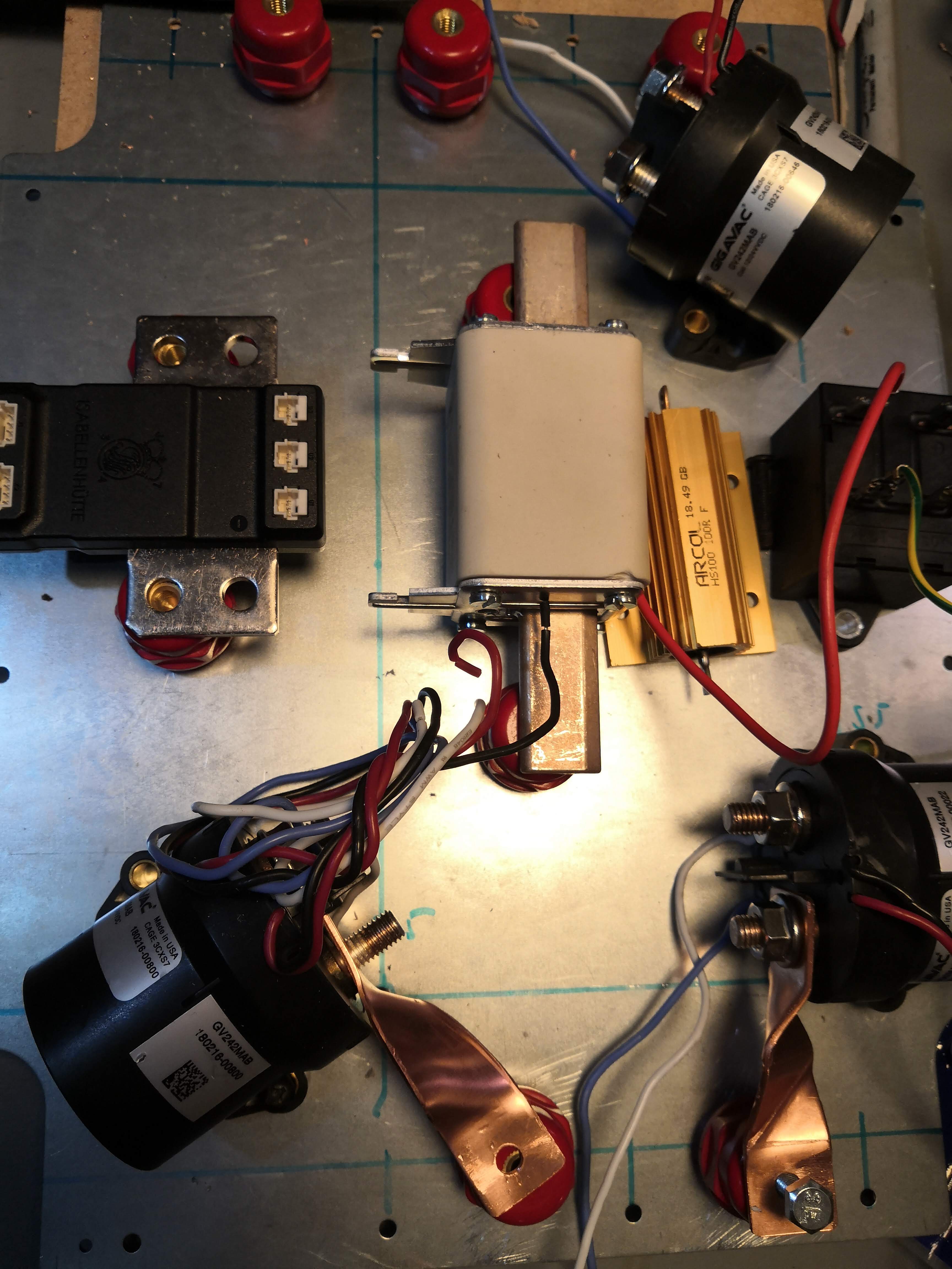

HV Junction Box

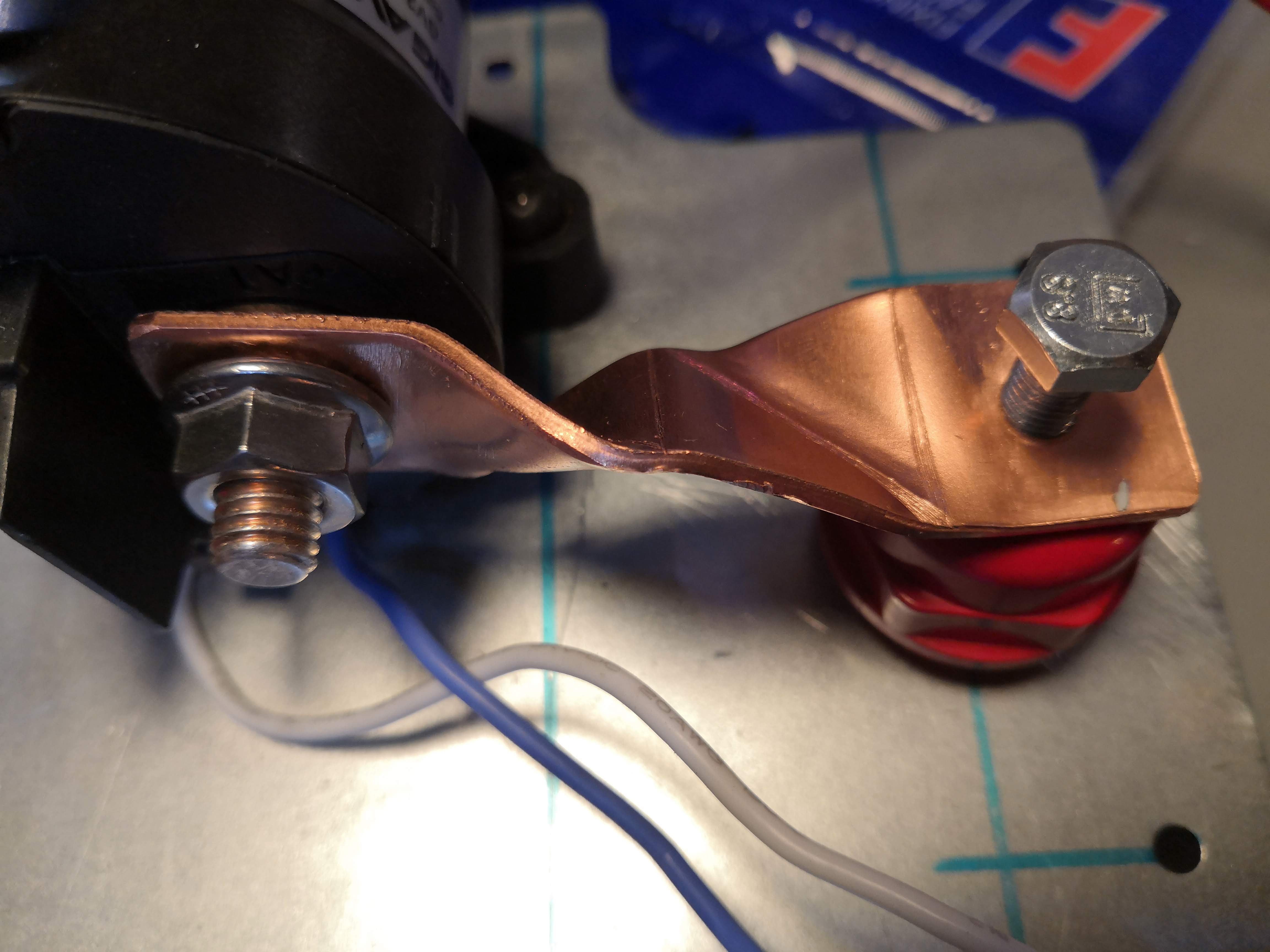

I've been working on finalising the HV junction box. This is where the contactors sit that switch the DC supply from the battery to the inverter (and vice versa for charging). I have probably laid this thing out about 20 times before I finally took the plunge and started drilling holes in the mounting plate. Still it was only after I had drilled three holes that I realised the polarity matters on the contactors (they're not just big switches) and so my planned arrangement wouldn't work. So, two holes in the wrong places. It's only cosmetic and I'm the only one who will see it but still annoying.

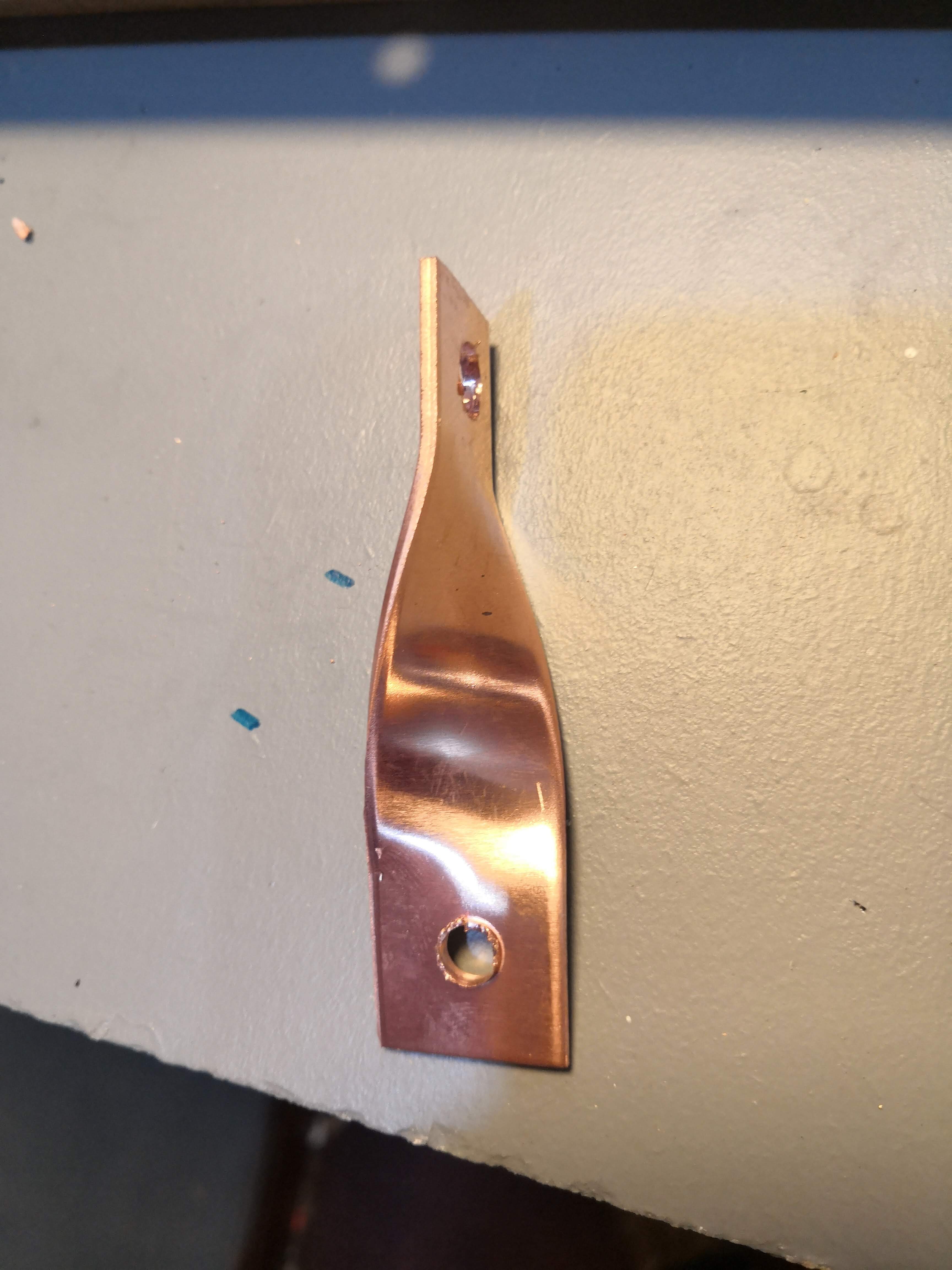

The other tricky bit about making up the junction box is connecting everything together. I figured I would have to make my own bus bars and so bought a load of 20mm x 2mm copper strip. Anyone with basic maths will realise this has slightly higher cross sectional area than the 35mm2 cables I'm using to hook everything up.
The only problem with this approach is that the contactors I bought are horizontally mounted while everything else is vertical, so my bus bars have to go through 90 degrees. I started by measuring out neat diagonals, scoring lines and trying to fold the bars along a couple of 45 degree lines to make a 90 degree bend, with a couple of other vertical/horizontal bends bringing it all back into a straight line. This worked OK but the finished result didn't look great and it took a long time.
So, on my third attempt I just stuck the bar in the vice and tried twisting it with a big pair of pliers. The result: a beautiful smooth curve with hardly any work. You live and learn.
Only seven more to make...
