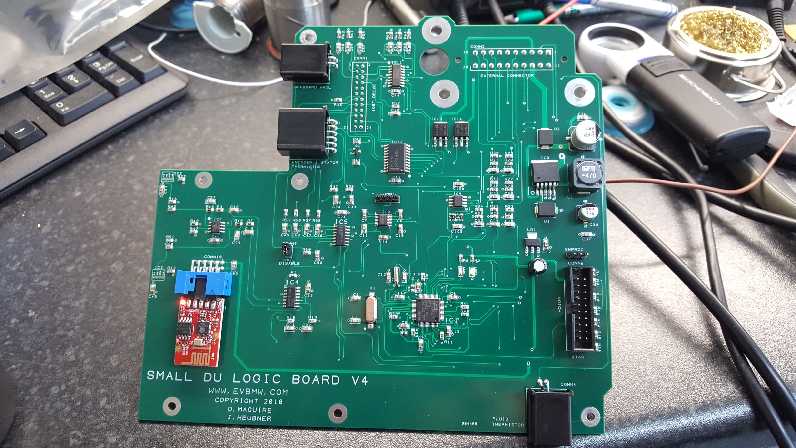

Setting up a support thread for the open source small drive unit control board.

Just a little note to let people know we have finally been able to source the 2 pin JST connector for the HV interlock and coolant temp sensor so all future opensource boards will be supplied with these connectors fitted. At least until Elon buys Mouser out of stock again :)
