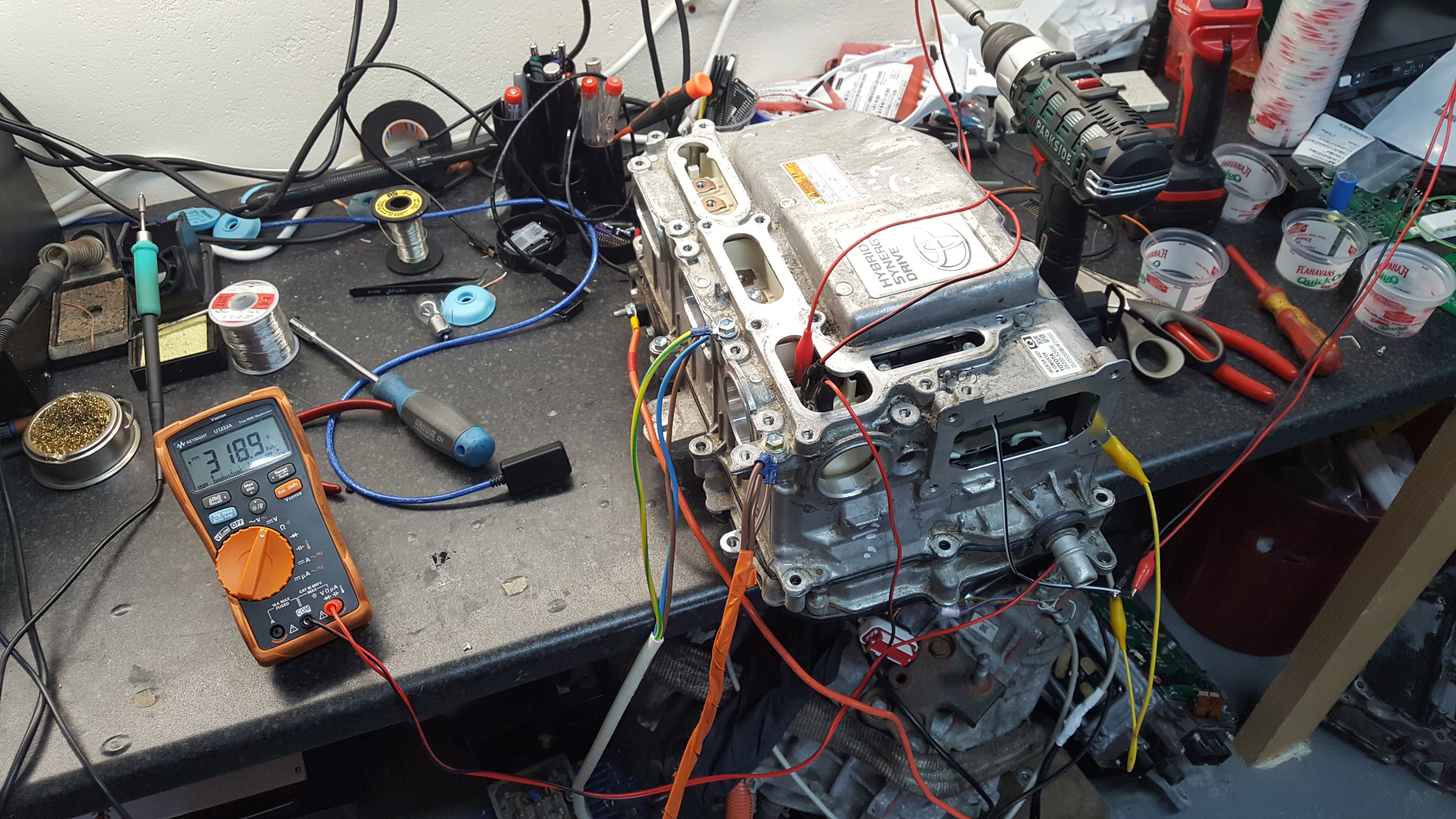

Decided to break off a new thread for development of control software to run on the Atmega328 processor for control of the buck boost converter in Gen 3 Prius and Yaris/Auris inverters.
First attempt here from myself to run in buck mode to drop a 360v nominal HV down to 200v to run the dcdc converter section without modification. Only tested on the bench with low voltages in a Yaris inverter but seems to work well.
Runs atmega328p buck/boost control on Prius Gen 3 and Yaris/Auris inverters in buck mode to drop Main HV down for DCDC converter.
Experimental code. Only tested on the bench! Use at your own risk!
D.Maguire

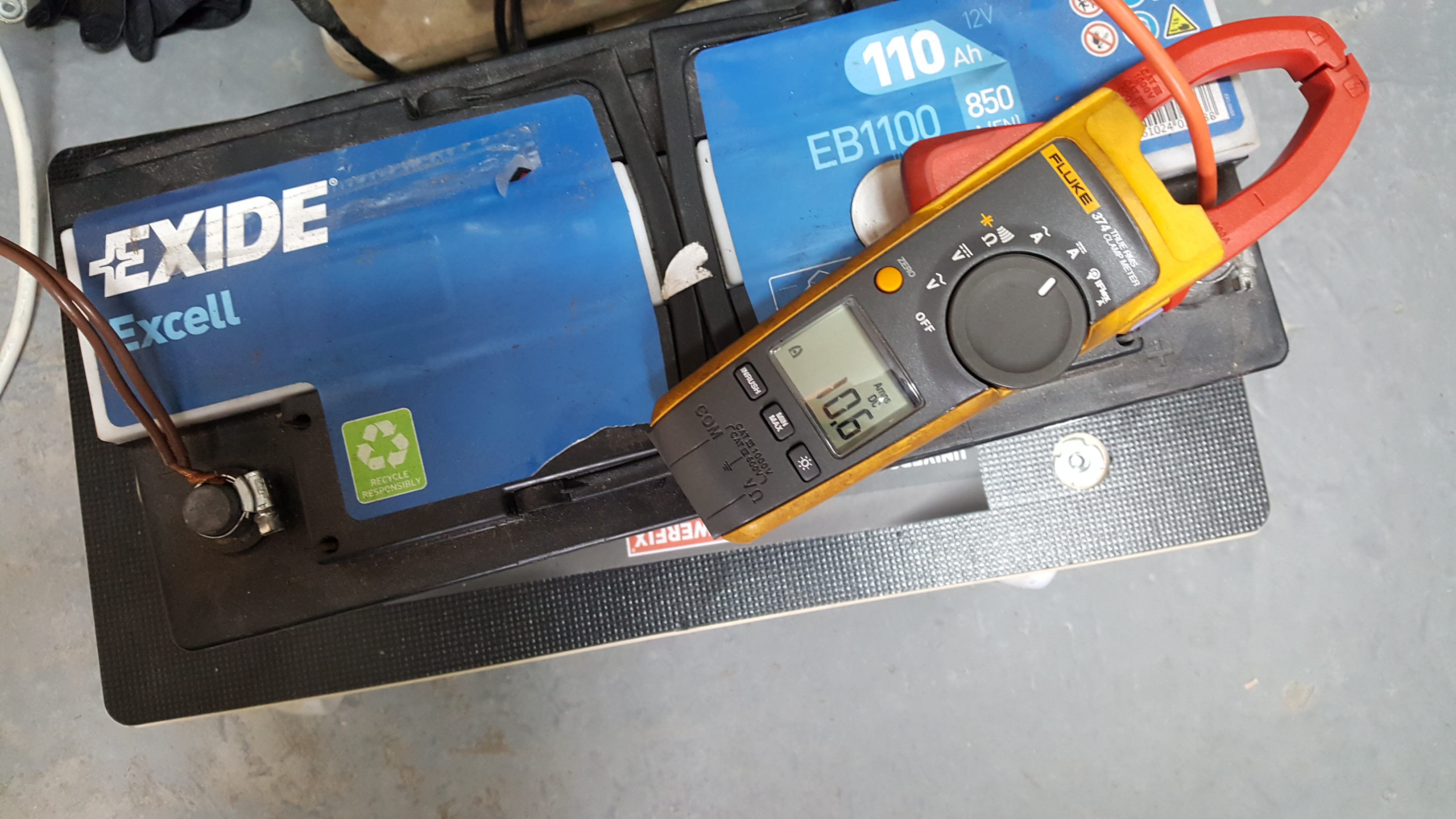

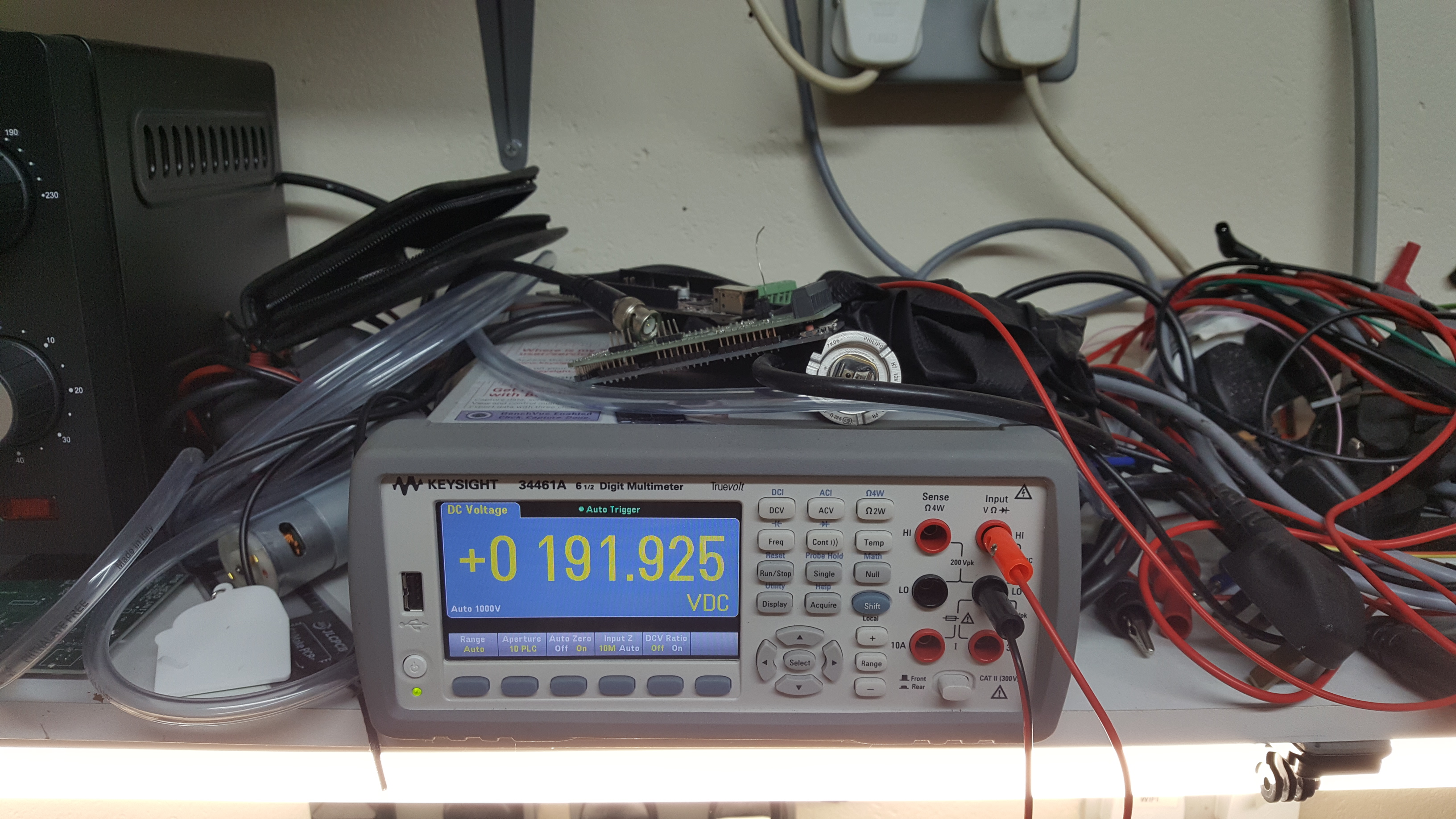

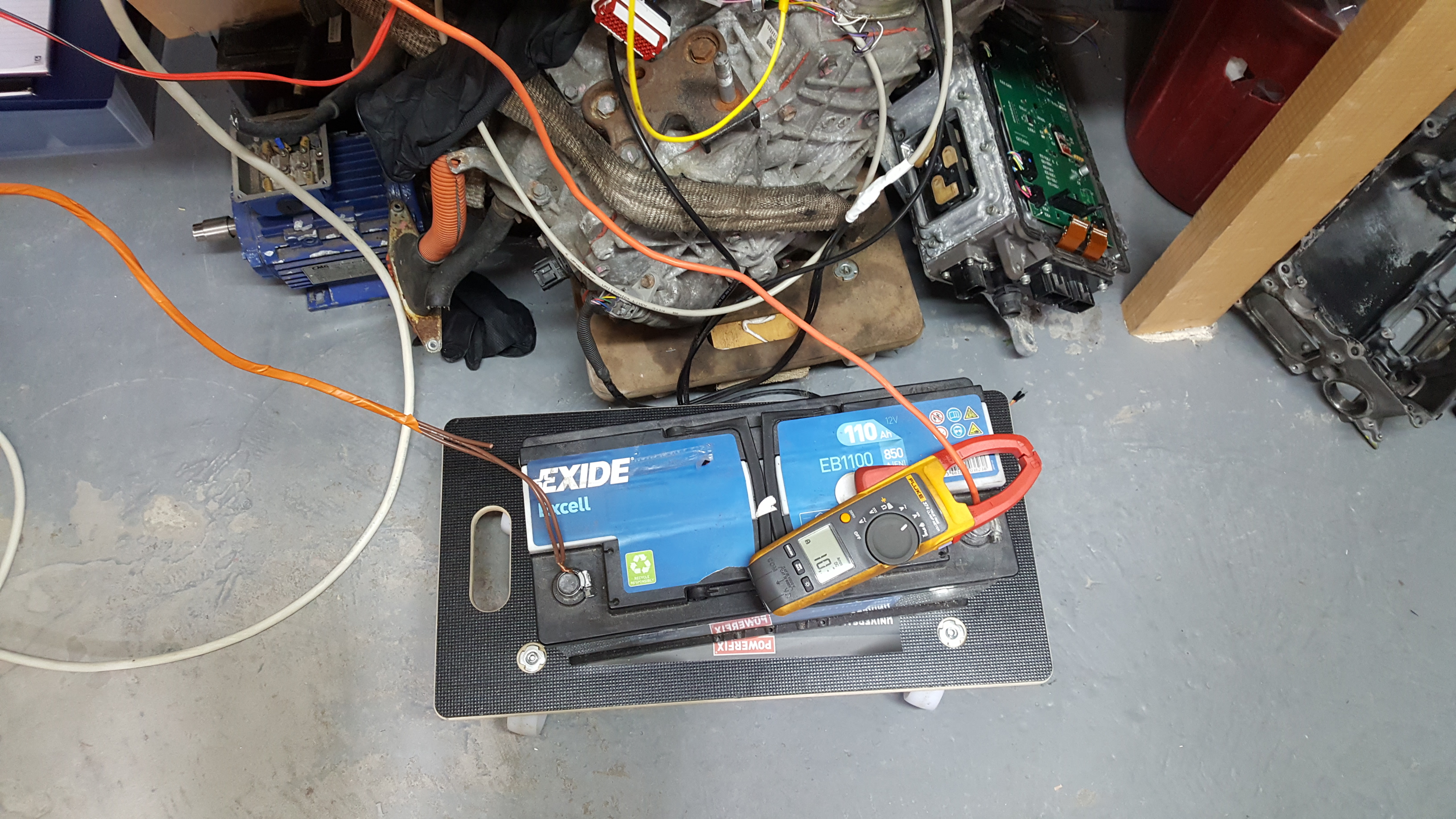

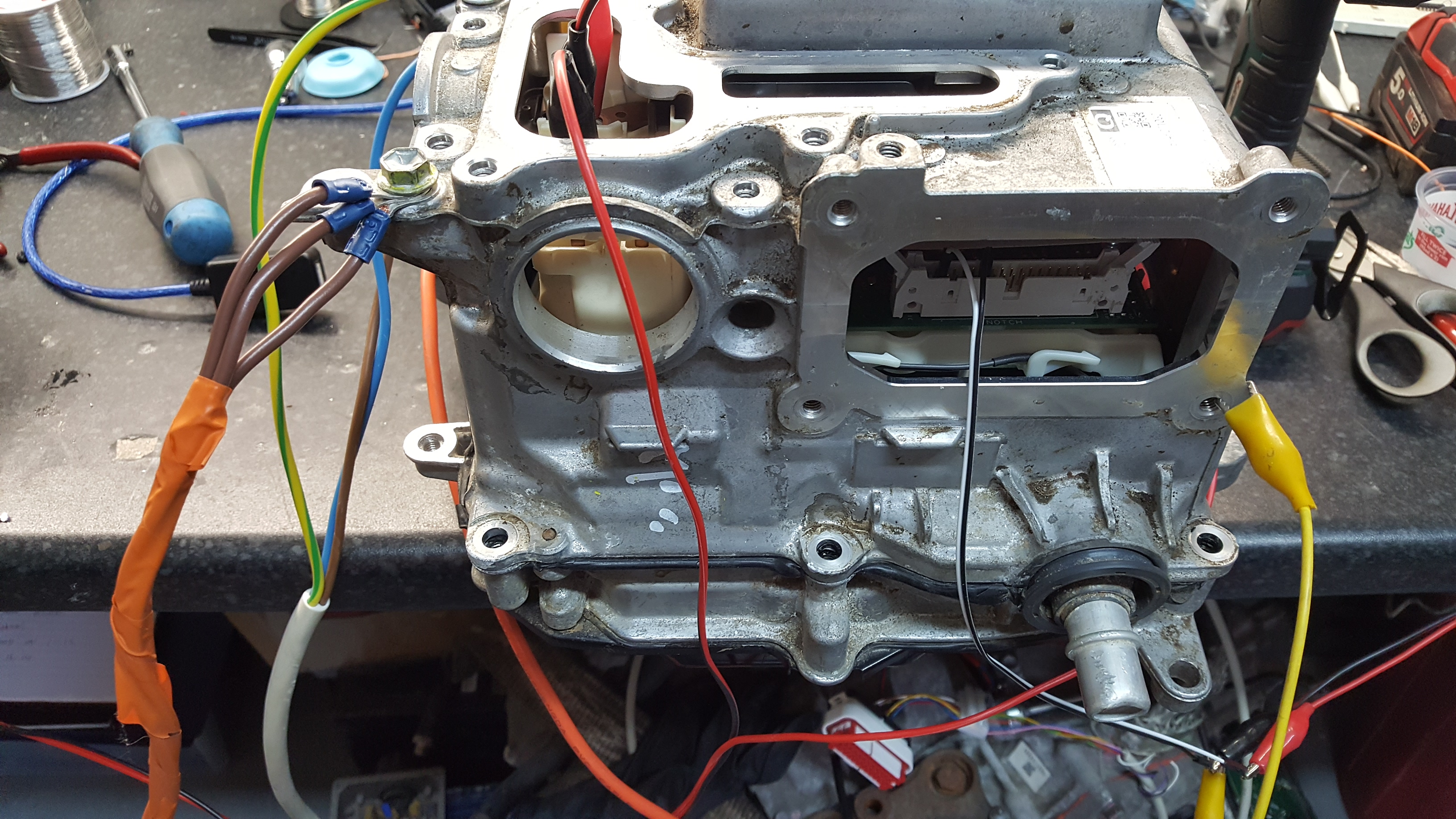

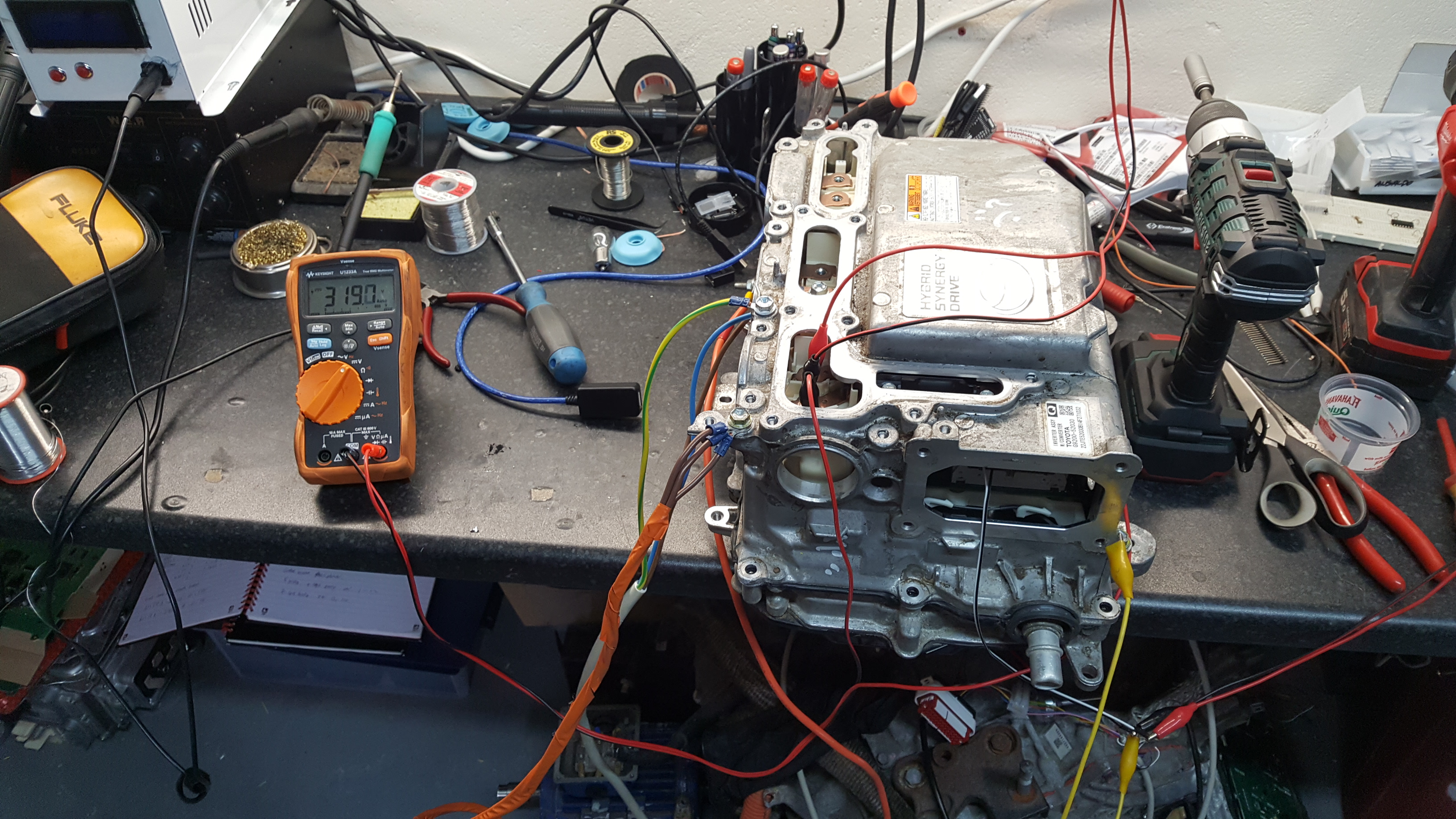

Figured I'd better test it. annnd....it works:)
Connected 230v mains to mg1, battery on the dcdc output. At 230vac in we were seeing about 320v on the HV main side and about 190v on the hv batt side. DCDC works perfectly.

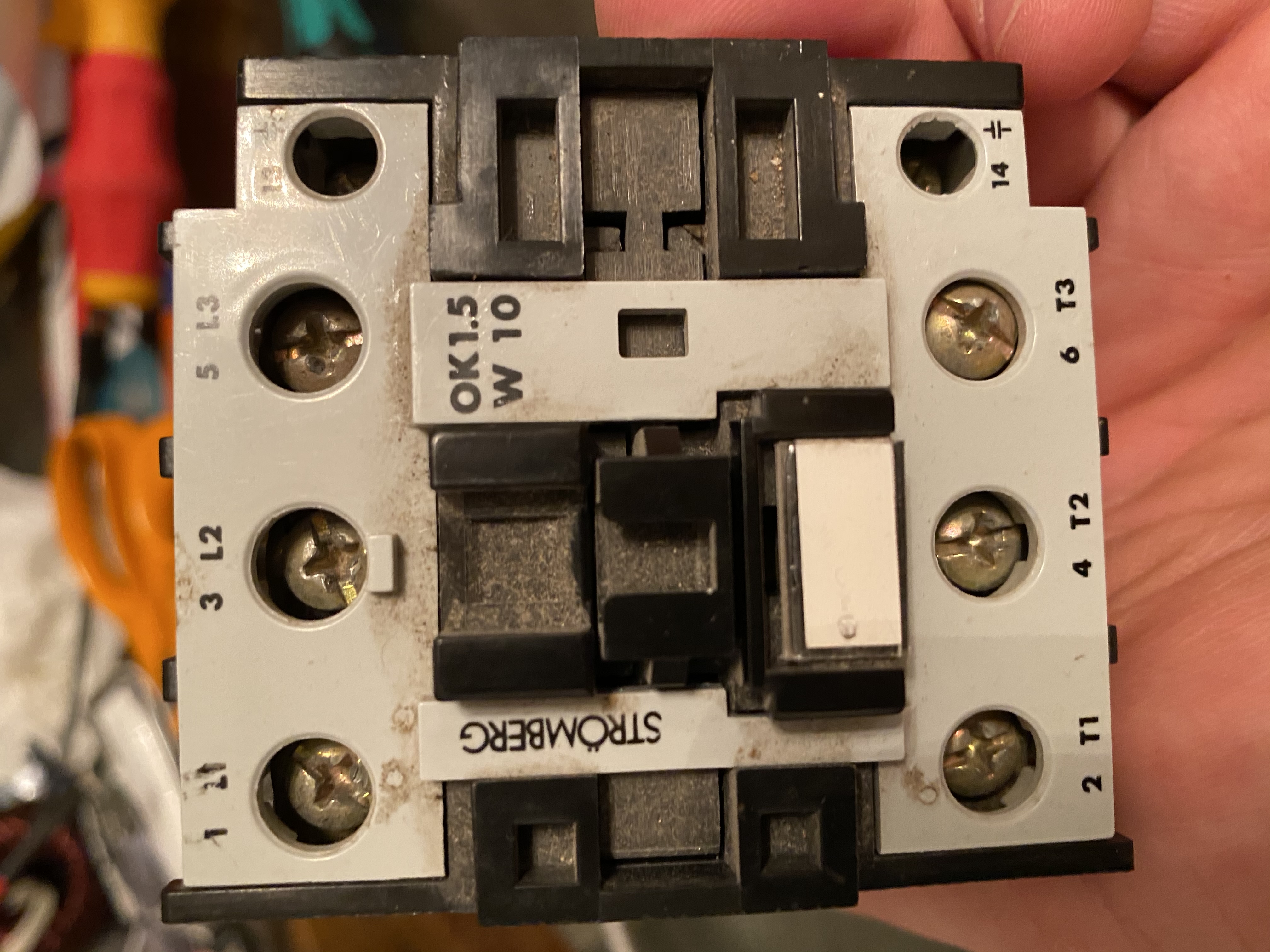

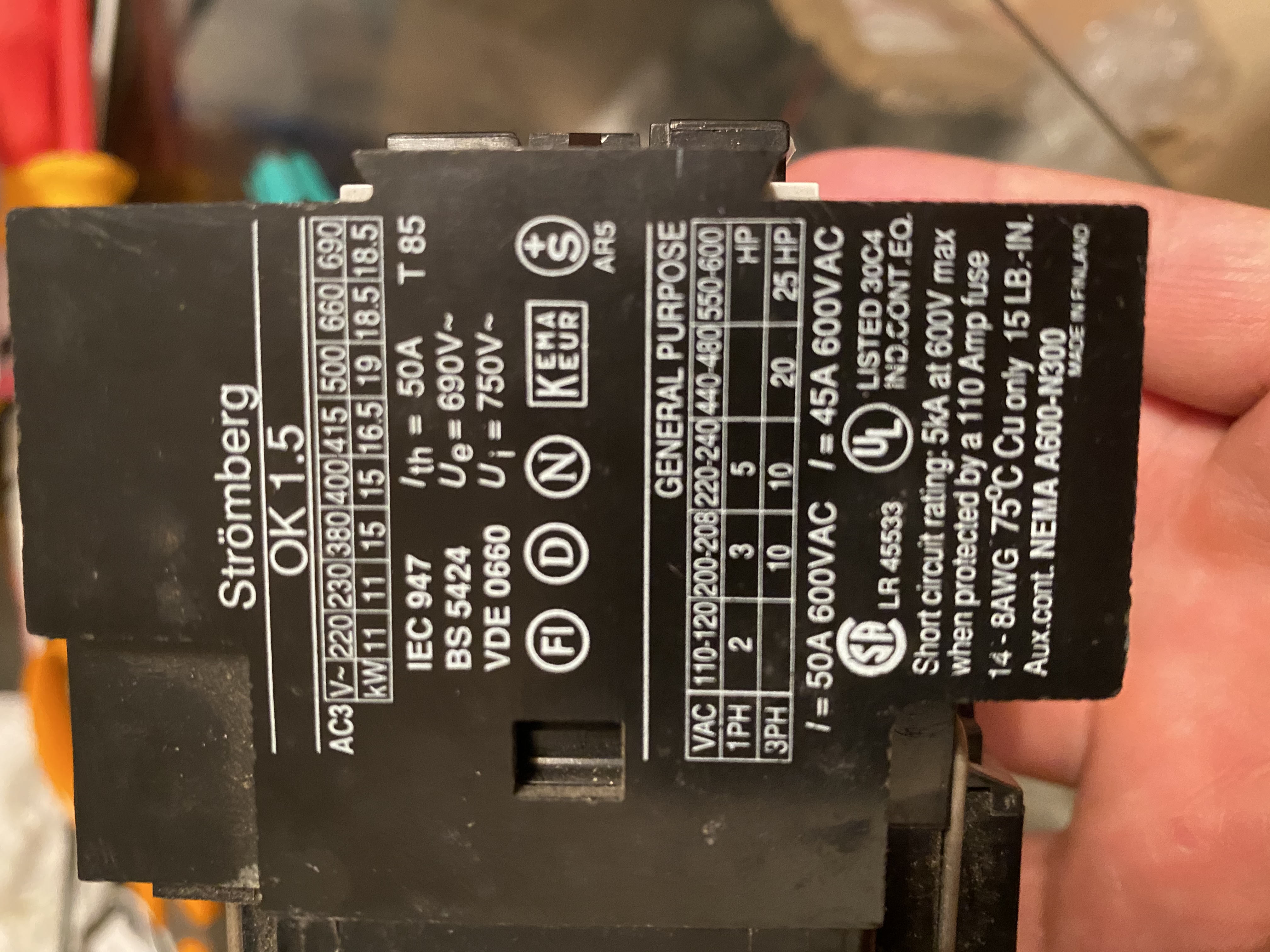

I am going to get to the charger code, but as a hobby my timeline is tied to the timelines of my projects that it's part of.
I'm not going to code it blind, I need a high power test setup for it. I currently have a Yaris inverter sitting on my desk, with all original wiring harness connectors. But before I can get to work on making it charge, I need to obtain a 3x400VAC input contactor and either decide to stuff a Prius board into it or obtain a Yaris board (Yes, Damien sent me a Prius board but I only could get a Yaris inverter for cheap...). Also I'm yet to source an HV connector for my BMW hybrid pack (not going to cut the original wiring as I plan to use the entire thing as-is and solder and heatshrink tubing for repairing cut wires isn't a good idea for high voltage high current). Haven't begun checking whether I have the 3 phase cable, connector, high current crimp terminals and whatever hardware for doing this yet. And my bank account is reading about zero right now. The car in which my existing hacky prius gen3 charger is in is a daily driver, I can't just go take it apart willy nilly.
So, if you need the code from me this fast, now you know what's currently blocking me. Throw money and/or parts at me and it'll happen faster.
I'd start programming and testing the charge function tomorrow if I had everything I needed.

celeron55 wrote: Thu Jun 11, 2020 8:15 pm I need to obtain a 3x400VAC input contactor
I have this sitting on my desk unused, if it helps I’m happy to send it to you and cover the postage as well.

I've taken jnsaff's contactor offer so I'm getting closer to having a test setup.
Don't be so hurried and worried about this, it's going to happen and you don't need to waste your time and resources on it.

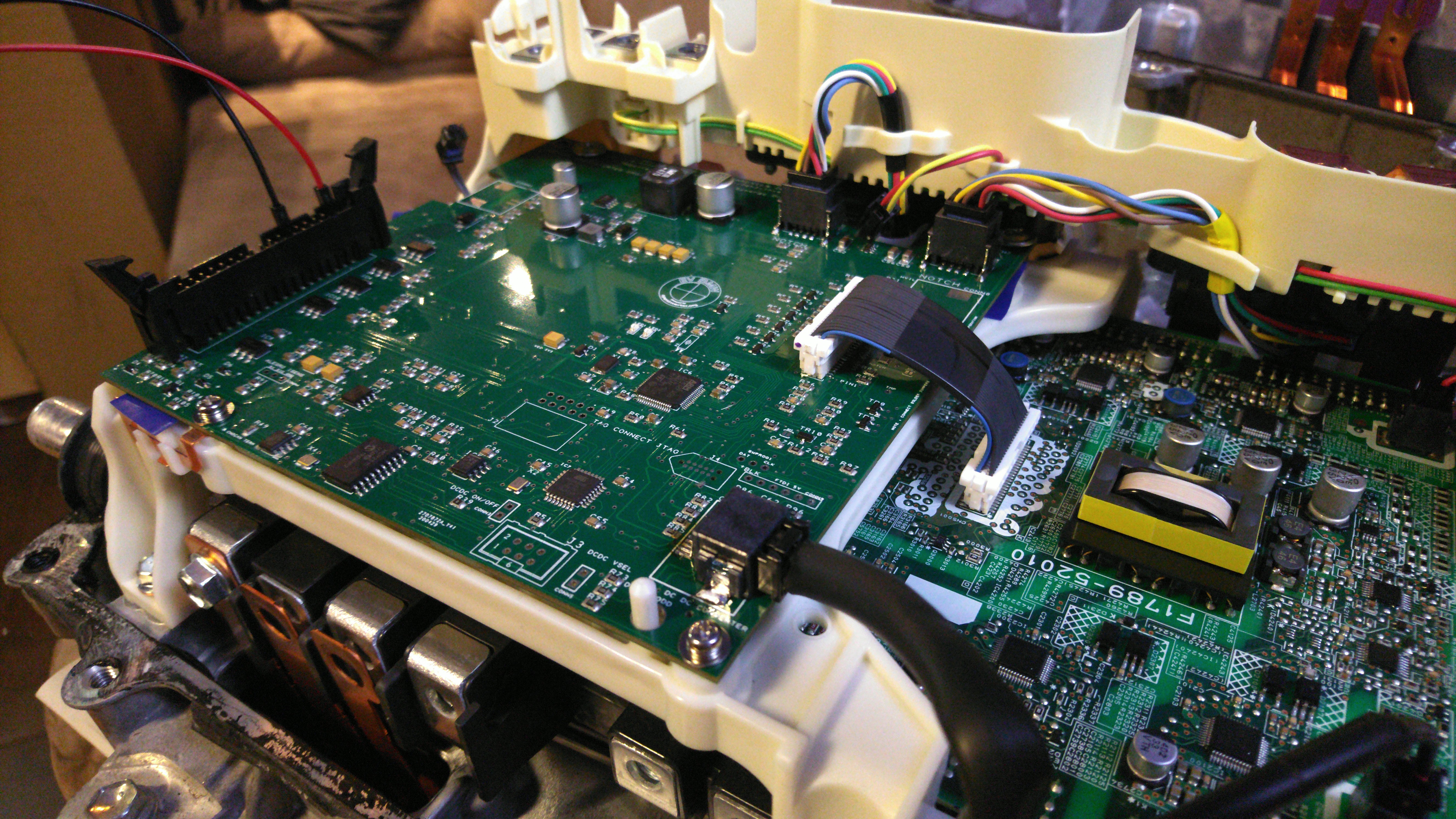

Plopped the prius V1c board into my Yaris inverter. Here we go then.
The current sensor pinout is the same, right?
EDIT: Yeah it is the same, no smoke and getting some readings!

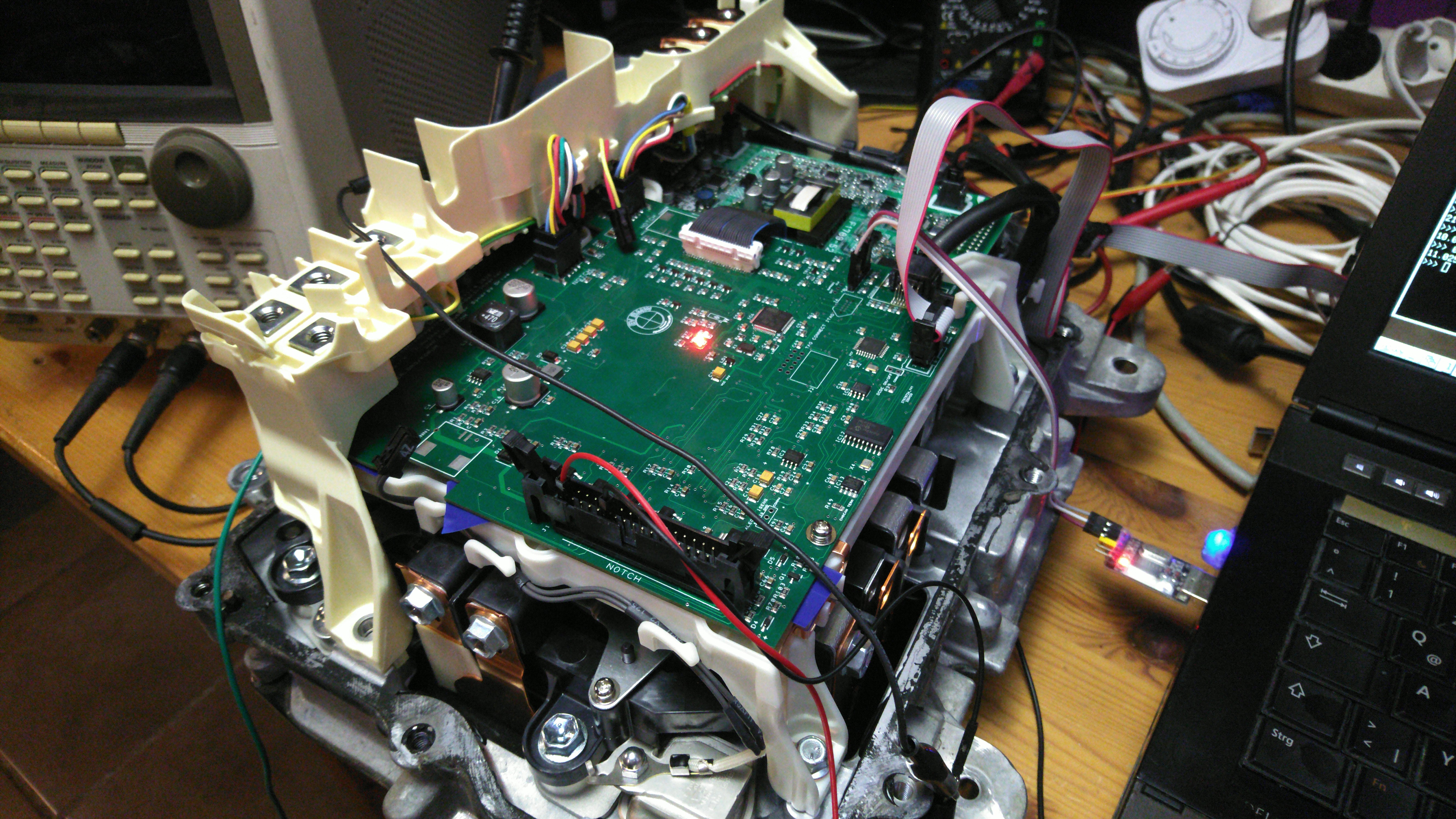

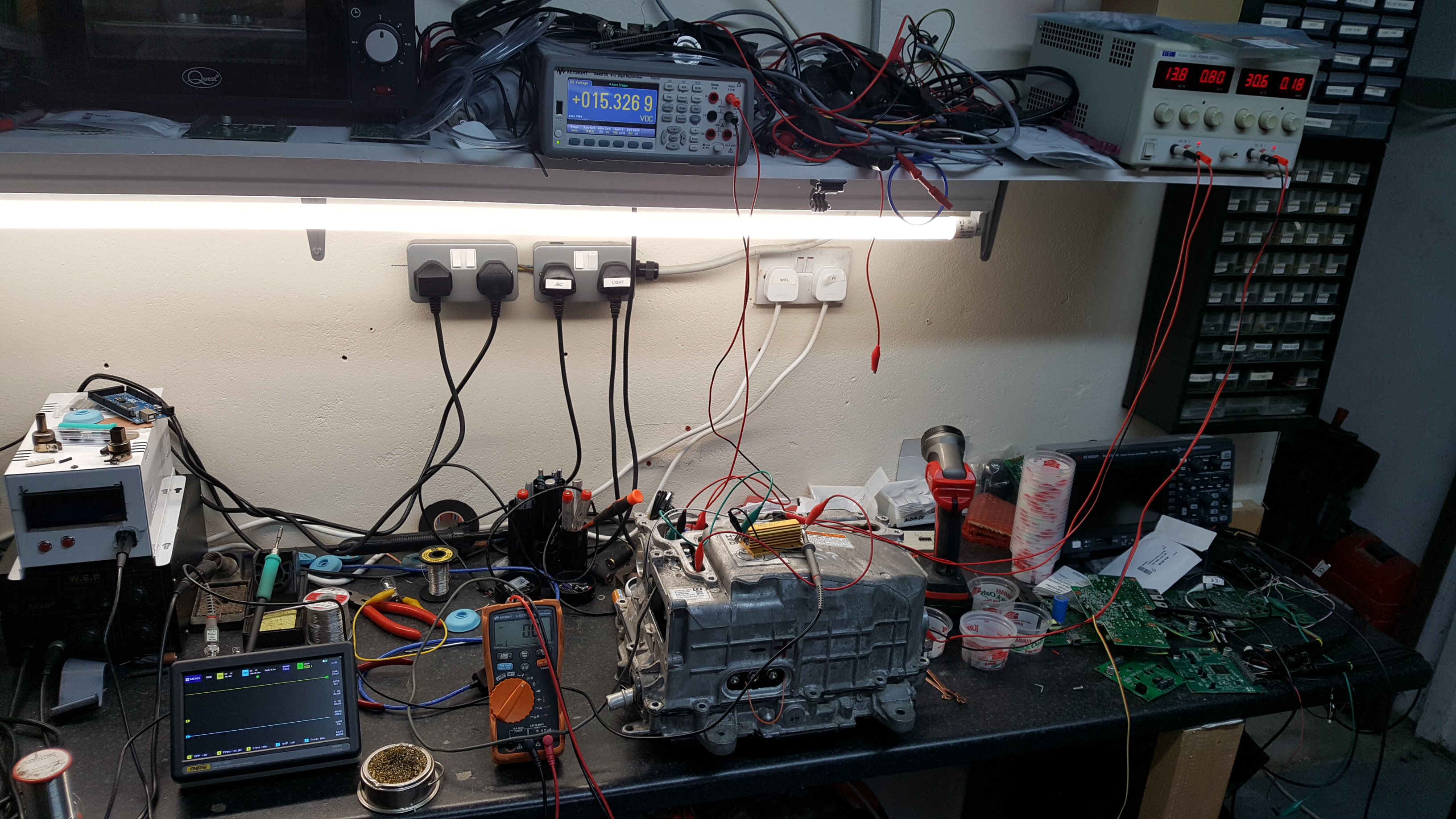

Hmm... I feel like my Yaris inverter, on the scale from inverter to paperweight, just turned slightly more towards paperweight.
I connected it to my car in place of the previous hacky prius inverter charger for testing, with the intention of leaving it installed if it works.
I was implementing the input side precharge by boosting battery voltage to 600V to the MG1/MG2 HV bus. As it turned out, my PWM went way too high for just charging a capacitor. There were a series of bangs and the last MG side voltage values I saw were over 1000 volts.
Now when I power it up with the car, the logic board shows 0 volts on both the battery side and the MG side. And no, there's no 0 volts there, the car still succesfully precharges to a little under 300V.
Now, to strip it off the car so that I can go on this trip I planned for tonight...
