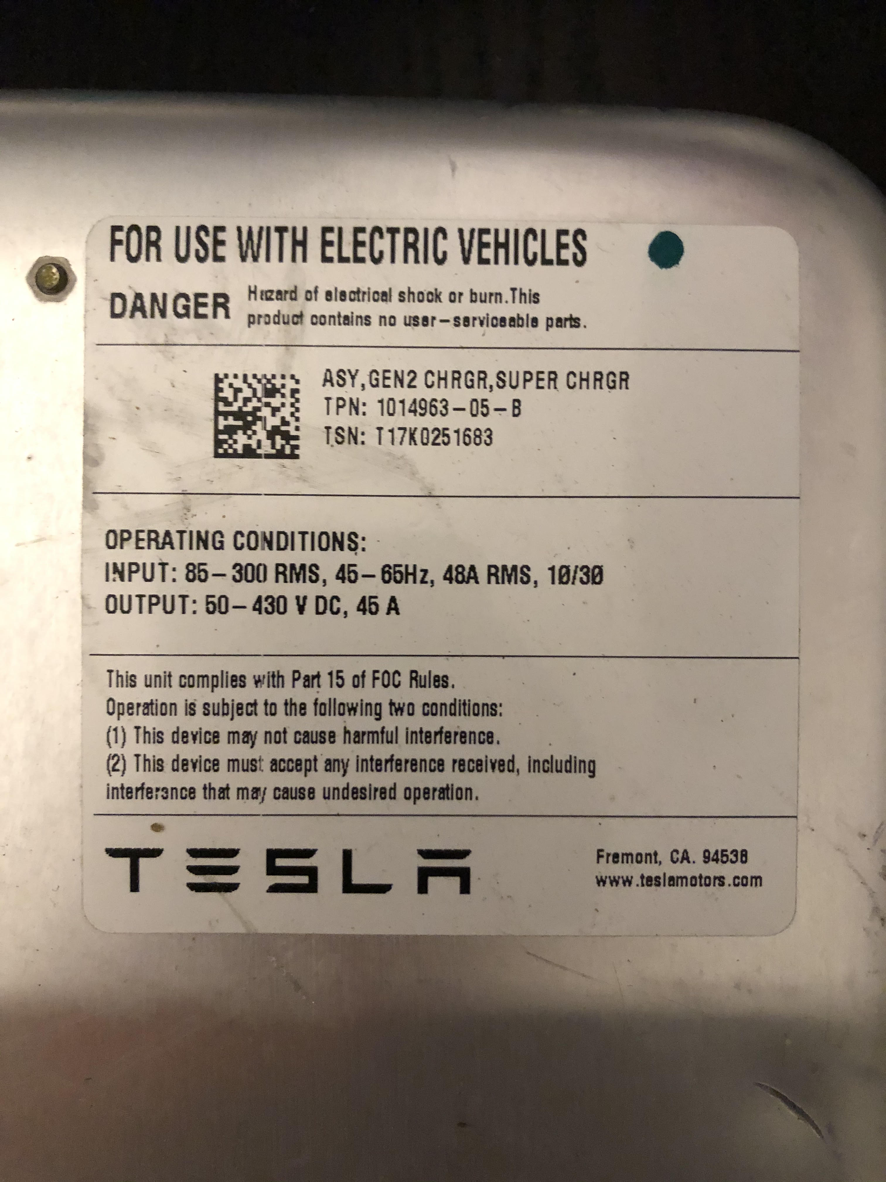

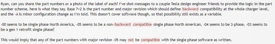

We have had an incredibly tough time getting Gen2 chargers to work successfully and have probably amassed the larger private collection of Gen2 chargers in the world. :(
After getting another batch of 4 chargers (luckily for next to nothing) that didn't work, we realized that the chargers were from a scrapped Tesla Supercharger, 1014963-05-B. It appears that Tesla scrapped a bunch of V2 Superchargers last year and that a number found their way onto the market. Notice the description after the part number
After looking back at our past list of chargers, I realize that our last 2 Ebay purchases were also from Superchargers ,(but were being sold as out of actual Model S vehicles). There are still some being sold on Ebay. I have contacted the individuals and asked them to remove, or revise their ads. I quickly went through the support forum and see that some others that were having problems also had these same units.
Bryson provided some info on part numbers in the past that says that all -05- units won't work:

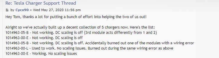

Here's our list of chargers (excluding the last 4 bad chargers) with part numbers:
As you can see, we had one Rev E charger that worked, and one Rev E that worked.
I have combed through the forum posts and see evidence of Rev J,K,G,L chargers working. All Gen3 chargers also appear to work (which would be the equivalent of a later Rev).
So, my guess is that early Gen2 chargers do not work. The change over was probably somewhere in the Rev E release. If anybody is buying a charger, at this time I would stick to Rev F or later. It would be helpful if others could post the REV of their unit and whether it worked or not.

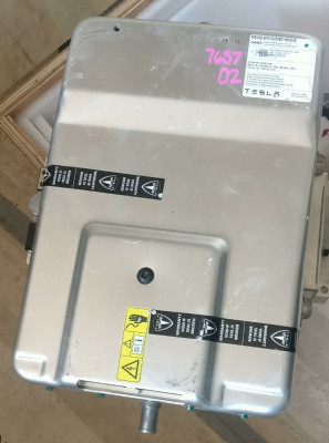

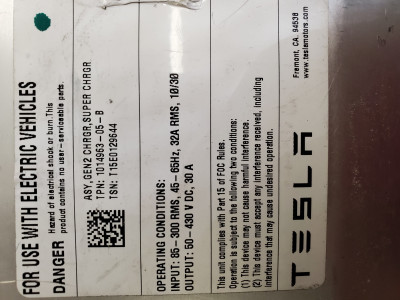

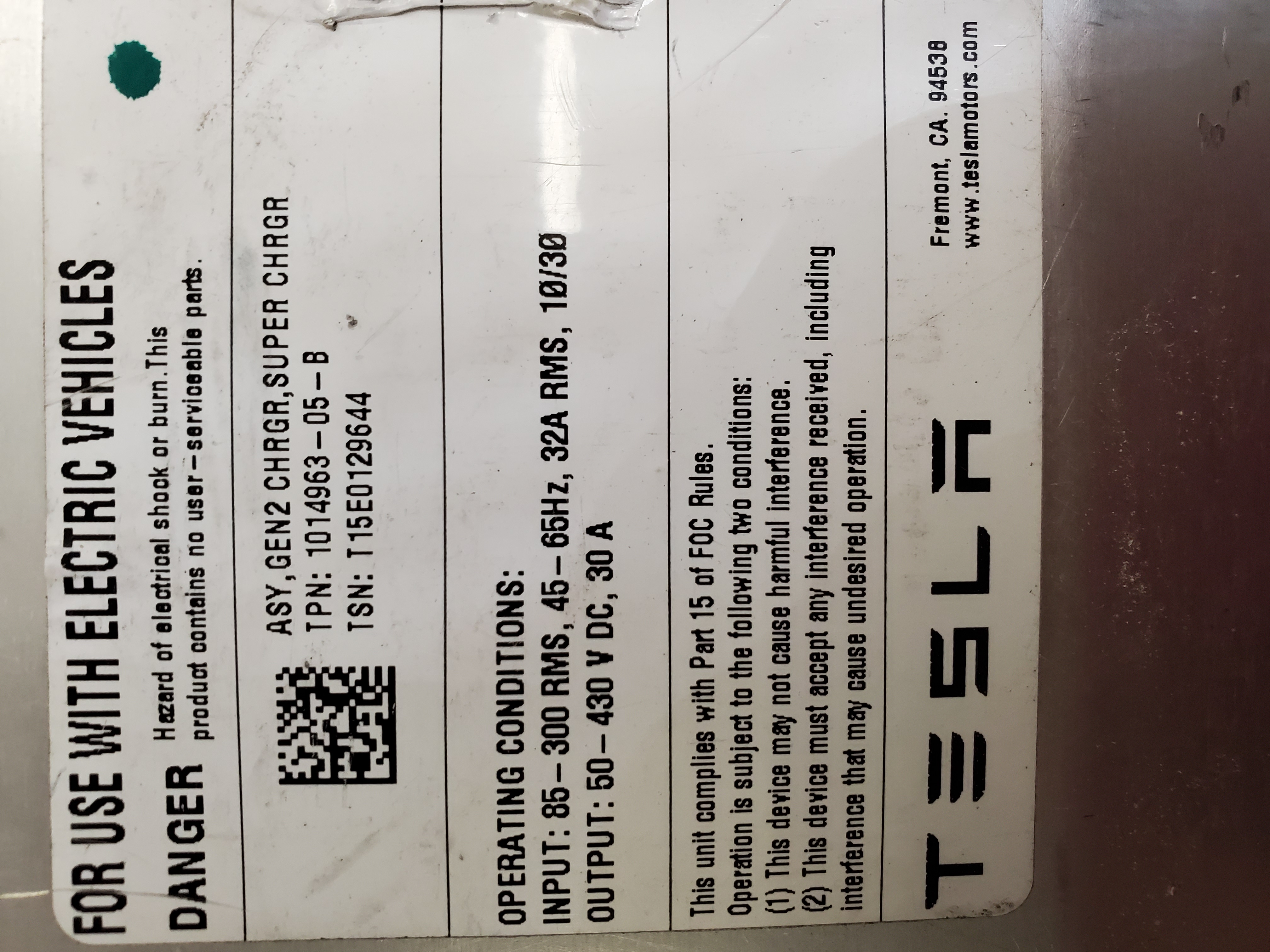

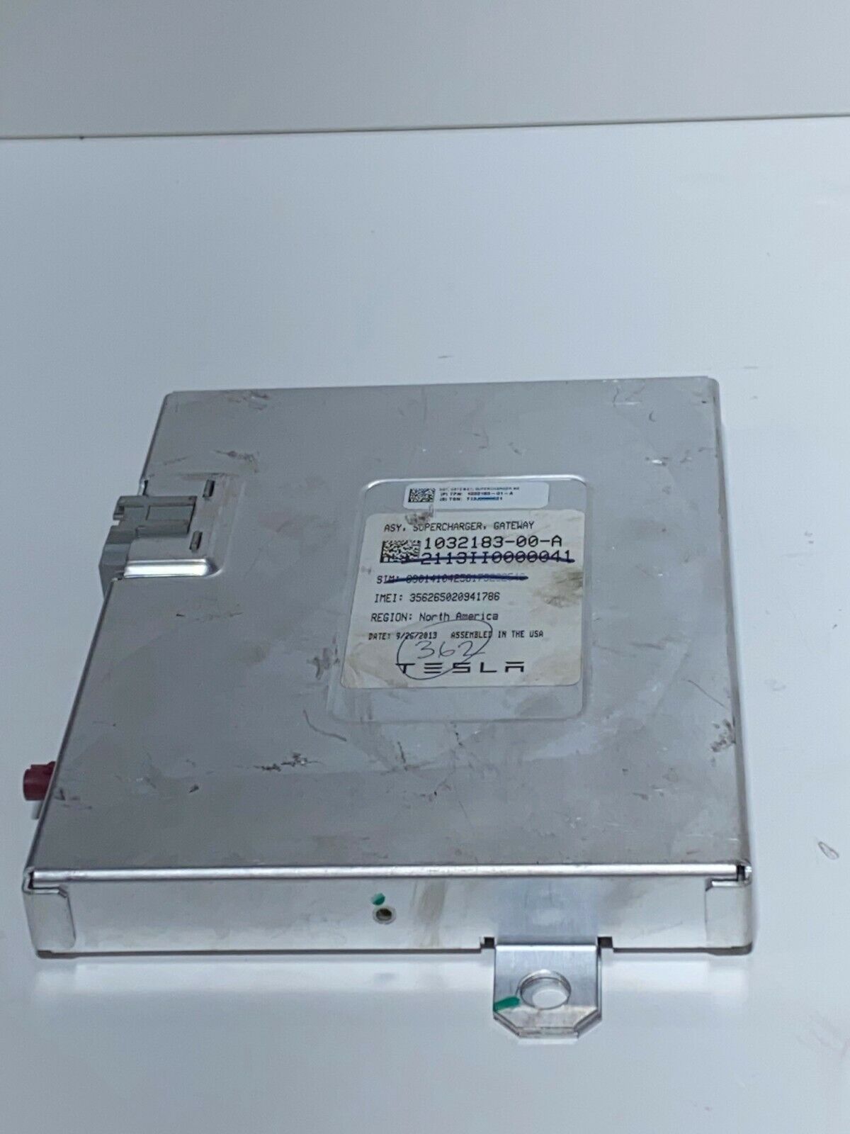

I unfortunately paid $250 for a super charger version from ebay before seeing this. Using the v5 board I am getting 125VDC from each module.
annyung

dougyip wrote: Thu Sep 03, 2020 3:36 pm Some of the Supercharger units are Rev C - and they don't work.
Purchased two Rev K chargers - and they both work! We will now be up to 27kW of charging capacity for our next race!
Curious, do they not work because they are super charger scrap or because of the rev C? I have a local seller with a rev c from a model s I was looking at buying for a pretty good price.

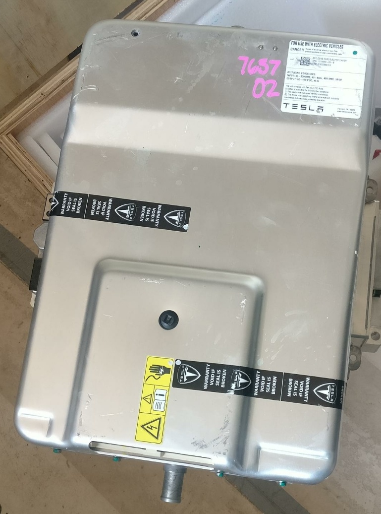

I bit the bullet and bought a 05 unit!
I only have no clue if i can give it any use in EU at all?
Is it compatible with 230 single or three fase?
So i will try if i can fix this scaling related issue and make the cheaper super chargers work.
The only thing i need is a Gen 2 board....

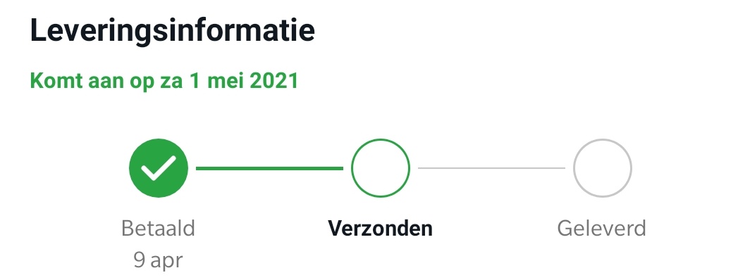

Ok shouldn't be too long before we can start!
Sadly the seller is on the otherside of the USA so it takes a bit more time.
The mouser connectors are inbound too.
(The 12pole molex is on backorder... though)

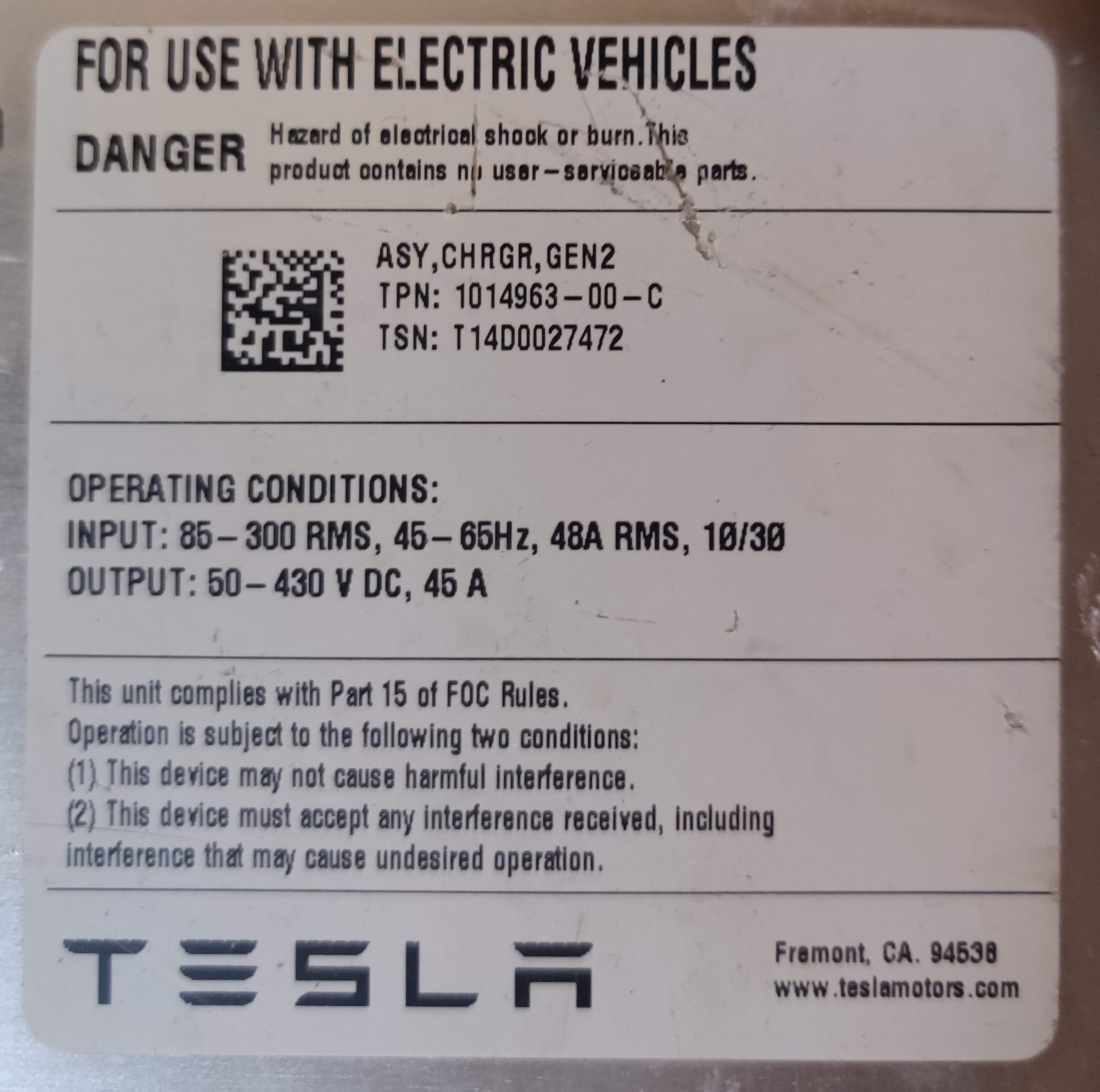

Can anyone publish there hardware numbers/versions?
Just to check if those are the same albeit the cover has a different number?
(1014963-05-B spcharger POS#2)
- Controlboard Tesla : 1026865-00-D REV02
- Charge module : (1026696-00-G)
- Molex Side Print version: (1020419-01-C REV3)
- Board Cable Part Nr: (1017601-00-B)
