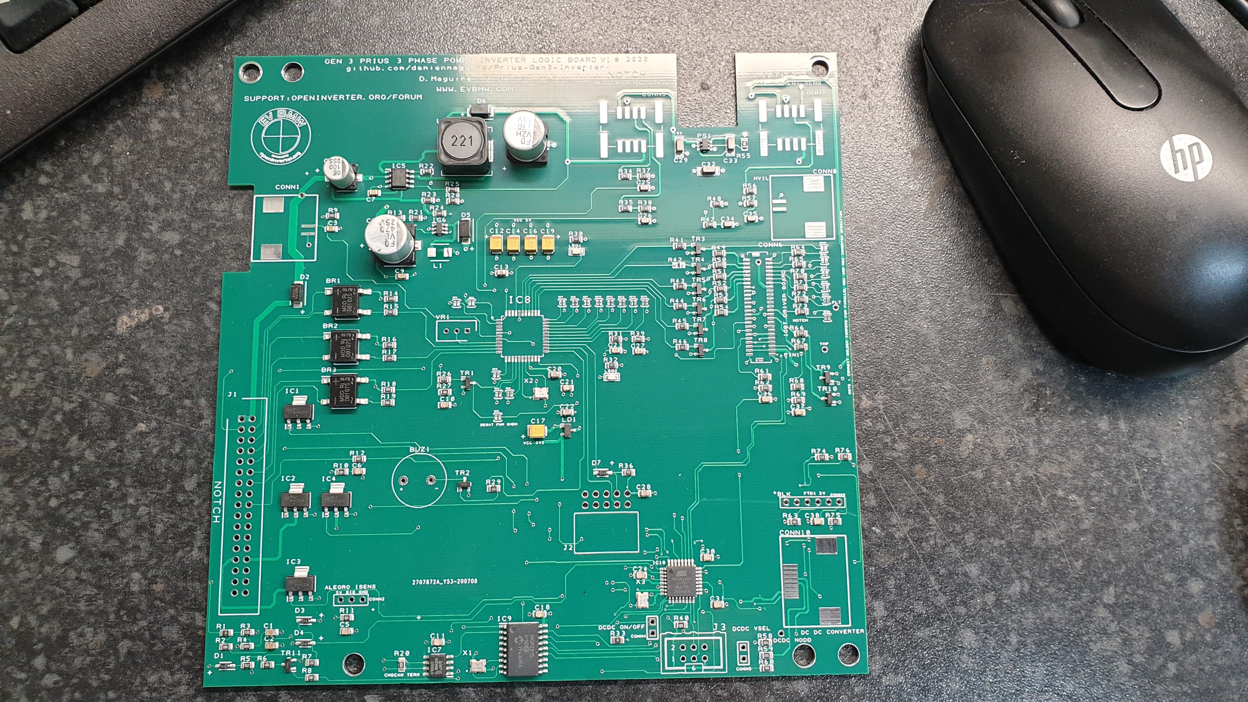

Prius Gen 3 Mains 3 Phase Inverter Logic Board
- Posts: 4007
- Been thanked: 1139 times
Time for a new logic board for our trusty Prius gen 3 inverter. This one is not for running electric vehicle traction motors however. Rather it lets you take either 230v single phase ac or a battery between around 150v to 600v and make 3 phase 400vac at 50Hz or 60Hz for running 3 phase equipment. Equipment say like a pair of 4kw 3 phase submersible water pumps to prevent a flood from ruining your home or workshop as just happened to me over the past few days.
Need 3p+n? Can do that via a delta to star transformer for that authentic 3 phase feel.
Uses the EG8030 from EGMicro as the brains of the operation:
https://www.egmicro.com/chip-centers/7/EG8030/
and for those not fluent in Chinese :
https://translate.google.com/translate? ... FEG8030%2F
I'll release the design and post more info over the next few weeks once my feet dry out.

Yeah I'll do a kit at some point. Can use the EGS8010 for single and split phase 120-0-120 systems.

Is that 3 phase VFD control chip cheaper than a STM32? I'm under the impression an off grid inverter can use the exact same STM32 board used for EV conversions, minus the parts that deal with motor position sensing.

I have one of these fellas now--thanks Damien! The design files are now available on his github as well.
Trying to figure out how it works before even starting assembly. For context, I am not an EE or any kind of E, just make software for a living and play with cars and have a very basic (mis)understanding of power electronics picked up from my dad and this forum.
I'm in the US and have a small mill with a 3 phase motor which will be the first thing we try to use this for. The data plate says 230/460V--Damien's posts above say 400V. The motor definitely will be loaded, so I wouldn't expect 400V to work. The datasheet is hard for a dude like me to get through. I don't see any reference to an expected output voltage. As near as I can tell from that and the schematics, we're using this in synchronous open-loop and setting or adjusting the voltage with a trim-pot attached to pin 8 that is maybe expecting a reference of 2.5V. It appears the 3-phase feedback pins are not connected, and the voltage on pin 8 is generated by dividing a 5V supply from the board. Does any or all of that check out?
If so, do I experimentally find a good value for that trim pot and adjust to ~460V? I can of course start with the 4.7k specified and go from there since 400V is kinda close. Max input for that voltage feedback pin seems to be a full 5V, but what would that correspond to?
Is the buck/boost used here, and do I need to mess with it to get what I'm after?
If using DC input, is this connected as per the wiki for the normal Prius mod board?
How/where would one connect up the single phase AC input?
I guess last thing to optionally figure out is if 115VAC input will work at all (say if the load wasn't going to pull more than the 15-20A our wiring will give up)
Thanks in advance for any guidance or answers. I'll be sure to post my own findings and Youtube videos as success permits.

The motor specifying two voltages means it likely can be wired for either one, check the terminal block. You'll probably want to wire it for 230V.
The boost converter can be used for PFC boost. Add a bridge rectifier to connect the battery side to AC. You'll also need some sort of PFC controller driving the low side boost IGBT, the high side IGBT should be wired to stay off. Operating frequency is about 12kHz.Is the buck/boost used here, and do I need to mess with it to get what I'm after?
- Posts: 4007
Re: Prius Gen 3 Mains 3 Phase Inverter Logic Board
Of course feedback is used. The board provides for EITHER open loop via the pot or closed loop via 3 feedback transformers. Rectifiers are on the pcb. Sorry again but due to house moving I don't have time to go through it in detail.
