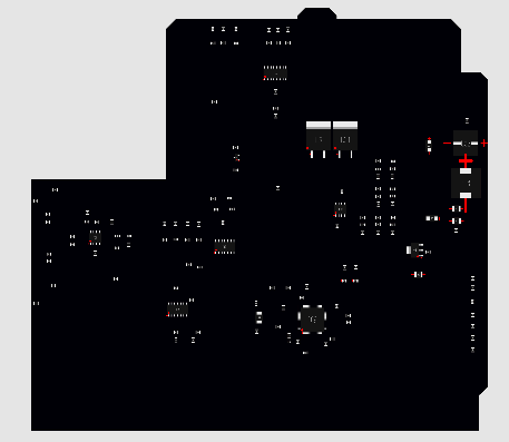

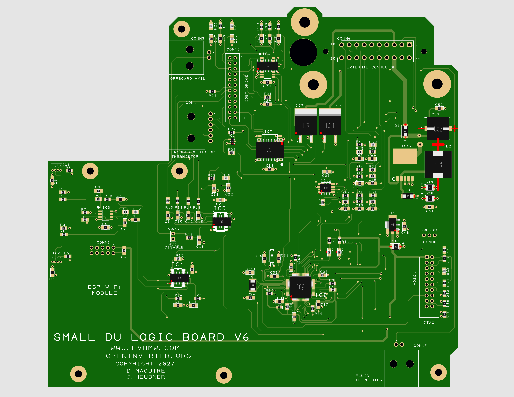

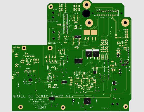

It's time for an update on my progress - plenty of distractions but I've sat down and gone through this again.
Last week I generated some Gerbers and CPL/BOM and put them into the JLCPCB website.
I had to change a few parts in order to fit inside the extended part budget, but overall it was going pretty easily. Until...
The parts don't line up. At all.
I tried manually offsetting some parts, but that didn't work well -- I eventually got a few parts lined up but then the offset for some parts was off in different ways.
Here's what I'm seeing:
I uploaded Damien's gerbers, BOM, and CPL to see what a working solution looked like. This looks a little weird too, but at least the parts line up (some are rotated wrong).
damien gerber.png (10.71 KiB) Viewed 84105 times
I also generated gerbers from Damien's .brd and .sch v6 files, this matches his gerbers but looks different in the viewer:
Can anyone with Designspark/JLC experience weigh in here? I'm at my wits' end here. I've been looking at everything; checking the CPL format, looking inside the gerber files themselves, whatever I know how to do.
I suspect something weird due to the component libraries I am missing; Damien, is there any chance you could share your Designspark libraries? I know you swore off any Tesla stuff before you retired to Lanzarote, but I'm stuck.
I would be working on the LDU board but if I don't even know how to get outputs from here, it makes no sense to sink more useless work.
-Isaac

Re: Tesla SDU/LDU Update
Couple things. first set your origin to the bottom left corner. Just zoom in as far as possible, put the cursor on the corner and press o.
Don't worry too much about the lineups after that. JLC sort it out.

Jack Bauer wrote: Fri Sep 25, 2020 11:14 am Couple things. first set your origin to the bottom left corner. Just zoom in as far as possible, put the cursor on the corner and press o.
Thanks Damien!
It's at the bottom left corner of the workspace, should it be at the corner of the pcb itself?
I'm just concerned because most components are about 30mm off.

Bottom left of the board outline.
