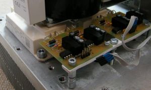

Gate drivers
The switches are controlled with a small voltage of typically 15V. At 0V the switch is off, at 15V it's on. Keeping the switch on or off is easy. But changing state is rather hard. Just like switching on the light in your kitchen requires some mechanical force. The electric current needed to operate our switches is 2.5A. More serious power electronics even require 40A. So gate drivers for power electronics are power electronics.
Another challenge is on the high side, i.e. the switch thats connects the output to the high voltage. I stated above that 15V are needed to switch on. 15V in respect to what? In respect to the source i.e. the output of the high side switch. So as the high side is switched on, its output rises to the high voltage. So the control voltage has to rise with it. Imagine a lift that rises whileyou push a button inside it. You better be standing inside the lift as you push the button.
This last aspect presents the third function of a simple gate driver: galvanic isolation. It's like a guy standing in the lift operating it for you. No matter where he is, you can stay where you are. In an inverter thats also a safety issue. You don't want your controller side to be electrically connected to the power side.
More advanced gate drivers take care that bottom and top switch are never closed at the same time and they insert a security margin (called deadtime) between opening one switch and closing the other. They also monitor the voltage over the switch as the switch is closed. If it rises to high then the switch is overloaded and will be opened. This is called desaturation detection or short desat. The deadtime can be replicated in software, the desat can be (almost) replaced with fast current monitoring.

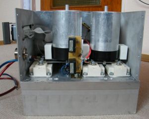

I'm often sent emails with ebay links to all sorts of IGBT modules. And often they are unusable. What you want is an IGBT half bridge module as depicted above. It is two IGBTs and two diodes in one case.
Next up is capacitor selection. It's hard to give general advise. I always advise against elcaps because of their low ripple current rating. Better use film caps as shown above. If you can get your hands on any cheap and large (meaning above 300µF for filmcaps or 3000µF for elcaps) caps then give it a shot. Watch the DC bus voltage with a scope while running the inverter at load. You don't want to see excessive ringing or spikes. Here are some examples of what you do and don't want to see.
In the power stage depicted above I used 1.5µF snubber caps on each IGBT terminal plus two 420µF film caps. All components have screw terminals with the same width. That makes handling very easy. Everything is bolted onto a pair of alloy strips forming a simple low inductance DC bus.
To suppress high frequency common mode signals you can place a ferrite core around the DC bus or the DC cables. This will give you a better chance to pass EMC compliance tests.
Last but not least place the gate drivers directly onto the corresponding pins of the module. The PCB has been designed to line up. Make use of that. 1cm of wire should be enough!
With the setup depicted above I passed the ECE-R10 EMC compliance test with a good margin. It's not that hard.
